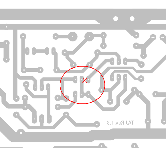

Yes, that is a mistake. I will correct that in v1.3. Thanks Alex.

Interesting, i have asked Sergio Vaz, the first Brazilian that made your board Taj
he said his version had not this short, seems from base to colector, not base to emitter.
he said he had to fix the RC gain network, the 470 ohms to ground in series with the 220uf gain electrolitic condenser, the one has the single diode as protection.
His version is working properly, it is interesting that other error was fixed and this one was installed.
We humans, ... we are subjected to failures in series...interesting that.

Okay, Here's version 1.3. ALexmm, please do your quality-control magic. My eyes are too tired after that marathon. I hope I didn't screw anything else up.
All updates are included. And there's one new "feature": I squeezed in a 10uF Polyester input cap with 15 mm lead spacing, including Digi-key Part number (see BoM). The two 22uF back-to-back electrolytic footprints are still there if you prefer; take your pick.
This was the final update. (I will certainly fix any errors though).
