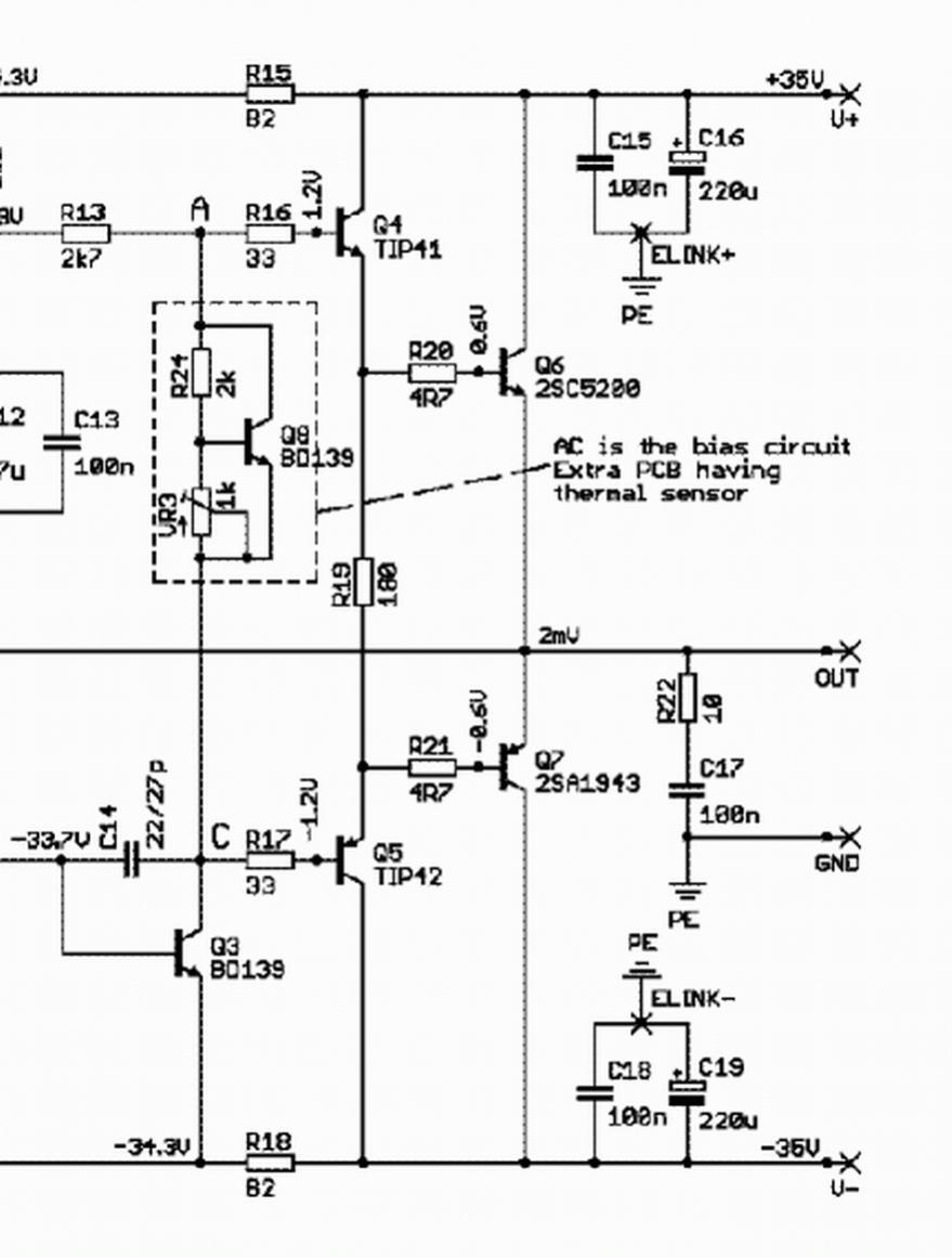

the power transistor emitter resistances to 0.1 ohms, or even to supress them!
regards
Carlos

You do not need them (Re resistors) only in case you run your output stage in a deeply closed class B, like 5mA idle current. Then you have tons of crossover distortion.

It is not needed. Actually with 0R1 you get better linearity and less crossover distortion than with 0R22. BUT, there is a game of reliability and thermal stability as well. With Re = 0.00 ohm, you get nothing but second breakdown by thermal runaway (if you do not work with a closed device) and destroyed output devices.

These resistances are needed to equalize when you use more than one pair, if you have a single matched output pair they are not needed.

With a single pair of output devices, the emitter resistors reduce transconductance (does someone understand this word?) to help matching the Vbe temperature coefficient of the output devices to that of the Vbe multiplier.
Usually Vbe multipliers run a bit short of dVbe/dt (t=temperature, not time), I used to solve that with a composite Vbe multiplier where the reference transistor was a high current TO-92 operated at a very low bias to get higher dVbe/dt and match TIP35C/TIP36C with only 0.1ohm emitter resistors, which is not easy as they are quite prone to thermal runaway (high dVbe/dt).
Higher voltage lower current japanese transistors seemed to have more emitter resistance "built in" resulting in lower transconductance and easier bias stability.
I don't remember seeing Carlos using adjustable bias on his previous projects, as it brings some new potential problems to solve. How much bias is being used in this amplifier when the emitter resistors are out of the circuit? Is the resistance of the wires that connect output deivces to main pcb being considered?

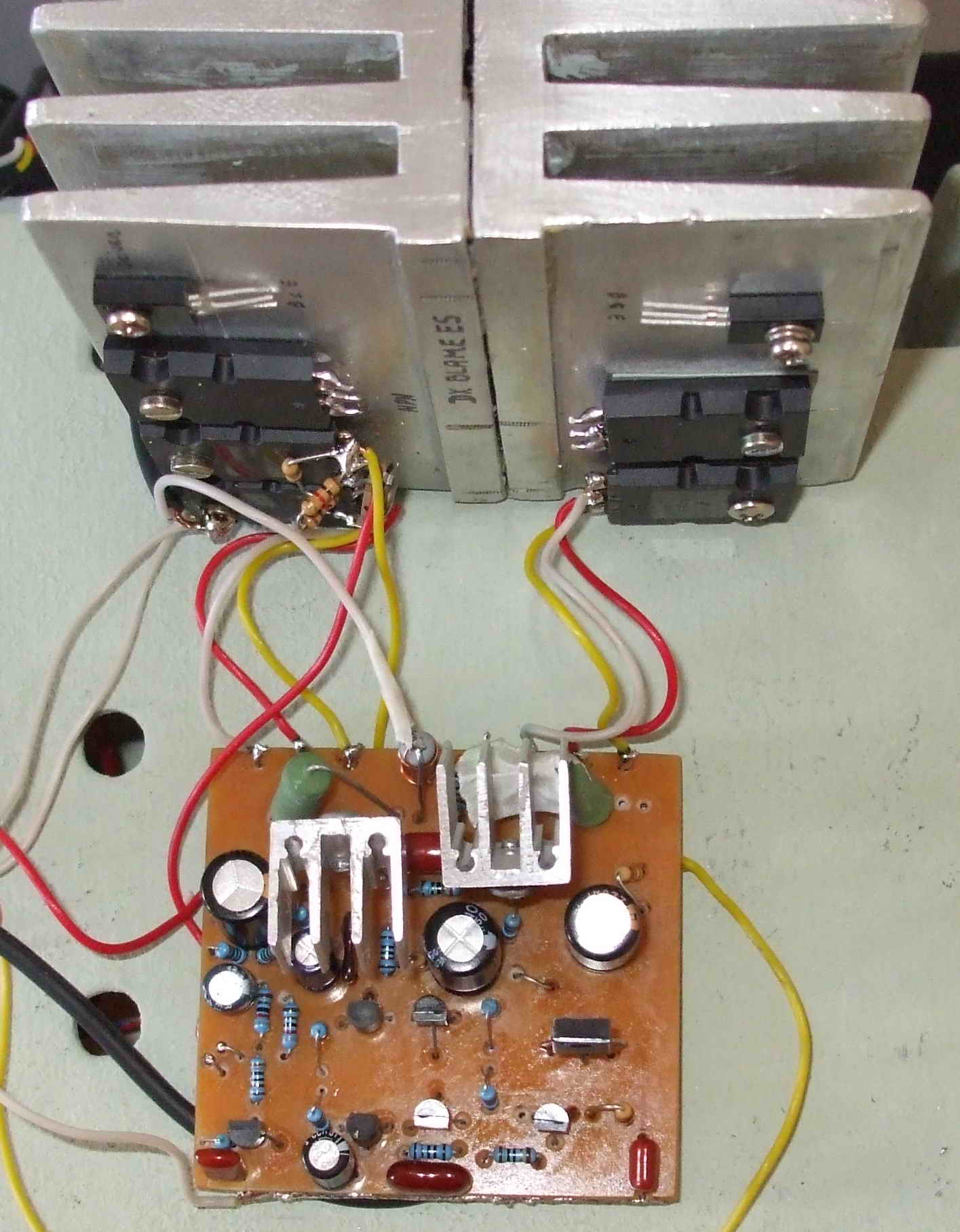

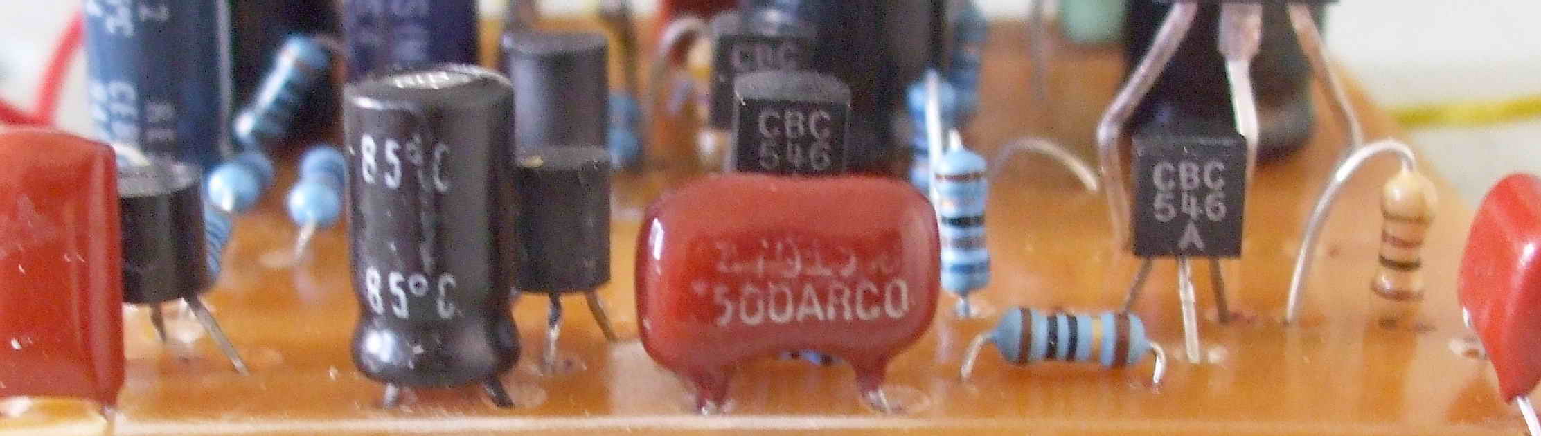

BD139/140 transistors, they are good, they can work at 100 Megahertz, i have built several transmitters using this one, Radio Frequency transmitters operating 108 Megahertz, also i have used as drivers (with some losses) in 144 Megahertz Radio Amateurs VHF transceivers, also in CB Radio Transceivers ad 10 meters SSB transceivers... do not tell me they are not good.... i will turn mad imediatelly, i am sure they are very good for audio.
Carlos,
I can tell you the BD135-140 are good, I have done similar things as you with these wonderful transistors, for already around 25 years ago I built a FM transmitter working around 100-108 MHz on a BD137 if my memory serves me, the BD137 itself was both the output transistor and the FM modulator. But these "pirate transmitters" as we called them are illegal... 😀
Cheers Michael

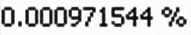

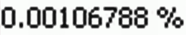

I was watching, after short the emitter resistance and have much more bass!, the distortion in the simulator even reduced!.
You see, and they go defending the emitter resistances. they have not tried with and without for sure, the difference is a hell clear.
See the images, the small number is THD without emitter resistances...and i did not tell the simulator software (it has no ears to listen me) that i was using inductive...ahahahahahaha!
So, if inductive, the result would be even worse, emitter resistances when inductive, use to sound in a very clear way.

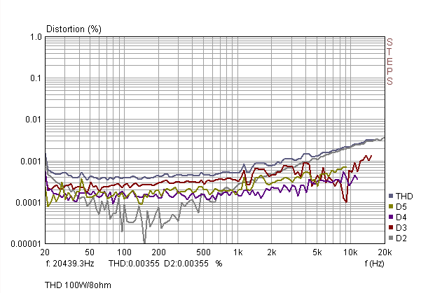

Carlos,
I am very surprised by your reaction an by size of Your ego, sorry..I posted only warning , posted schematic should simply not be dangerous. I posted several times to this thread, and I see some changes in "Your" amplifier (moved Boucherot cell remving capacitors from wrong places, fuse in output..) , according my posts. Try to buy Self´s book and read it, You wil find many answers..
But do what You want, it is Your reputation and name,but some of Your theories are very funny. And simulations are not measurements, real world is quite different.BTW. theories, I made several thousand of PA amplifiers , they are working at very hard conditions (clubs, musicians), some pieces 10-15 years, and many(several hundreds) HiFi amplifiers , too. It is my only job last 20 years.
Measured performance of my amplifier is attached, try to post Yours😉
