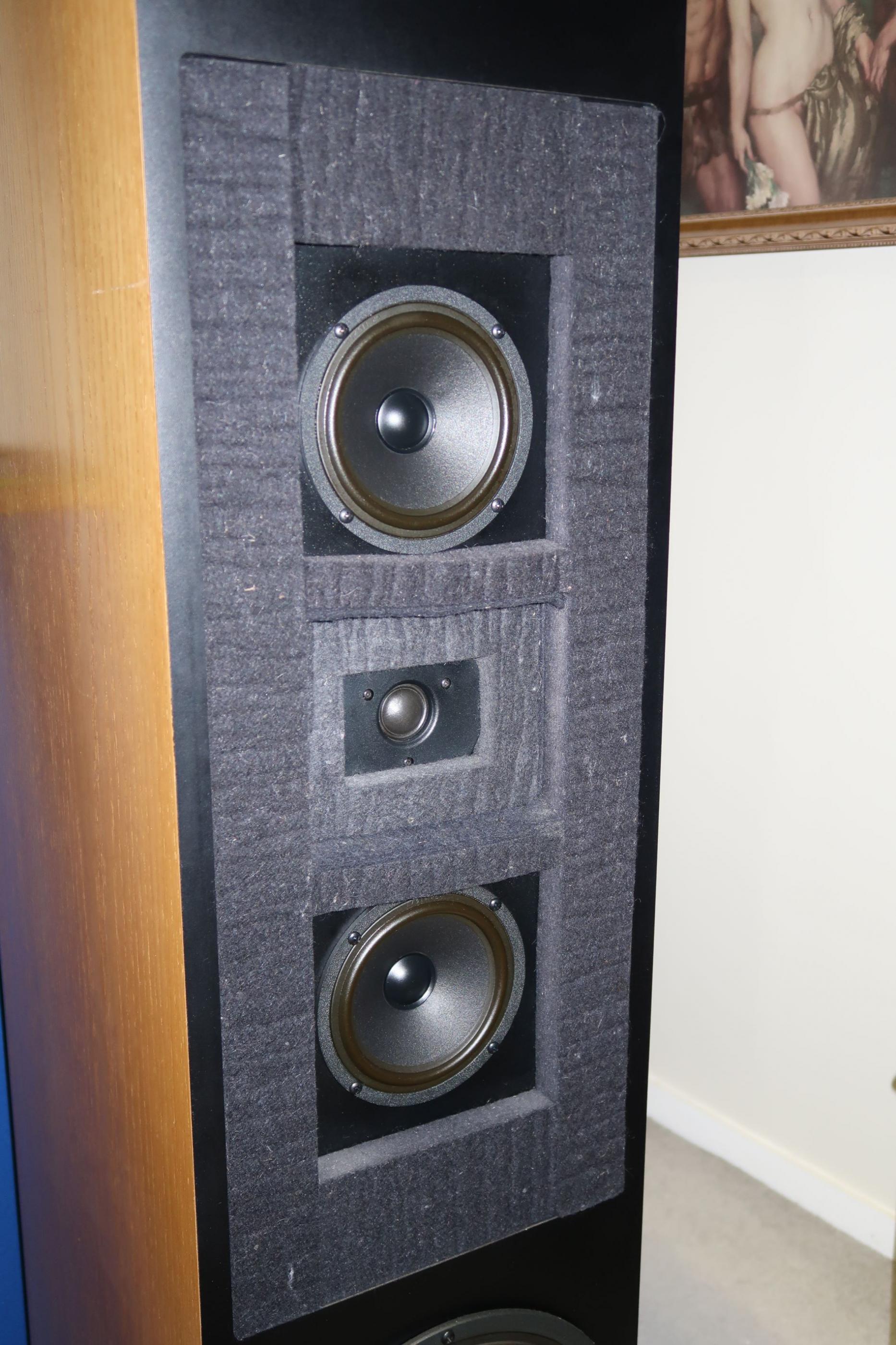

Baffle is 12"w x 72"h. Flat with no radius, trusting in the driver setback & felt to handle diffraction, etc. All drivers are surface mounted for the same reason.No problemo 🙂
Might take a day or two, but I shall get it done.
The array is centered vertically. Mids' CtC is 13". Woofers' ~40.5".
Mids' baffle is stepped back 1". Tweeter's another ~3/4", so 1.75" from woofers'.

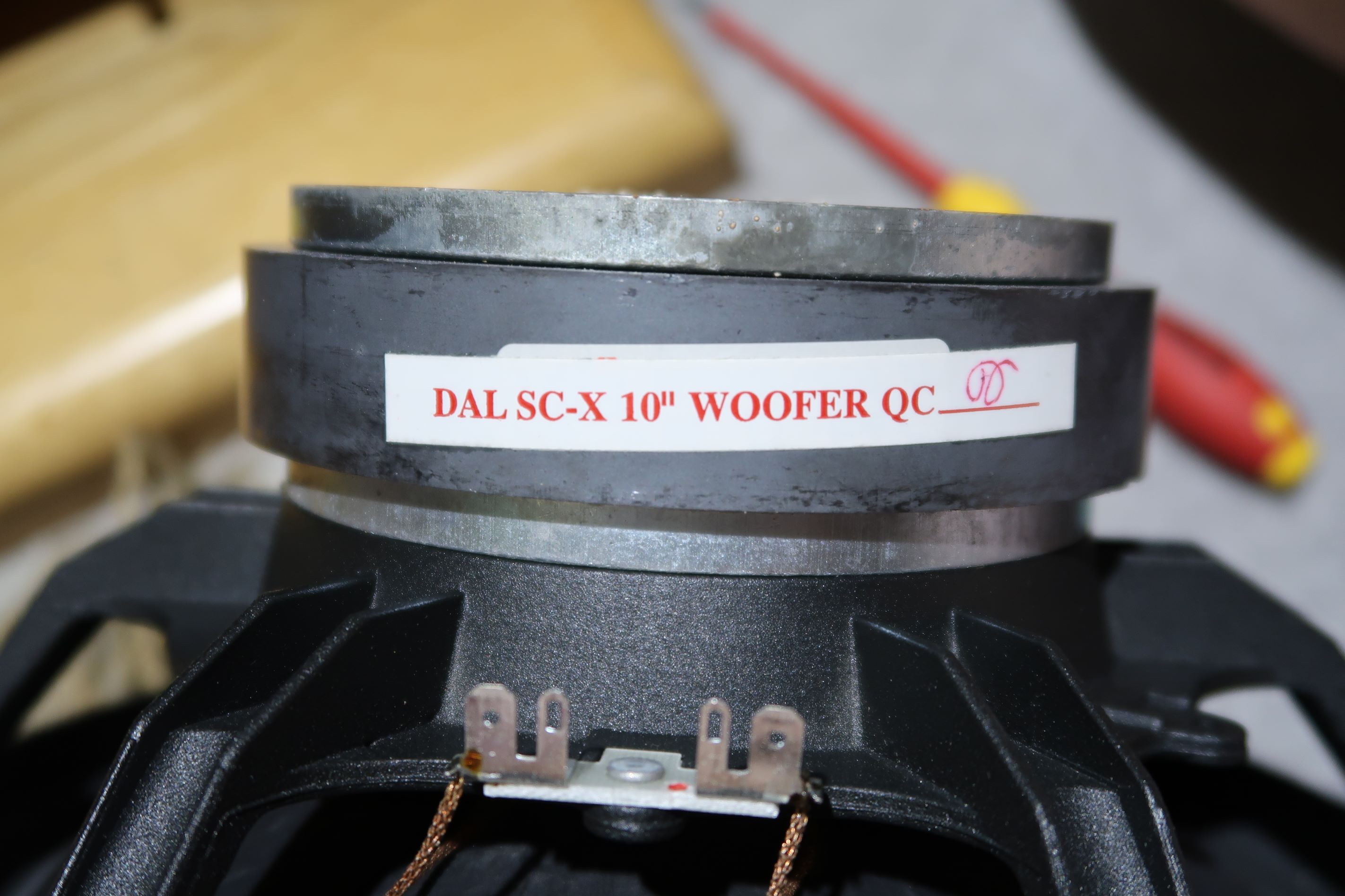

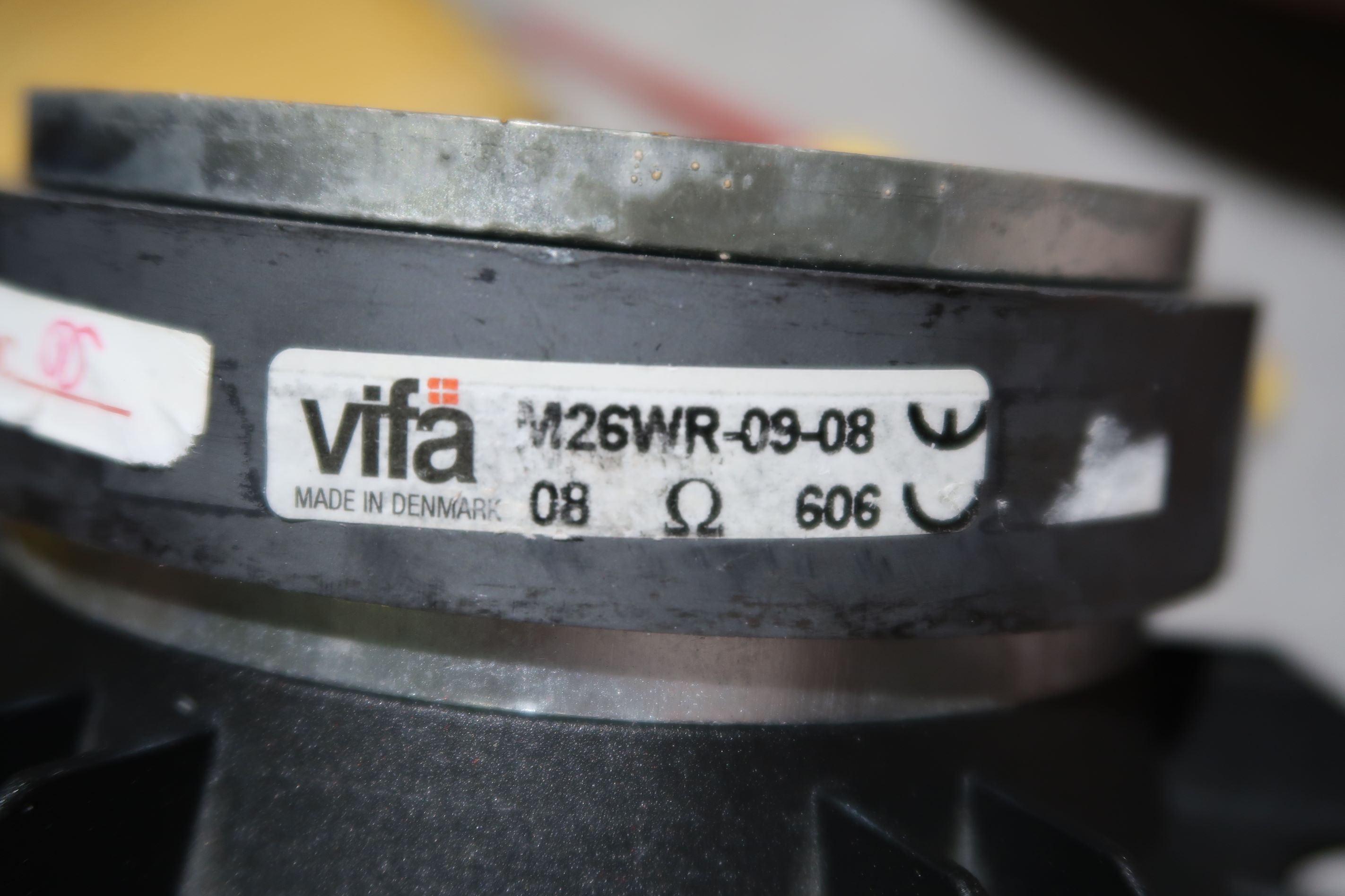

Driver info I have found scattered around da webz..
Vifa D27TG 35 06 1" Silk Dome.
Huge number of complaints about them being destroyed.
May want to consider something like a Morel MDT33 as a more robust replacement.
DAL-X 5" Vifa M13SG09-08
Possible replacement Scanspeak Classic P13WH00-08 5" Poly Cone Woofer. (<--- This doesn't seem right to me as that's the part number for a vifa, And scan never had a poly cone mid as far as I know, so no idea how they think it's a scan..).
Rumours are that John had vifa customise the drivers (Extra damping chamber on tweeter/basket/motor assembly only ?).
So it might be a wiser option to recone (if possible) rather than do a straight out swap even if it has the same part number.

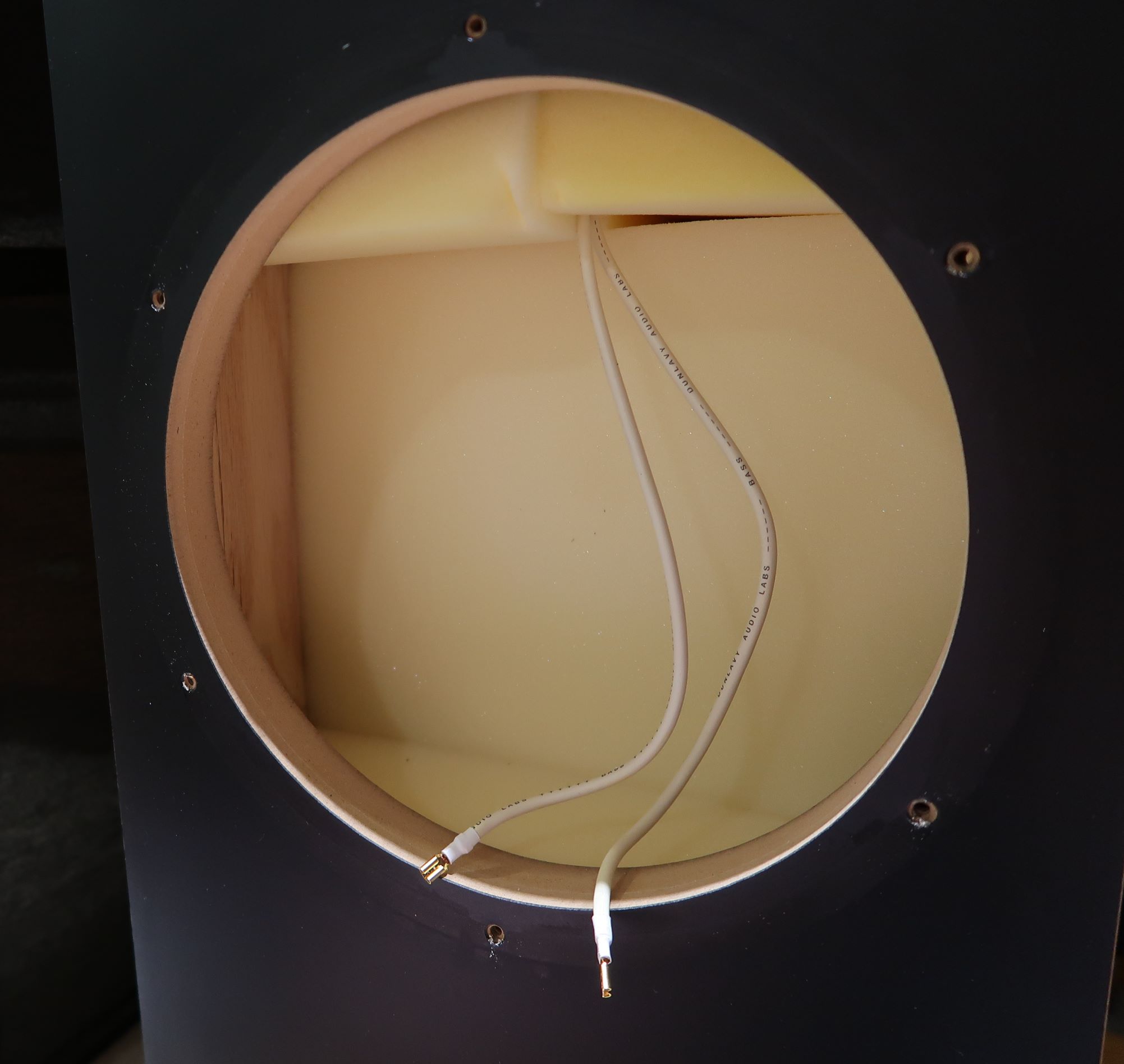

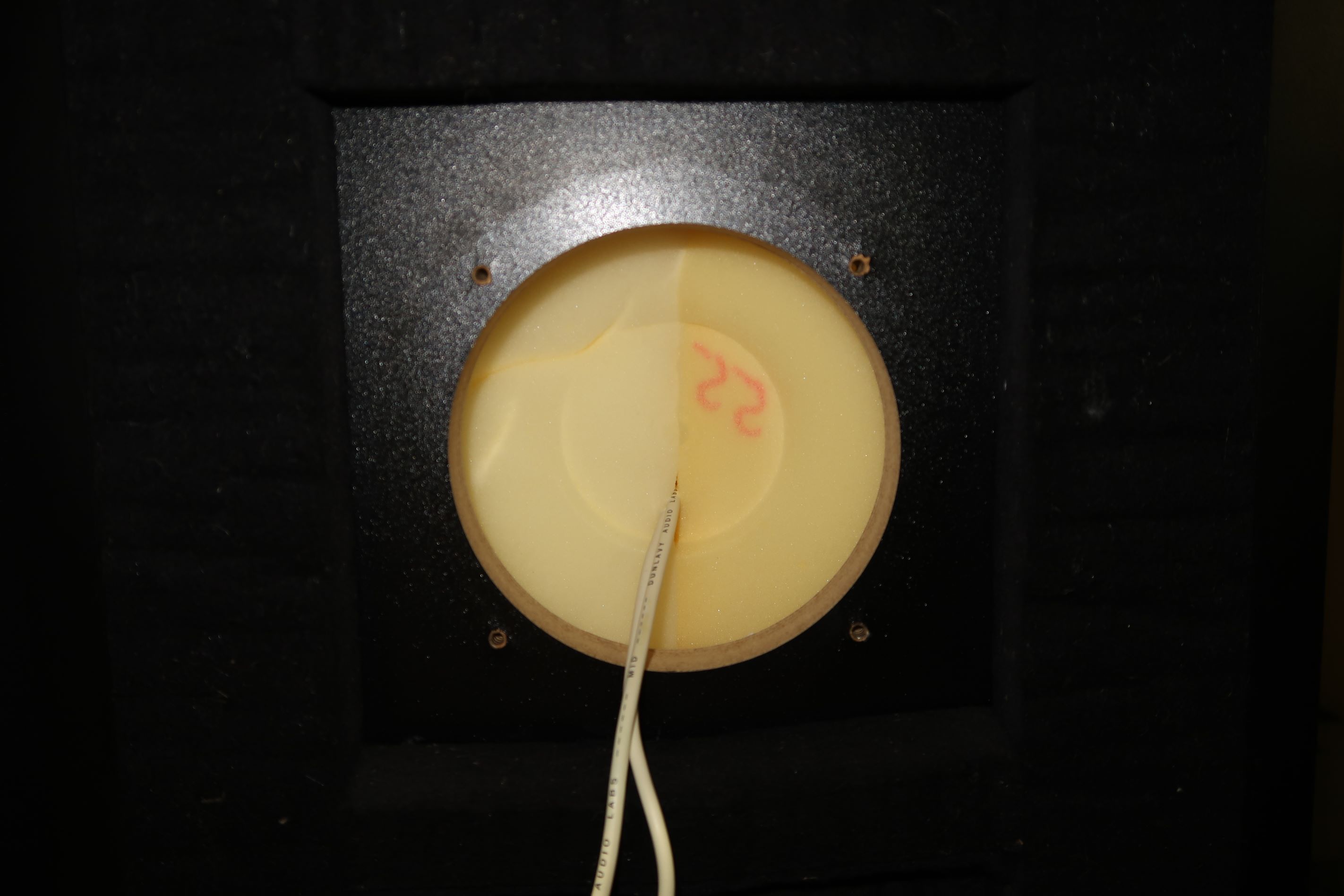

Pics as attached.
It would appear the cabinet is fully packed with foam.
And I do mean packed. As in it fills every mm of space.
The magnet of the mids push against it, the back of the tweeter has a gap of maybe a few mm.
The bass section has a little room behind the magnet, but not much. Sorry I didn't think to measure that.
But the pics should help you understand.
The mid/tweeter/mid section appears to be one chamber as when I had the mid out, I pushed the tweeter out from behind via the mid hole.
The bass sections I can't comment on as it would involve more deconstruction than I'd want to do.
Especially as these are not my speakers 🙂
Dimensions as best I can measure so give or take a mm here or there.
Outside of cabinet is 304mm Wide x 1777mm High x 458mm Deep.
The crossover is in its own foam lined enclosure at the bottom.
The main cabinet sits 25mm high above the plinth which itself is 40mm High x 470mm Wide x 600mm Deep.
The front panel is 110mm back from the front of the plinth.
The front panel at the bass driver hole is 25mm thick mdf.
Bass centre line is 385mm from cabinet edge. Top and bottom.
Mids centre line are 725mm from cabinet edge. Top and bottom.
Tweeter is dead centre at 888mm from cabinet edge.
So a fully symmetrical layout.
All drivers are surface mounted.
The mid/twt/mid rebate area is 267mm Wide and 665mm high.
Each mid section is rebated 25mm from the front panel and for each mid driver is 260mm high.
The tweeter section is rebated 45mm from the front pant panel and is 145mm high.
It appears there are 2 or maybe 3 different densities of felt on the front panel.
Hope that helps 🙂

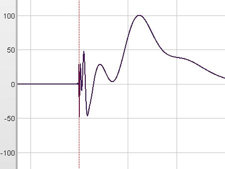

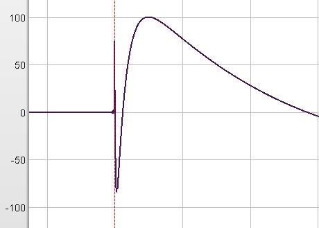

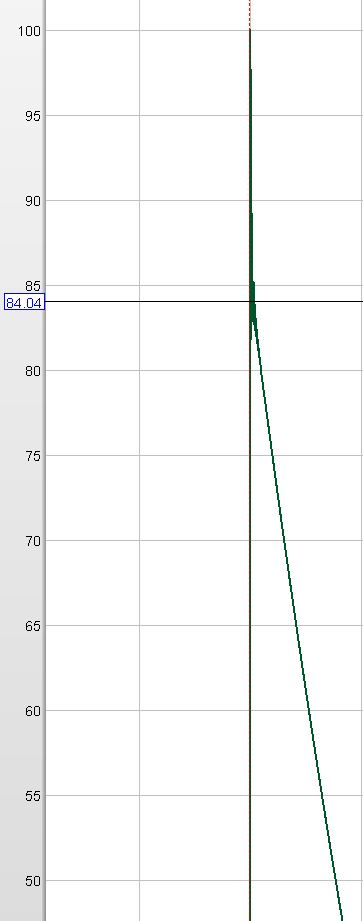

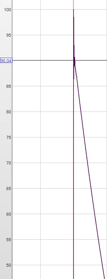

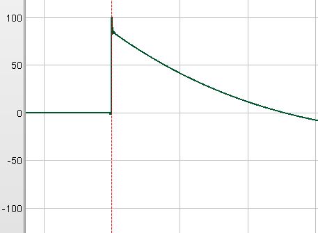

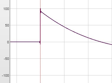

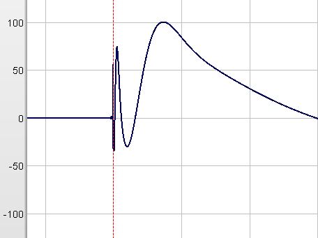

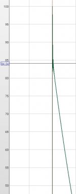

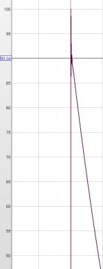

Oh and honestly I'm enjoying the conversation about step response etc, so please, continue.
Hope you really meant that ! cause here goes 😉
Couldn't find very much info on how to assess step responses. Maybe the best article was Step Response: Does It Really Matter? | Audio Science Review (ASR) Forum
So i started playing around looking at them from a 'crossover-only' standpoint, as a building block for being able to 'read' them.
I've been running REW against the spectrum split into electrical passbands and summed back together.
Patterns definitely show form/shape differences between 2-way vs 3-way vs 4-way, all using the same type and order crossover.
They show incredible differences as order increases...other than with 1st order and of course linear phase.
I'd say beyond 4th order they get so convoluted they aren't of much use.
So, staying with nothing above 4th order....
timing and polarity changes make a huge impact on the step shapes.
Surprisingly, moving x-over frequencies up and down, and altering relative band levels, not so much.
To no one's surprise on this thread, first order rules IIR step response.....big time.
For fun, I've attached some step responses of a simple 3-way using crossover points of 200Hz and 2000Hz, splitting the spectrum kinda evenly.
So to repeat, this is measured electrical summation only,.... as good as a speaker step can get using said crossovers.
As you can see , 1st order and lin phase look essentially similar.
The last two snips are the peaks of the BW6 and Lin phase. This was about the only small difference i could see until moving up to a 4-way, where the 1st order started to show a little more concavity.
They go in order: BW6, LR12, LR24, LR48, Lin Phase (100dB/oct),
then BW6 peak, Lin phase peak..

I am not interested in an exact copy, but rather in building something in a similar concept. Loudspeakers used in the original Dunlavy are not available. What loudspeaker could replace the original Vifa p13wg-00-08?
Similar concept as in a three way with first order crossover ?
That doesn't mean you need to use vifa's.
Or any particular brand for that matter.
You would have to look at whatever specs are important for them work together in a very wide response.
I would be tempted to look at his SC V (12" drivers) or if you like stupidly big, his SC VI with 15" drivers.
So after reading that, ok I read the first page and skimmed the rest.
It always seems to me that it comes down to one basic premise.
Unless your listening room is exactly the same as the designers used for their tests etc, then you will never get the full effect of what they designed the speaker to do.
This isn't just in regards to step response, but every other measurement system out there.
In larger Duntech and Dunlavy speakers such as the Sovereign, the bass section had a small chamber directly behind the woofer, slot-loaded into larger volume. Similar concept, I suppose, to the Dynaco A-35 or A-50.
