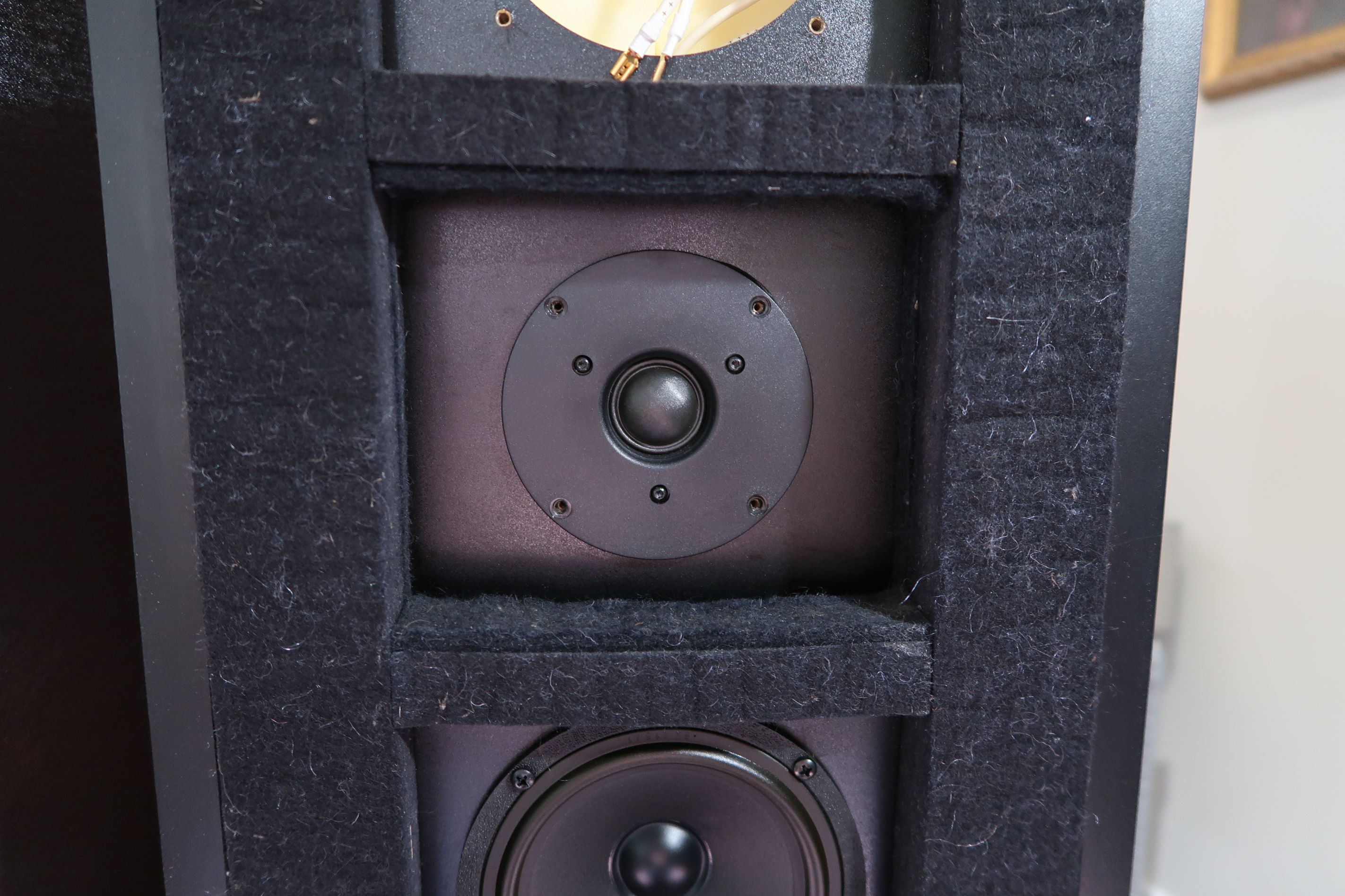

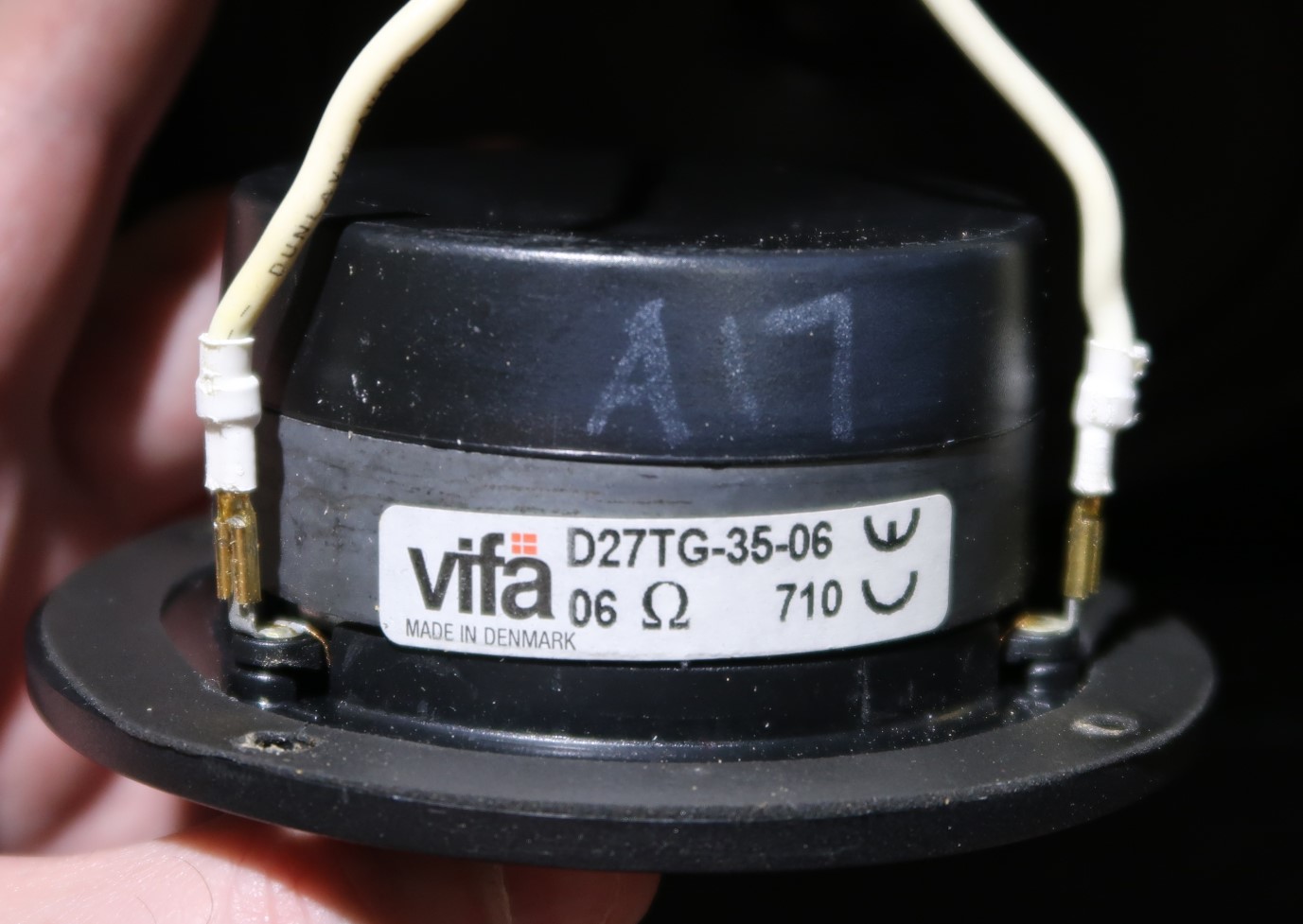

I was originally led to believe by the (new) owner that the tweeter had been changed.
Now I have them here, I can say they have not been changed.
These speakers are factory original.
D27TG35 or are these early production? Per Andrew Rigby (Dunlavy support) mid-90's, the change happened around serial # 250. I'm not sure which tweeter was used for the 1st year or so of production. Per Stereophile's SC-IV review, it was a Vifa fabric dome but not silk.

I haven't removed any drivers to confirm model numbers (yet 🙂 ) as I don't want to risk marring the cabinets, felt or gaskets etc. If I do go that far I shall report what I find.
I've replaced SC-IV tweeters, thankfully when DAL was still around to provide a set matched to the speaker's original pair. The job's easy enough.
I don't recall the gasketing, but I'm sure there were no issues with sticking, residue, etc. Of course, that may be a little different after 20 more years...
Drivers are not soldered, and the D27s do fit thru the hole in the felt. Just take your time & get the angle right.

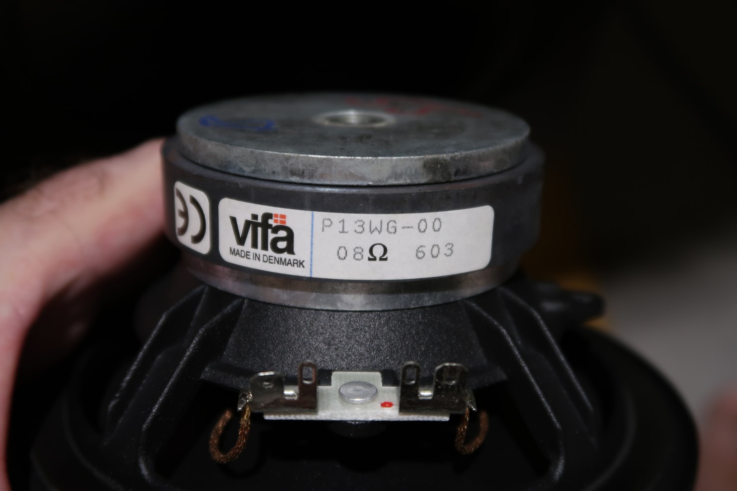

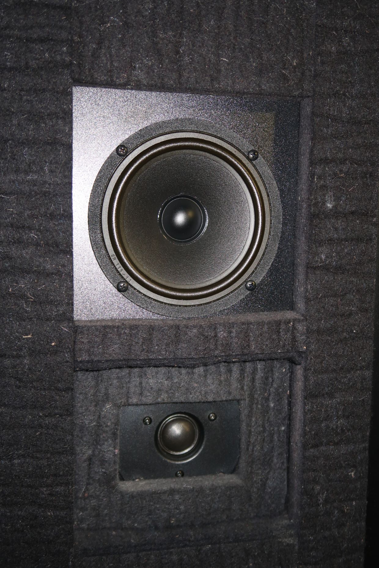

Two pics for those playing at home.
They are the mid and tweeter out of this SC IV.
From the few threads I've found about the SC IV's the midrange model is 'unexpected' 🙂
Interestingly there is no glue at all holding the felt in around the tweeter.
