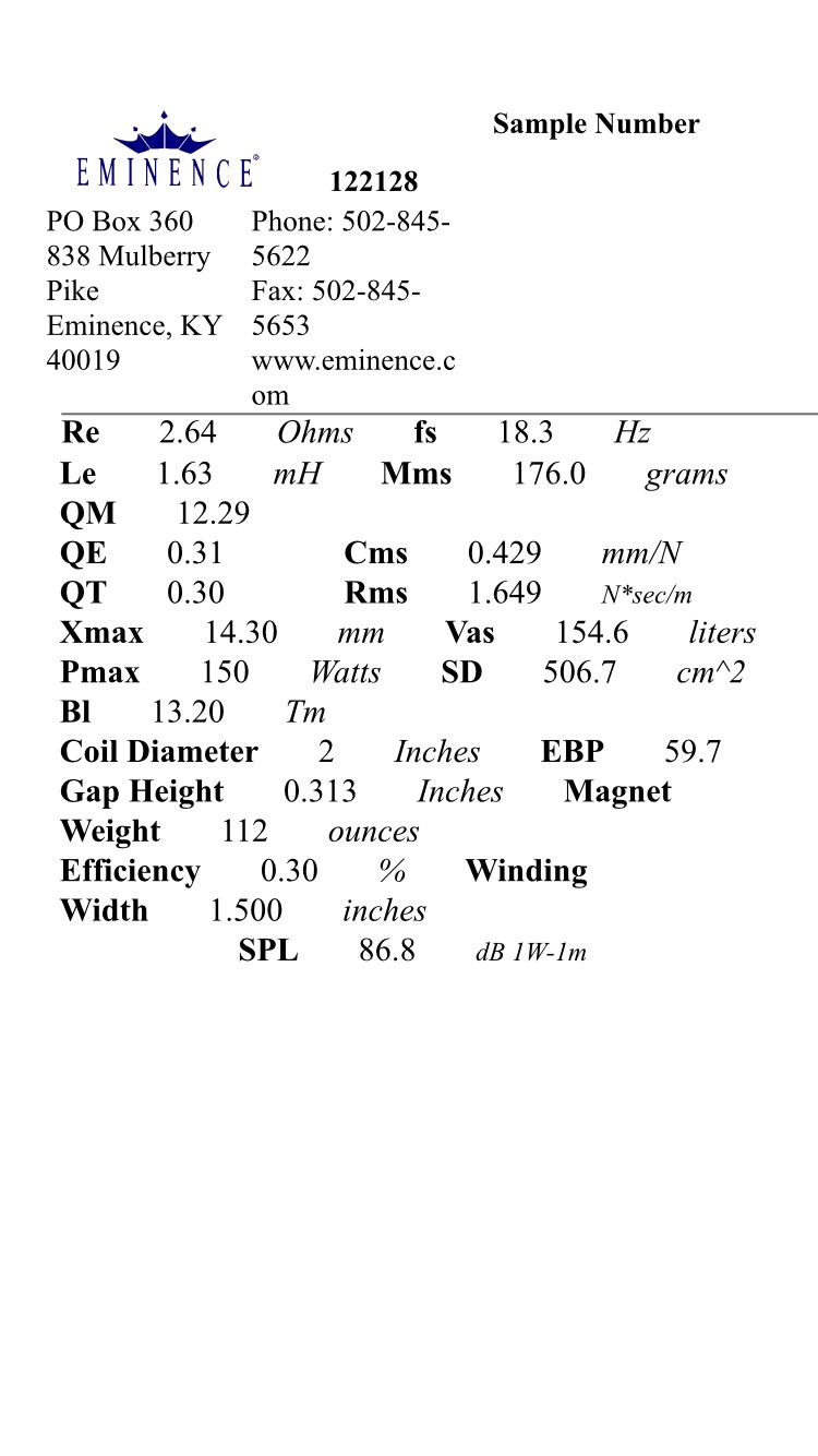

@johnnyk9 Yes my SC-S2 has 2 12" . See pictures. I bought it with a fried amplifier (see pictures) which I removed and sealed the cabinet after direct wiring 3103 cable. The amp appears to have caught fire on the pcb under the filter caps. The 2 - 12" drivers are wired in parallel for 4ohm load. The internal wires are 12 awg copper (not tinned) labeled dunlavy. Do these look like Eminence ?
I apologize I somehow missed this question.
Yes they are Eminence.
Here are the specs. Very similar to a Lab12…

Hmm, thats interesting about the P13s. I put new surrounds on my last pair I have since they became rock hard, and they're reasonably close to spec.
I'll try to get some measurement data for you on the new M26s I have. I used 2 of them in separate 1.5 cu ft boxes behind the bench seat of my old F250. They sound amazing in that small space and are super efficient. One thing I did notice is they are very sensitive to uneven screw torque on the mounting flange. The VC starts to rub if i don't have those screws tightened very evenly, so i suspect they run a very tight VC gap clearance.
