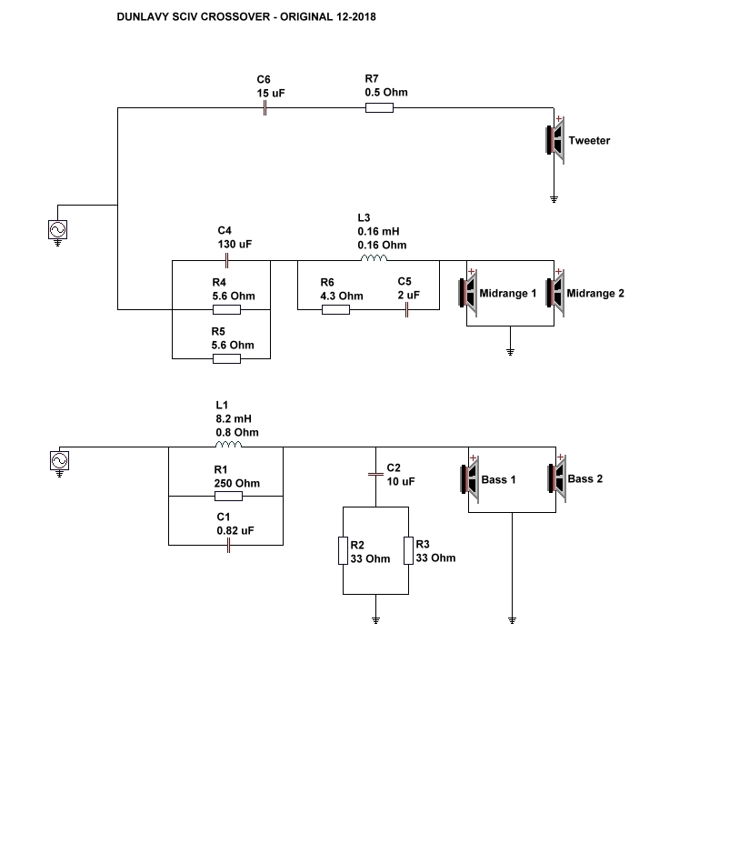

I'm hoping someone has the schematic they can share.
All I've found so far are photos of what looks like potentially two minor variations.
Update.

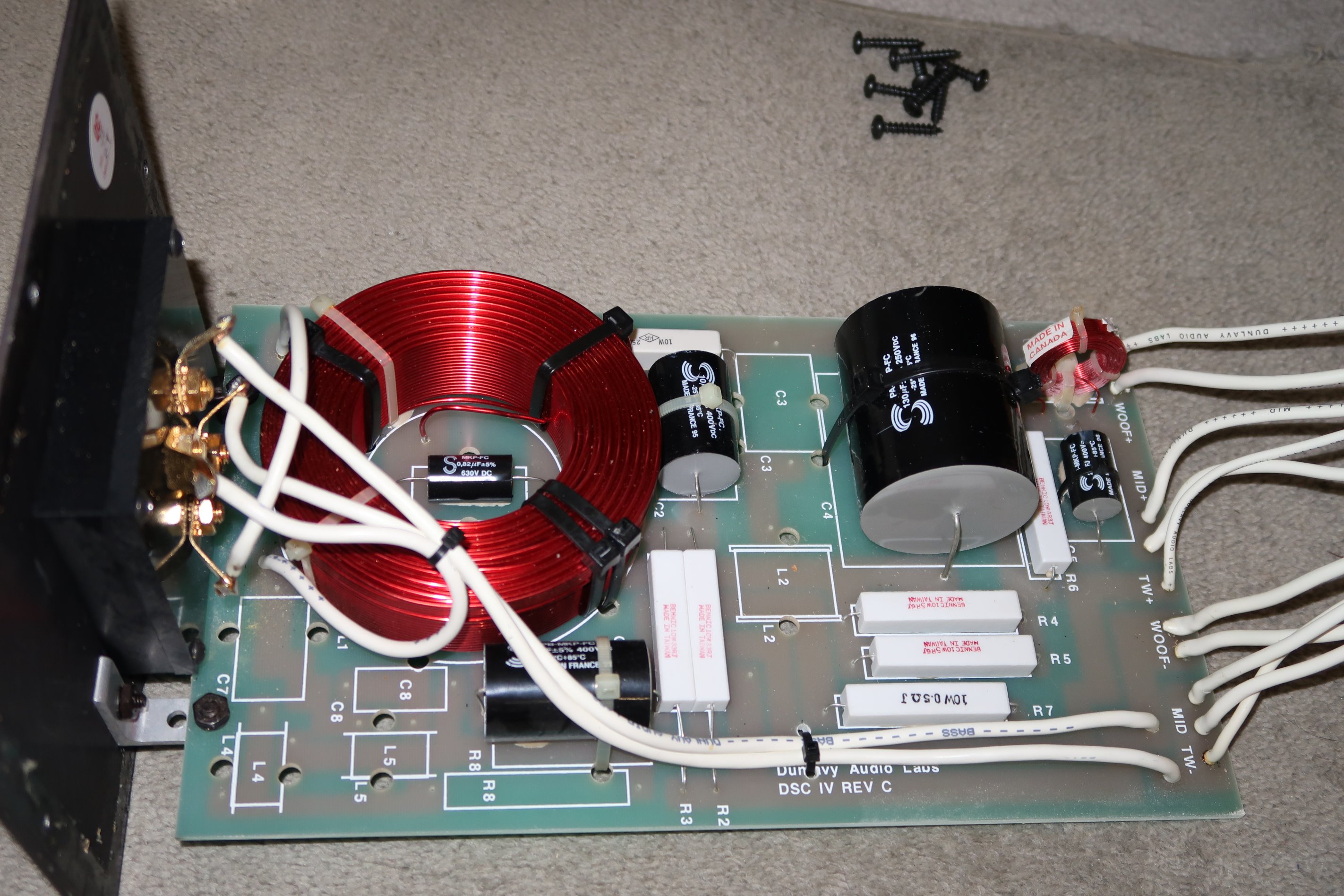

Friend asked me to babysit these speakers.
And after getting his blessings I removed one crossover and took many pics.
I have also now drawn up the crossover.
Due to technological advances, there is much room for improvement.
If he decides to go that way that is.....

If they were my speakers I would forget all about the passive crossovers and go fully active.
I would tend to agree. Here is a quote from this site:
...the pair of SC-VIs that I purchased for personal use spent about THIRTY HOURS in the anechoic chamber. Every single pair of speakers he built went into the chamber, one speaker at a time and unlike most other speaker companies, each crossover was hand built for that specific speaker and set of drivers and unless John personally examined the chamber results, the speaker would not ship...
This isn't what I'd call "design for six sigma" (DFSS), if you catch my drift...
Chris
Is the balance off? Dunlavy sure new what he was doing, I wouldn't claim to be able to do better. The changed out tweeter might have upset things though.
This is pretty much a unique speaker with a clear vision, it would be a shame to mess it up. Just read the post from Cask05 above.

I was originally led to believe by the (new) owner that the tweeter had been changed.
Now I have them here, I can say they have not been changed.
These speakers are factory original.

The owner is not tech savy (not in this area anyway). And the expense of going active would be a huge no from him.
These speakers really do a lot very right.
Far more than almost any other speaker I've heard.
I have zero plans on changing any component values.
Just updating the solen (shudders) parts for more modern, better manufactured items.
And yes I know some out there are reading my posts groaning and yelling at the screen :D

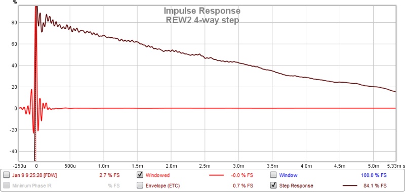

I was trying to ask, how do you read, what do you see, in a step response ...that then leads you to alter your design.
IOW, when, why, and how do you judge a step response?
I know what a good step looks like, or at least I think I do :)....
I've included an example that I'm used to achieving, of a 4-way.
So far, for me to get a good looking step, I work with mag and phase and get both as flat as possible.
That of course means dialing in x-overs, levels, timing, etc...all of which adjustments I can see pretty easily, with mag and phase under dual FFT.
But I couldn't start to look at step and know what to alter.
Is there some material that shows examples of funky step functions, and how to read them?
I love Dunlavy, but what he's saying about first order xovers isn't 100% true. It *is* possible to get good step response with higher order crossovers.
I didn't know this for AGES. I still have my Vandersteens, which I purchased when I was under the misconception that you must use first order filters to get a good step response.
Agreed !
The 4-way step I just posted used 16th order LR's for all the x-overs.
But I do think, if using passives, that lower order is practically essential to maintain the flat phase that's inherent in a good step response.
