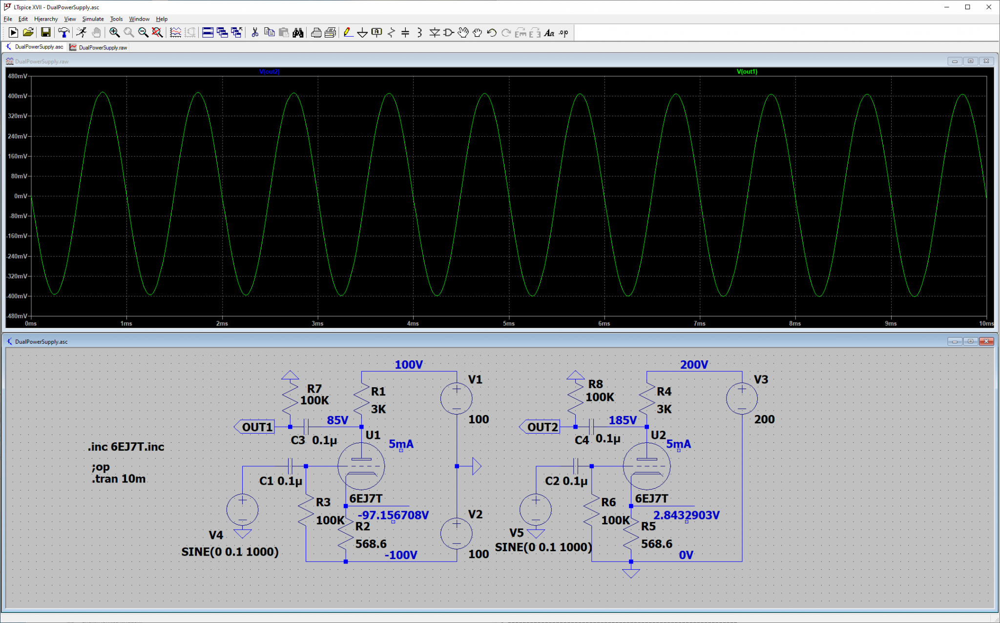

I would say your case is a strange one, very little drop on the plate resistor. But it makes no difference, as many said before, the calculation for the bias resistor is the same, based on the curves and desired current. Easier to illustrate with a simple circuit, two implementations, one with +/- 100V supply, the other with 200V. The bias resistor is exactly the same:
Thanks for your response. You should note that my "case" is in fact hypothetical (as I said in my initial post) because for me, the numbers are irrelevant. At this stage, I want to understand the process and the theory behind the process.
Thanks for the schematic. I would build it if I had the time.
Can you be more specific and address the theoretical aspects of the problem?

Has anyone had any experience with using a dual power supply for tube amps? If so, did it work? If not, why not? I ask because It seems to me (at least in theory) that it would bypass the problems of having to use hv caps if one could split up the b+ into a negative leg and a positive leg.

It has been a while since I have had the time to look closely at this schematic. It has helped me with my original question. Thanks again for it. I have another question related to this schematic: given that all tubes use the bias set by the cathode resistor to control the flow of electrons, how does a tube with B+ and a B- control the bias? With the same cathode resistor?Doesn't it have to go to ground in order to do so?I would say your case is a strange one, very little drop on the plate resistor. But it makes no difference, as many said before, the calculation for the bias resistor is the same, based on the curves and desired current. Easier to illustrate with a simple circuit, two implementations, one with +/- 100V supply, the other with 200V. The bias resistor is exactly the same:
