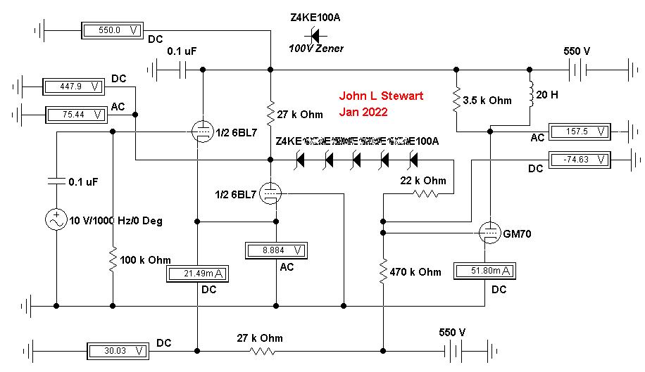

This is my first attempt at using a dual power supply. It seems to me that it solves some problems of having to acquire HV caps, etc.
Is it necessary to have the pos and neg legs be an exact mirror of the other? Can one leg be a pi filter and the other a choke filter? IF so, are there any advantages to doing it this way?
In this case the DC load is across the two supplies, not to ground, so the two supplies should be
similarly configured. But instead you could connect this as a single supply, with two equal series capacitors,
and with an equalizing resistor across each cap.
DC drift is the enemy of direct coupled amplifiers. This can be partially fixed using a differential front end.
DC stabilized PSs are the normal in anything serious. And while using tubes the heater supplies were stabilized as well.
The five 100V Zener diodes provide level shifting to avoid signal loss between stages.
This schema is a first pass & is not optimized. 10V rms on the front end results in 7 Watts in a 3.5K load.

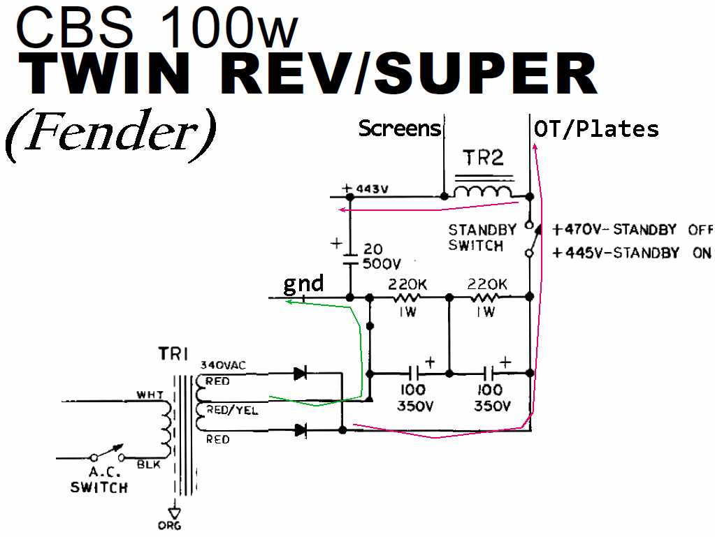

Don't over-complicate. K.I.S.S. If you are not doing a direct-coupled (transformerless) output, tubes are far happier single-supply. (Maybe a minor negative supply for bias, but not a fork in the MAIN supply.) High voltage caps are readily available, at specialists and even at Mouser/Digikey/etc. You need some balancing resistors but you should have bleeder resistors anyway. Here is a well-tested plan from over 45 years ago (I didn't want to go too deep in the vault).

As a side note I see your circuit as scary.
You want to make the baddest assest triode gain stage in the planet?
I agree whole heartedly with KISS principles, in fact I am doing a OTL but a cap coupled design and while I have the caps for a 1000v supply, I would like to split the supply to keep the supply within the voltages of 550v caps.

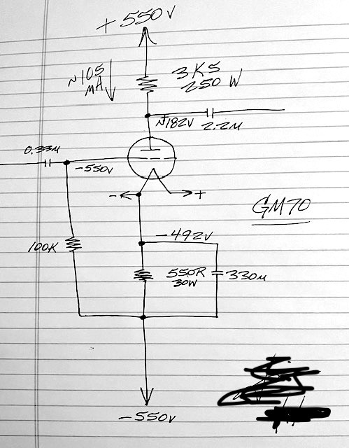

While your properly called badass design :
se-gm70-otl-voltage-analysis-jpg.1013860
uses very deadly 1100V supply (not that 250V is "safe" of course), a 250W plate resistor 😱 , a 30W 😳cathode one (and even so it manages to smoke it 😳) and to boot places grid, cathode and filaments 550V from ground. 😱
In fact I am finding my adjectives weak, go figure.

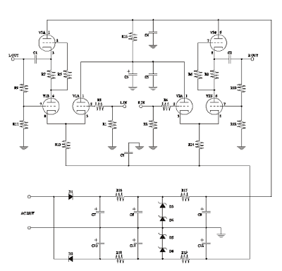

This is one of the better designs I've come across: https://audioxpress.com/article/your-can-diy-a-25w-otl-tube-amplifier
It's a good design because the powersupply caps do double duty as power supply smoothing and effectively becoming the AC coupling capacitor to the output. If the output stage fails and tries to send DC to the speaker it's limited by a resistor on the ground of the split powersupply. It has copious amounts of negitive feedback so distortion is low. It has DC feedback so the DC offset is at least somewhat self adjusting. Main improvements it can do with is to make sure everything doesn't blow up if one or more of the tubes (not just the output tubes), or a powersupply rails fails, and making it less sensitive to variations in line voltage - you don't want for instance your bias to increase by 100% if the line voltage increases by 10%.

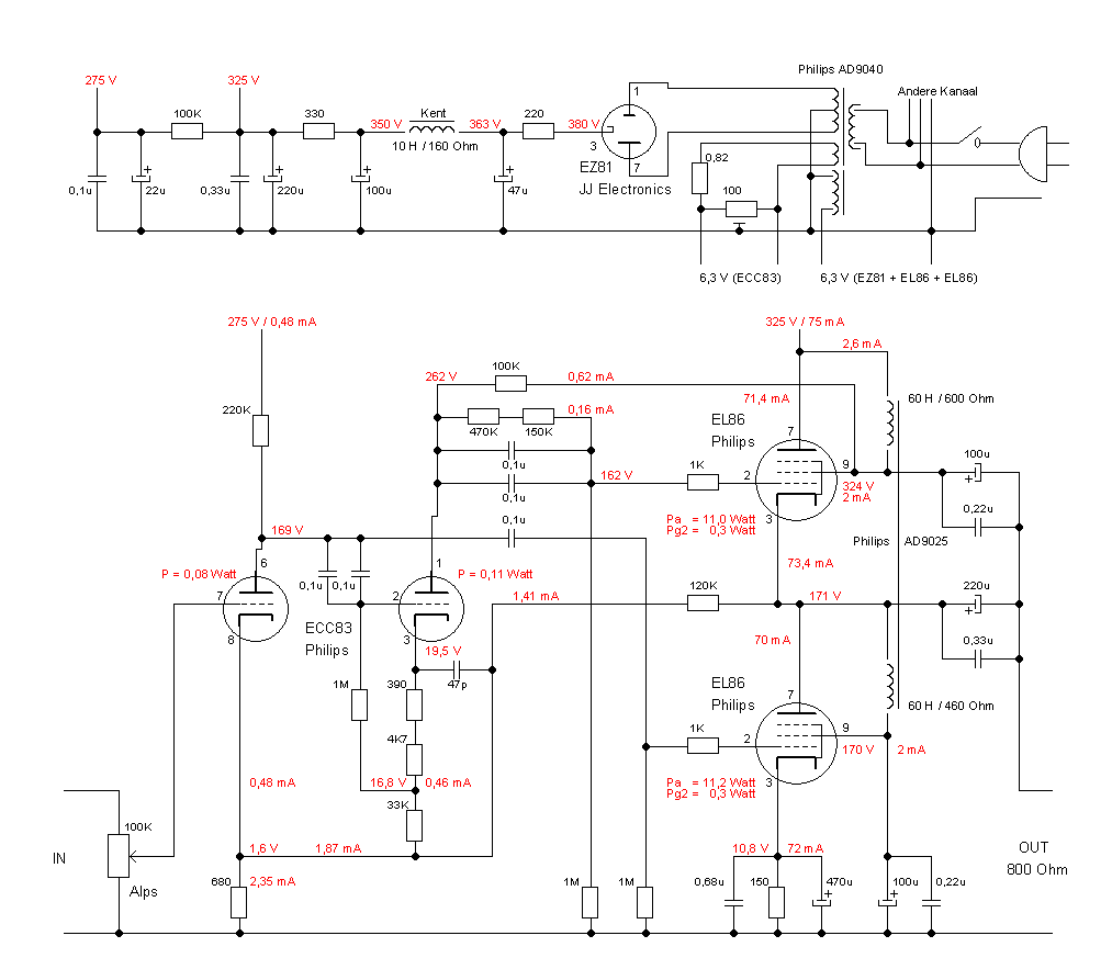

Although a small niche within the world of OTL tube amplifiers: Philips made a line of Hi-Fi OTL tube amplifiers, with 2 x EL86 and a double choke for the screen grid supplies per channel, for 800 Ohm loudspeakers. There's positive feedback and (much more) negative feedback going on in it. I never heard or read or experienced that they showed signs of instability. I have built two myself that work fine. Output power is 10 Watt at 0.3 % THD.
