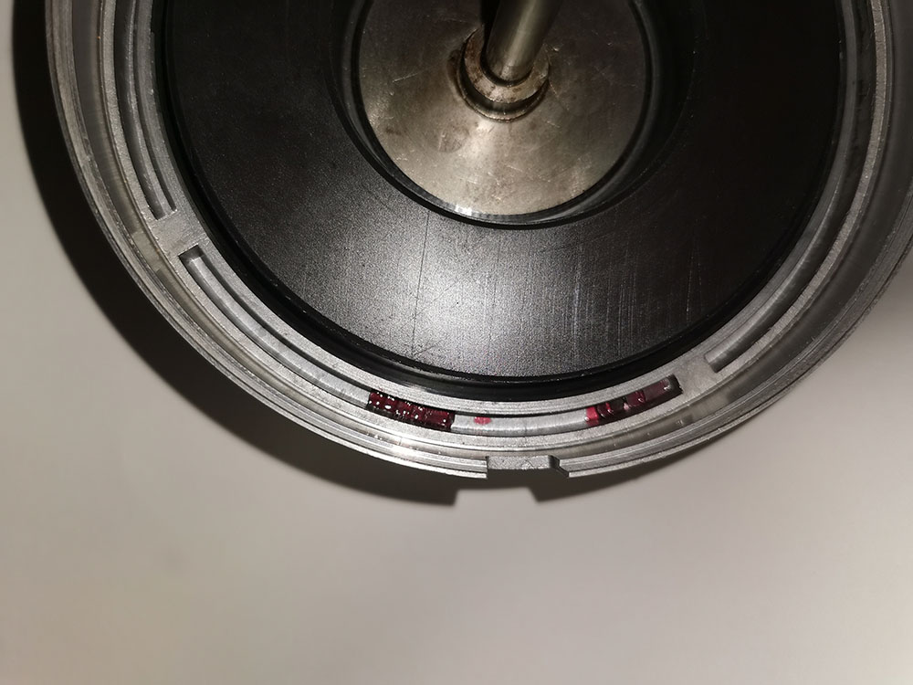

I don't think there's meant to be any slippage; I have dismantled one of my motors again, and I can definitely see a 'glue line', which unfortunately does not show up well in a photo.

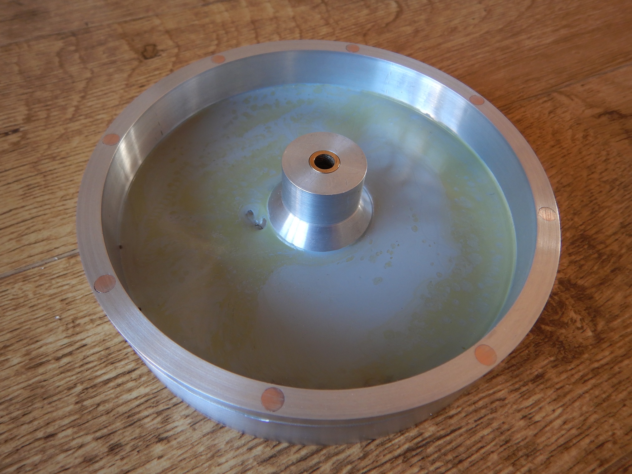

Without breaking it apart, which I do not intend to do, it appears that there is steel plate epoxied into the alloy rotor, the inner surface of this is machined flat (I can see this in the area just outside of the magnet. The magnet, which has 8 poles, is then epoxied to the steel plate, presumably to concentrate the magnetic field. Finally the complete rotor assembly is balanced, with small weights added as shown in the photo below.

Doch. Well, I will just (re-)comment. It was actually very easy to adjust the position of the magnet back to it's intended, perfectly concentric position. This is because the thoughtful designers at Dual machined a small ridge onto the magnet mounting plate, inside the i/d of the magnet, that denies the magnet any other comfortable position. If it is dislodged, as in my case, then it rides up on the ridge, and separates slightly from the seating surface. But all the magnet wants to do is grab that plate as hard as it can. So with a little initial impetuous, it slides straight back off of the ridge, bang into the concentric position. And it is as good as bolted down.

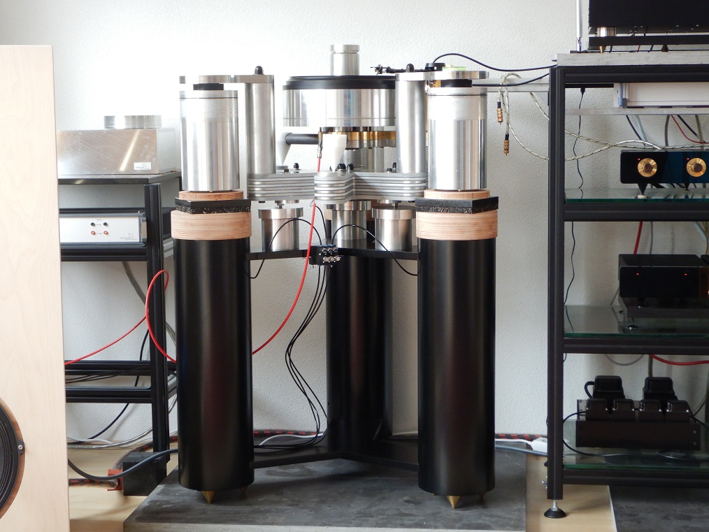

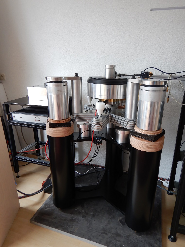

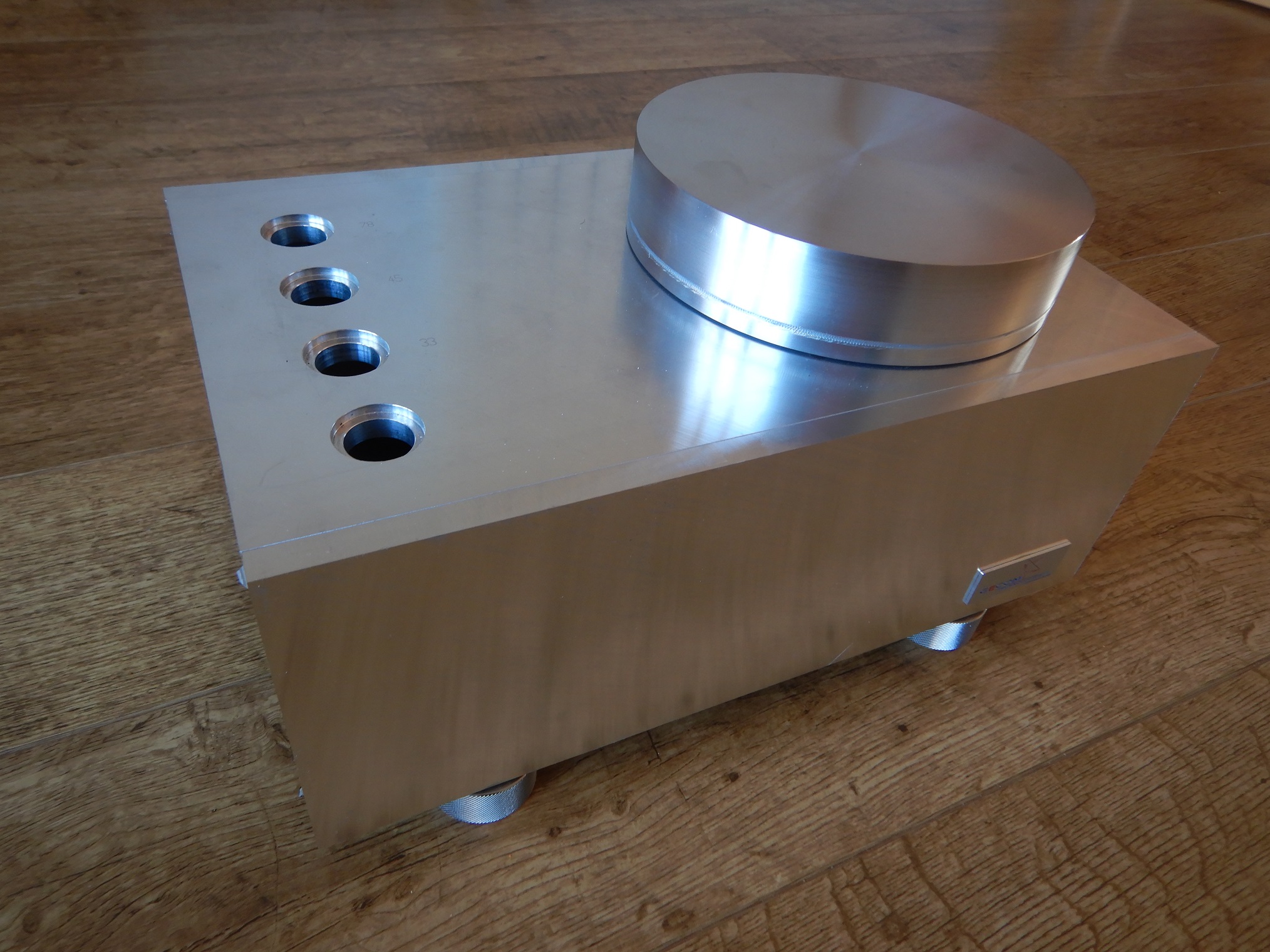

Currently i use a EDS930 (from a Dual 741Q) as an outboard motor do drive the turntable by a string. I specifically choose a DD-motor as the pulley i use is not a cm-affair but a half of the size of the turntable platter itself. This pulley has weight (in order to obtain a flywheel-effect); the bearings of standard TT-motors would wear down to easy. The EDS930/741Q normally felt the load of the original platter so my pulley is easy enough.
The motor, together with the original 741Q PCB's, is in an external housing. The battery power supply feeds the motor 8++ hours disconnected from the mains.
And i was lucky to score a stash of EDS930's for sane money. That batch will last forever.

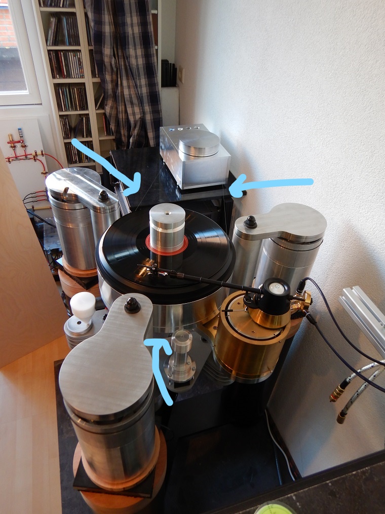

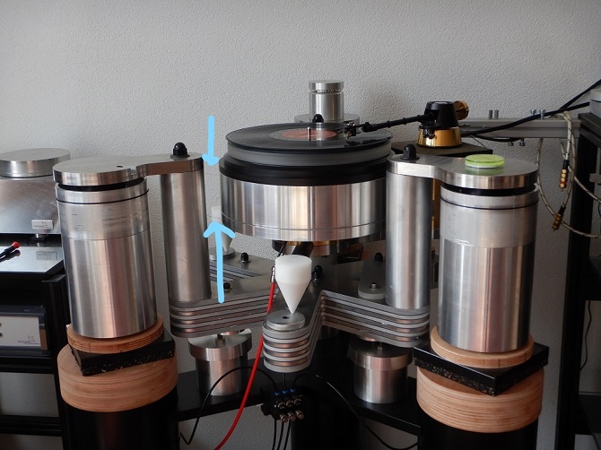

Of note: i'm not running the string from the pulley directly to the platter. I loop the string to an external free standing axle. The actual turntable platter simply is touched by the string on 2 opposing sides. There is no tension on the turntable axle whatsoever as the tension is divided by the pulley/motor and the axternal axle.
Added a picture with arrow to that external axle.

As the CS 741Q's EDS 930 and it's electronics is designed to run either at 33 1/3 or 45 rpm, the drive pulley and the platter need to be of the same diameter. You said that your dive is half the diameter. Now, where's your string running? Is there a subplatter?
Sorry, your pics don't show the string.
Best regards!
Best regards!
tried to photograph that string which is not easy.
I use a very strong (not smooth !) fishing line with minimal slack/stretch,
In the enclosed pictures you can (barely) see the string near the blue arrows.
No subplatter. The electronics from the 741Q were not hard to chance in order to exactly half the rotationspeed of the motor. Done by an Audio-collegae ; not by me.....normally i stick to tubeamps, Karlson-tubes and open baffles.
Regards, Reinout
