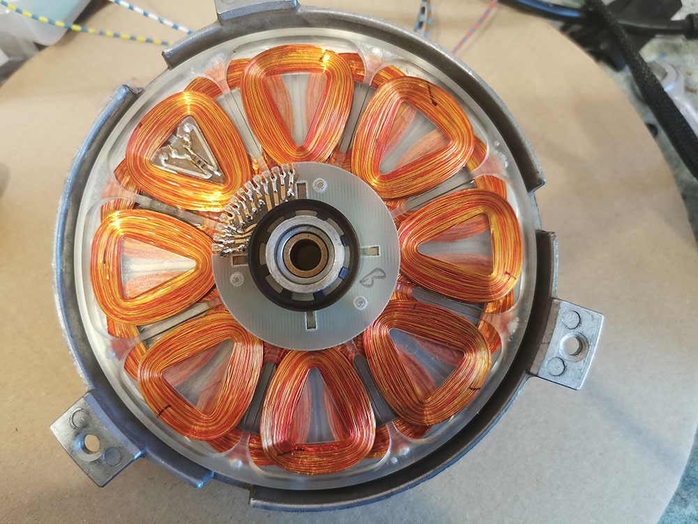

I have recently acquired a 701 and have some concerns with the EDS1000. I have an internal rub over a small arc when rotating, coming from inside the motor assembly, audible from a meter back, and I have out of balance on the motor rotor. I have found that the rub can be removed by adjusting the height adjuster screw in (up) by about 20 degrees - but I haven't tried to run the motor in this configuration yet. On the out of balance I found I needed 14g of blue tack to rebalance (onto the edge of the subplatter). I am tempted to open the motor up to investigate this but would really appreciate some opinions from the knowledgable folks here first.
Its probable that the thrust bearing has worn a little, allowing the rotating part of the motor to come into contact with the coils. You can see if this is the case by removing the 2 screws holding the adjuster in place. The ideal position is to have the assembly as close together as possible without touching; if you can achieve clearance by adjusting the inner screw by 20 degrees, I would suggest between 30 and 45 degrees, then forget about it.

If you remove the bottom plate with the thrust bearing, you will see a circlip holding the shaft in place. If you remove that the shaft and rotating part of the motor will separate from the rest. You can then inspect the internals.
It's that easy? Looked to me as thought there is a plate underneath the coils that is pressed into the rotor drum (which carries the magnets above the coils). So I would have to prise the plate off of the drum. Also, there is the drive gear, just above the bearing, with a thread locked locking screw on it (that I cannot budge - will need to somehow apply some heat to it). Or am I wrong?
I've two motors, one with just the shaft, and one with a gear (that's from my 721).
It's still a matter of removing the circlip, but also the gear 🙁. You may have to take the screw out quite a way, there's a flat on the shaft
And just as an aside, if the thrust bearing is too low, instead of the magnet touching the coils, the centre bush touches the inner casing, so no risk of damage to the coils. 🙂

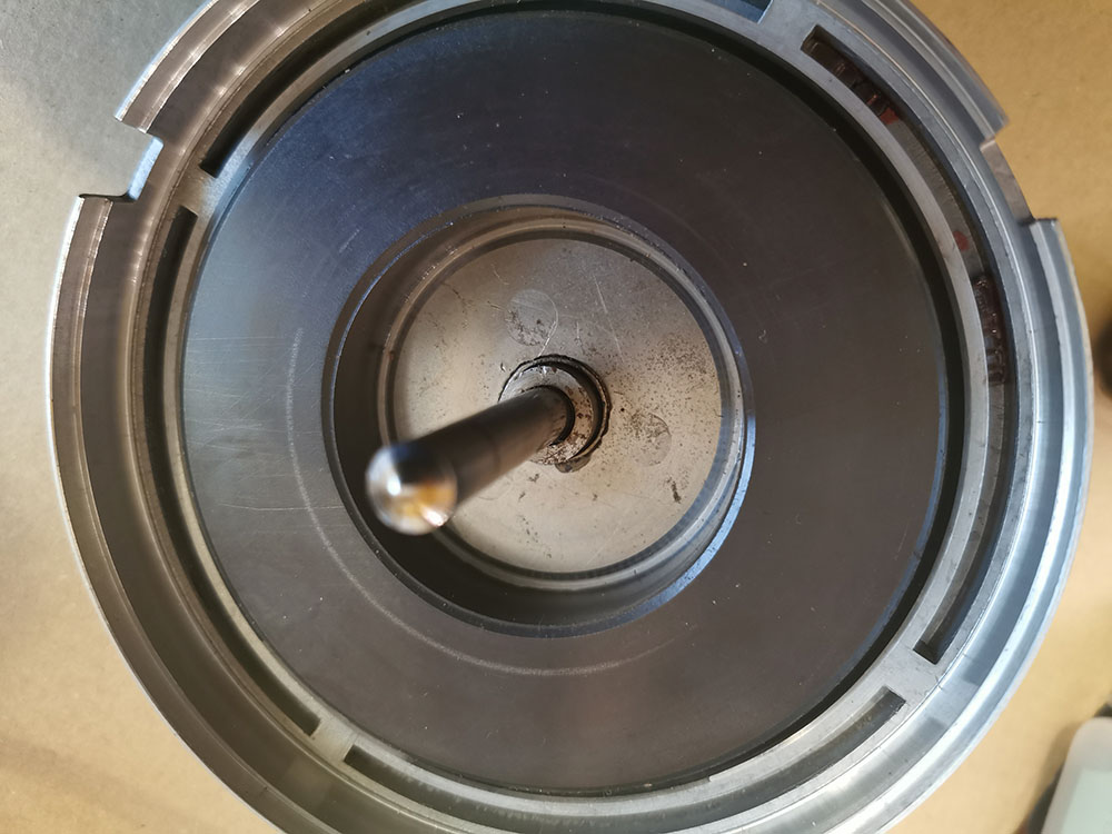

I lifted the bearing cover, the black lube was almost crusty, the thrust plate has a kind of teflon surface with a small dimple in the centre. Removed the drive gear after heating the grub screw with a jet lighter. The circlip was a tough job. Then came a thin washer that retained a tight washer that seems to be an oil dam for the journal bearing. The rotor did not lift away though, held in by the plate that is under the coils (that I mentioned above). It seems that is held in place by the magnetic pull from the ring magnet. I have stopped here for tonight. The grip of the magnet is very strong. If I slip separating these parts the the magnet could pull the ring back onto the coil assembly in an uncontrolled way. Looks like I need three clips to secure the plate to the main body, access for those through the three notches. Need to figure out a method. How did you manage this ralphfcooke? (thats me for tonight though)
Ah, now I see the post from Veeren (whats going on here), answering some things, thanks for that! So the coil assembly will take the load of separating the magnet and the plate, good to know.
Looks like balance weights to me, pushed into the slot, outside of the magnet, at about 2 o'clock and three o'clock.
I suspect that it's not the magnet stopping the rotor from detaching, but a very small amount of interference where the circlip groove is machined. The first time I took mine apart I used a small piece of 2000 grit wet-n-dry to polish around the groove.
Make sure you re-install all those parts in the same way after cleaning and re-oiling the bearing/shaft. (30Wt motor oil is good)
Except, flip the teflon disk over to it's fresh side against the shaft.
