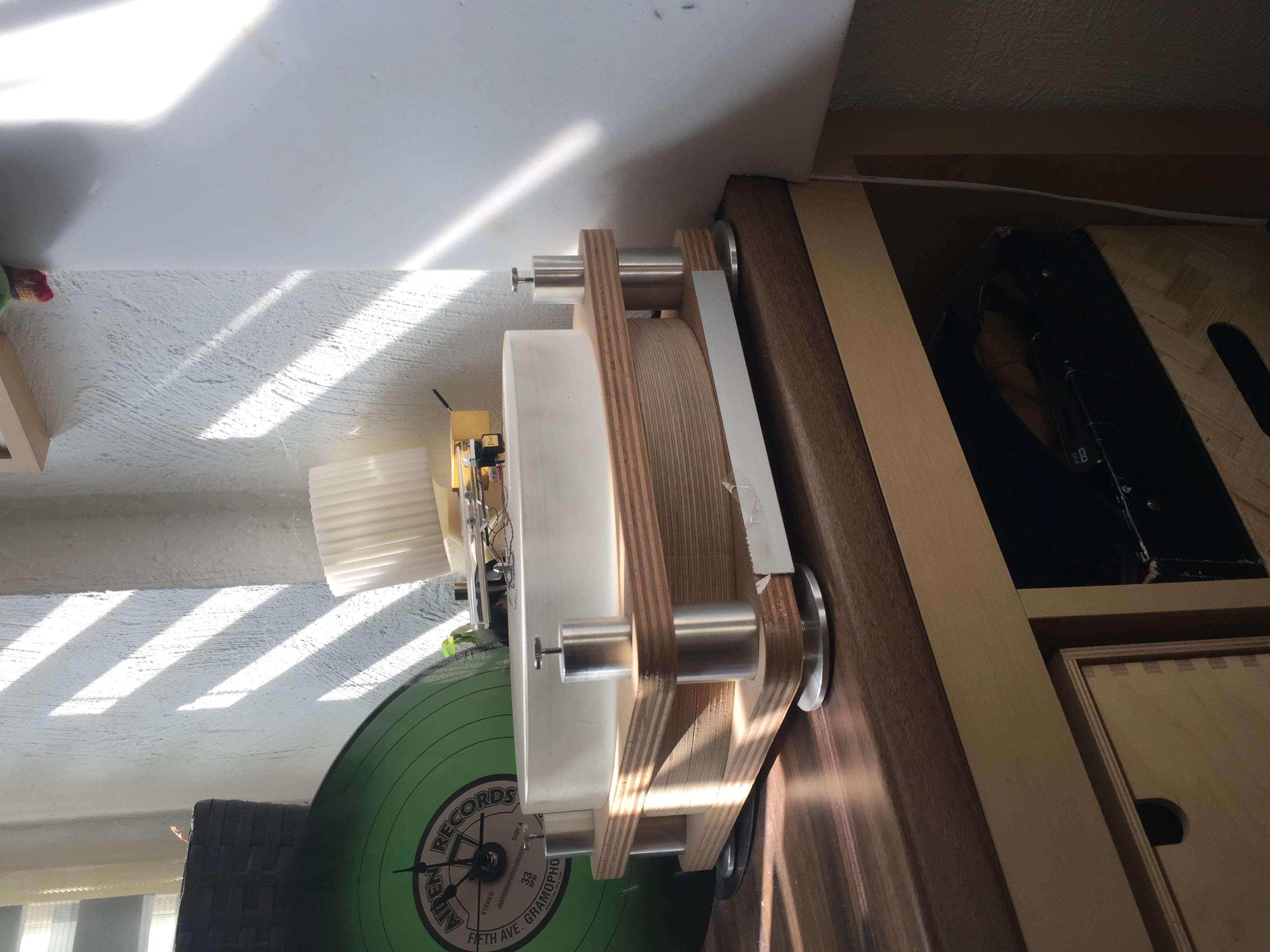

Hi Kay, the outboard motor stands outside of the turntable and drives the platter with a nylon string from its pulley.

Dear Kay, perhaps I was not clear.
The Scheu I had was using a DC brushless motor that works on the same principle as many DD motors.
Check out the Scheu turntables if you want to know more but I cant recommend them.

Perhaps Kay is assuming that since you used a DD motor, that they ALL run at platter speed, and not capable of any higher speed, such as for instance, 300RPM.
Direct drive is not a type of motor, its a type of mechanical power transmission. If its outboard, its not direct drive, pure and simple.
Indeed, agreed.
But what Veeren was refering to is using a DD "type" of outboard motor to drive a platter through a belt.
In other words, a servo/quartz controlled motor with a higher speed.

Hello,
Can I ask for some advice ?
I'm thinking about building a turntable using an EDS-1000-2 drive unit and I would like to use a heavier acrylic or MDF platter. It's weight is about 4 kg. Is that OK with the bearing ?

The original Dual platter, along with the weight of the "under platter" which is part of the direct drive motor, has been tuned (in the electronics) by Dual to achieve extremely low wow/flutter already.
This fine German engineering really should not be "messed with" by modifications such as you speak of.
The only thing I've done is to add a touch of heatsink grease to the several power transistors to improve their thermal contact to the aluminum frame and provide some additional reliability.
Also I've cleaned and added Super Lube with PTFE to the shaft and single ball bearing assembly under the spindle to insure silent rotation.
Of course, the electronics benefit from replacing the electrolytics and PS snubber caps after decades of aging.
Leave those small tantalum capacitors alone, unless they're obviously defective - I haven't see a bad one yet.
Hi wiseoldtech,
Thanks !
So I better go looking for an original platter. I don't want to modify for improvement, it's just I have a MDF platter, but no original one.
