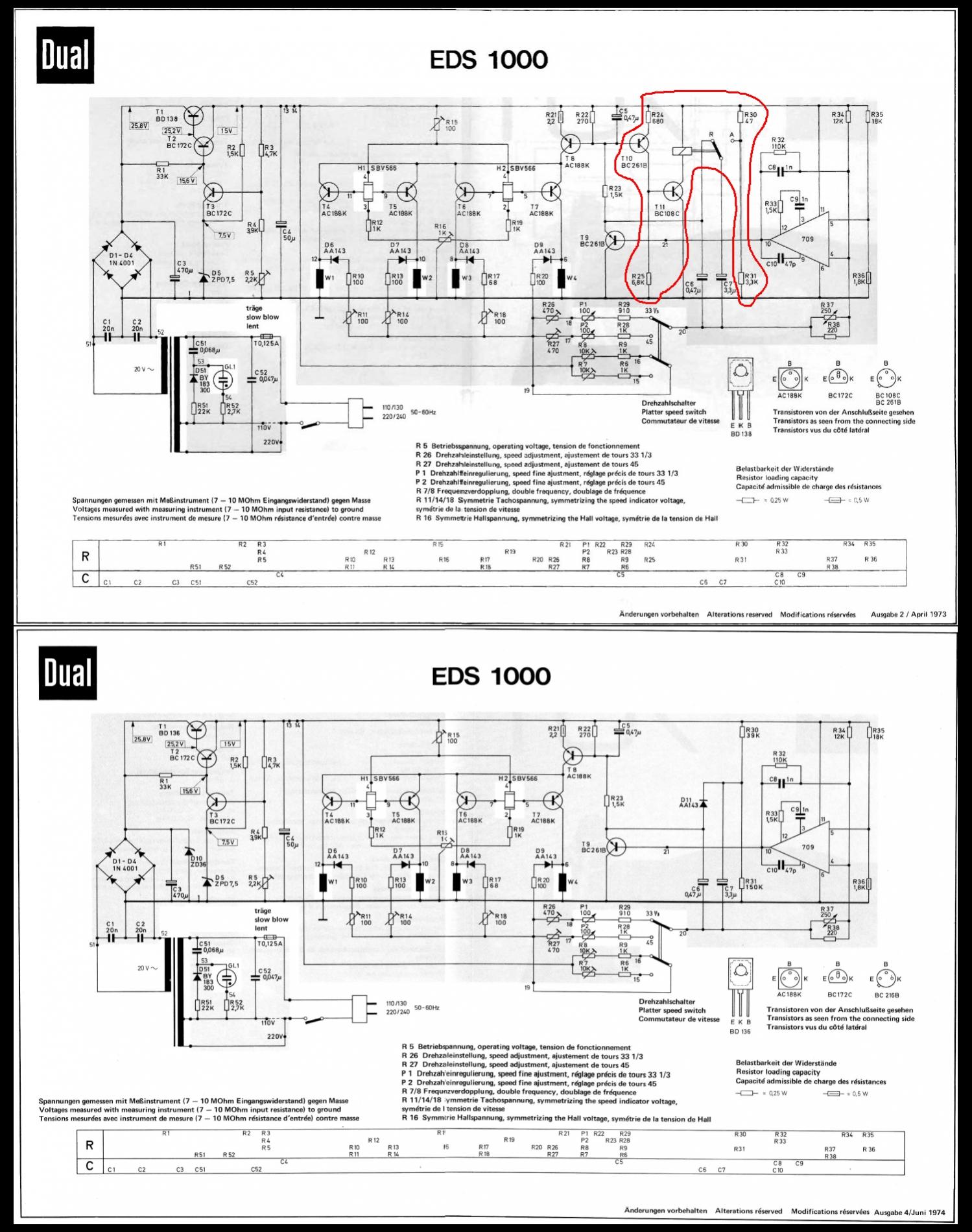

I think i found it:
You asked for 701 but the above schematic is for 721, which uses the EDS-1000-2 motor. Now you have all schematics for both models.

Thanks Kay Pirinha and wiseoldtech.
Any "improvements" on these motors is futile.
If you have a CS701 or CS721 be sure to replace the Rifa cap inside the transformer box, they short circuit in time from age!
They will take out one 110V winding from the transformer putting 230V
over the remaining 110V winding!
Replacing this T-former with a small 9+9V toroidal is a good idea in my view.
While in there replace the now hardened grommets that hold the box in place
with new or sorbothane ones, you will notice the difference.
To compare servo vs non servo listen to a SL1200 and a CS701-721.
If you cant hear the difference than it does not matter to you.
A better bearing, why the ones in there are fine, have a look at the CS601 platter bearings for comparison or a Ariston RD 40 etc.
Regards,Veeren
