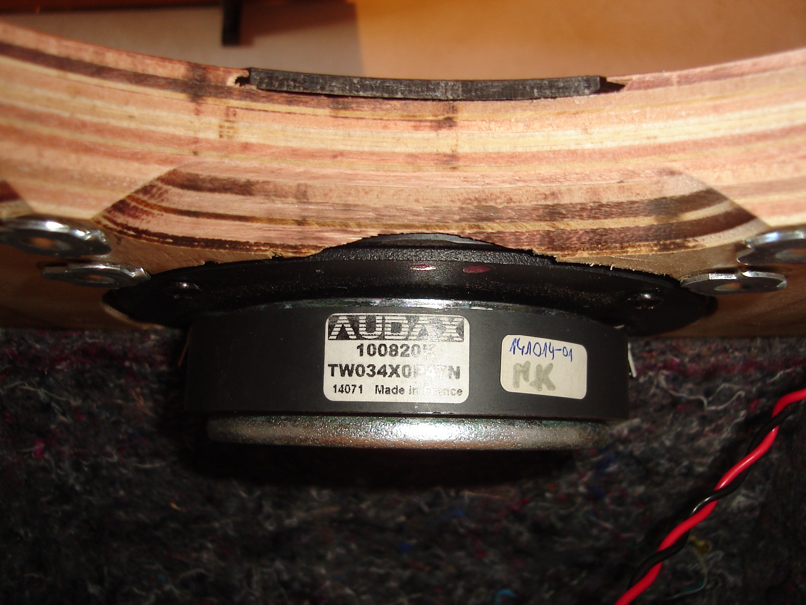

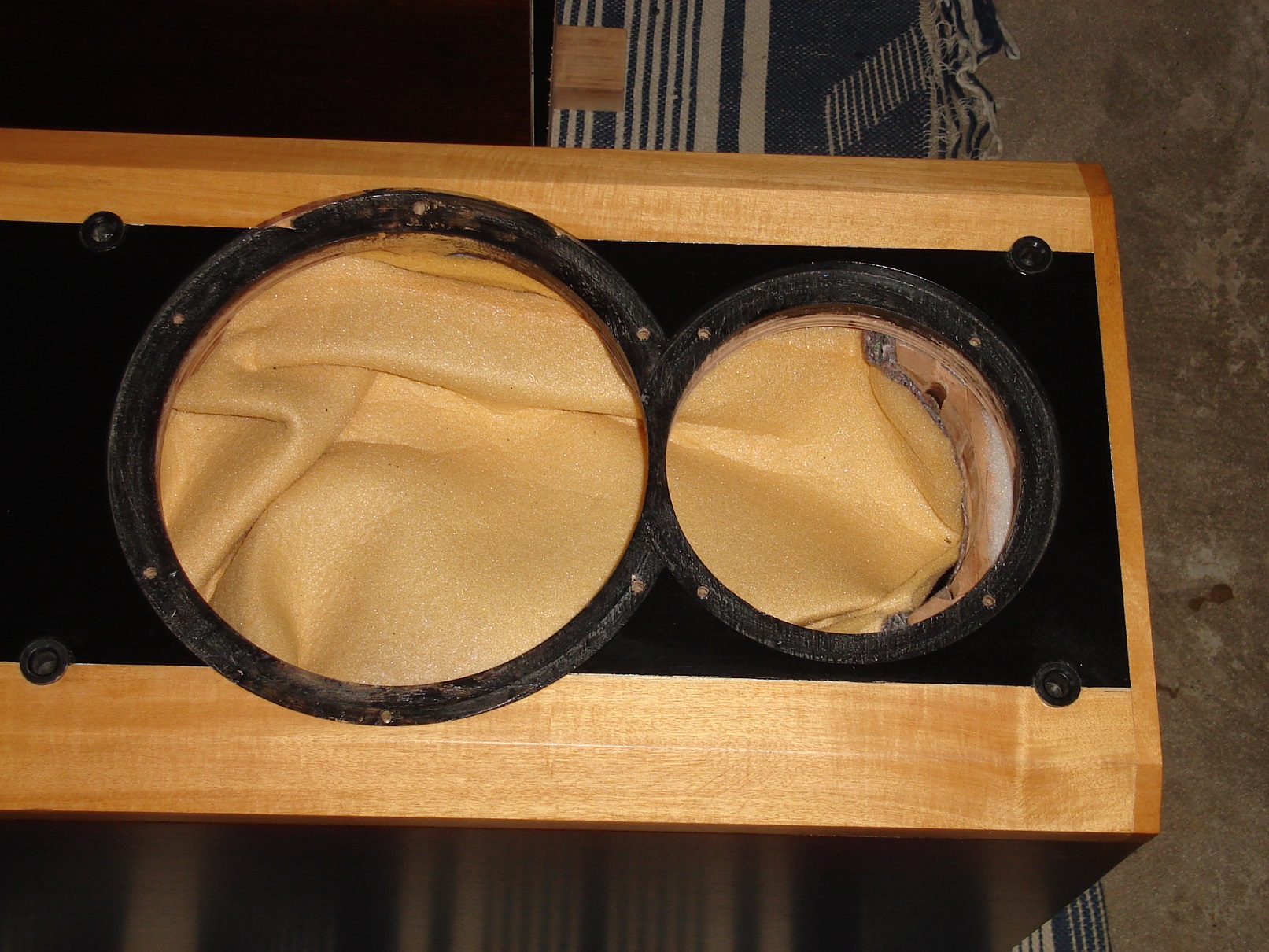

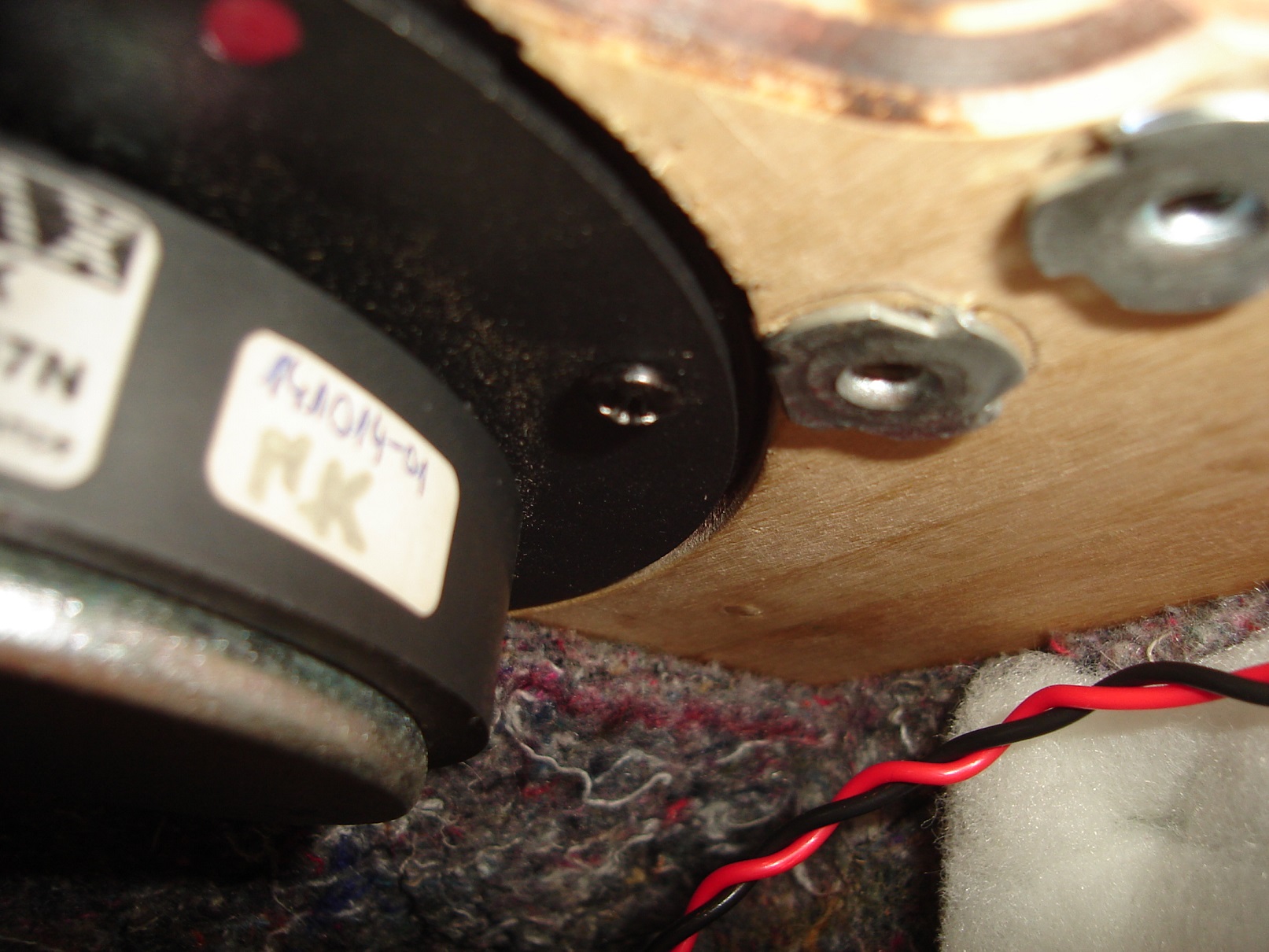

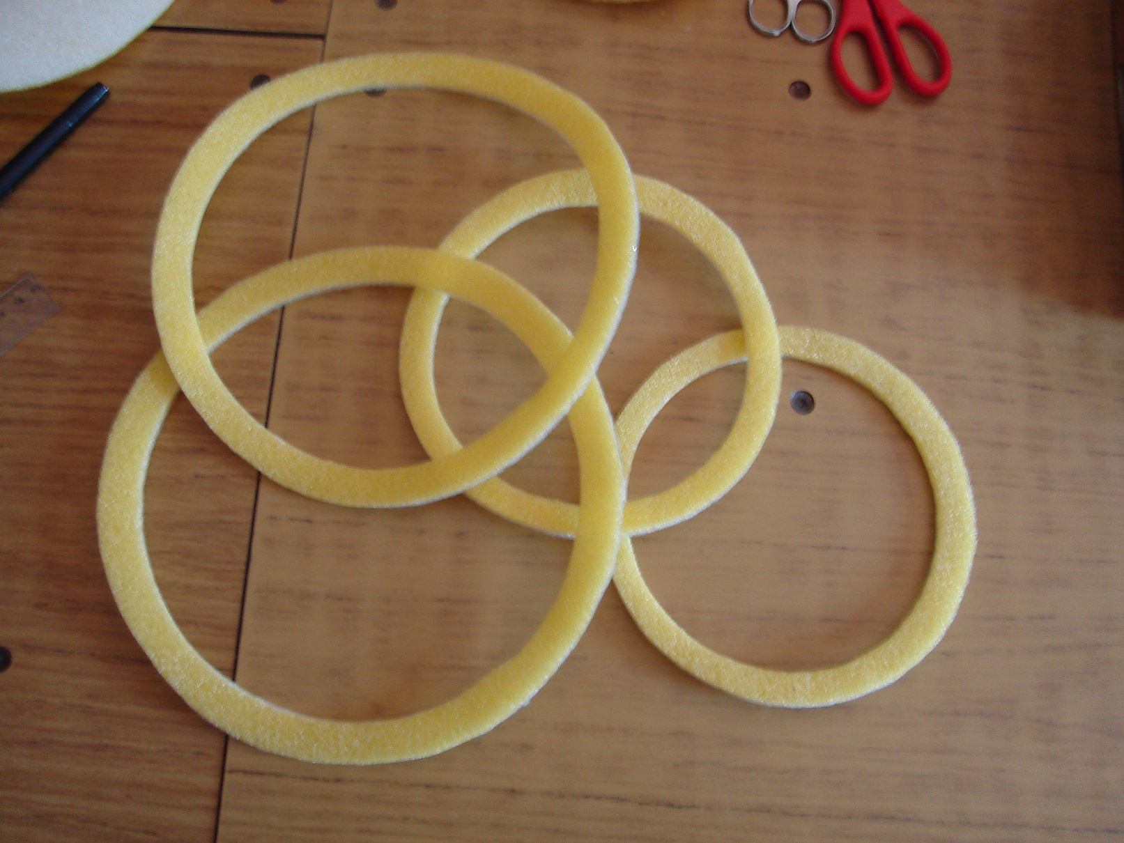

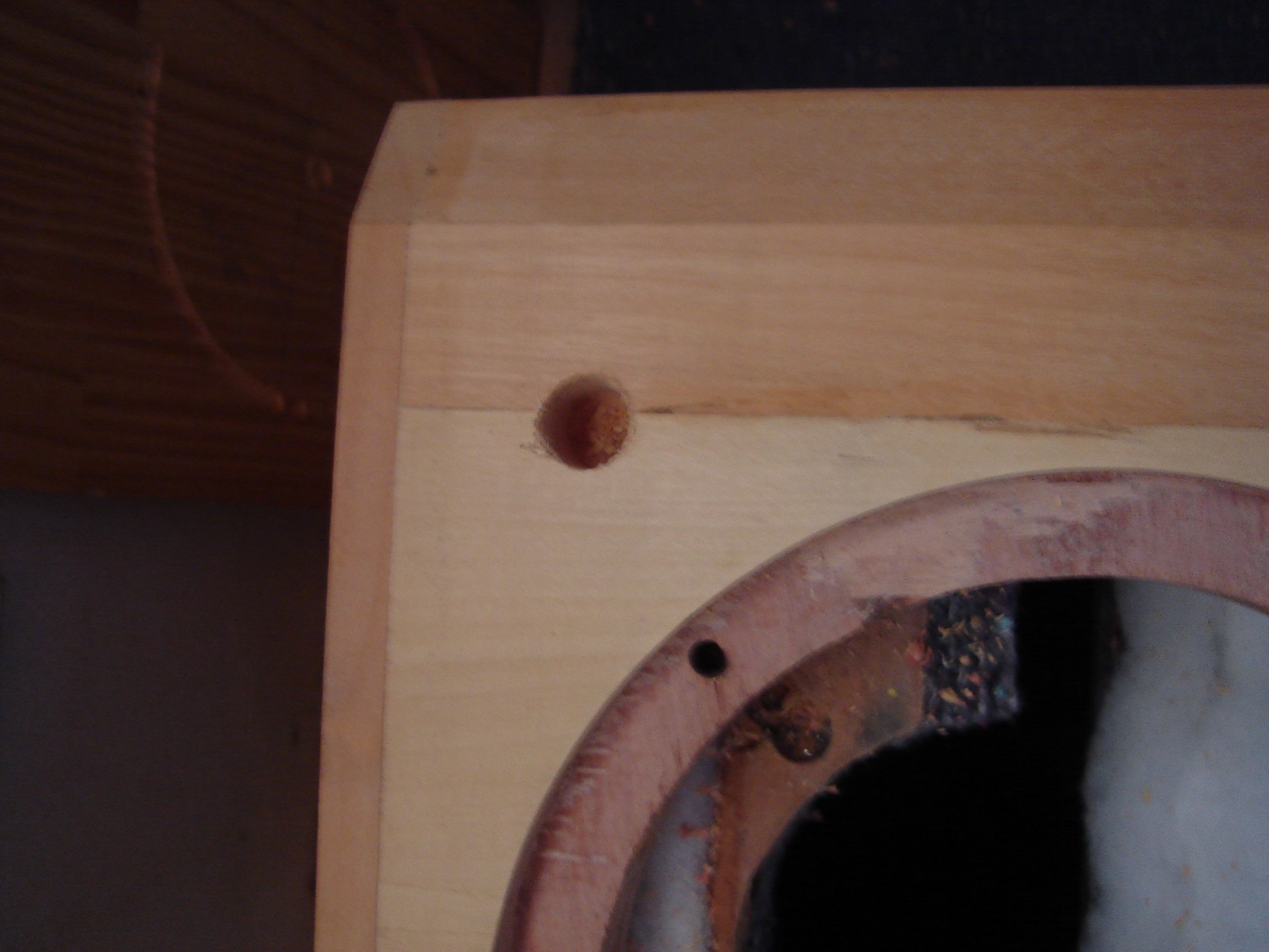

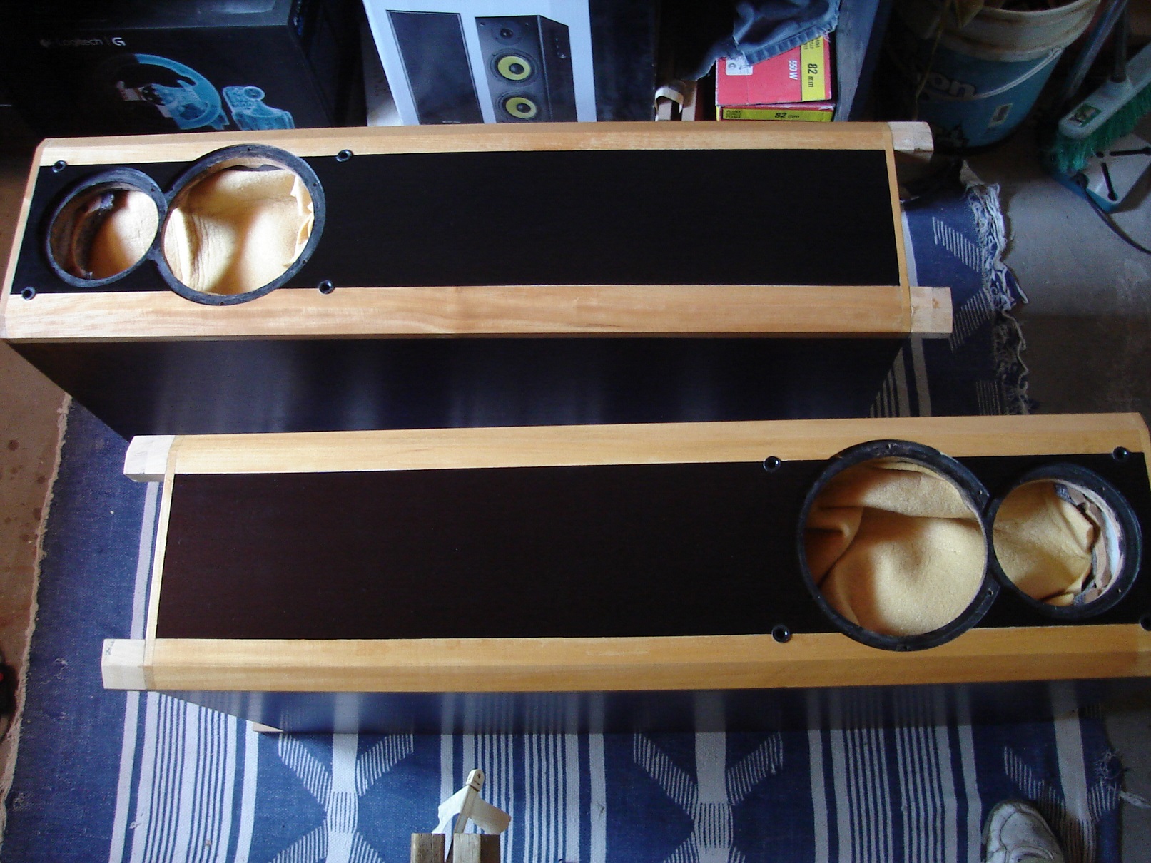

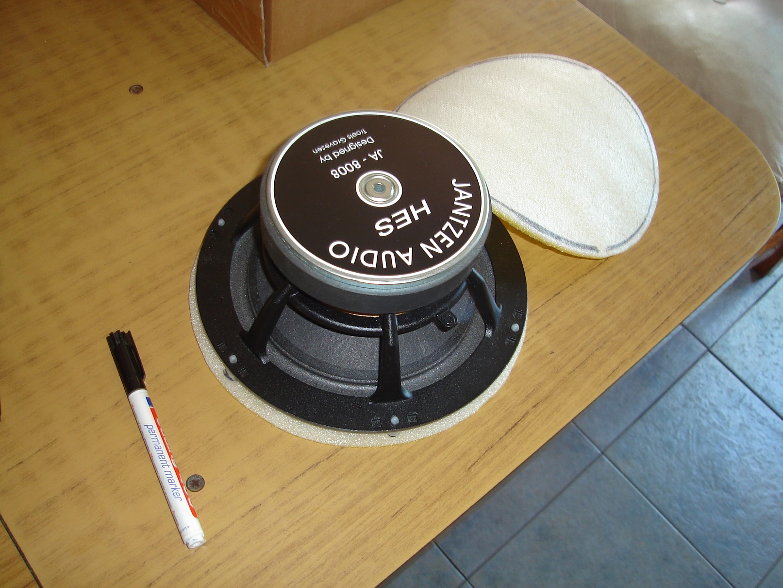

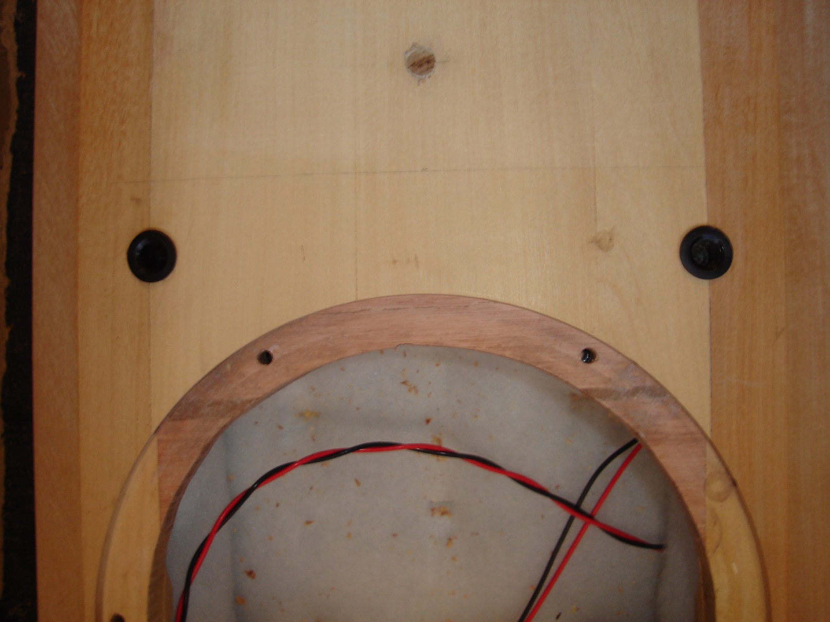

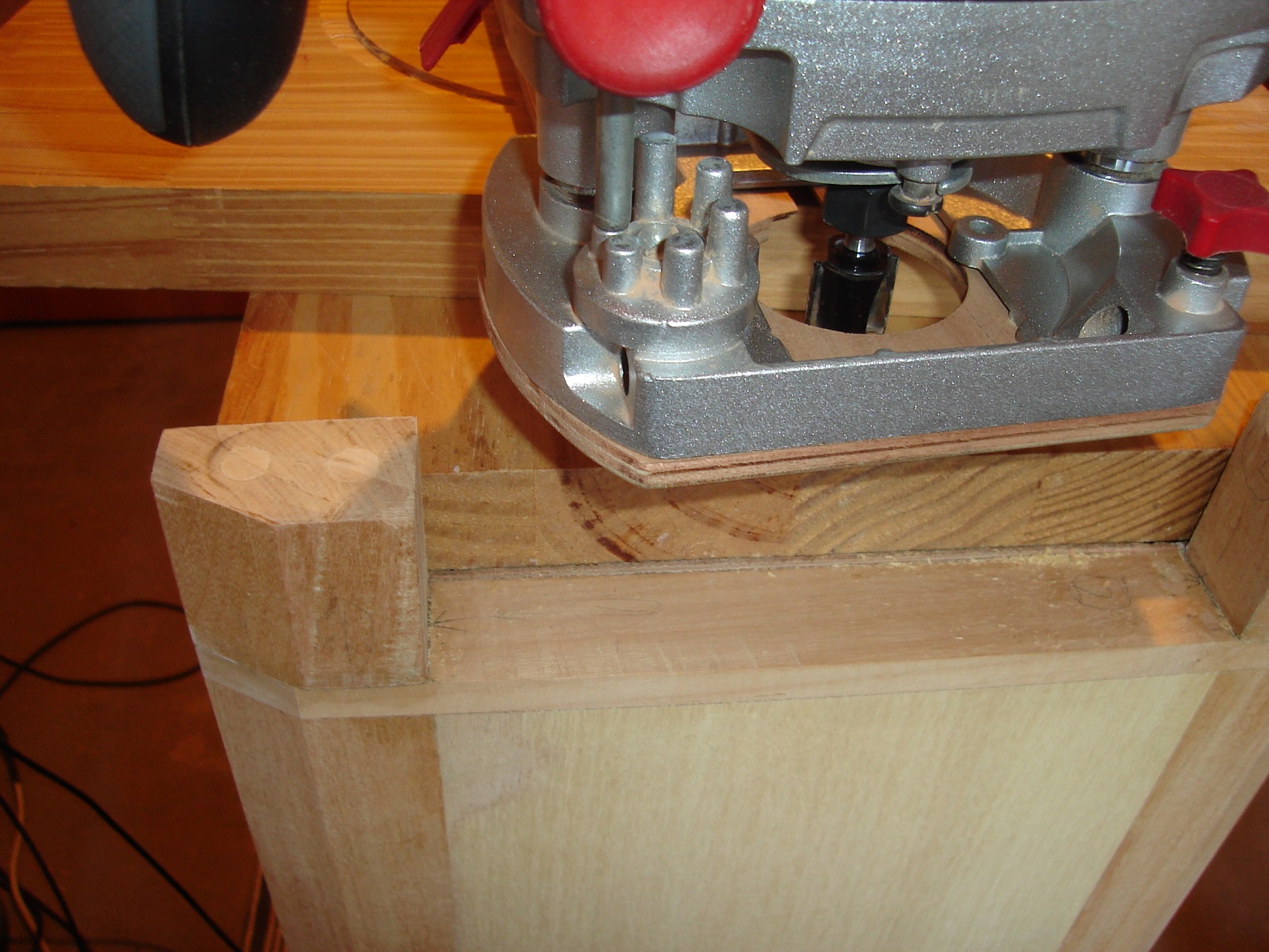

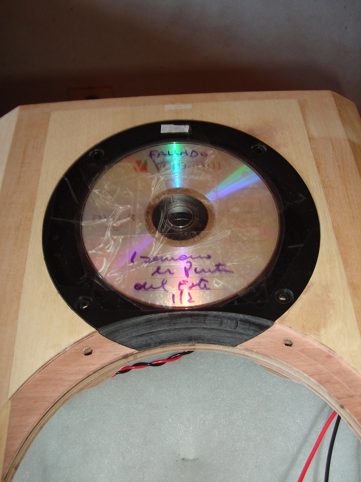

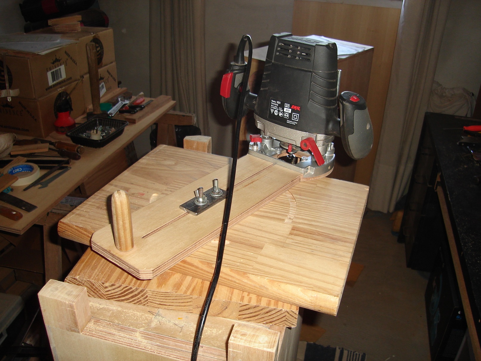

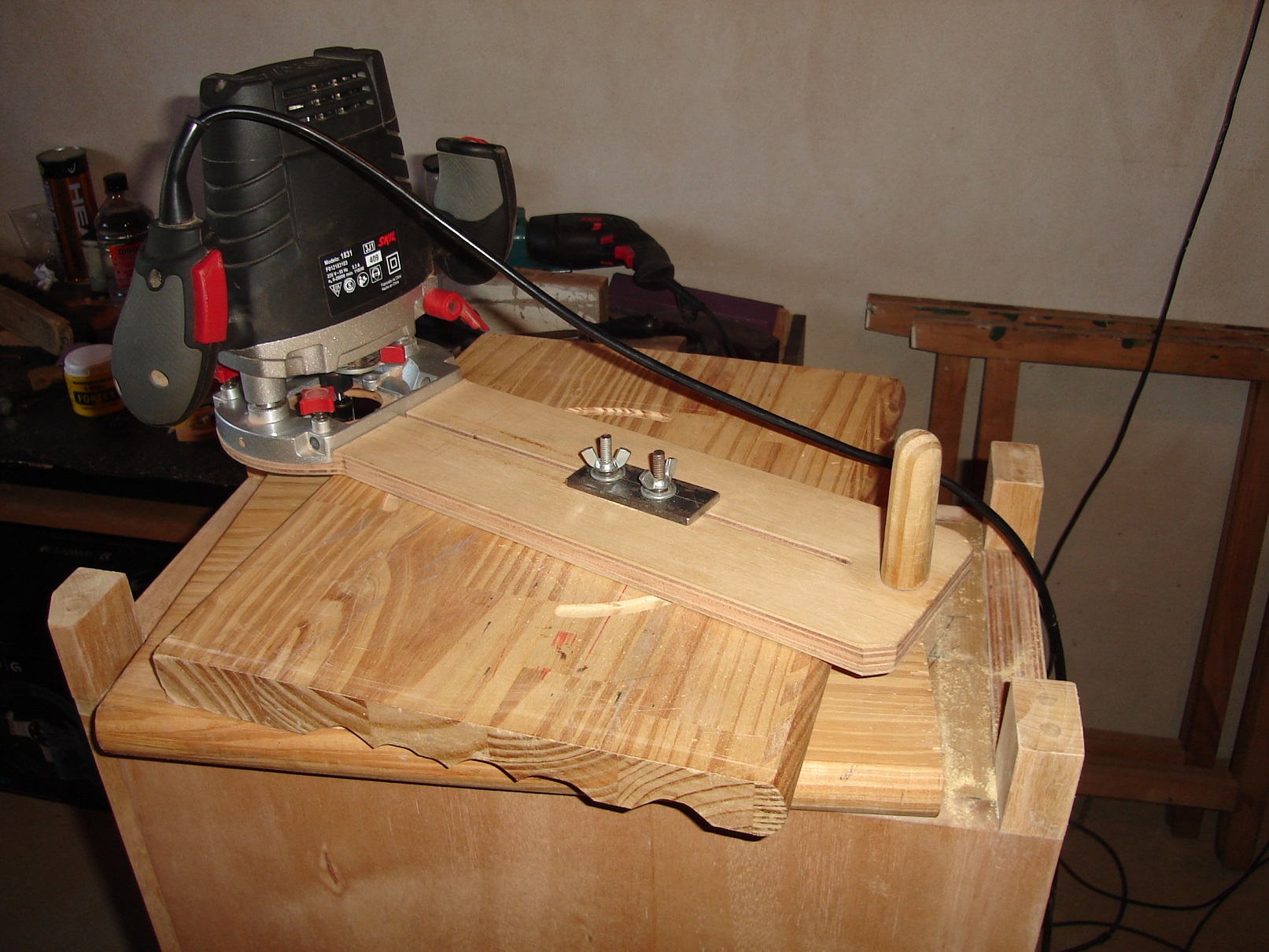

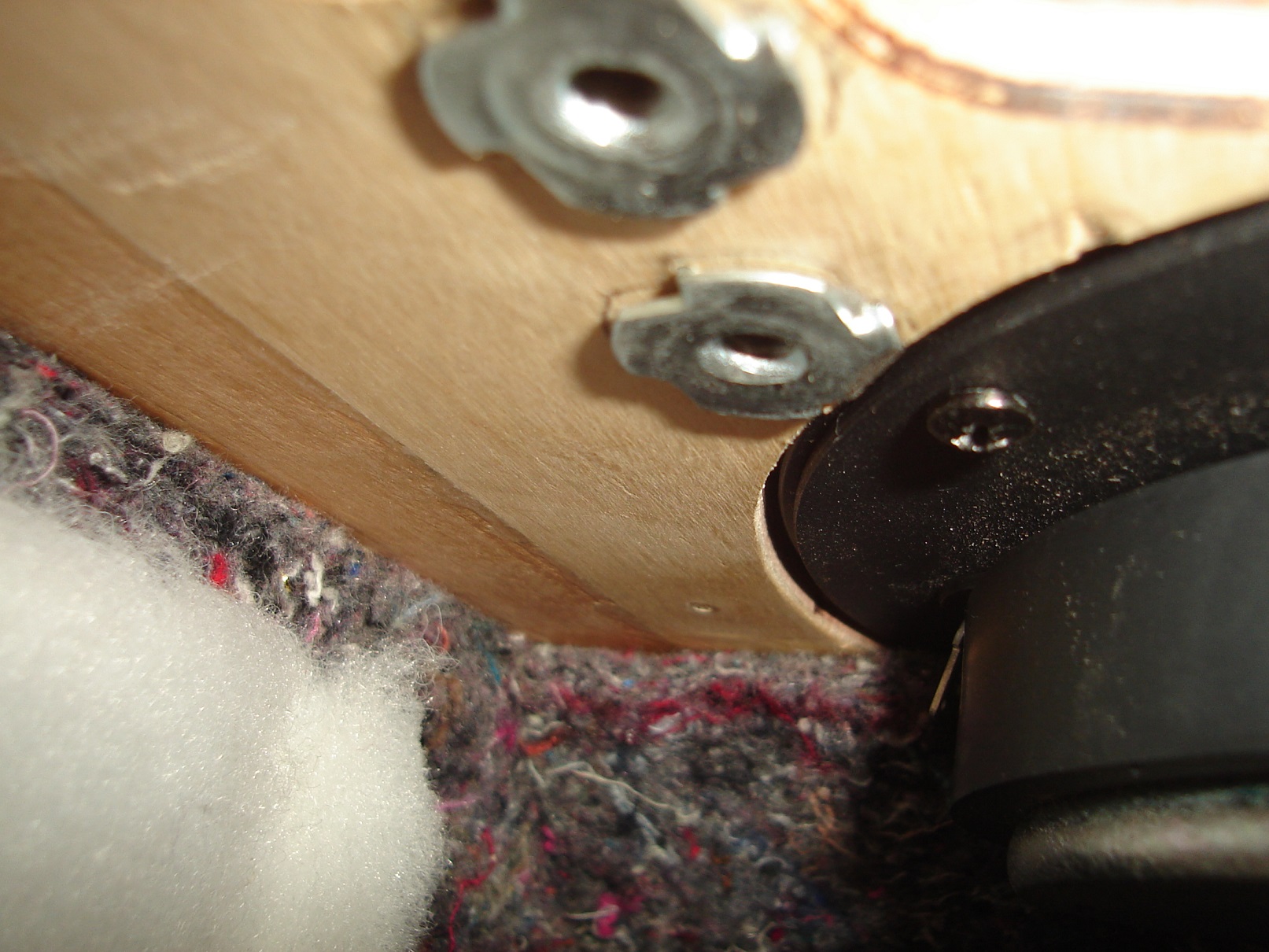

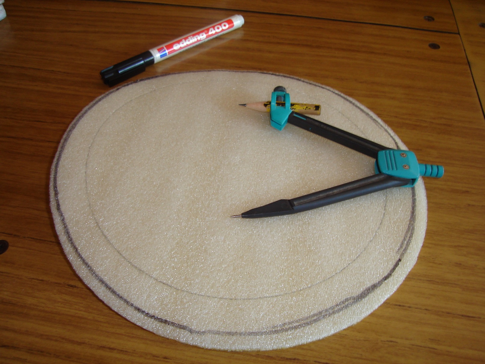

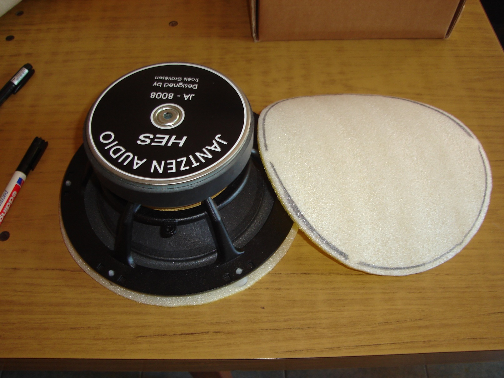

The tweeter set - waveguide seen from within. I have tried to adjust the housing as much as possible, the two upper nuts have somewhat complicated the setting, but with the router was fixed.
The protection of the dome is very important, the cd fits right here....😀

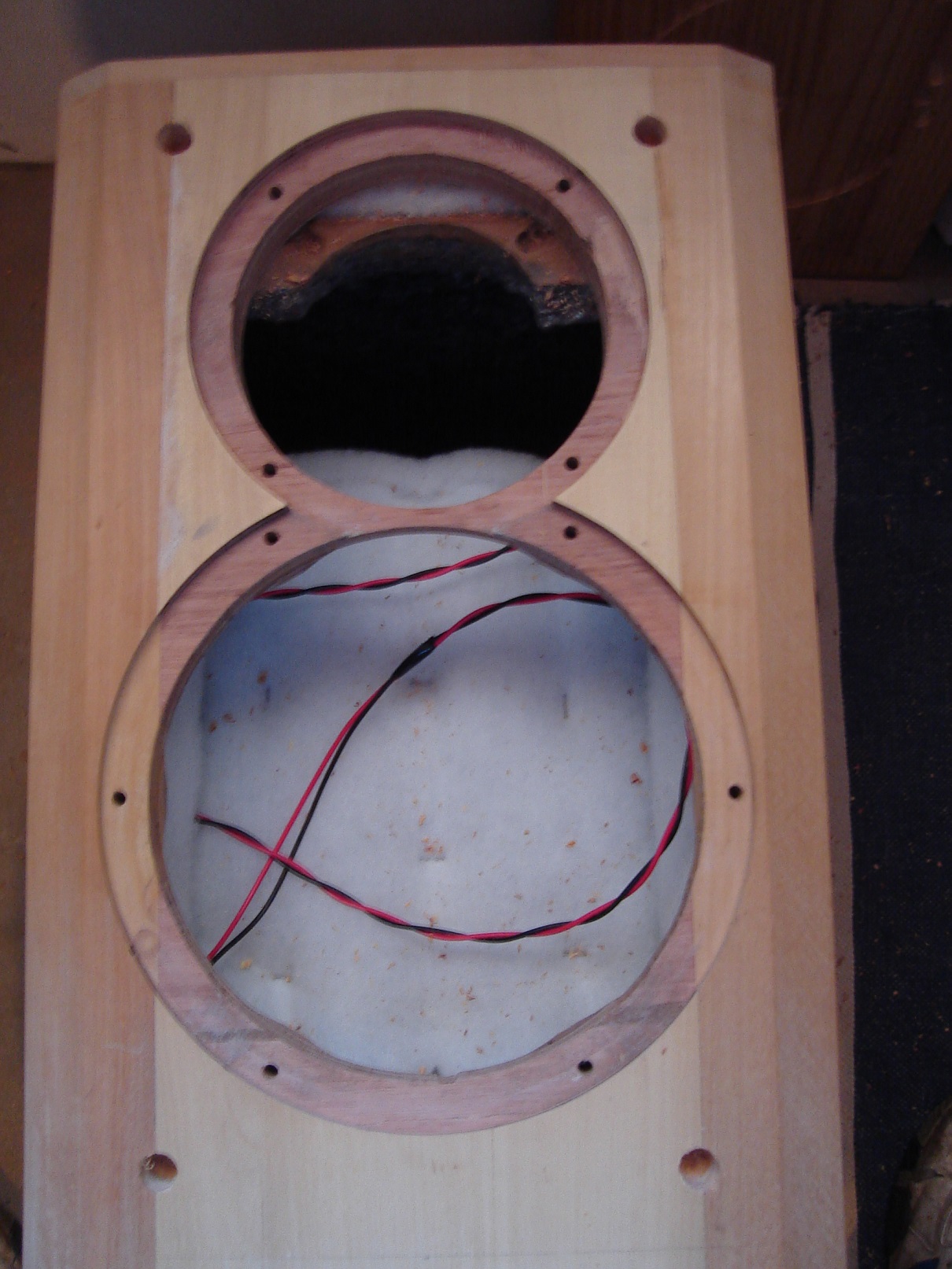

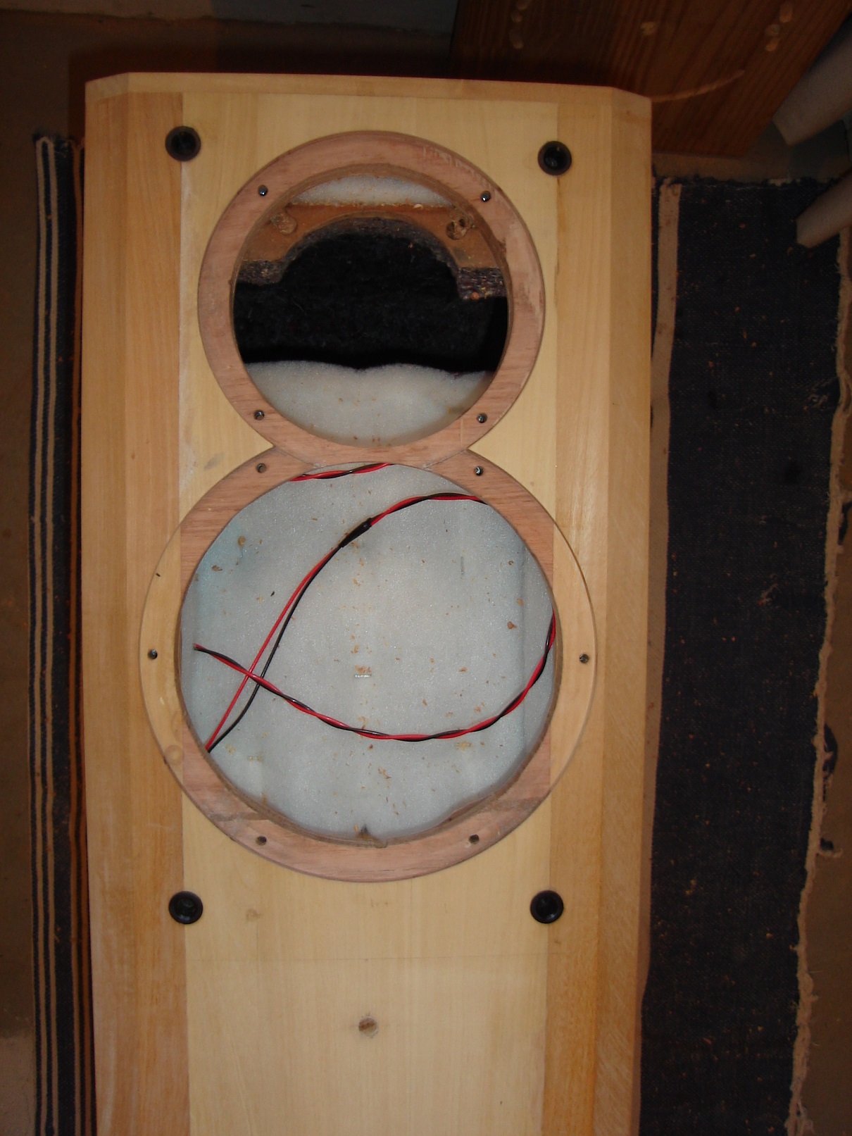

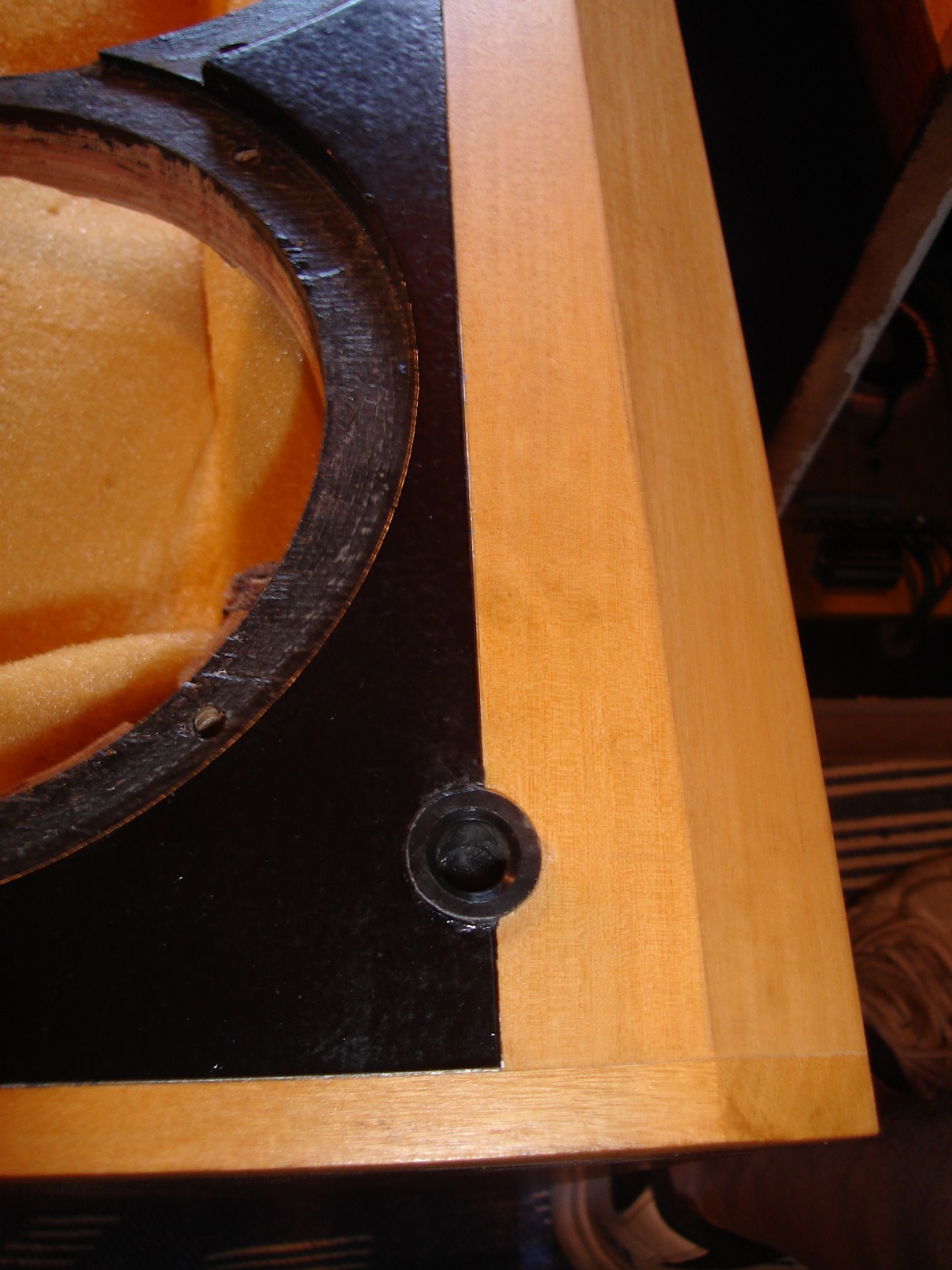

The alignment of the baffle step will be adjusted with the joints I have made. The material is excellent, these are "under carpet" folders.😉
Allows an exact adjustment by varying the adjustment pressure of the screws. When you reach the desired depth for a perfect alignment (it's about millimeters) do not press it any more...😀

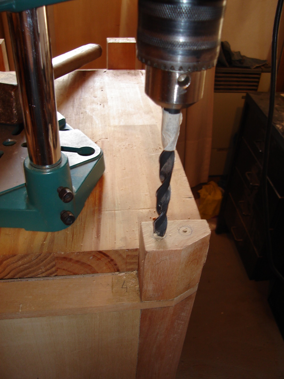

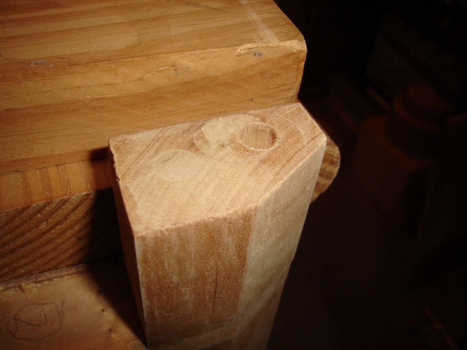

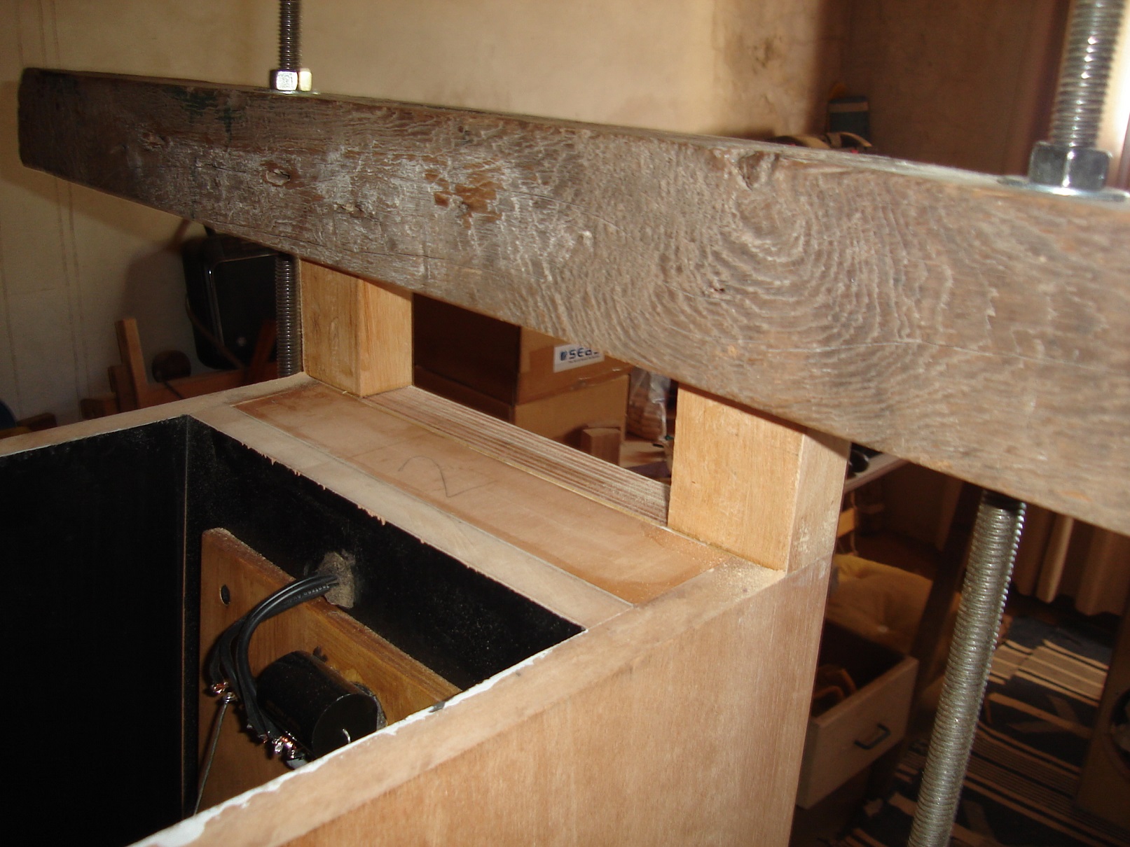

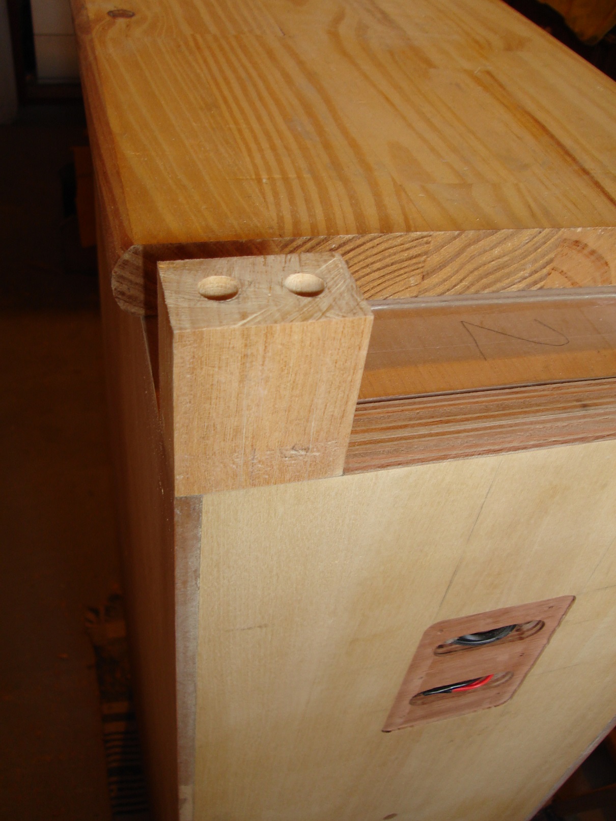

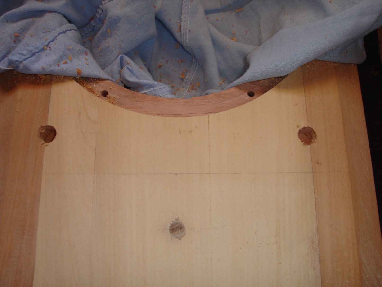

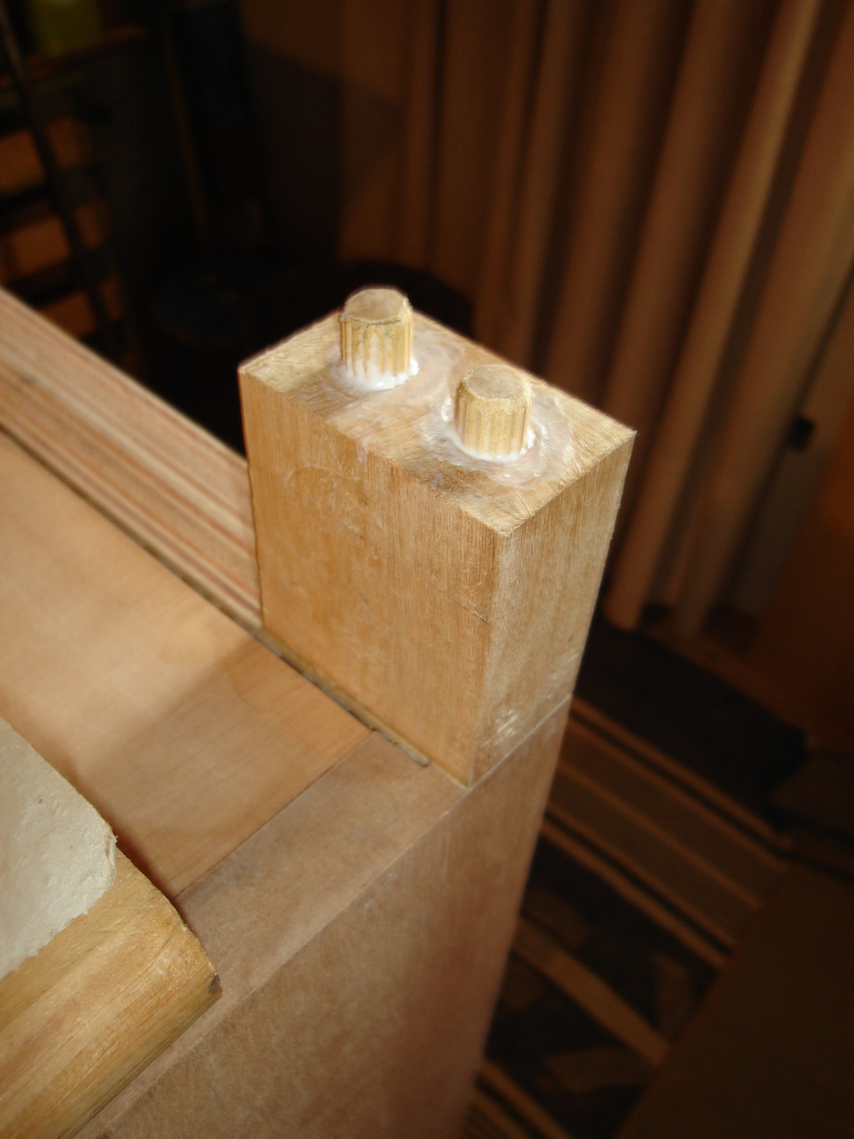

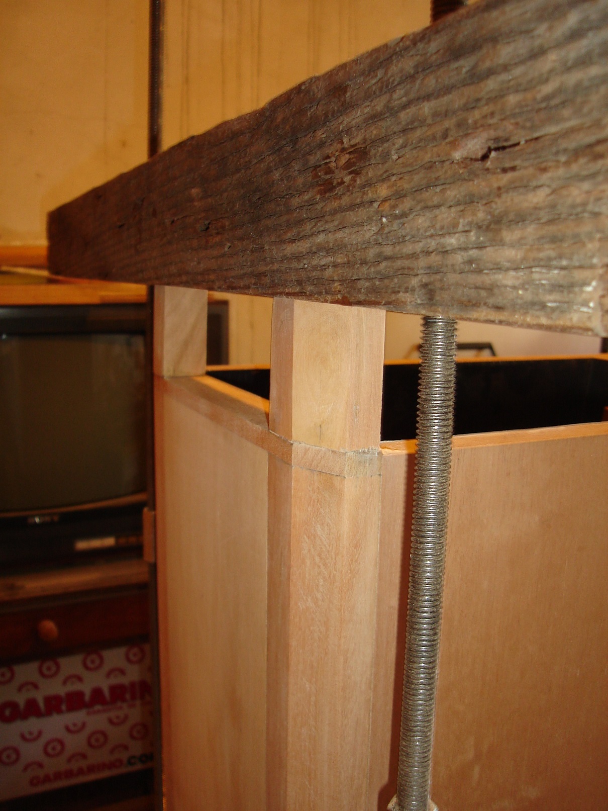

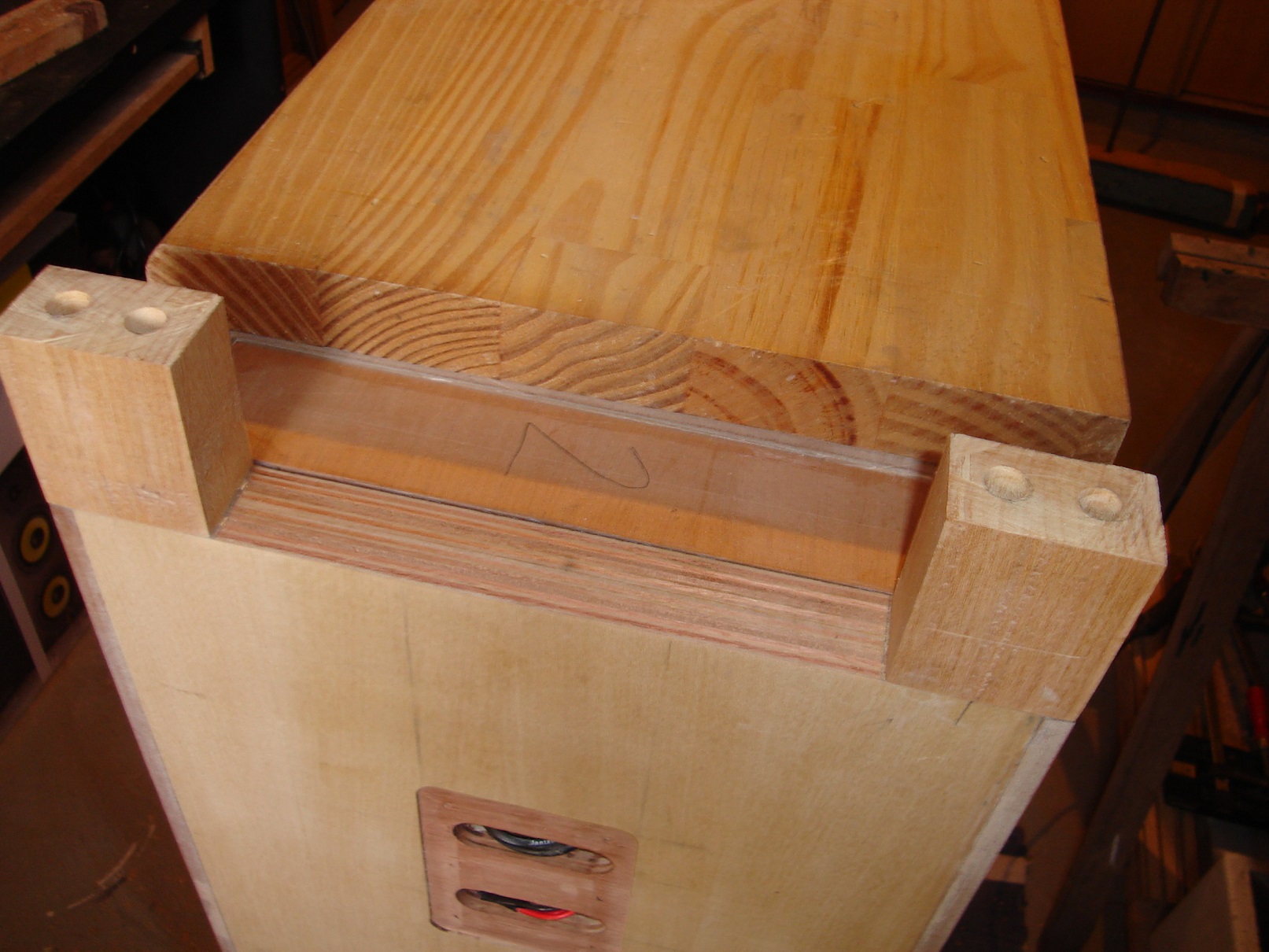

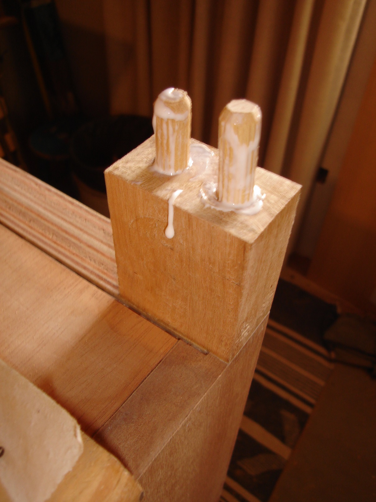

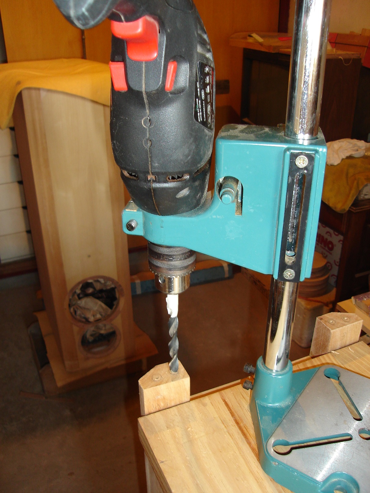

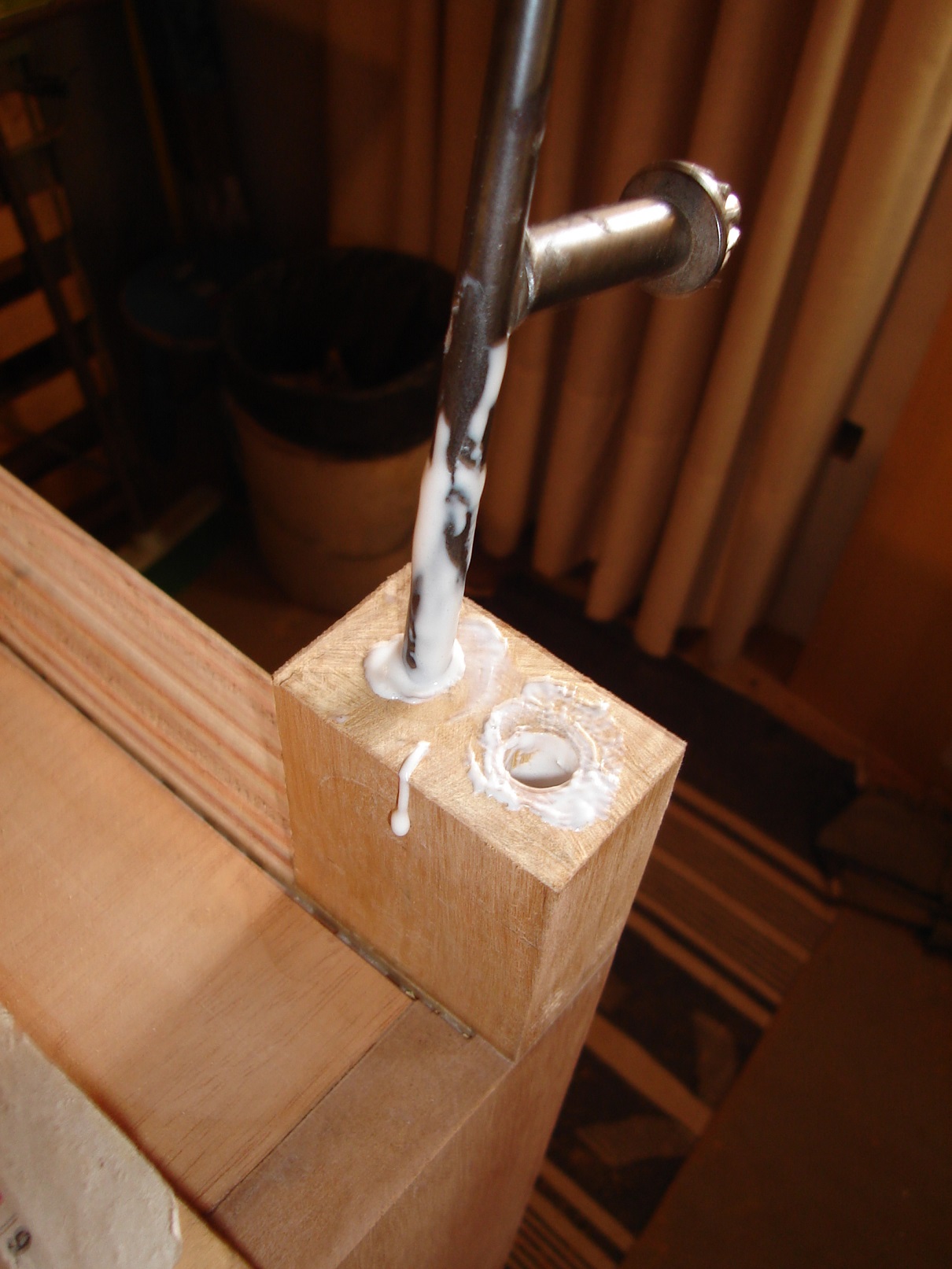

Gluing the cabinet feet.
Once the vinyl glue is dry, the feet will be reinforced with dowels...🙂
I could have used screws and then removed them, but doing it using my home presses seemed more fun .....😀
Remember that I promised myself not to use screws throughout the building. I only accept those who squeeze the speakers. 😱
Question of principles ! :mischiev:

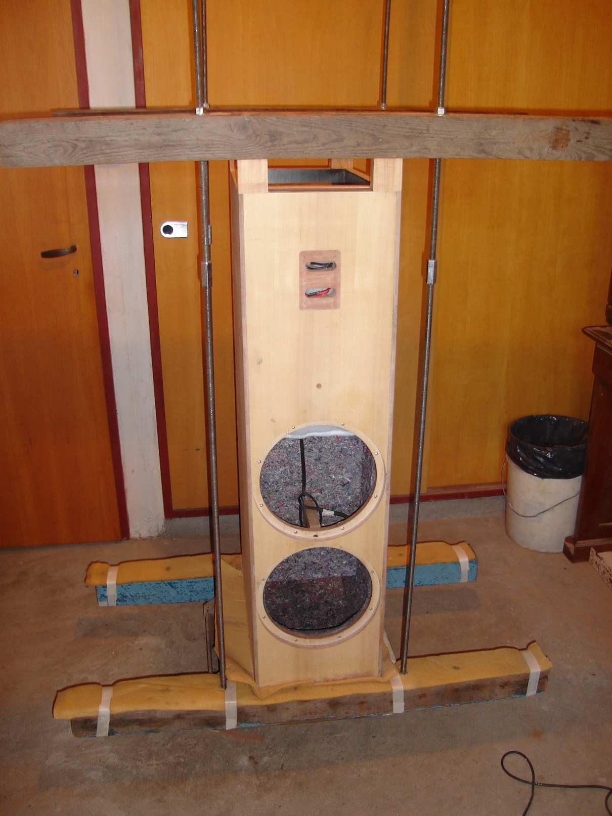

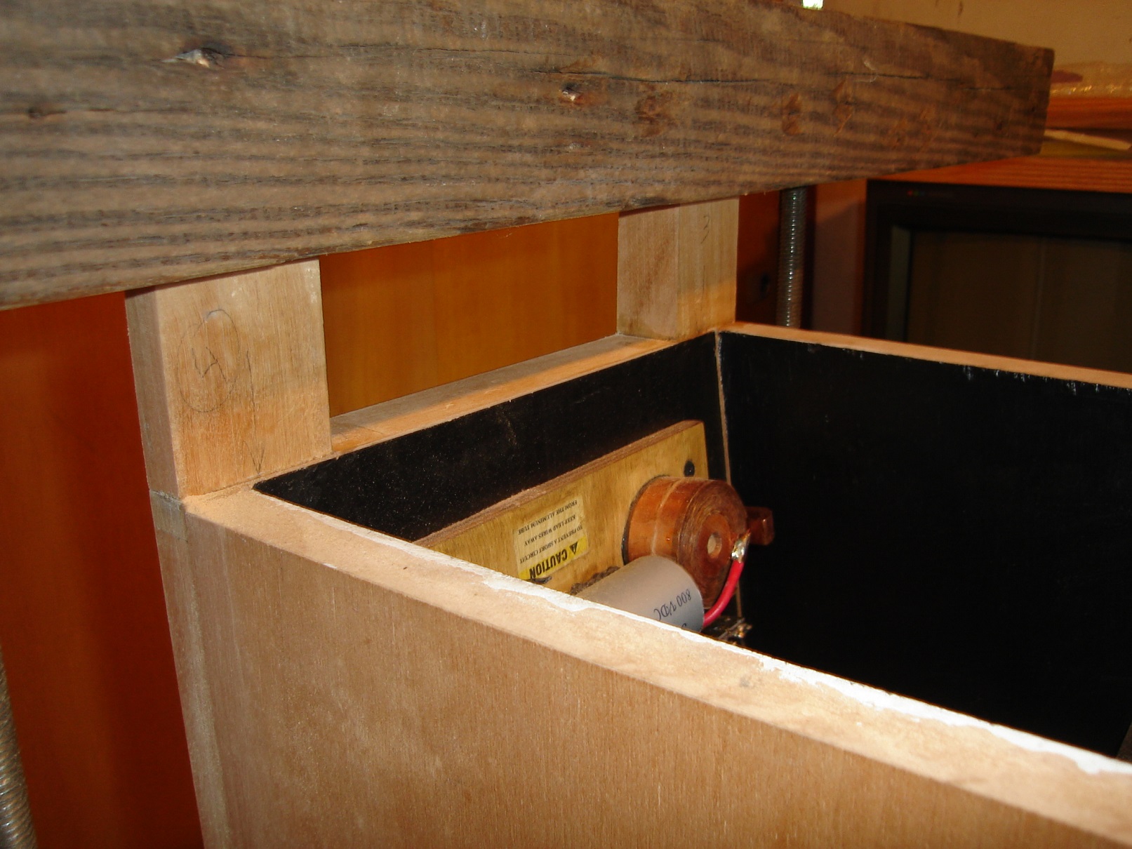

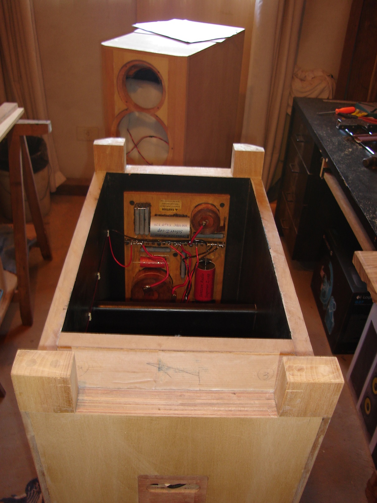

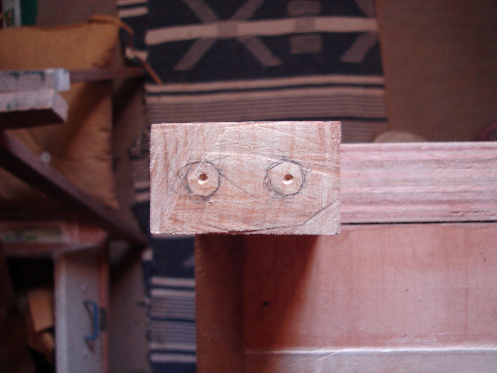

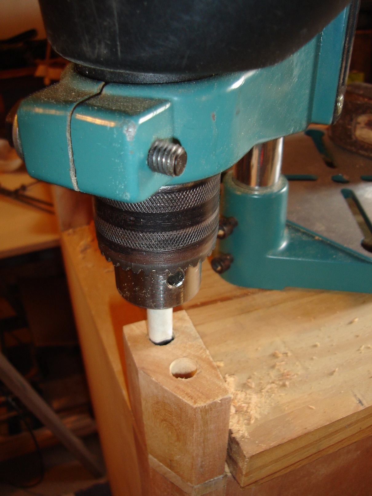

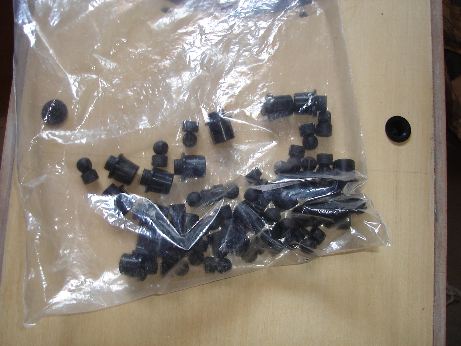

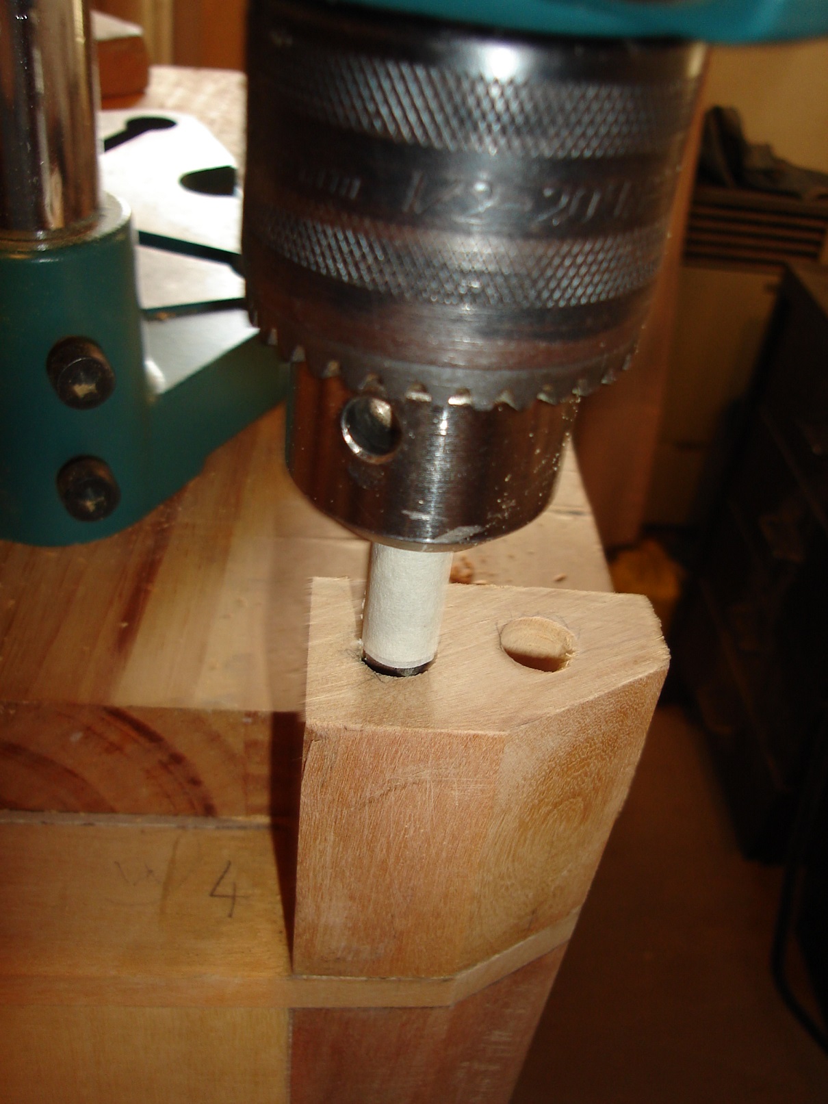

Each foot will be trimmed to 50 mm, 10 mm will be inserted into the table that will base as wheels.
This frees the recommended 40 mm of charge at the mouth of the horn...😉
Each hole carried three billets. The tool to introduce them one at a time is very difficult to find...😀
Today there is a photo festival !! 😛

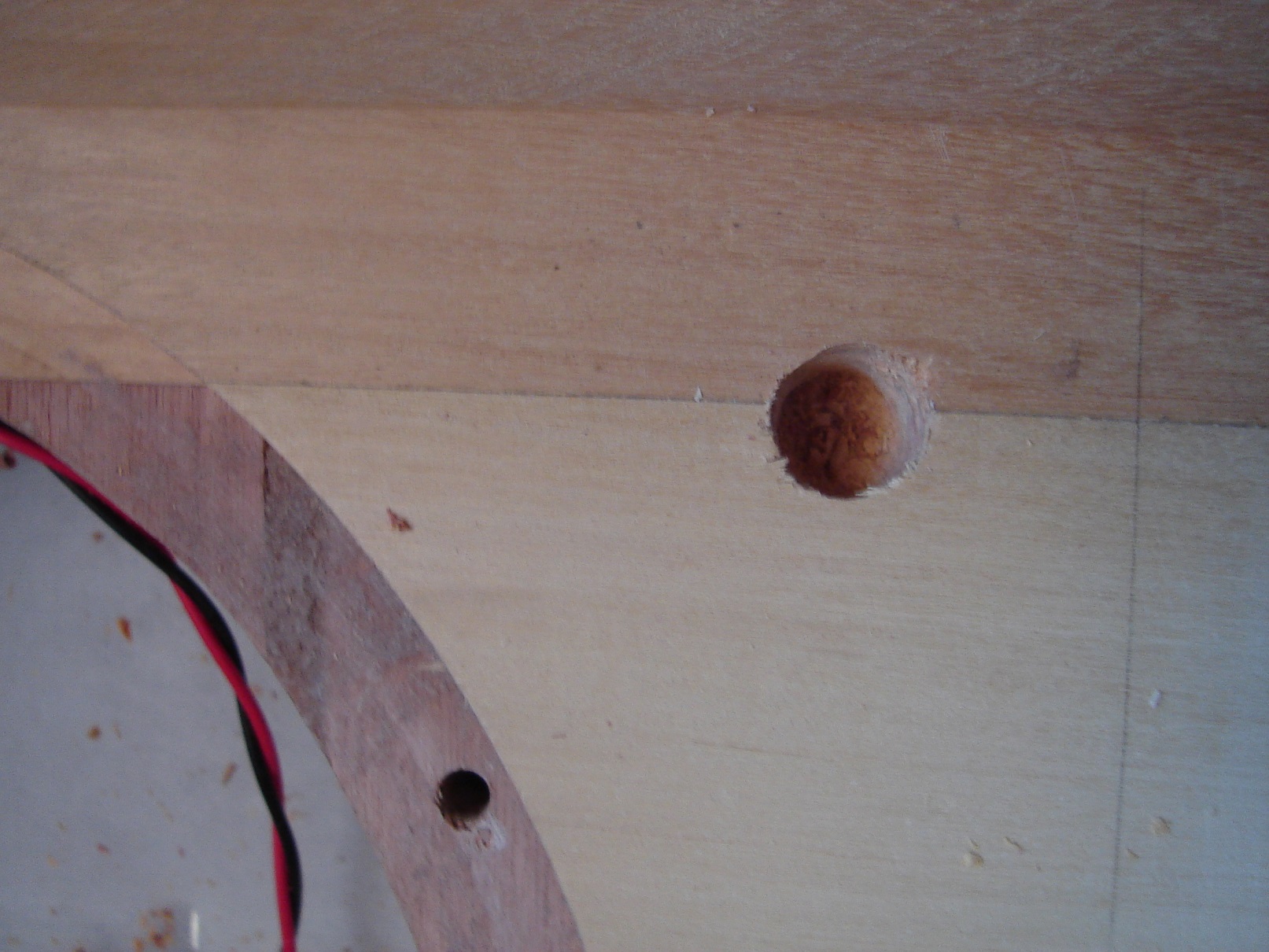

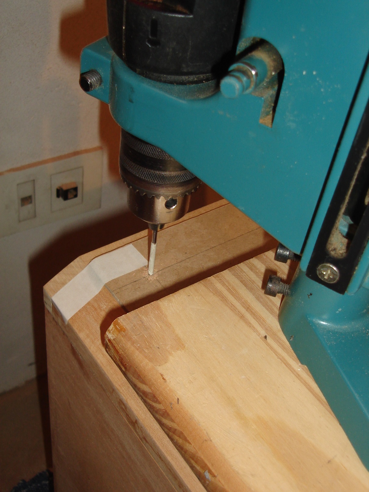

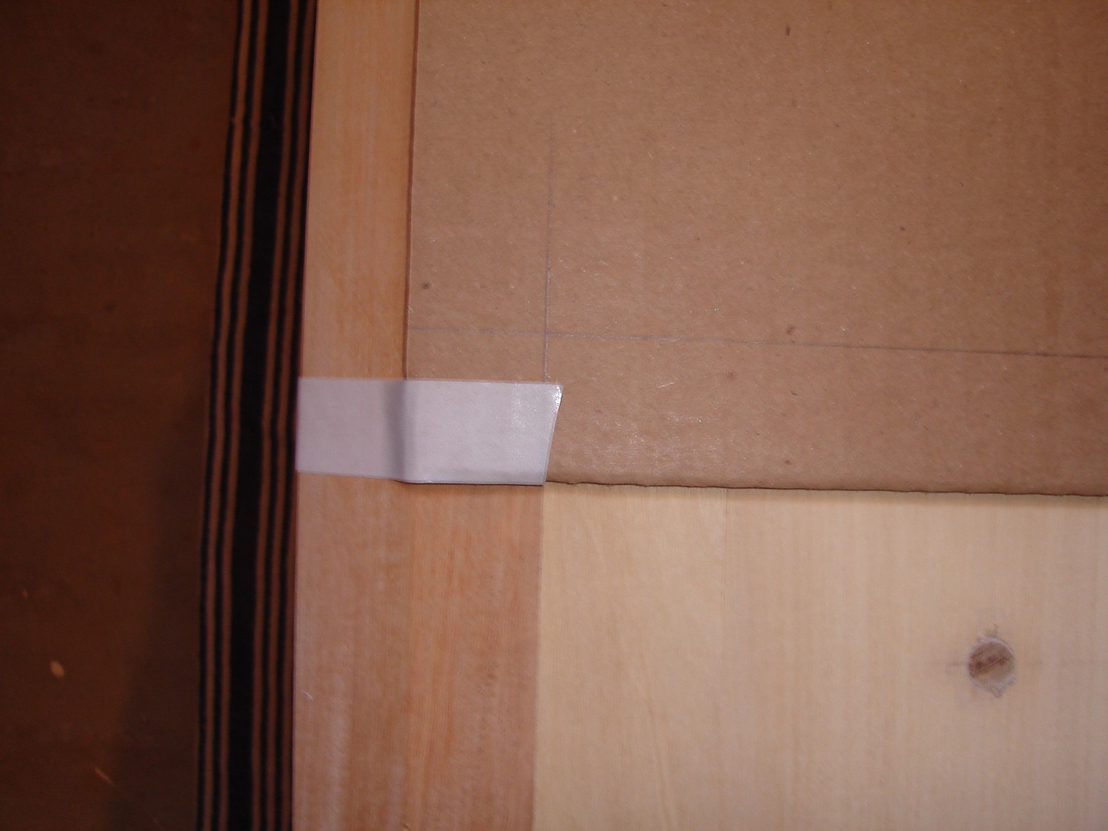

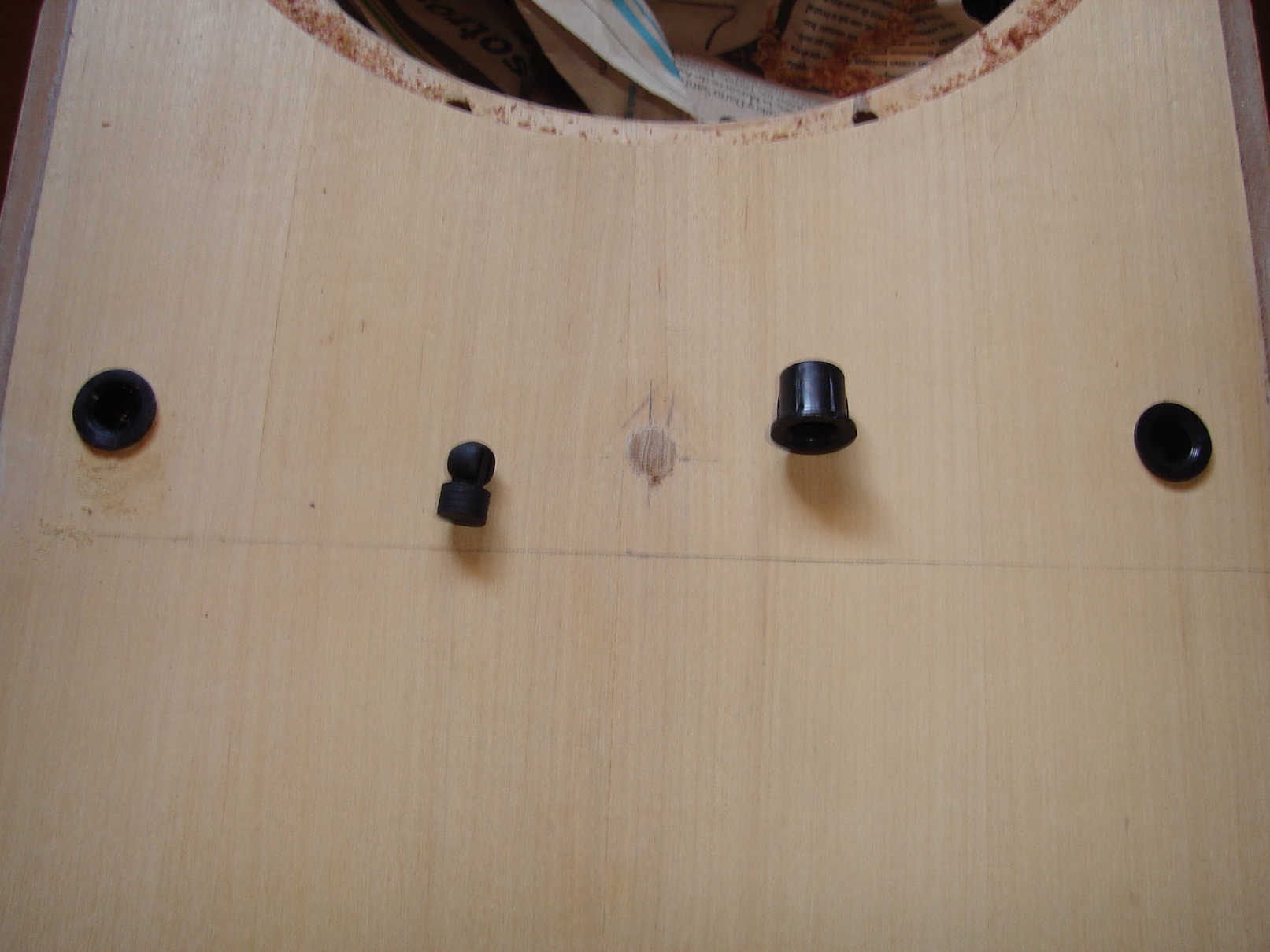

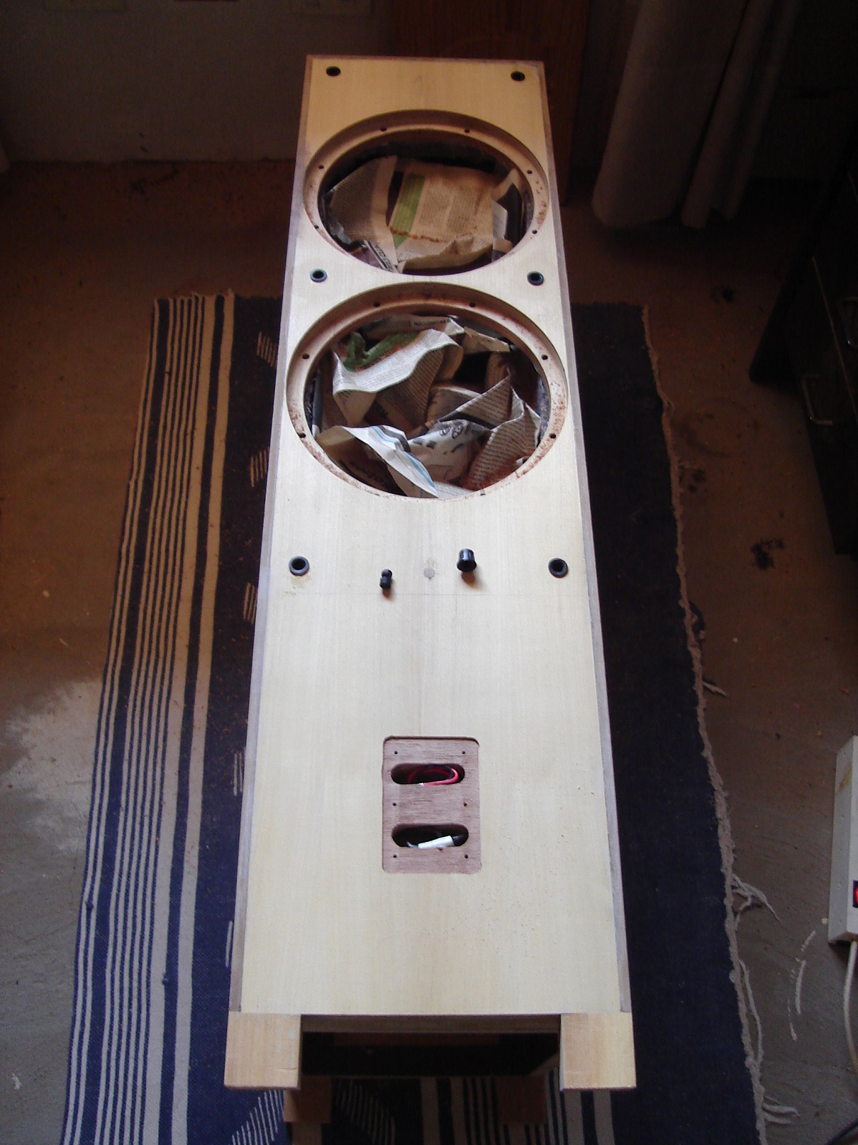

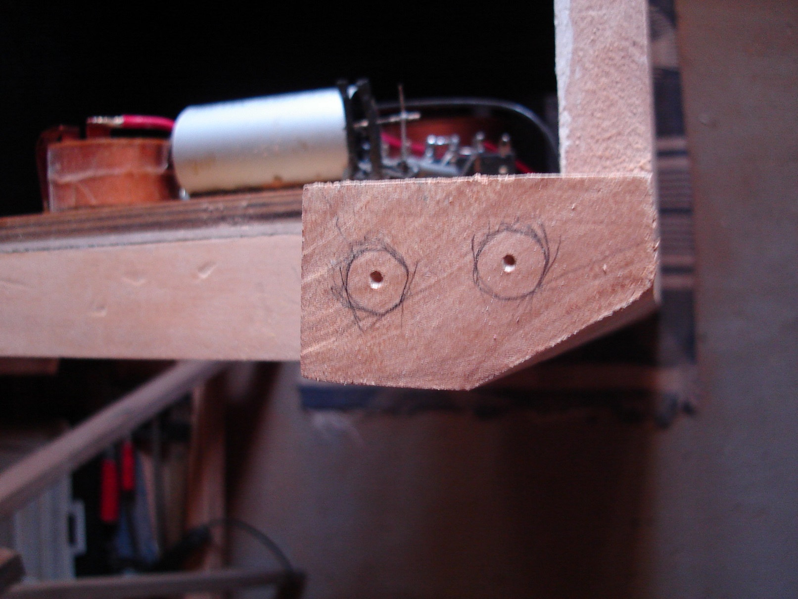

Installation of the grid locks .
Make the hole accurate , use a rubber hammer, try before on a wood trim.
The template will serve to match the female parts with the male parts then ...😱

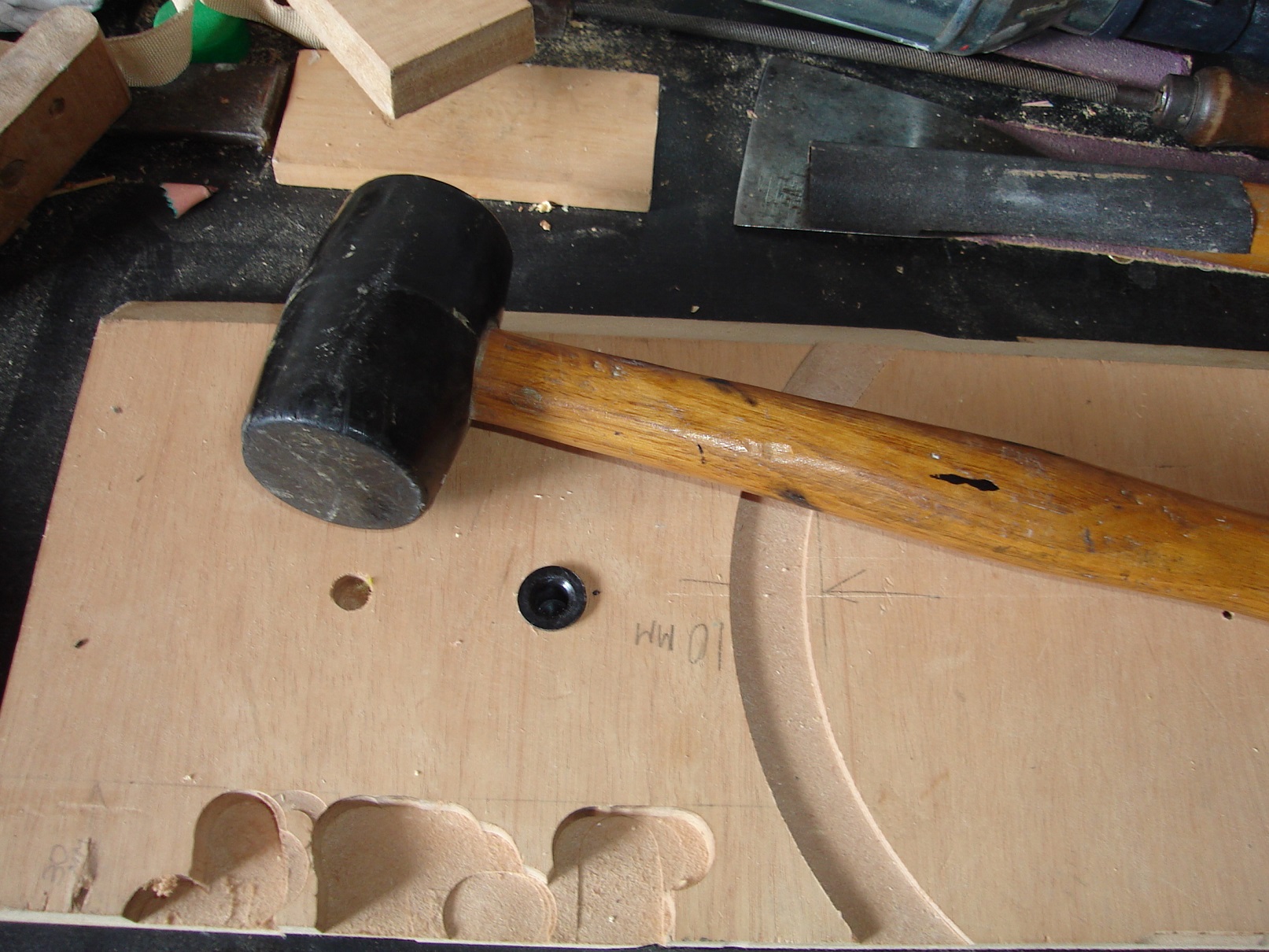

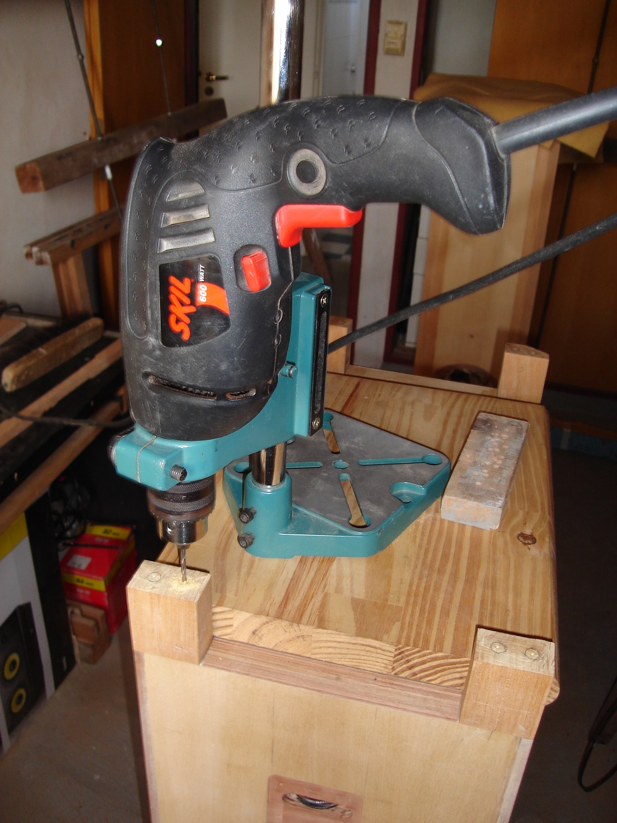

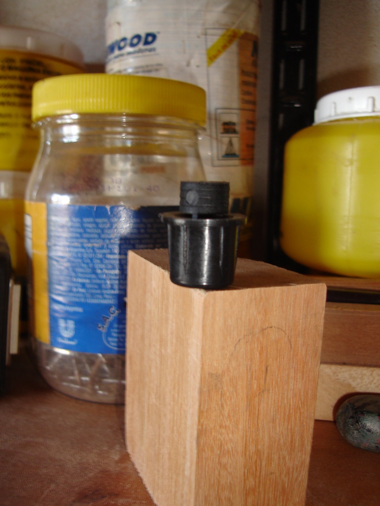

Use various drills from minor to major, use a rubber hammer, try before on a wood trim.

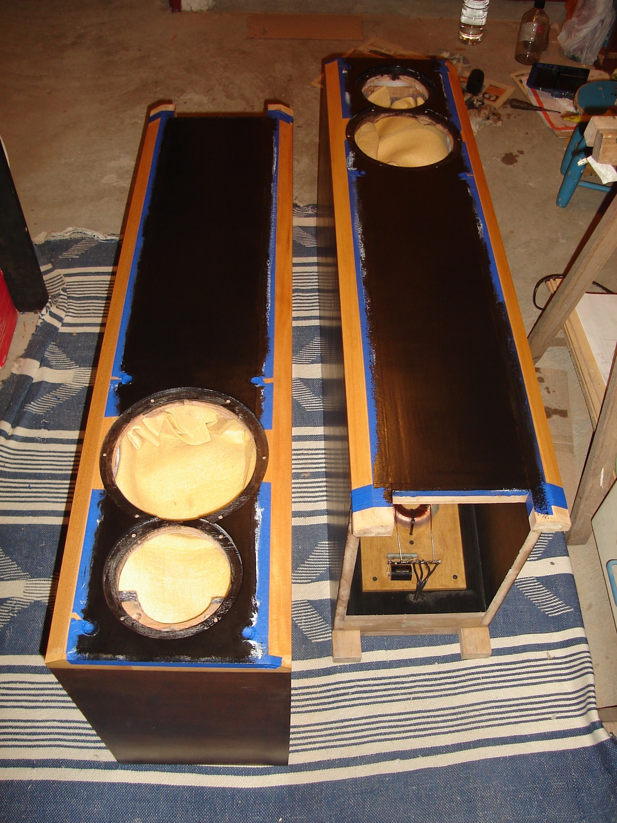

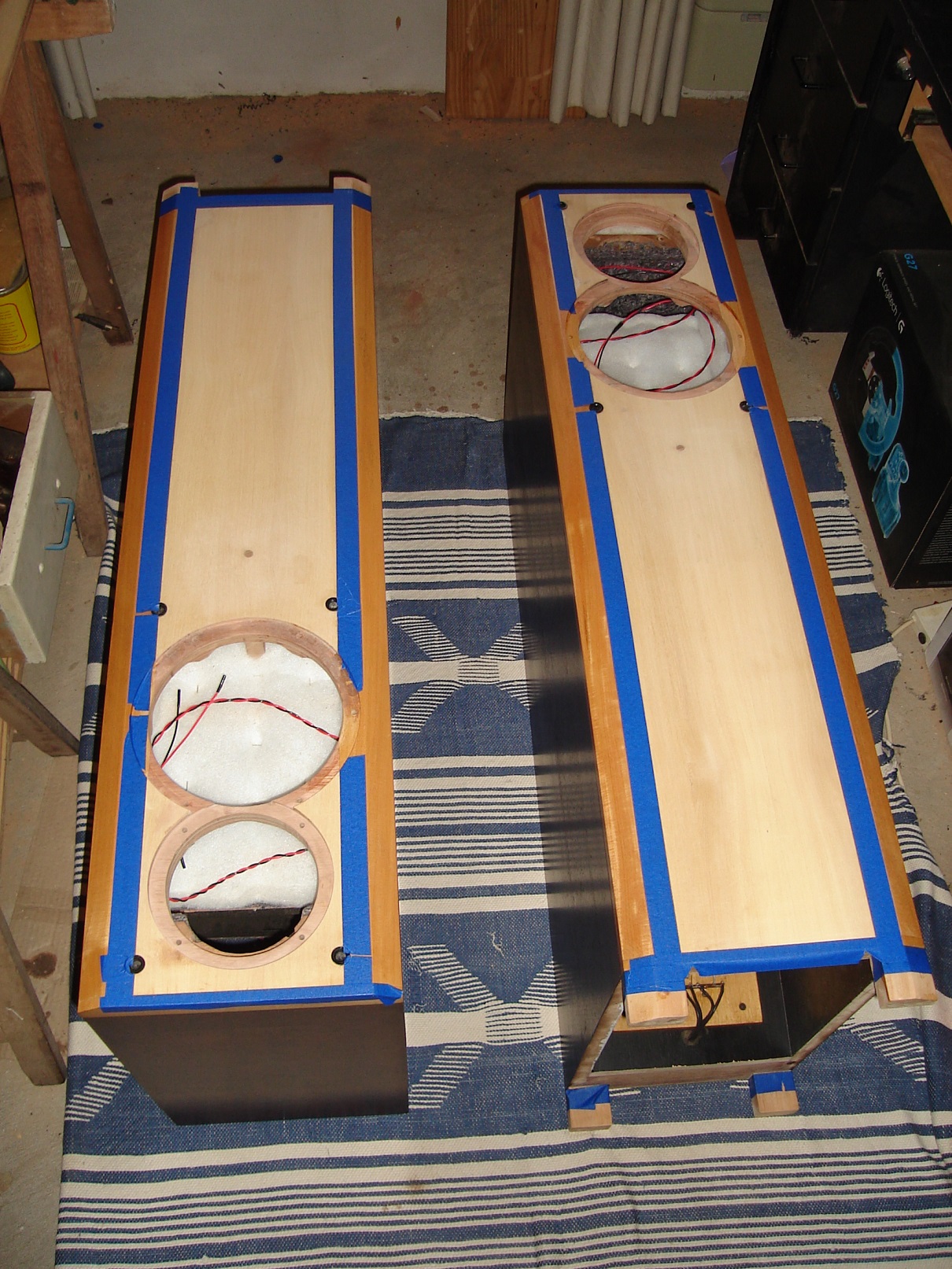

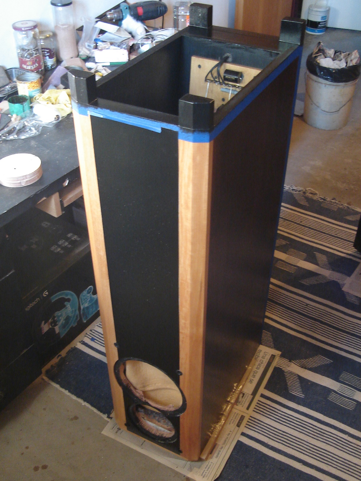

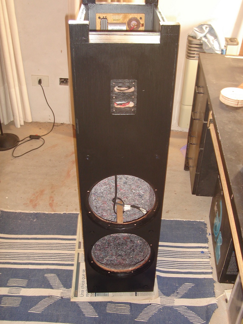

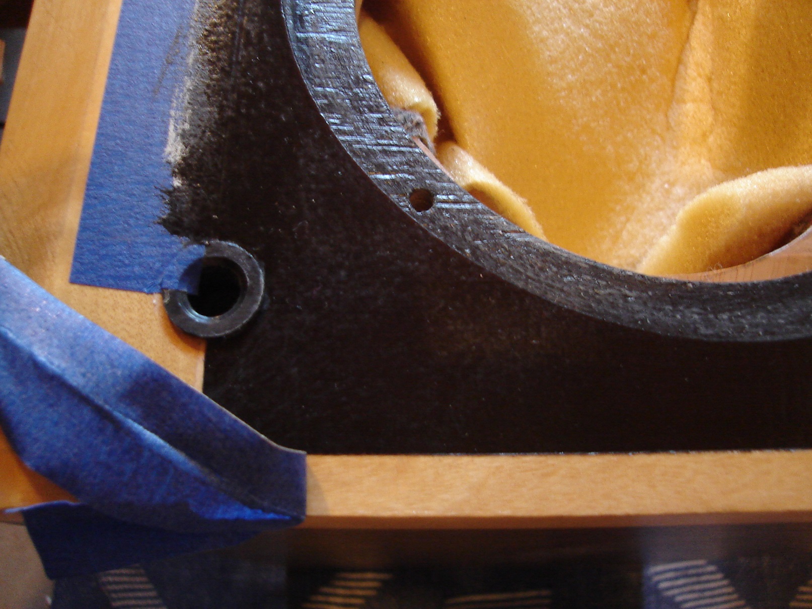

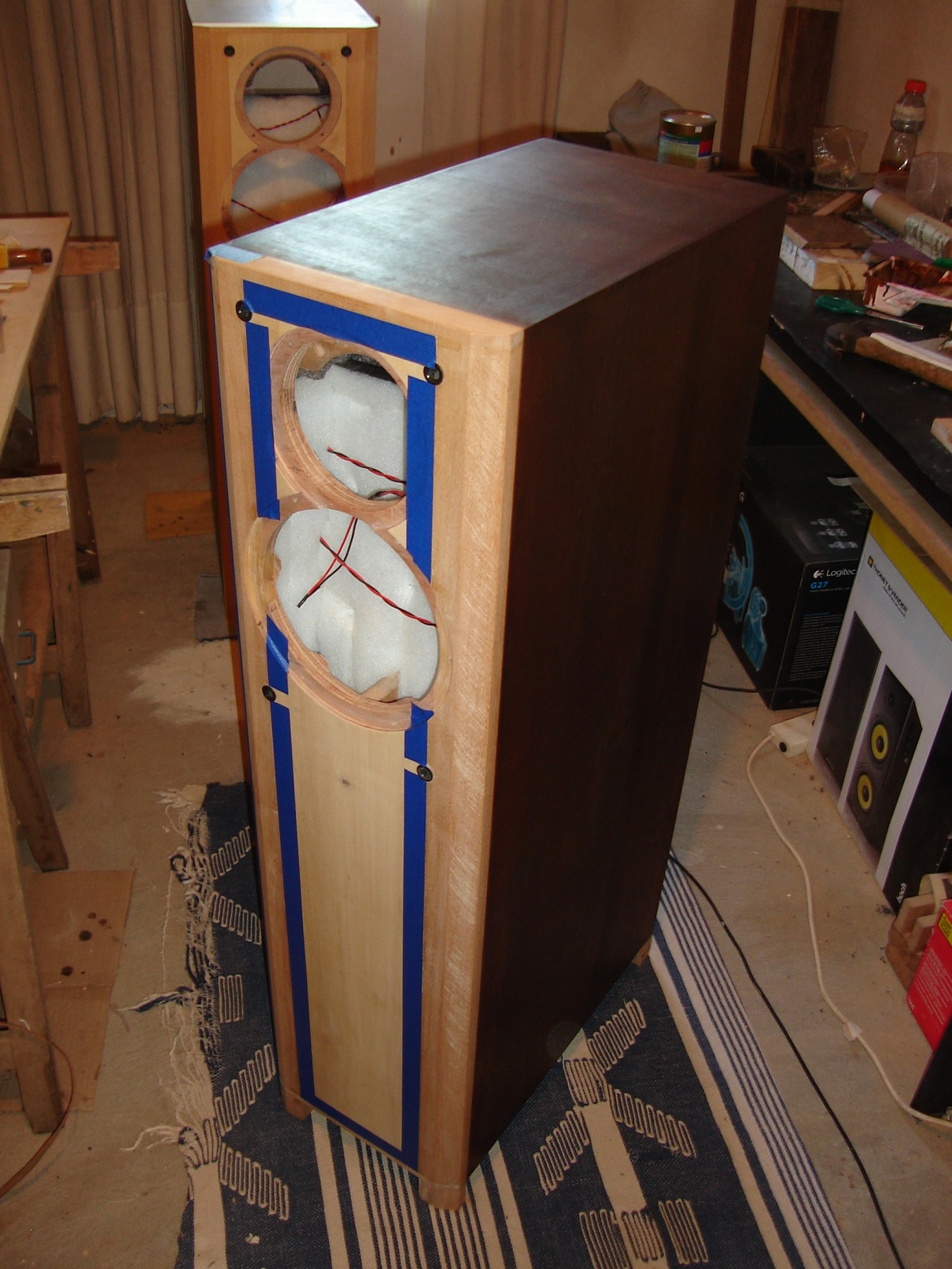

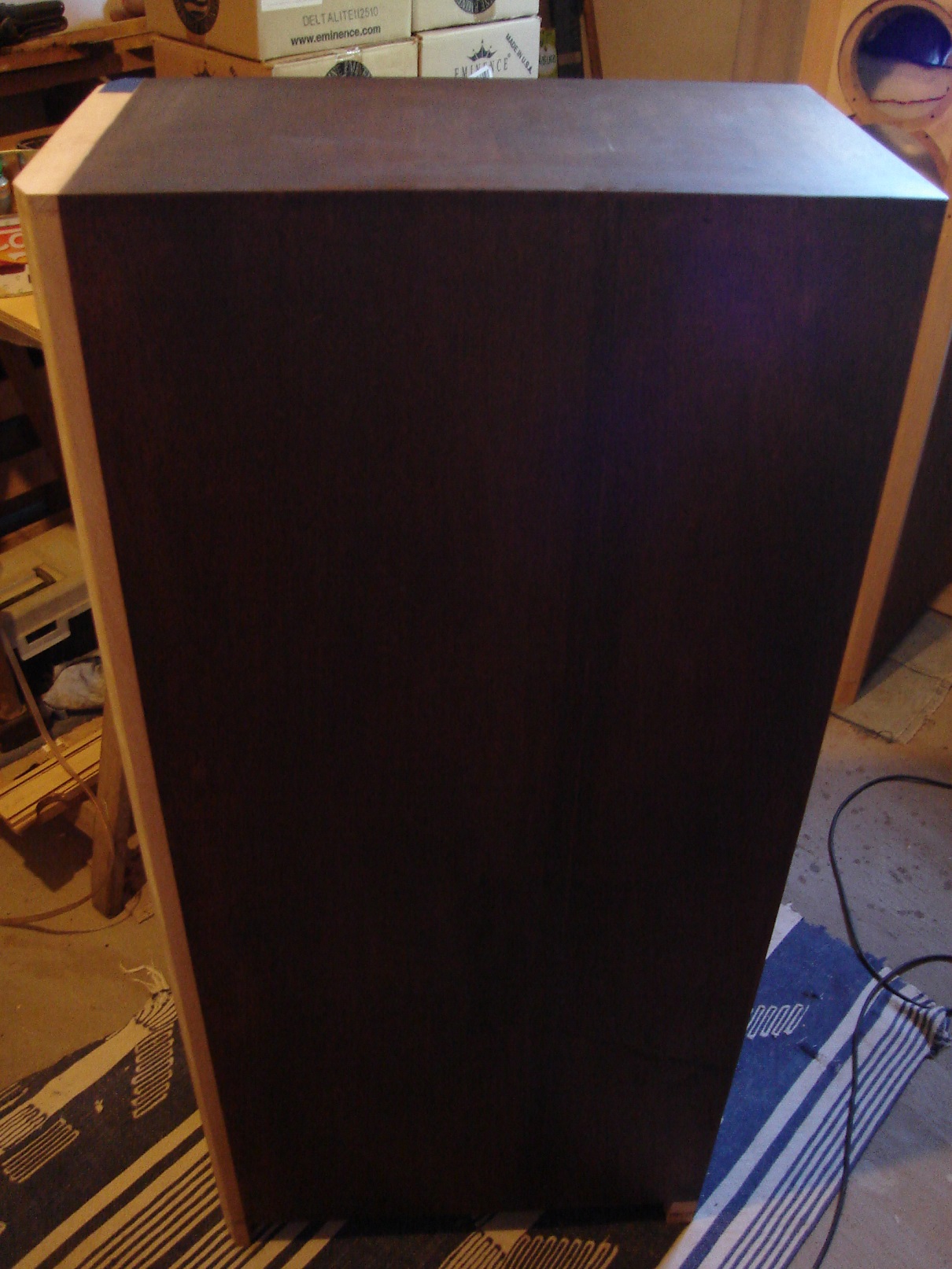

Stage of cosmetics.
Each of us will have a finish that pleases you more, I chose:
Bafle (front panel) black center, angled side slats of natural wood.
Top panel and side panels semi dark wood (walnut)
The back panel will be all black, little work here, thankfully ...:happy2:

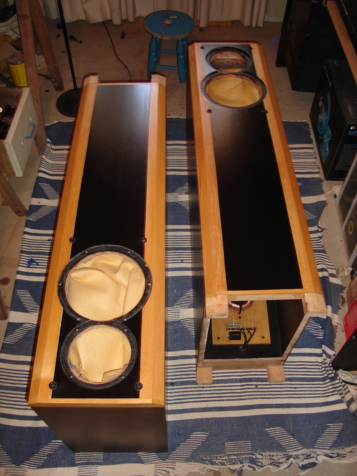

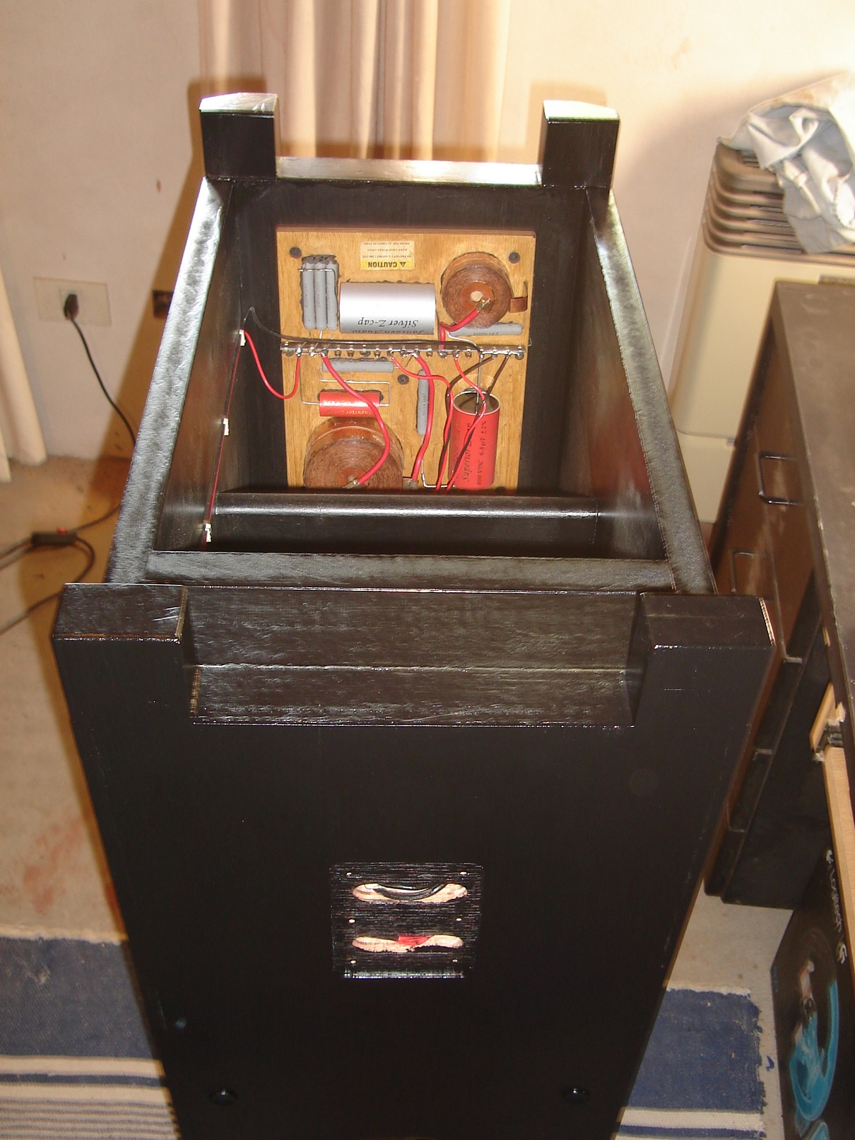

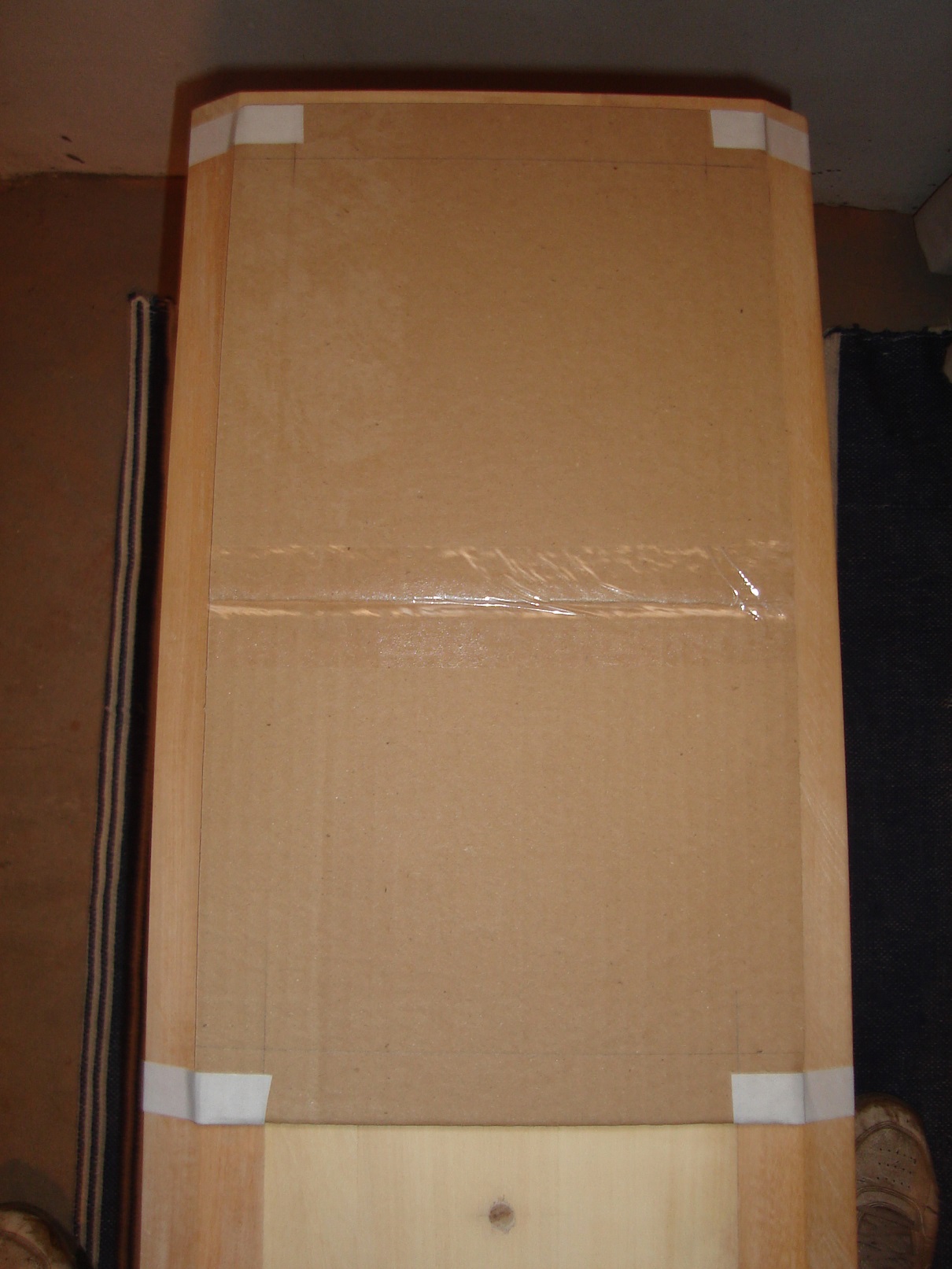

A final step for this year, paint the front and the back panel black, and then a final coat of varnish to all surfaces.
The rest will be for 2017, a happy new year for everyone and thanks for following this thread ! :cheers:

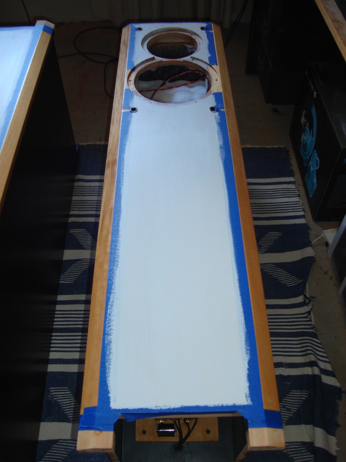

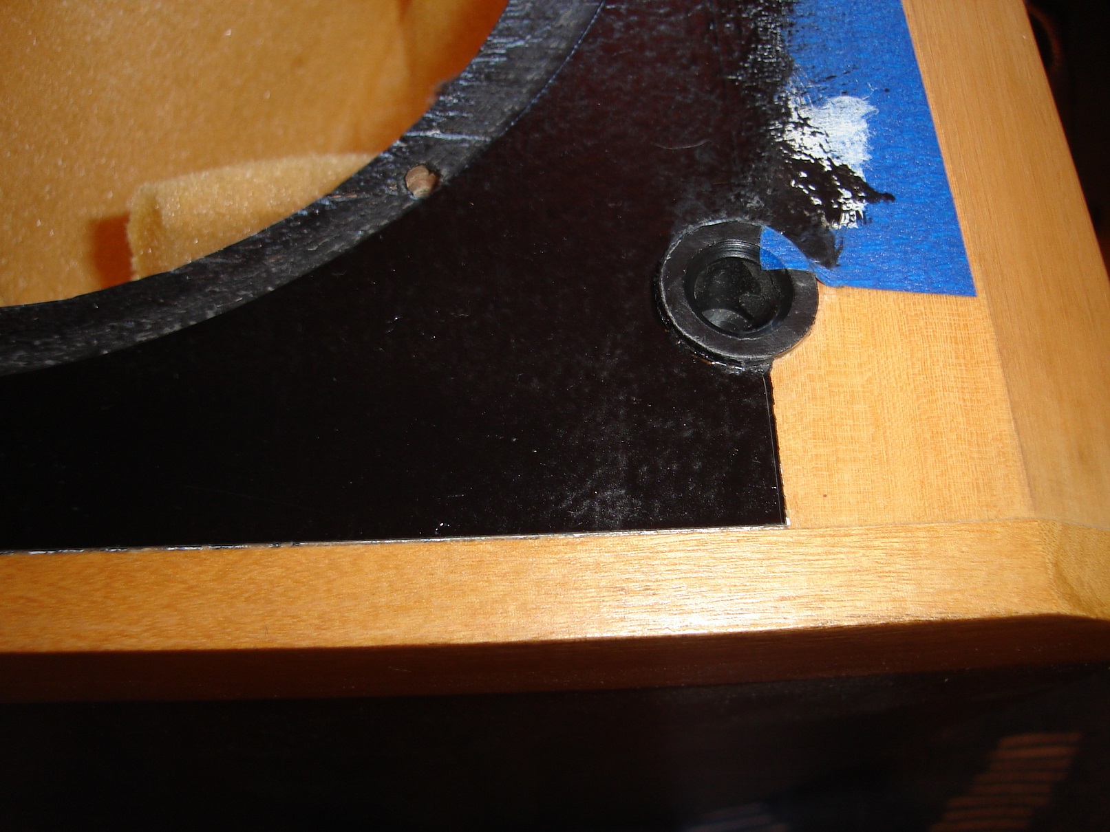

The front panel is already ready for the last coat of varnish, - I have chosen a semi-gloss coat - now paint the back panel and the feet in black. I will not apply varnish on it. :no:

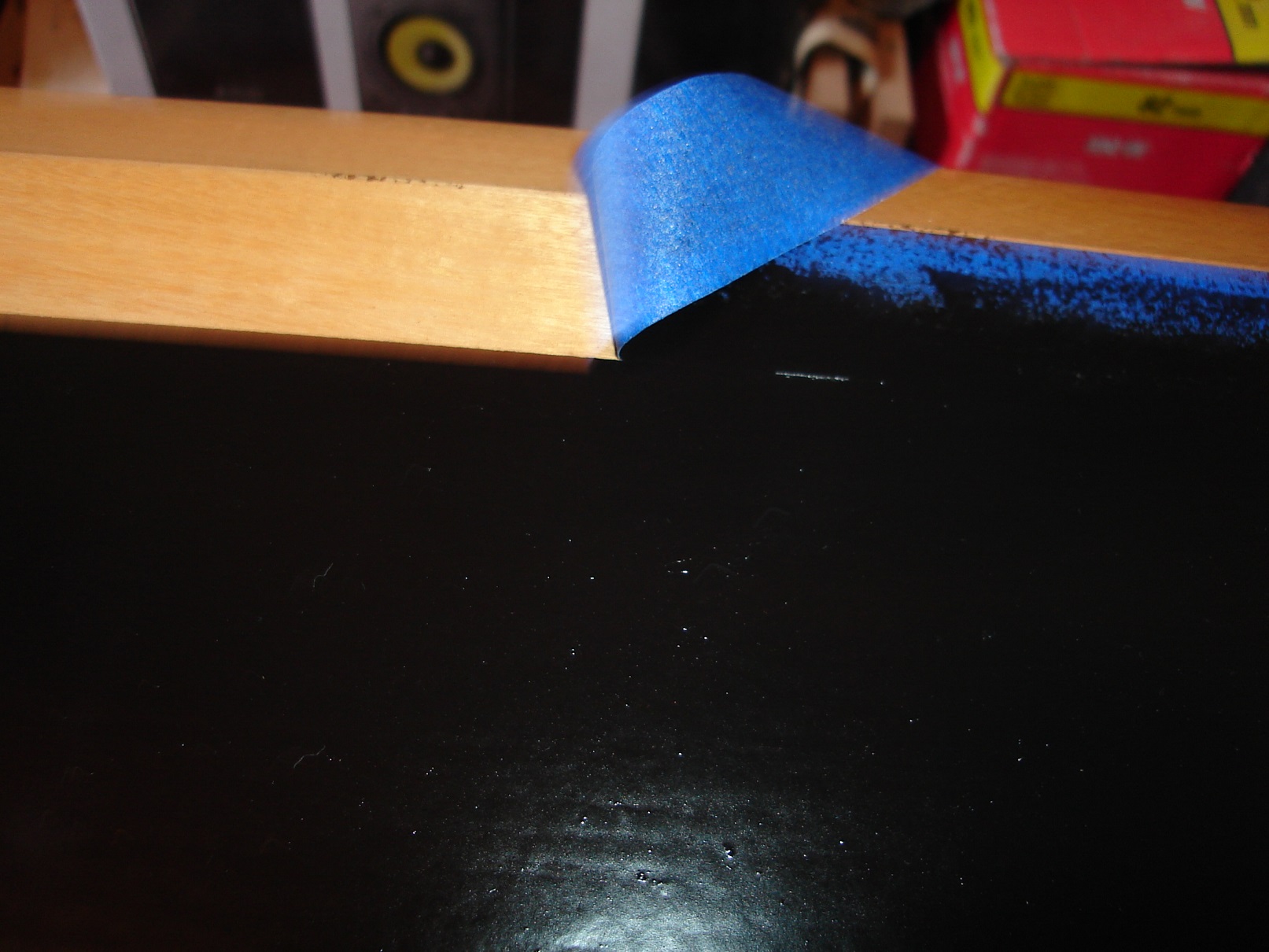

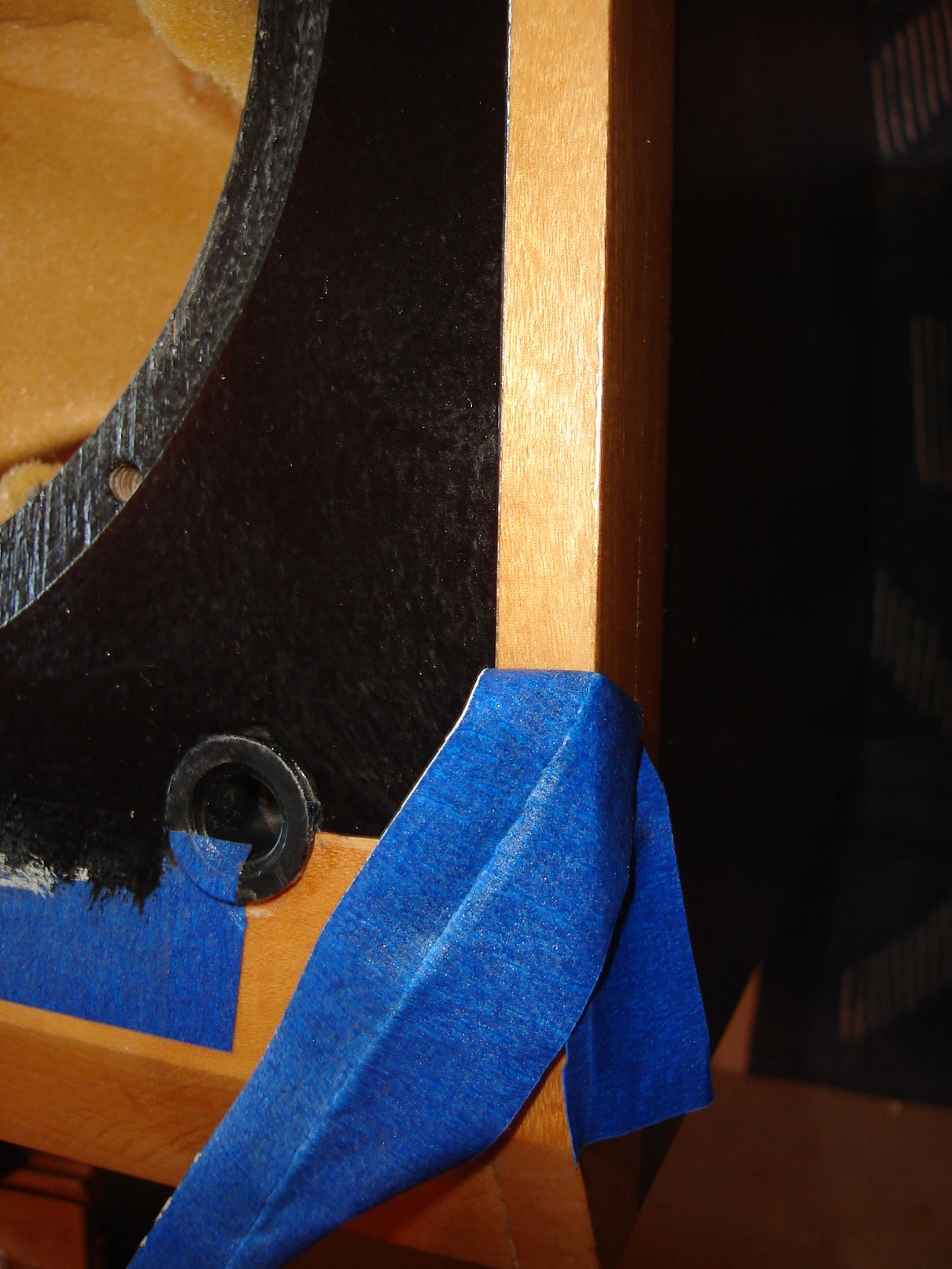

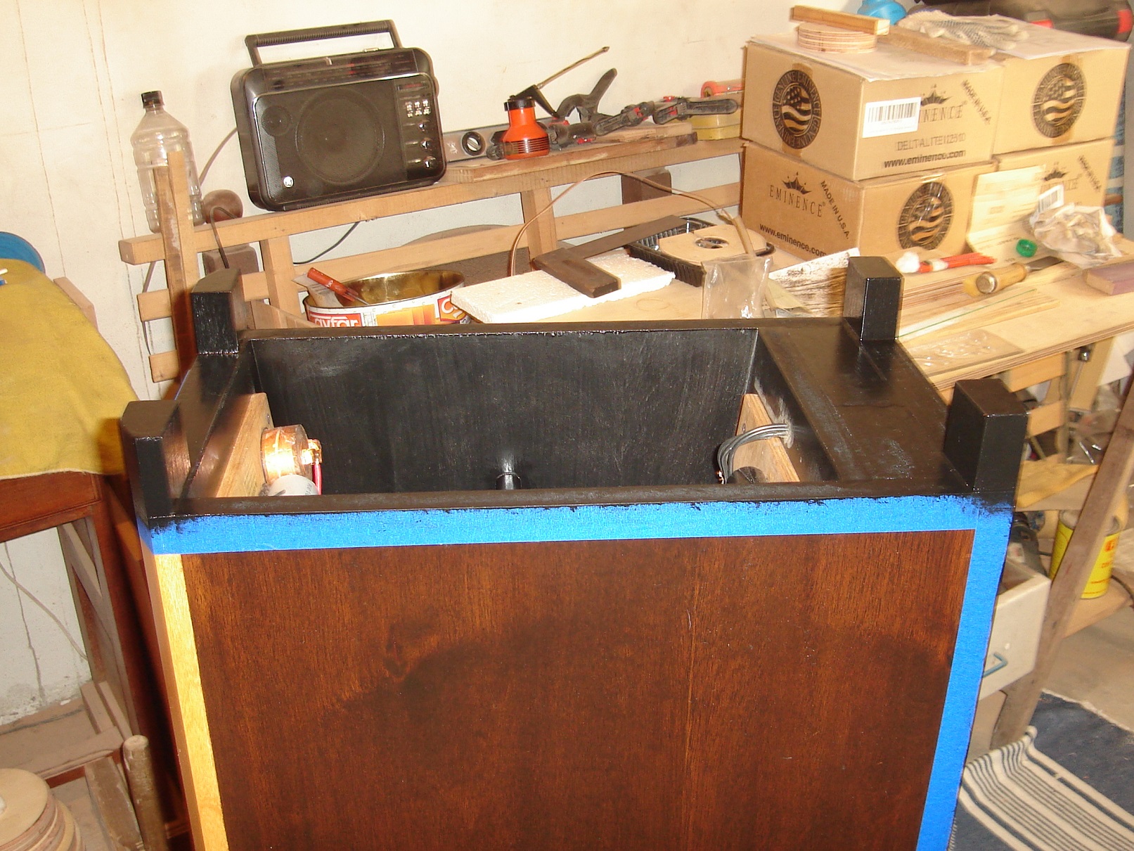

I have not applied white wood base paint to these surfaces.
Use black paint diluted with 10% turpentine as a base and then another pure coat.
Humm, there are change of plans .... I think that once dry (it takes 12 hours to take its correct tone) apply varnish to all surfaces, including the back panel and feet. It will be easier because it will not be necessary to protect with masking tape.

Many online chess games have not let me see clear in the last post .....🙄
It seems to lie ..... with the simplest things sometimes we become too complicated .... analytical excess of certainty ....😱

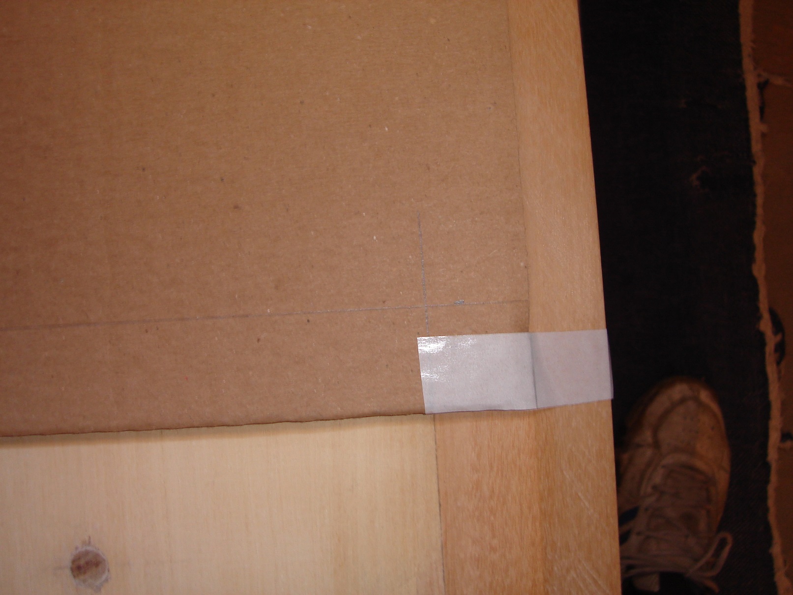

In the current state of painting, if I apply (I have already done so today) a third layer of black, then I will remove the masking tape, I will put up the cabinets up front and I will give the last coat of varnish only to the surfaces with wood finish.😀
