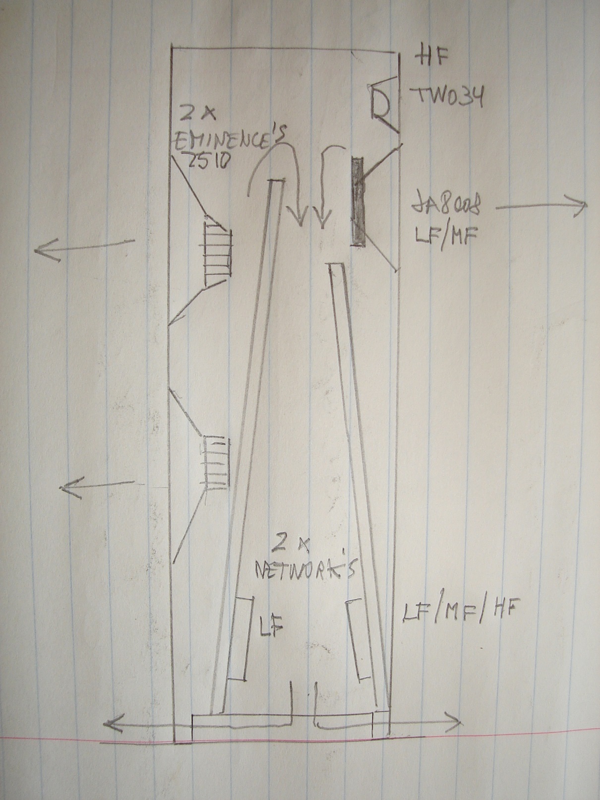

The only trouble with this is that the levels for JA8008 and rear speakers will become mismatched in level.Thanks friend, I'll leave it connected then in four ohms. What would happen if I use 8 ohms for the subwofer sector (very pretentious this phrase ) and 4 ohms for the rest ?

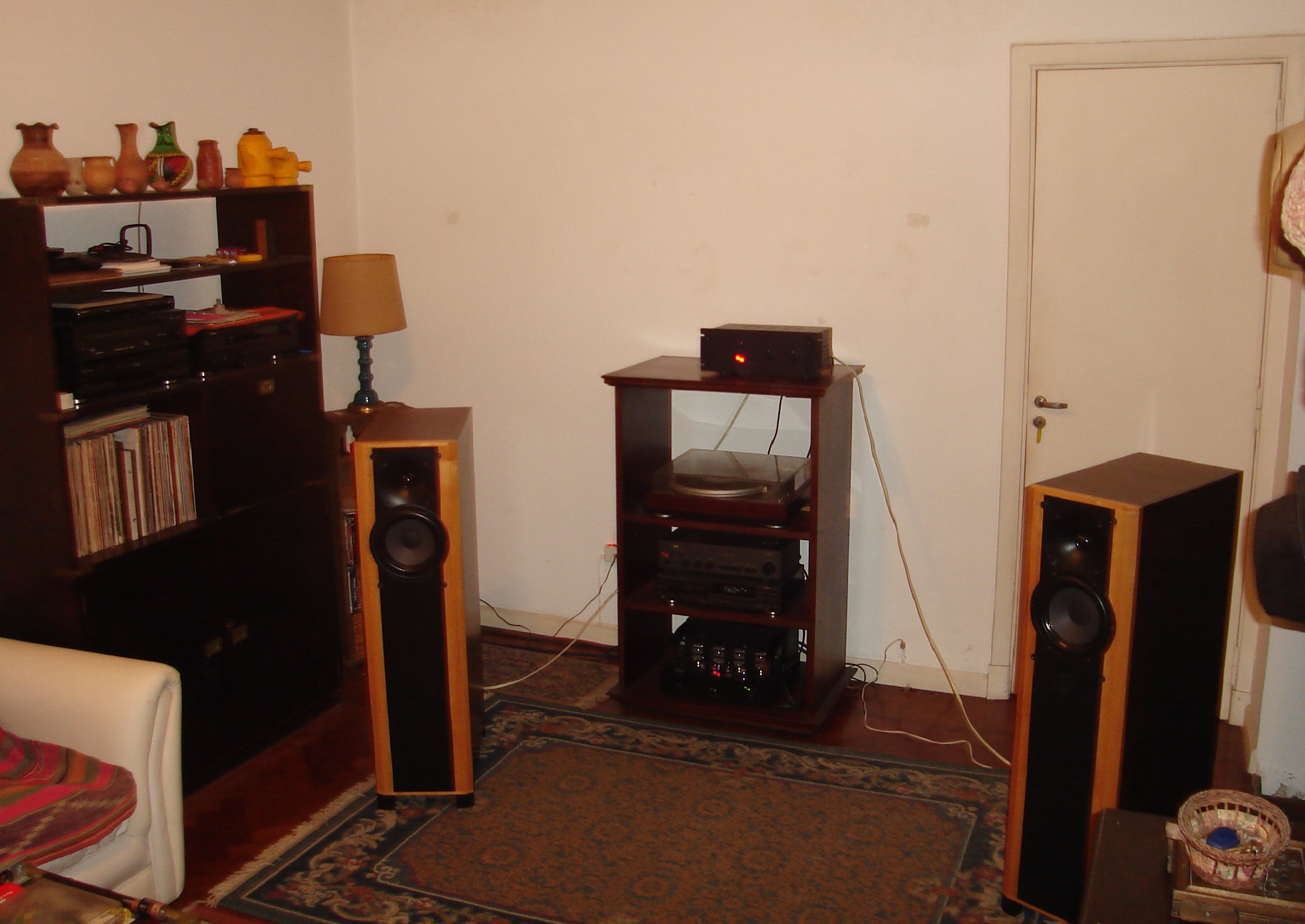

""Well, enough of can and now to listen to music..."" I agree! Time to listen!
I keep listening and comparing, I think I miss the first two octaves ....
I have not found the first two octaves ( for this we need
a subwofer,there are no free lunches, see here ...)
http://www.diyaudio.com/forums/subwoofers/303987-vintage-jbl-subwofer.html

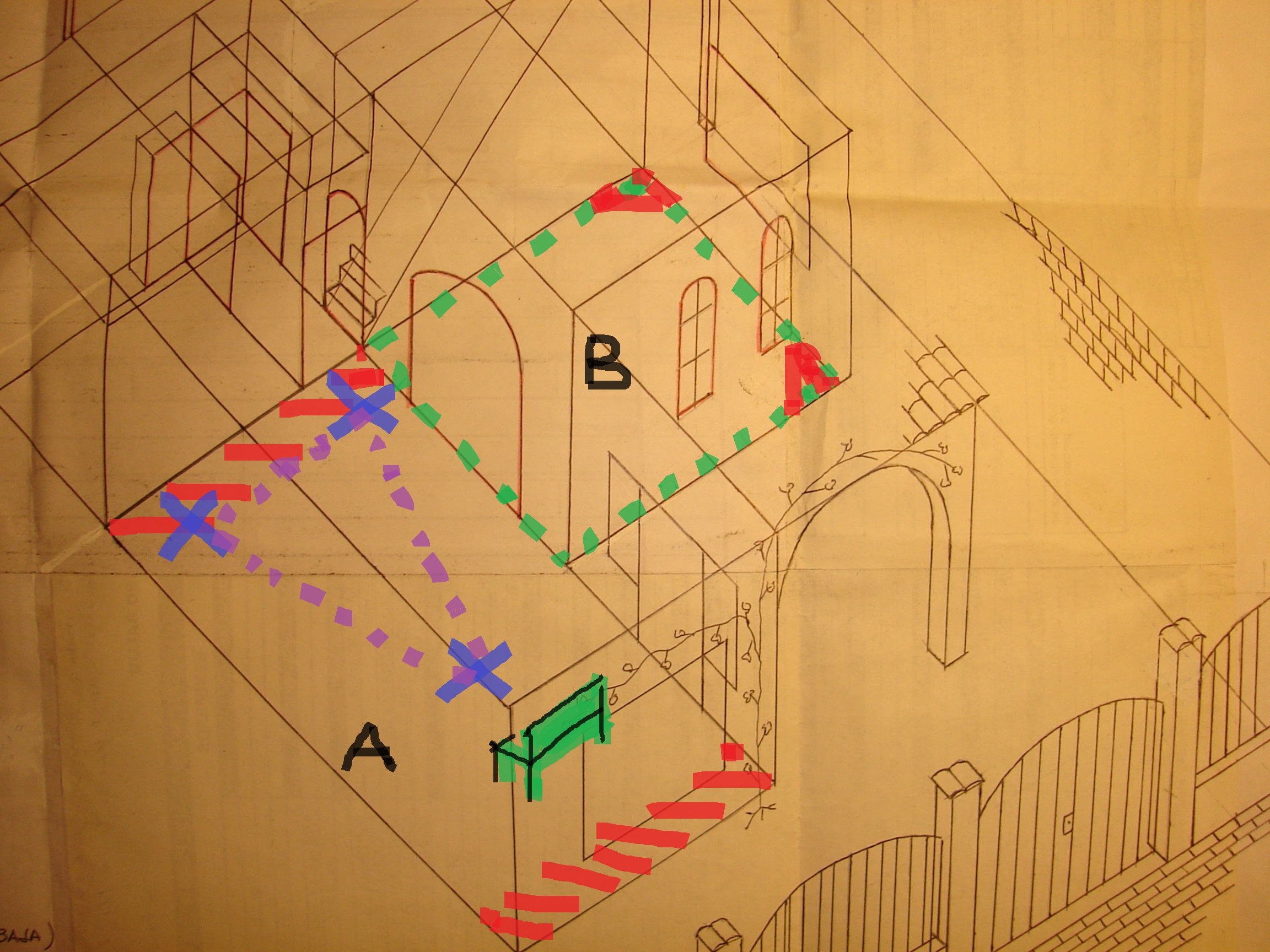

, but if I found the optimal listening place in my room.

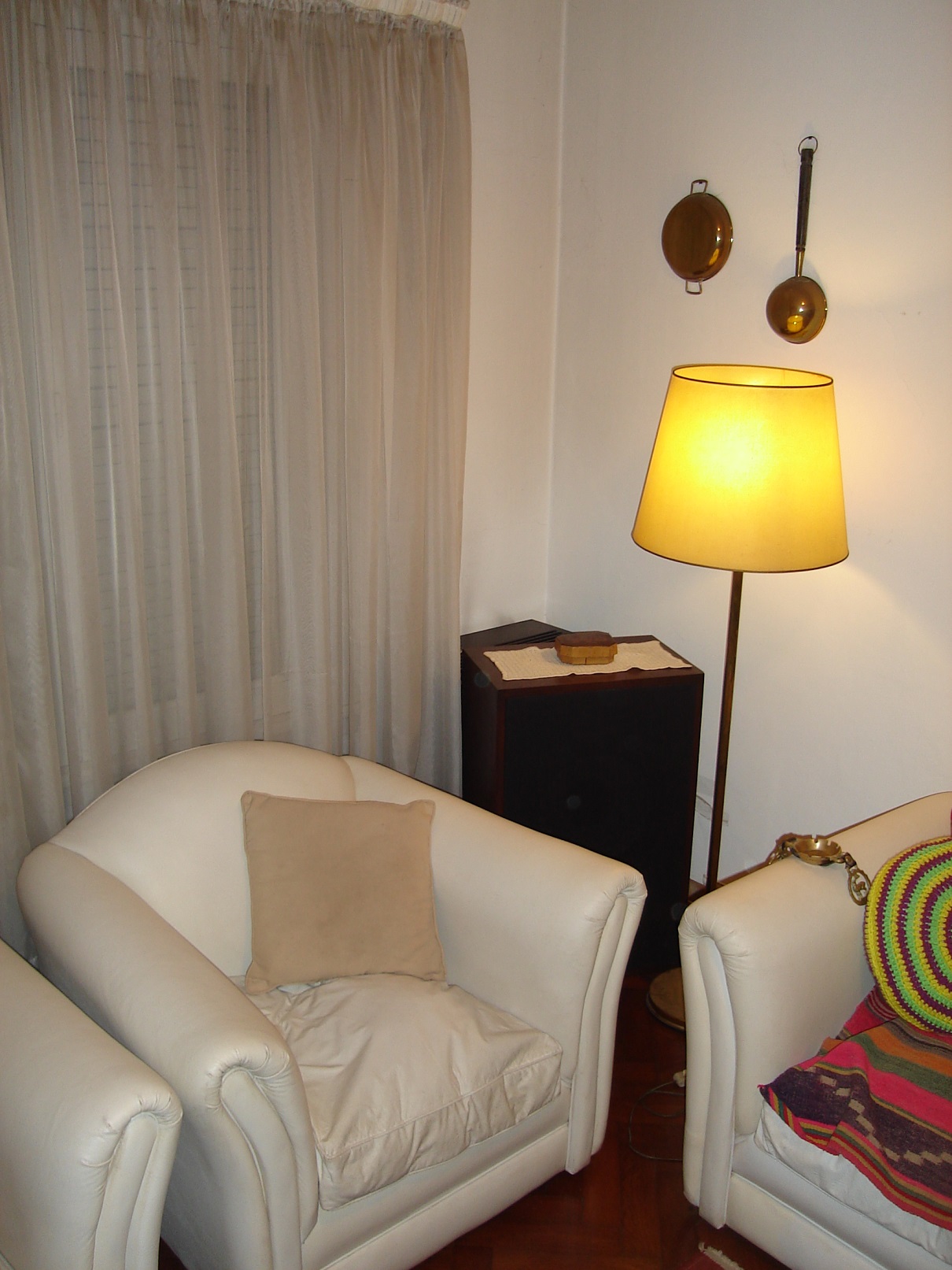

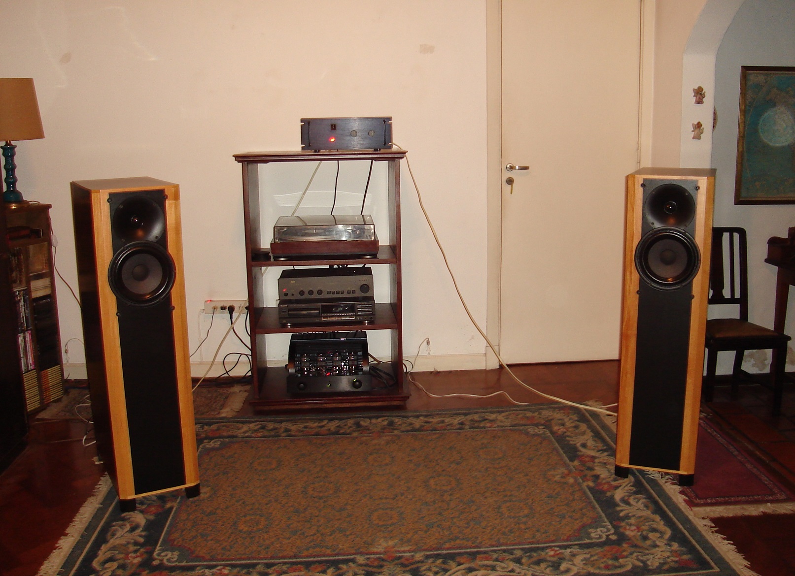

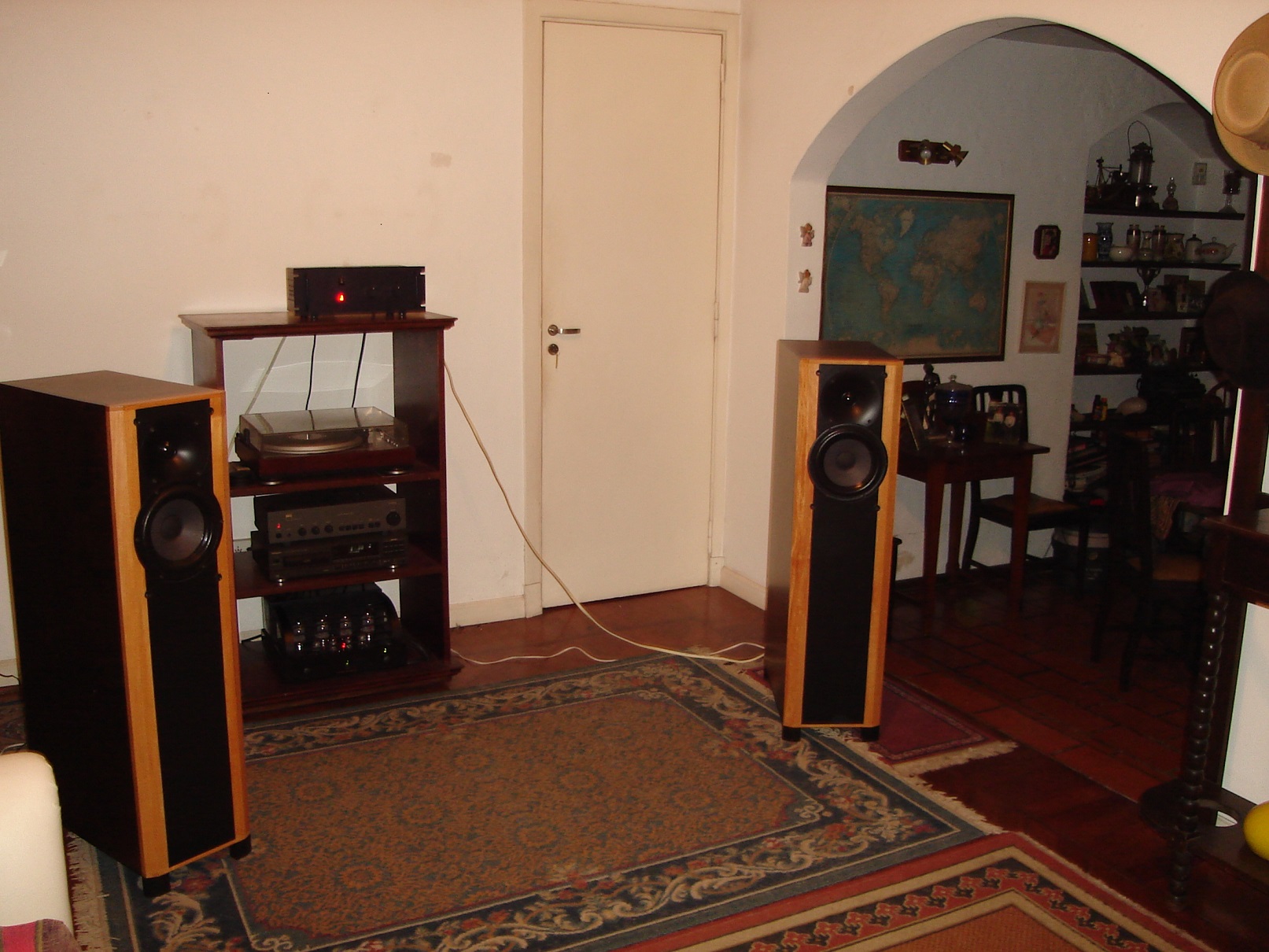

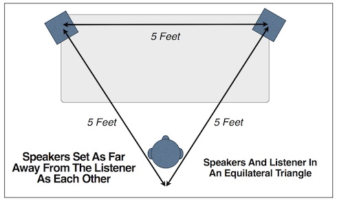

New phenomena occur here, since the replacement of my vintage JBL by DTQWT have appeared blind spots (? Modes) in the sound perception of bass tones.
In other words, what used to be a bass reflex speaker charging and tuning through the front of the cabinet, does not fit a double horn with load for front, back and floor. Tuned by the mouth of the horn in its encounter with the floor, as to increase the differences.
The areas marked in red are the points where the bass gain is strong, I calculate about 6 db minimum, I have no instruments to measure this nor do I intend to do so. I only trust my ears and experience. My intention is not to experiment, but to listen as best as possible.
The sweet spot to perceive depth and wide sound scene, expanded to the sides besides (see link, thank you Lynn)
Speaker Location and Image Quality
The Ariel, Part II
and not a hole in the center, is pointing the cabinets to a point located right in front of our feet, physically speaking. (In my case, they are 60/70 cm)
This changed the sound scene a lot. The traditional here does not work as well.
( see attached )
It is an atypical room, with high ceilings and a lateral habitat to the right, it is the zone dotted in green. ( See zone A and B . Zone B is located 50 cm below the area A and there the roof has lower height )
Any comments will be appreciated, regards !

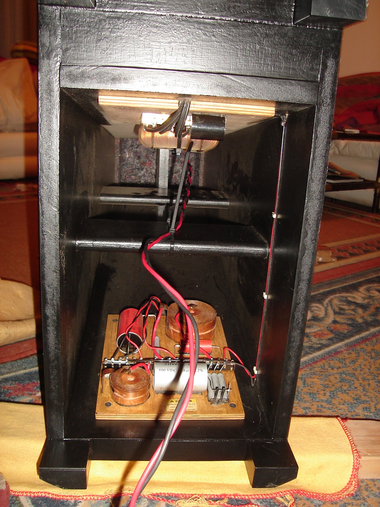

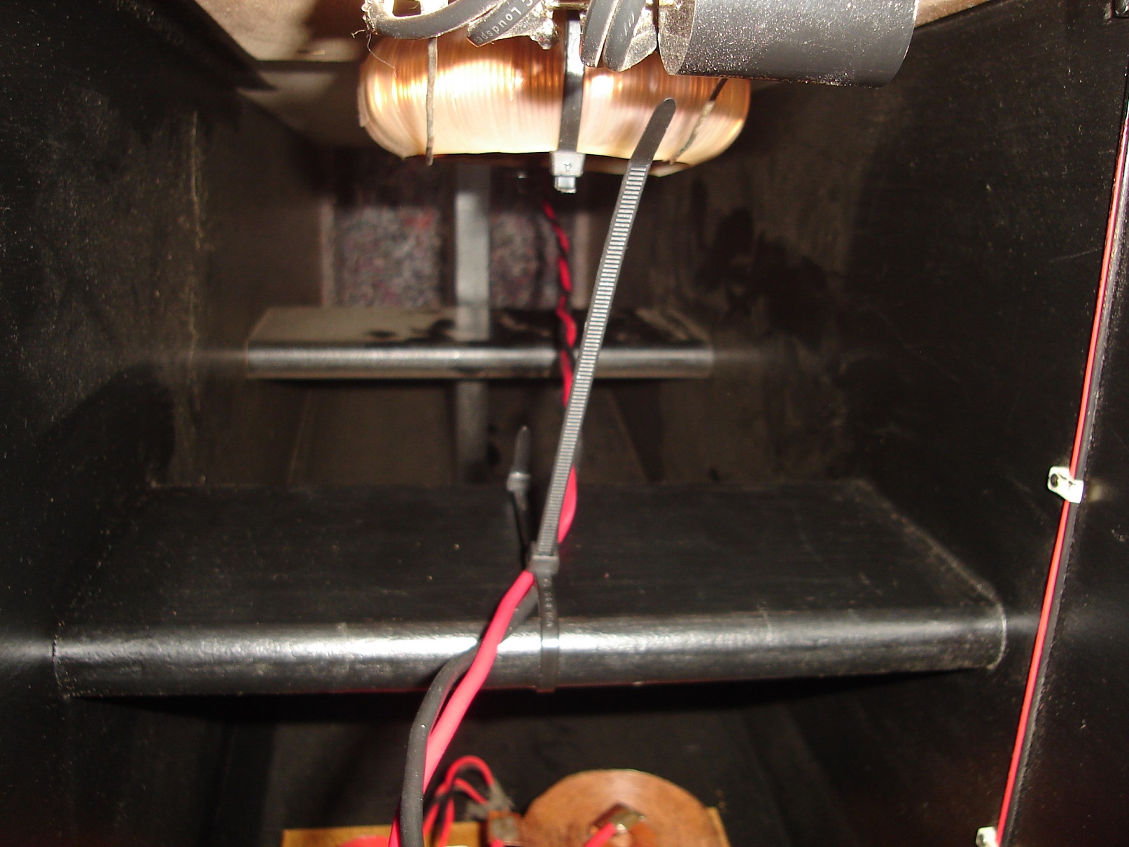

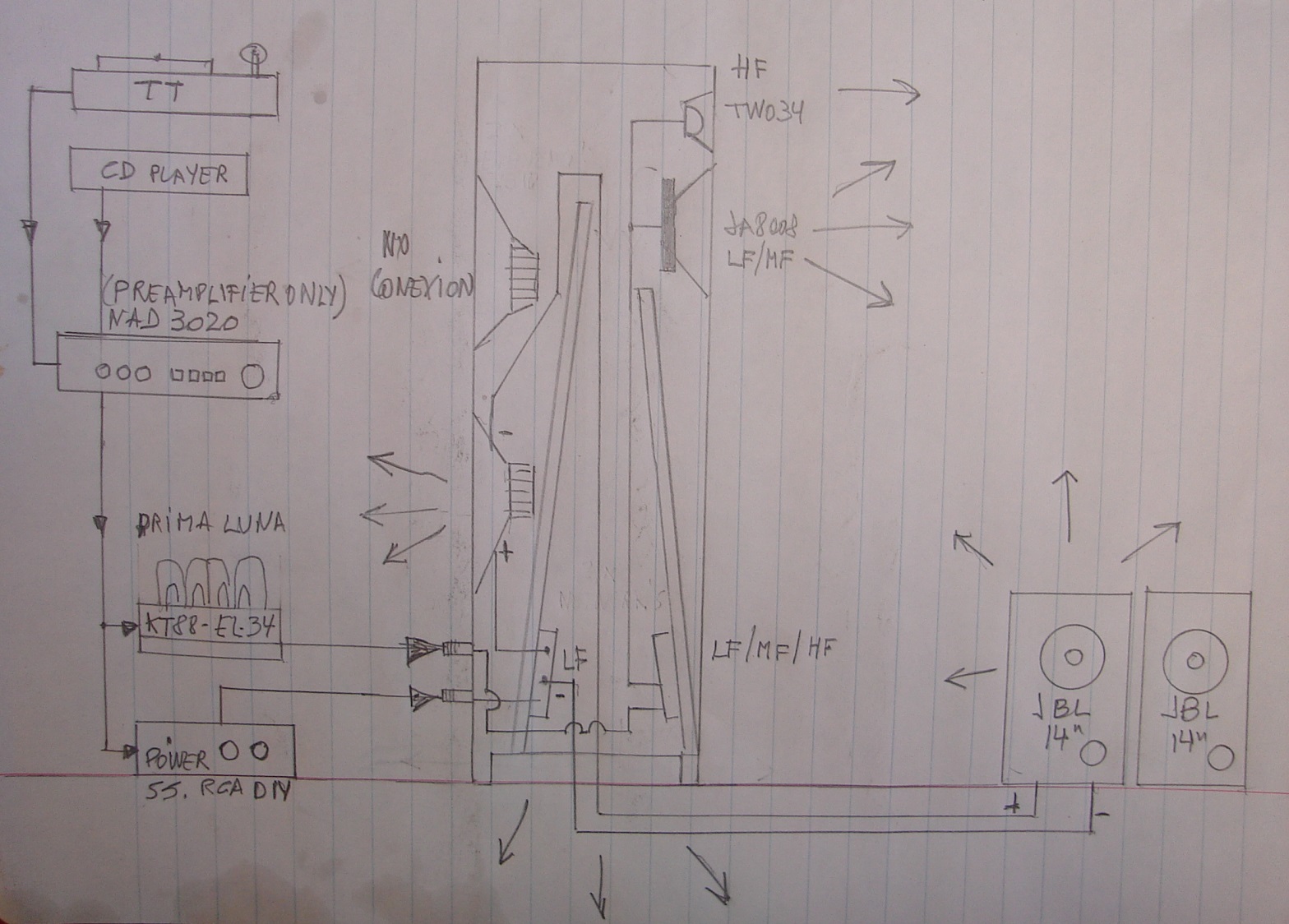

There are news! Very interesting and good, I am enjoying a new sound with great satisfaction, the builders of Dtqwt/ II must be attentive, today I have achieved the bass extension that I wanted.
I'll tell you all ...
Hi earlk

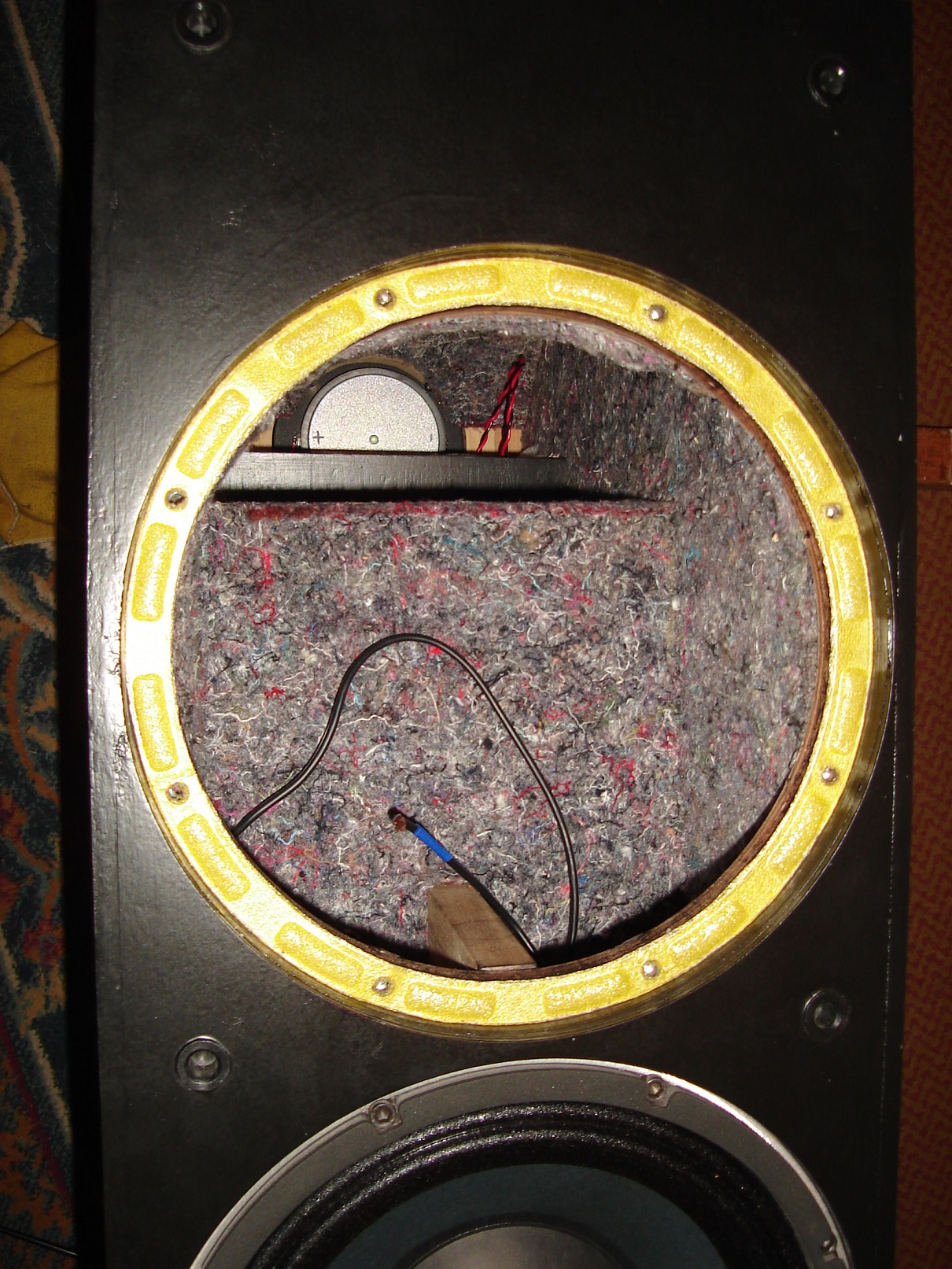

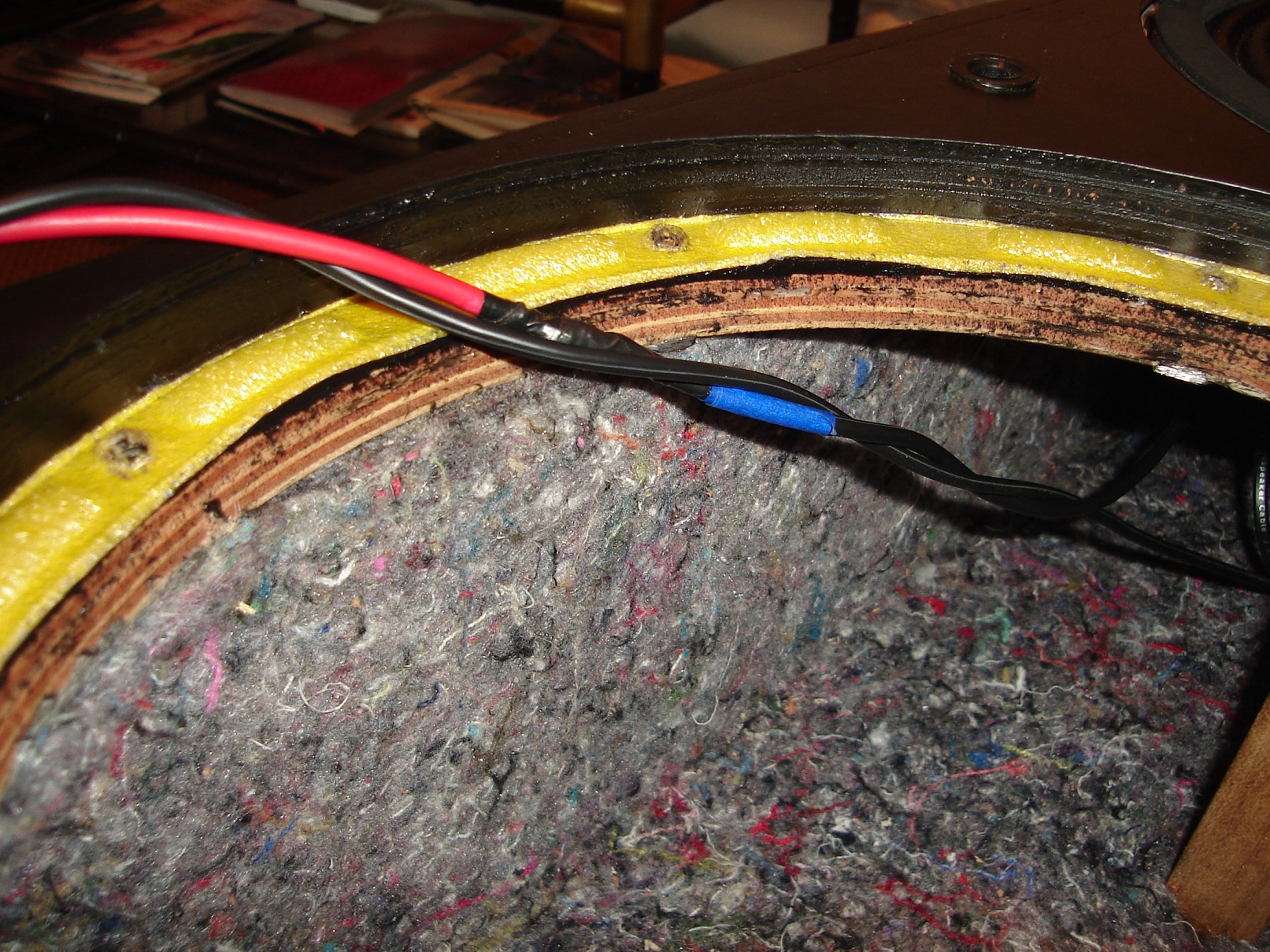

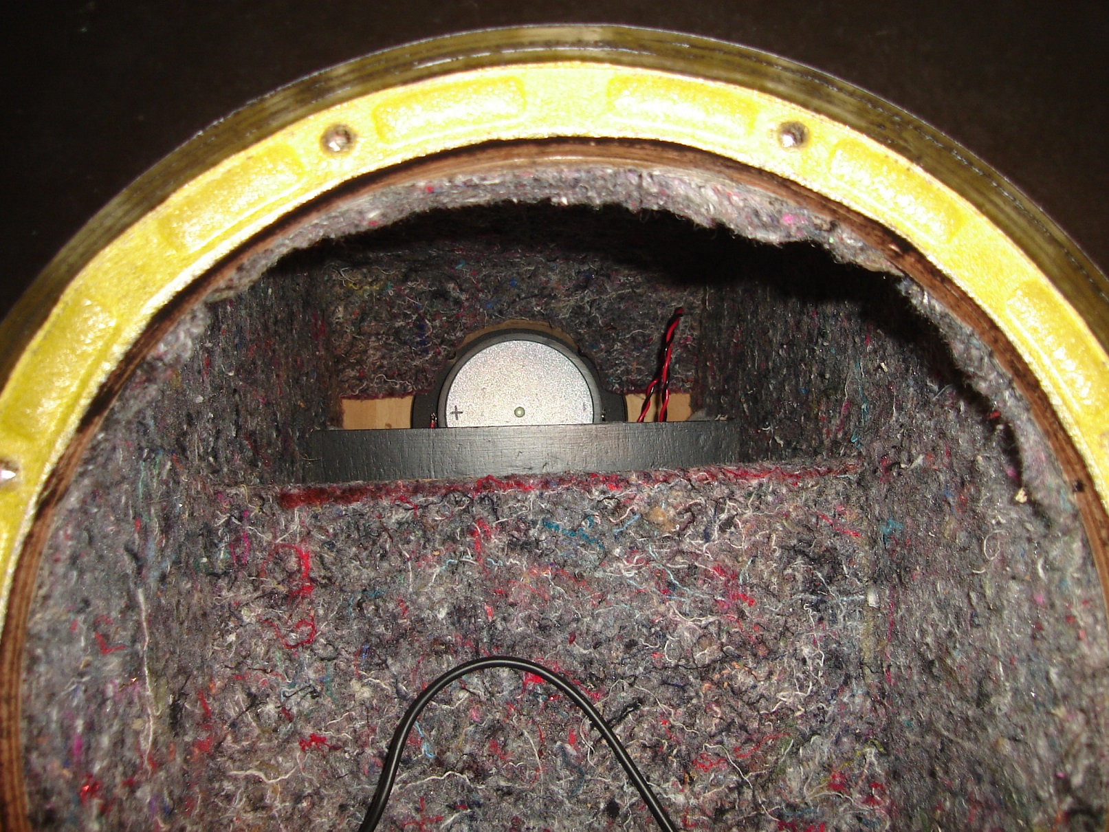

I canceled the Eminence DeltaLite 2510II. (higher)
Instead it works a 14-inch JBL LE14C speaker that has lower FS and in its dedicated 80 liter cabinet achieves a bass extension that adds to that of the DTQWTII.
Vintage JBL for subwofer
The upper Eminence speaker is disconnected acting as a passive radiator.
I'll be attaching graphics as I develop the idea.
Thanks for your interest !

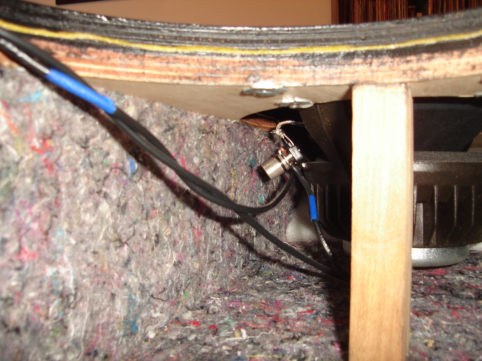

In general "normal" sized TQWT don't have the "normal" low freq. extension like people are used to (33~40Hz). In practice seems to start at 43~45Hz or so. My home has a great room gain in low frequencies and I don't miss "half octave" most times with almost all music, but I plan to build a active two 8" TL for suplying 20~45Hz (TL taper's invesely if compared with a TQWT, interesting...). For most music for sure I don't switch on the sub. In fact, some "woolly" recorded music actually benefit from a less than good very low freq. response (some studio people need to learn how to microphone correctly the drum kit...)
The DTQWT don't make low freq. extension lower in comparision with a TQWT, since max line lenght is same; only the max low freq handling or so (in my home I don't miss the extra woofers; in reality sometimes I desire to put a second tweeter, that's it ). The extended "monster" DTQWT will reproduce all without a need for sub.

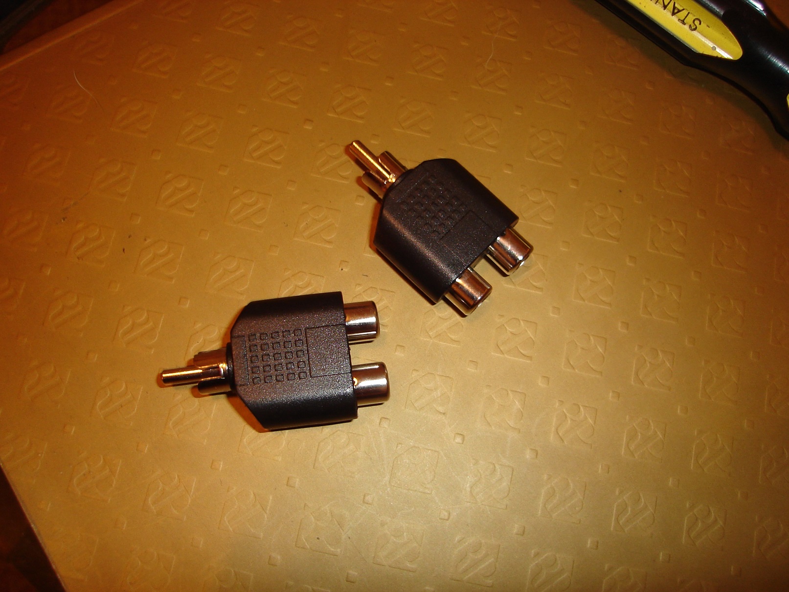

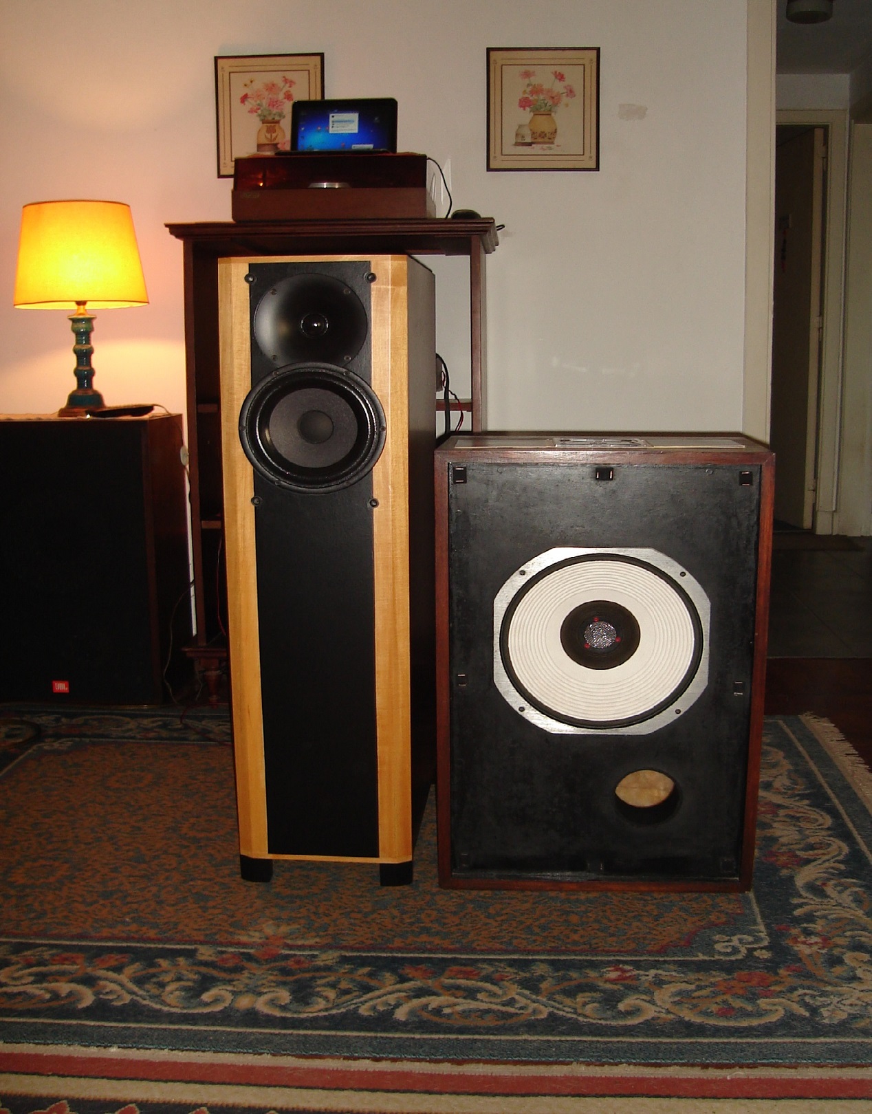

Here all connections
The SS amplifier is a vintage RCA diy 70 watts rms per channel, a classic of the 70's. 2 x 40638 RCA quasi complementary at the output, are transistors equivalent to the Motorola 2N3055. If, of course, a 300-watt modern class D amplifier, connected to a special speaker for subwoofer, 18 inches and housed in a good cabinet would be better .... It will come that step, a plate amplifier, and with a selection of frequency crossing is ideal. But, this is what there is, and the sound result is far superior to my previous configuration. Lots of fun, and WAF lets me do it, what more can I ask for.
This power amplifier is used directly to power the bass sector with the two speakers connected in series, the same electrical impedance is retained (Eminence and JBl have 8 ohms of impedance), the acoustic impedance is not altered because the added speaker of 14 "Works in its own compartment and the disconnected Eminence remains in place acting as a passive radiator.
The amplifier Nad 3020 has good output signal level (mV) in its preamplifier section, and the shunt with a Y-connector does not significantly change the input impedances to the respective amplifiers.
https://www.hifiengine.com/manual_library/nad/3020.shtml
The JBL speakers are used directly in the low frequency sector, the DTQWTII used first order cross over works perfectly with the two speakers in series. Only the JBL is separated and away from the main cabinet, to my surprise, the adaptation is perfect, sectors have disappeared where there were behaviors with bass nodes and now you walk around the room and the bass sounds are of equal intensity!
A little experimentation is necessary to achieve the harmony of the set, for them it is important to have, as in my case, independent volume controls on each amplifier to match the emitted DBs, and then the general volume is managed with the control of the pre NAD 3020. In addition, I have tone controls if I want to play a little, edit old recordings, and I can apply Loudness when I listen at low volume. Anyway, everything must be balanced flat.
In the next post, respond to Diybrass and upload photos ! I must go to fulfill my daily obligations .......

Diybras :
I agree with you, you're right !
DtqwtII has more "lower" than TqwtII , says the designer and I check it by disconnecting the back sector 2x Eminence. The push pull effect is correct and works well. But I think the mistake is confusing subwofer with low frequencies. This looks like a pun, but it is not. The difference in sound pressure between the bass notes (let's face it and talk about 30 hertz, let the golden ears all the rest of down) and those that are above 40/50 hertz, is important. The graphs show drops of 10 db below 40 hertz, and that is almost a third in the power applied to those frequencies. (Wow, it's now fashionable to use the CSD, it would be nice for someone to do the scan over the entire audible spectrum of all the drivers running, not just for individual drivers like the manufacturers.) There is no free lunch here, they go to subwofer dedicated to this very special sector.
But, as I said before, in my case and particular room, the experiment has performed very well, without becoming a subwoof once again. The bi-amplification theme is easy with watertight compartments for the bass and mid / treble sectors, but in the DTQWTII .... it was a big unknown! ..... because all the drivers (except the tweeter) interact with each other, included middle range, so important.
I hope to see some photos of your subwofers and tell us what it is.
And tell us about your current project, too!

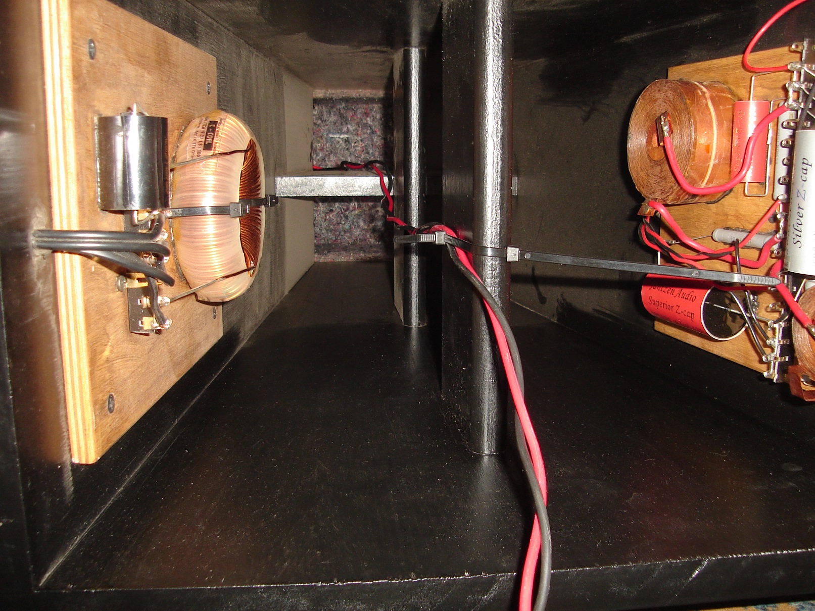

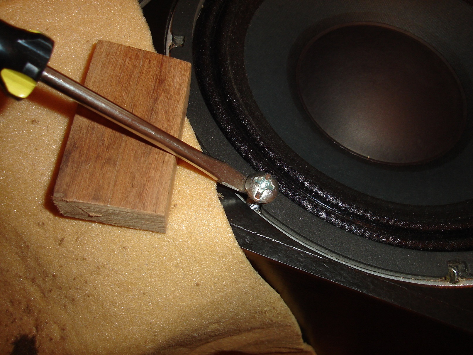

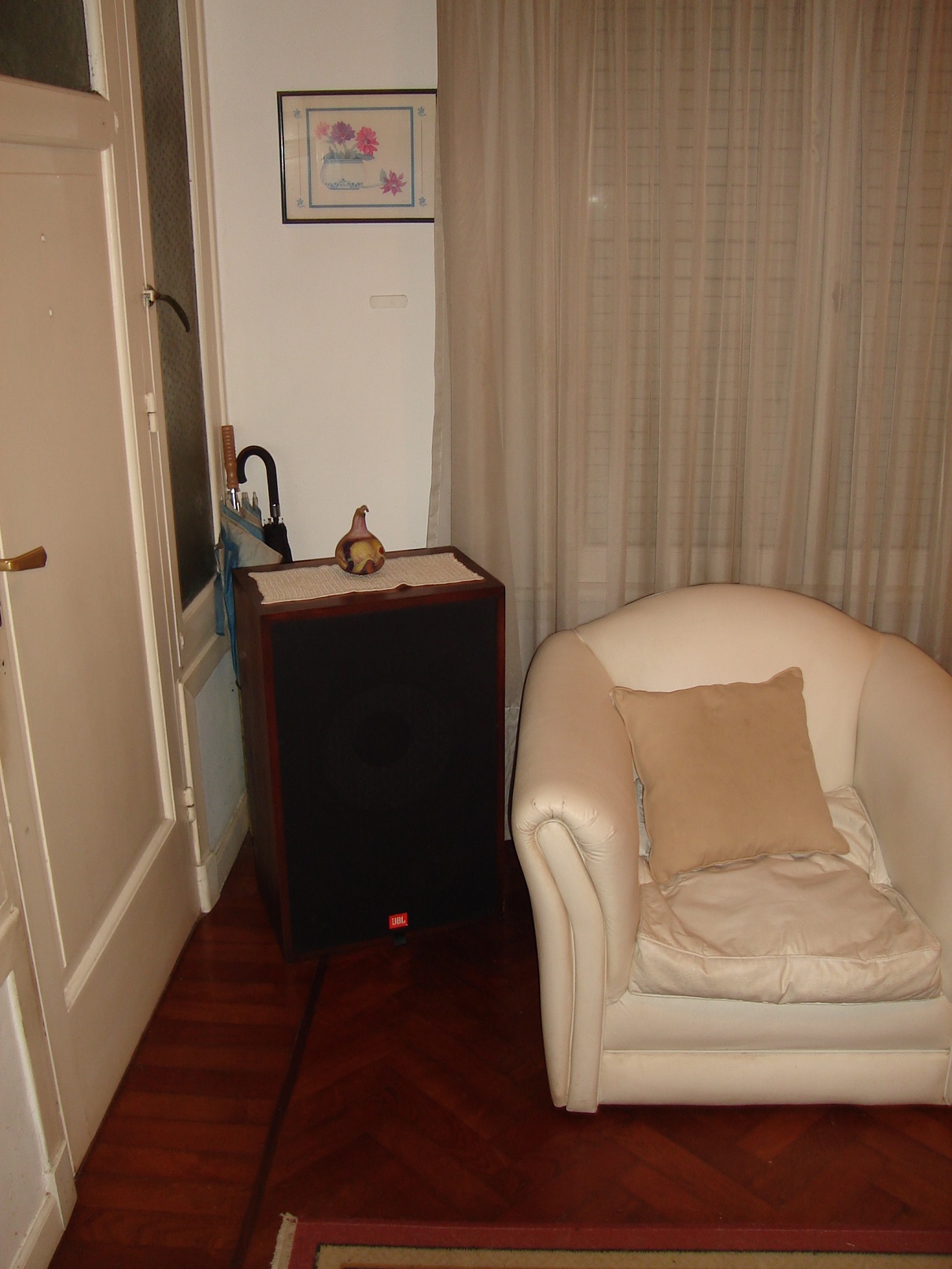

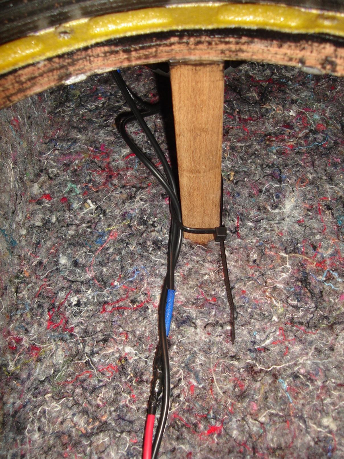

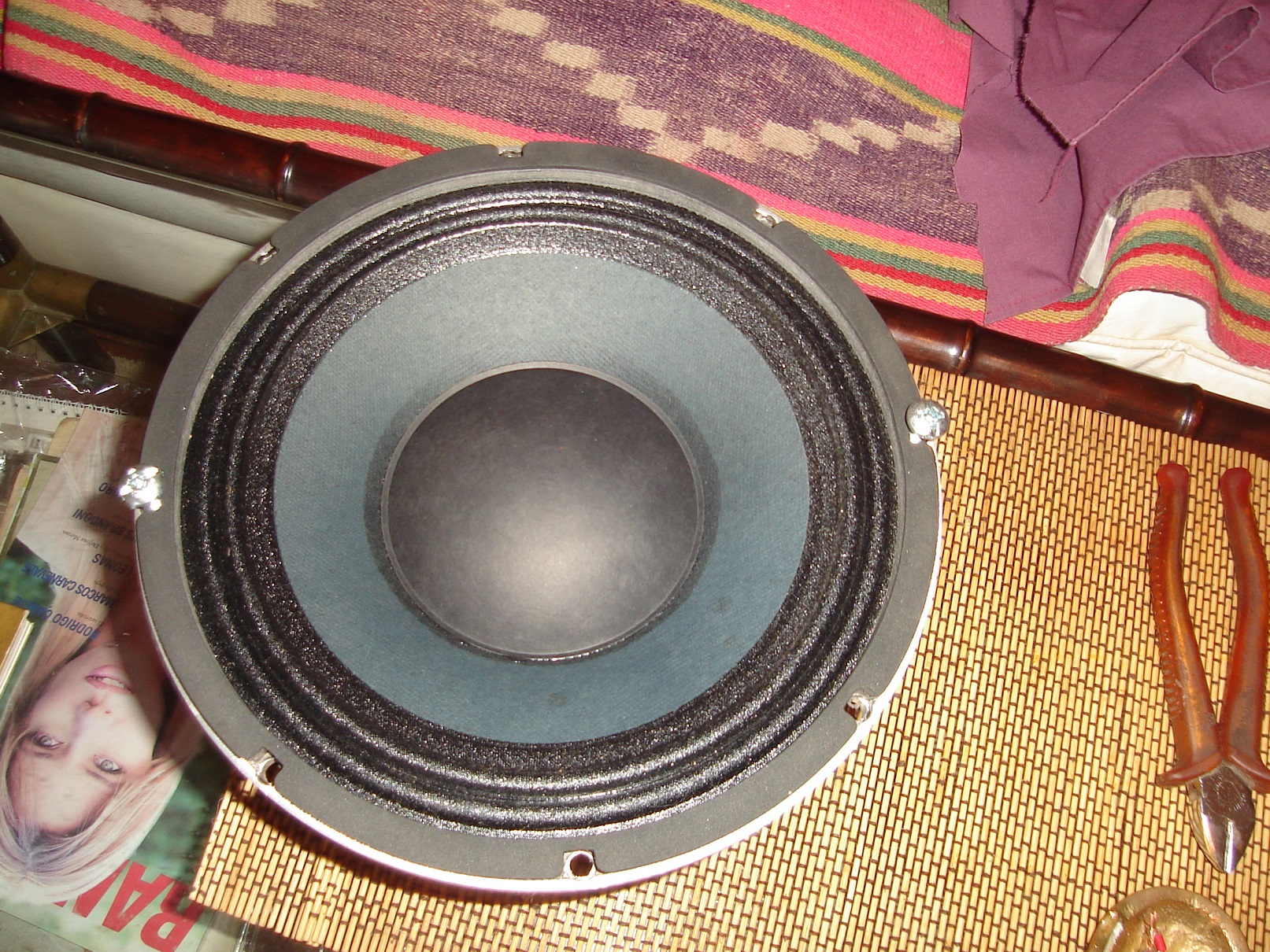

Subwoofer experiment photo show
Will not be too many ?
