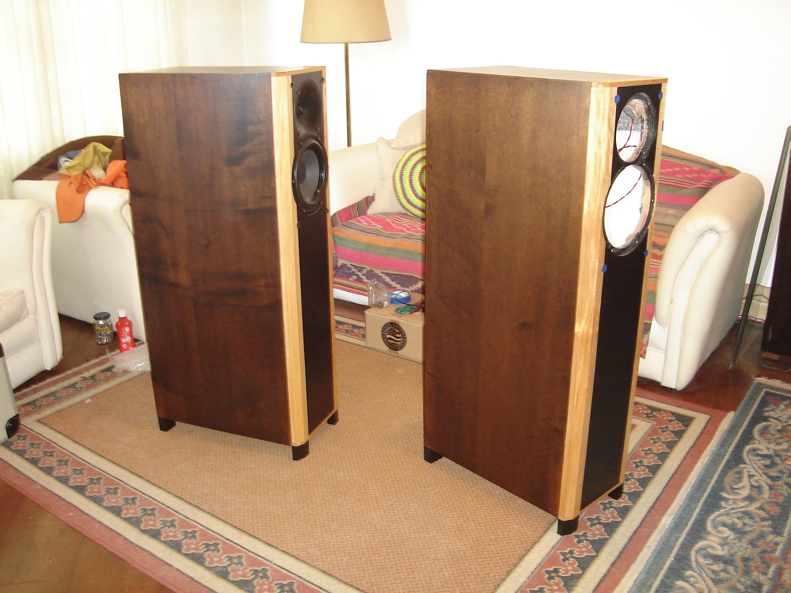

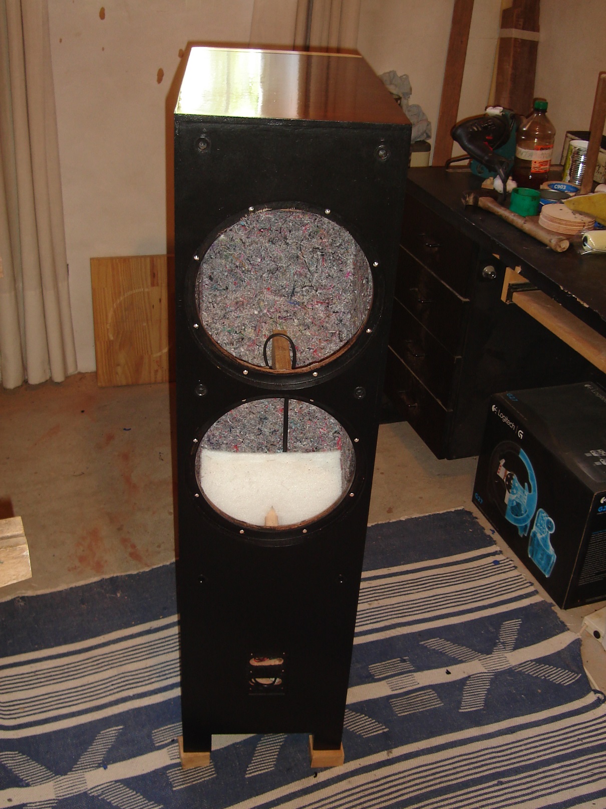

The painting process is finished, the cabinets are drying, tomorrow they are lowered (I am in the heights of the house) to the place of listening and the installation of the drivers and terminal panel of connection begins.
To weld and screw! This part will be a lot more fun than painting! 😀

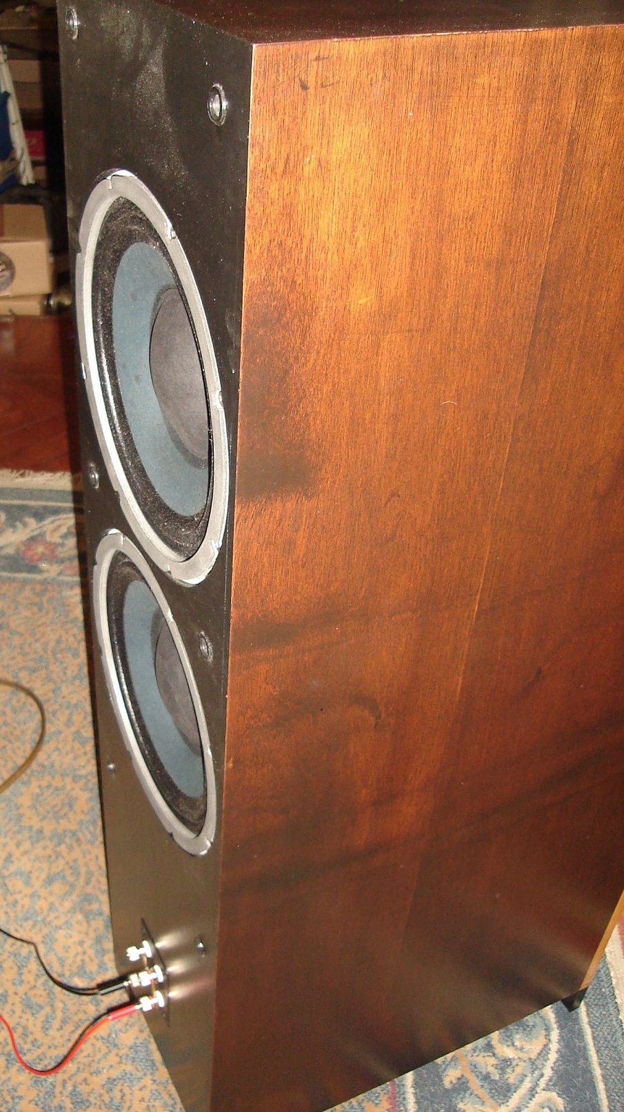

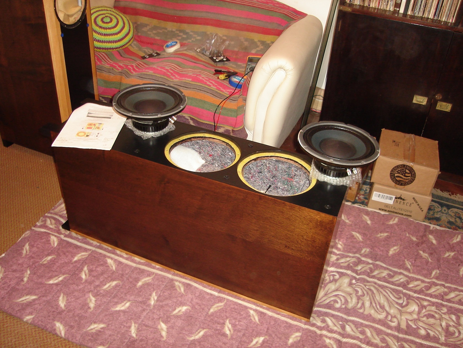

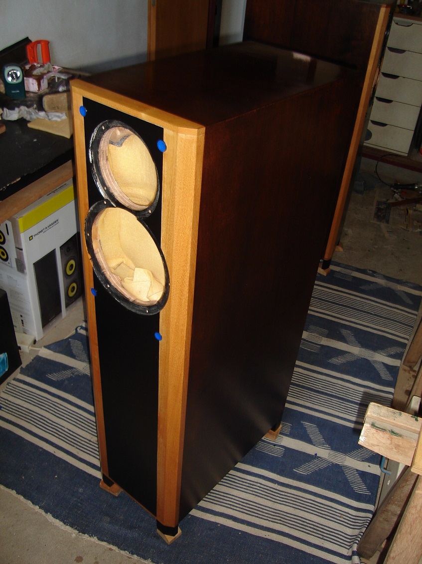

Only the Eminence Deltalite 2510 II speakers installed.

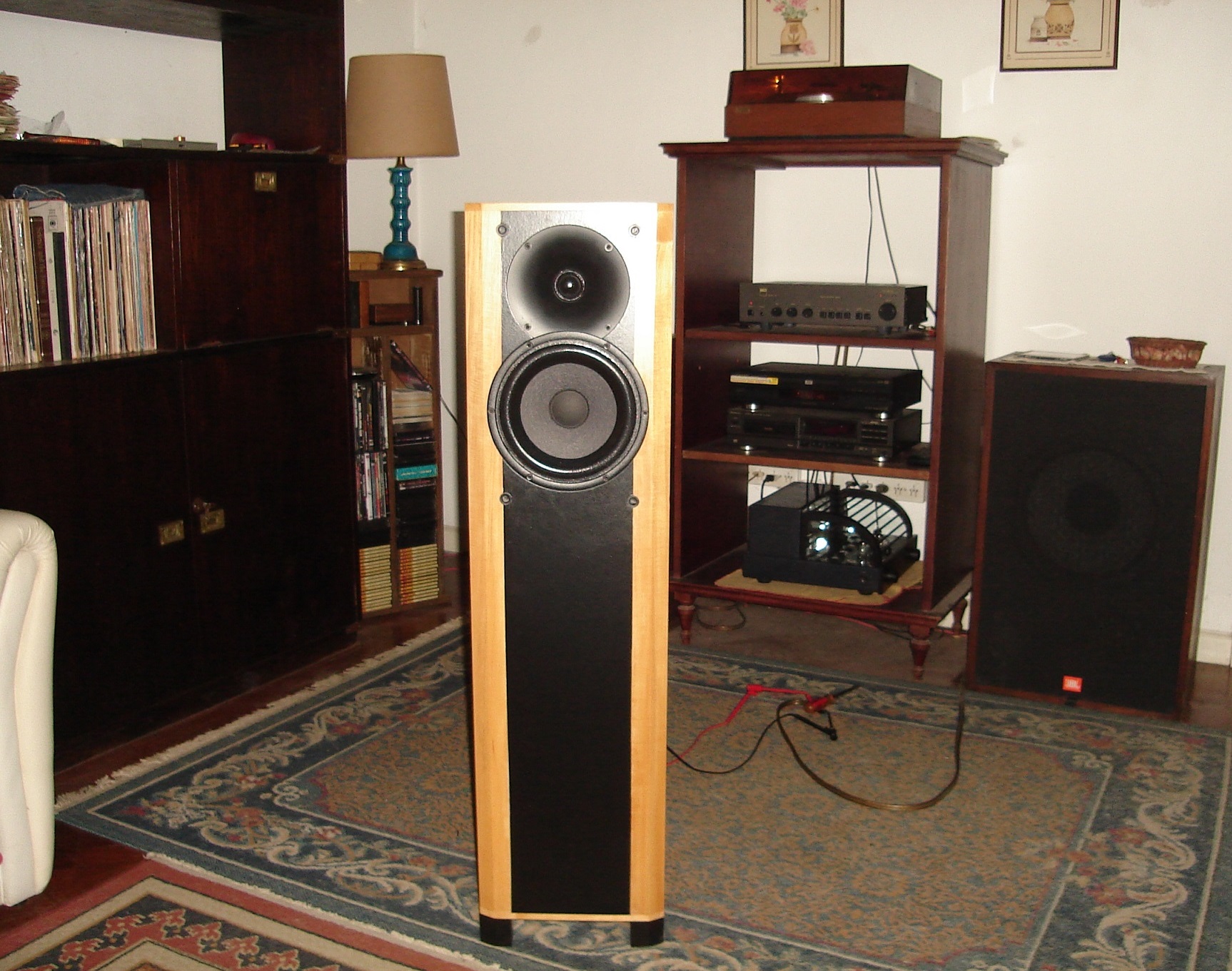

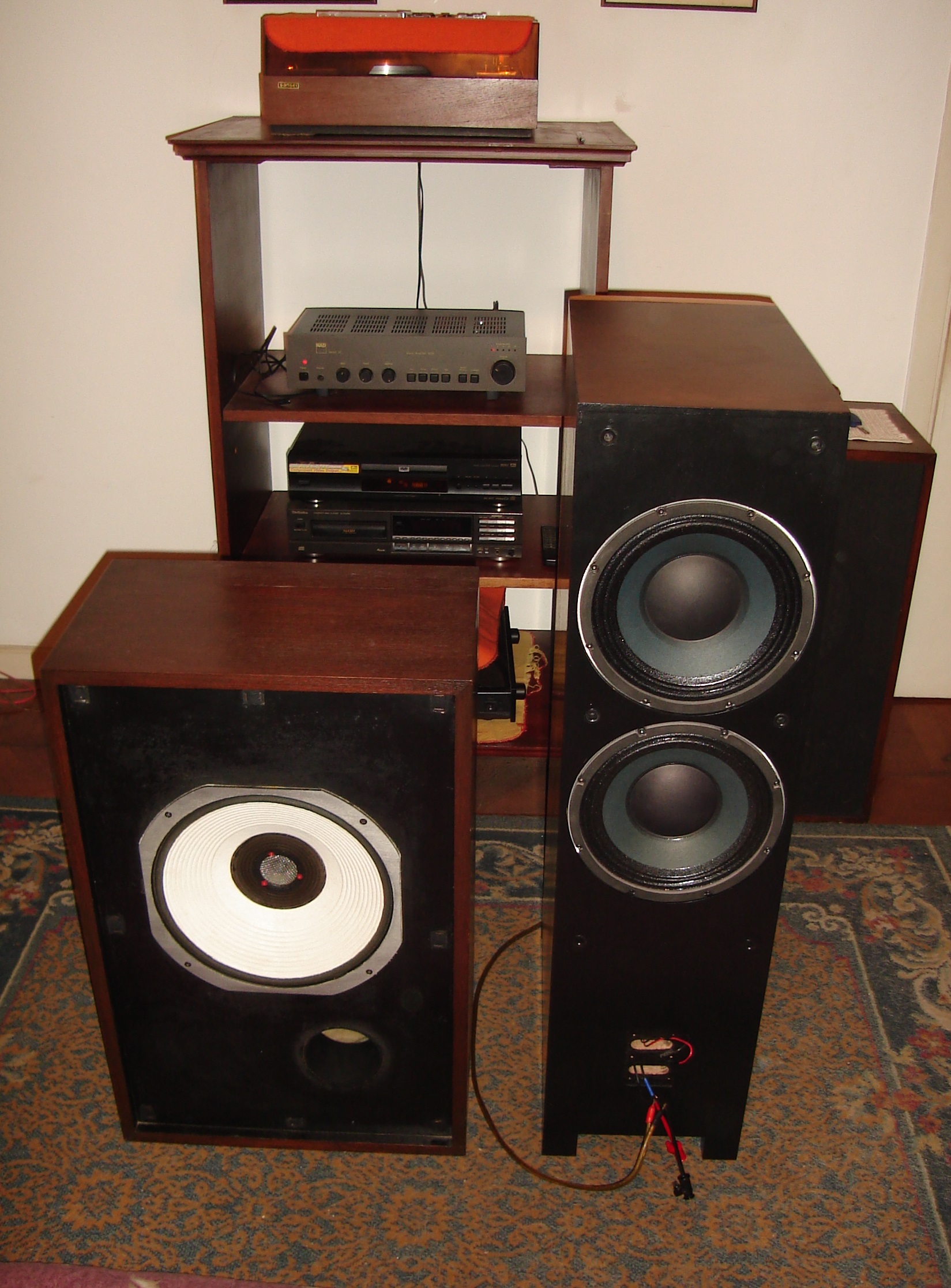

I made a comparison with the JBL vintage LE14C .....

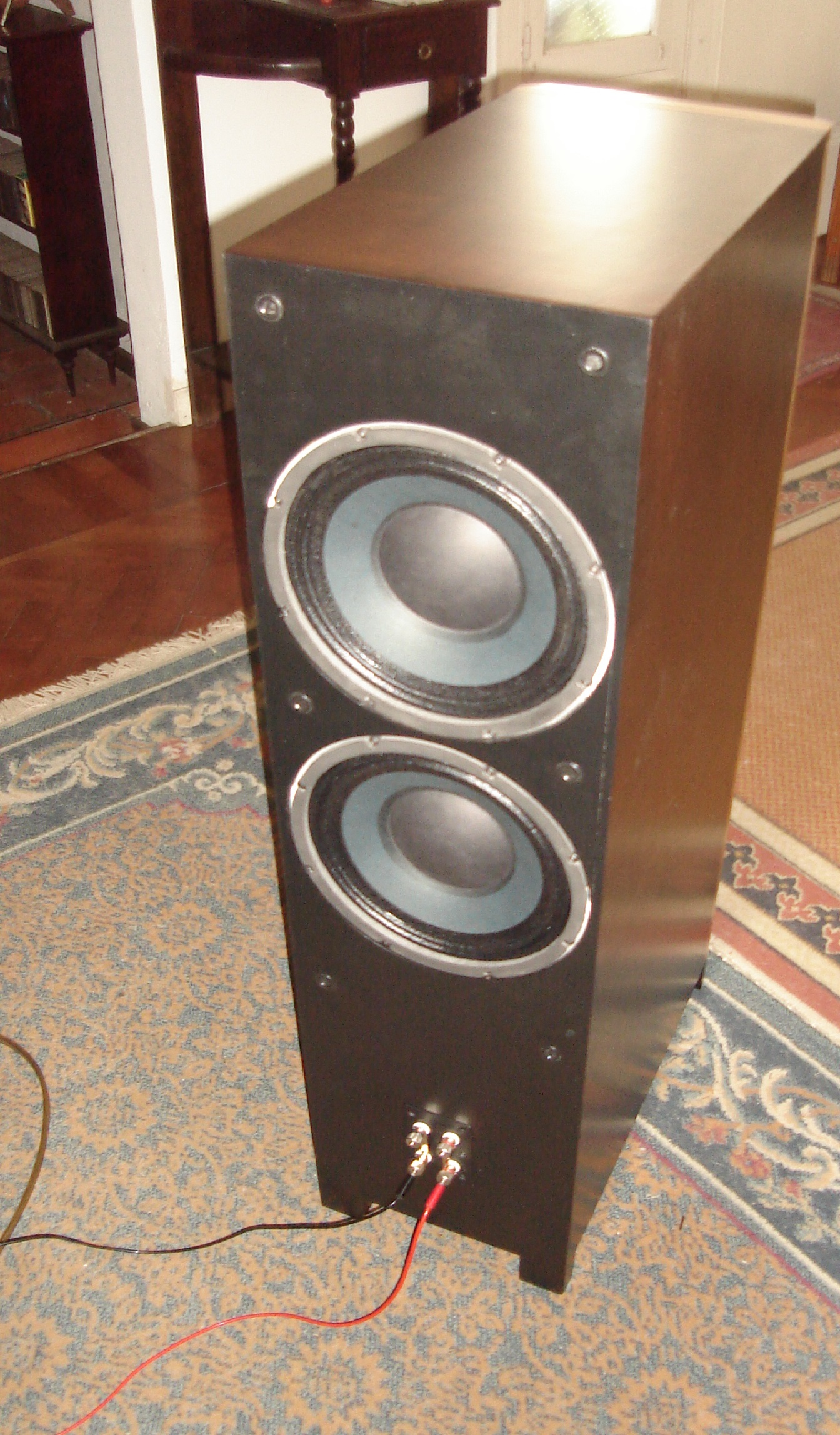

Surprise! Or not ? The bass in the DTQWTII shine by their absence ....... what is happening here ? 😱
Any idea about it ? 😉
Perhaps open holes in place of midwoofer and tweeter?
TBH, the DTQWT is a crazy design of Troels Gravesen and hard to understand. I wouldn't be surprised when it finally doesn't come up to expectations. At least the 18 mH coil in the woofer filter and the acoustic interaction of woofers and midwoofer give raise to doubts. But let's hope the best. 🙂

Well, this beautiful result makes up/compensates for every drop of sweat! 🙂
About bass, probably the DTQWT will make bass only with all three bass speakers in place and connected to amplifier/crossover (I don't know if you tested only with Eminences or with the 8008 too), and/or with the Eminences fully "burned up", since their suspension is hard when new. Some new builders complains with that.
But I don't surprise if the total bass SPL perceived is a little less than one bass reflex (even with Eminenced fully "cured"), since most bass reflex desings have a bass hump, and a large group delay and distortion, different from TQWT, and results in different bass timbre (I prefer the sound of TQWT, is more realist to acoustical bass instruments).
EDIT: I don't have the Eminences but in forums is common the suspension issue.
Answer to Dizzi and DIYbras:
(This goes out like San Google, I have little time now and there will be a bug review on my part)

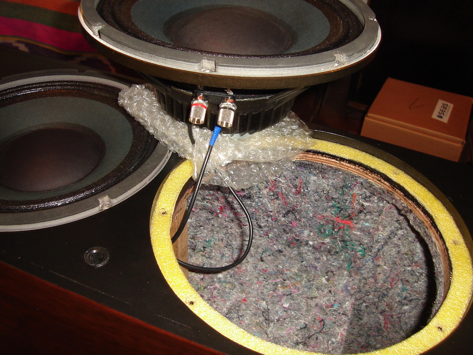

Ufffff, testing the rear speakers just was not a good idea. I figured it could somehow be low in the style of an OB, but this design works totally different.
Yes, the point was that without the front drivers the backwave of the speakers Eminence escaped on all sides but with strange turbulences, oblivious to the design expected.
The coil reinforces Troels as the lower octaves, I think.
But obviously everything is ready with the cabinet closed.

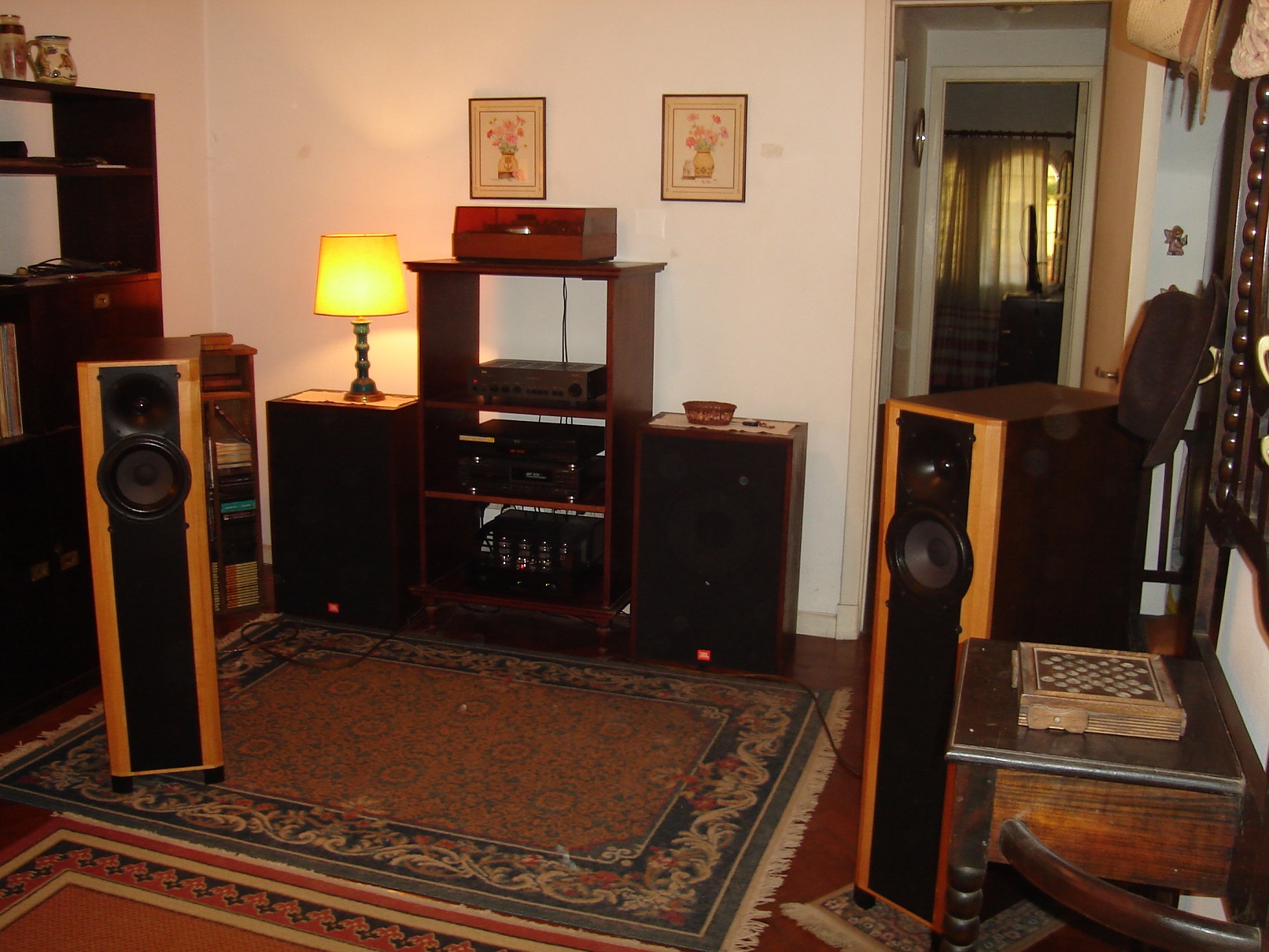

I finished one of the two boxes and tried it with recordings that I know well.
For this I used the amplifier SS, things will be much better with the valve, but the result is excellent!
As Diybras says, the basses are very ditintos to those of a bass reflex design. They are less bombastic, but have cleanliness, definition and speed. As always, it is very difficult to describe the sound in words. The middle range low, medium low and high is excellent, rich in details and the instruments and voices sound natural and rich in nuances, details have appeared, many details that give great wealth to the music in that range.
The integration achieved between JA8008 and TW034 is perfect.
In short, this promises much more when you finish the other box and feed the whole system with vacuum valves.
I did not hear in this preliminary test string instruments like a double bass in a jazz ensemble. That will be for the end, and with all the artillery in operation. But I know he will not disappoint me, when I consulted Troels about the seriousness of the DTQWTII, his response was "dry and fast." It is what I look for in that range, to feel the fingers of the performer when playing with the four strings, not a cloying mix of bass notes with absence of harmonicas.
I'll tell you more, thanks for your opinions ! 😉

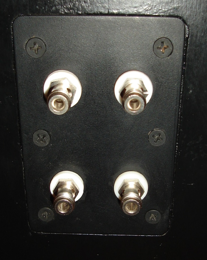

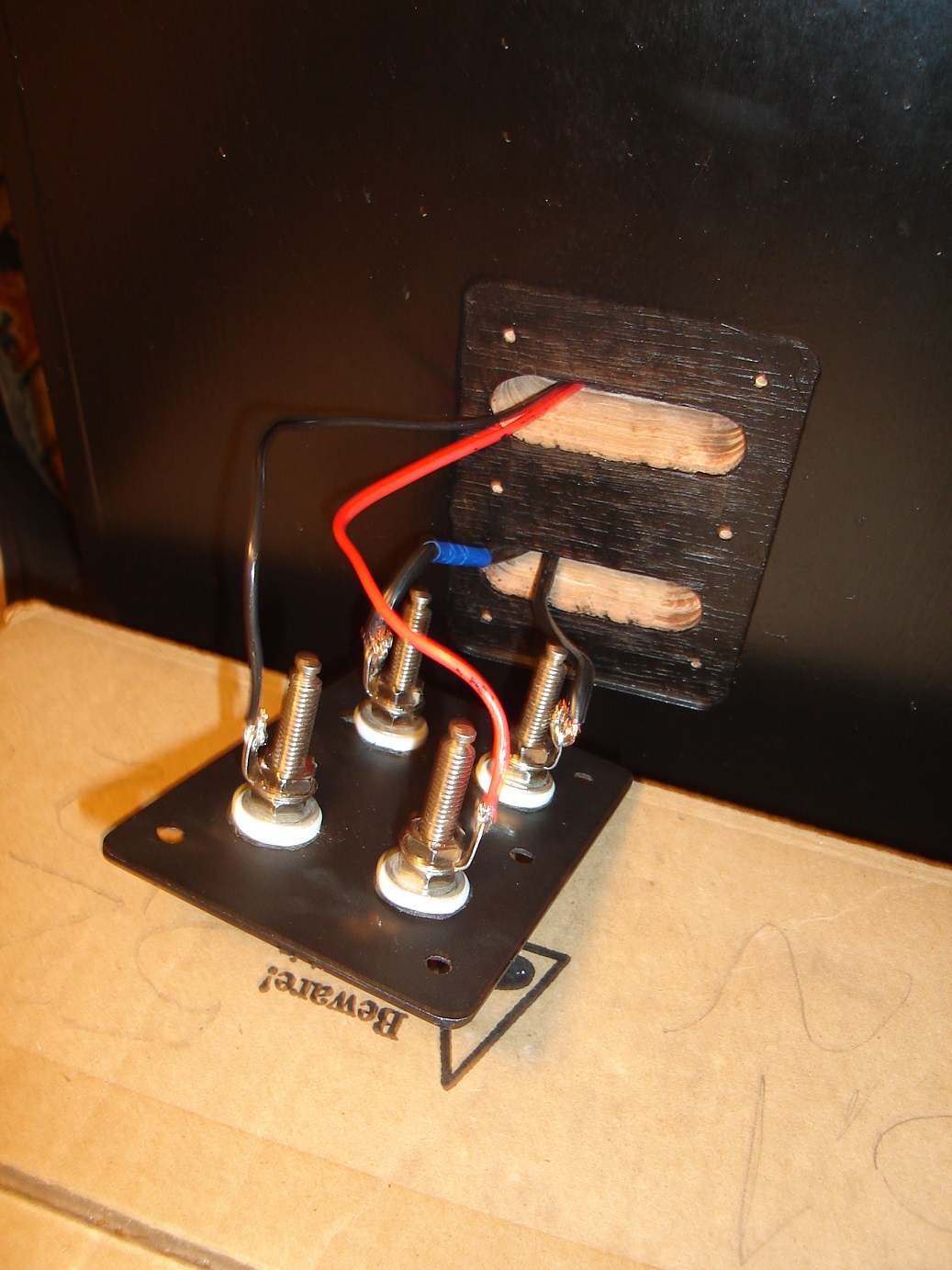

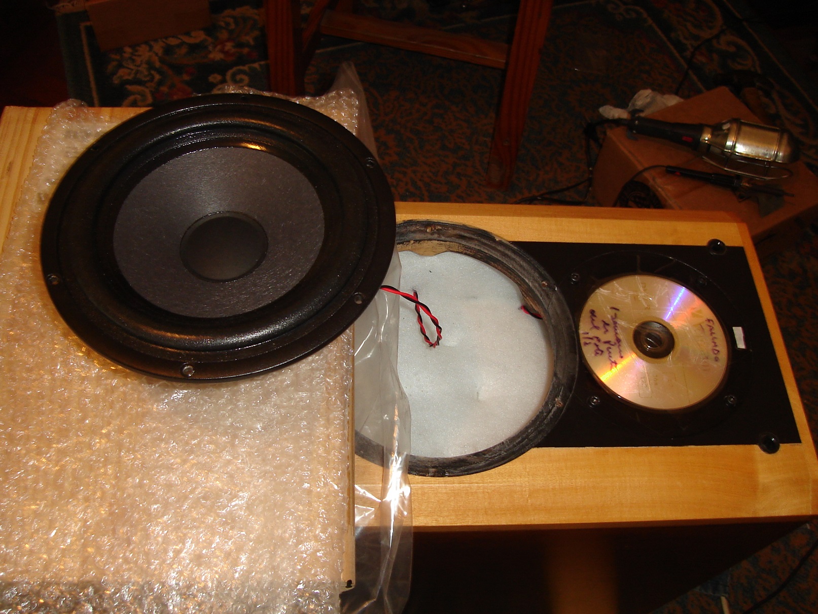

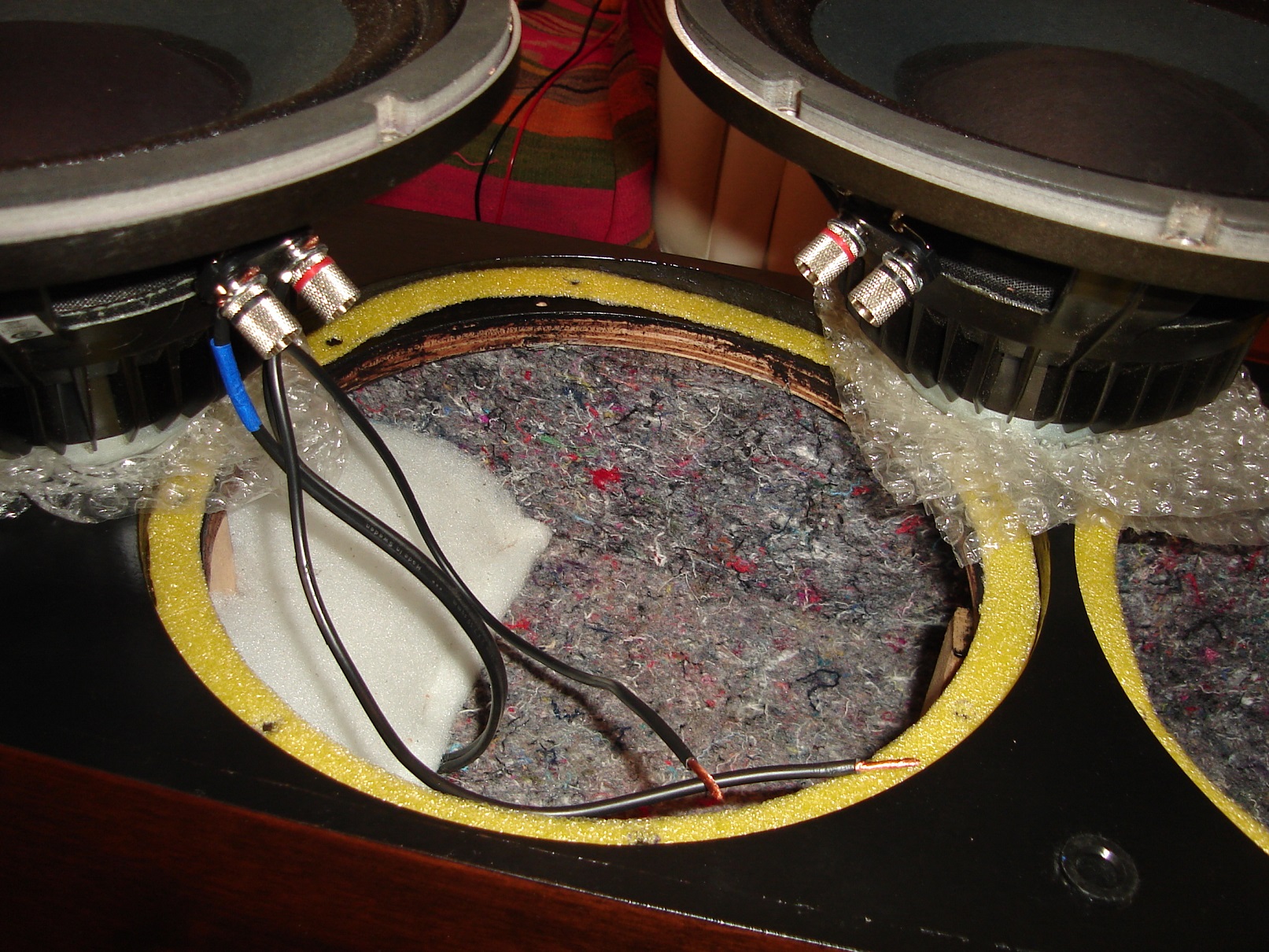

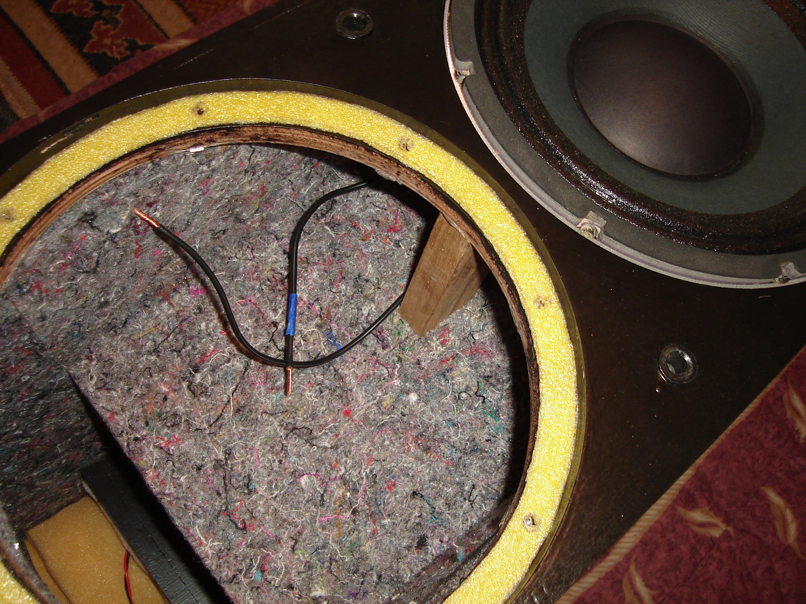

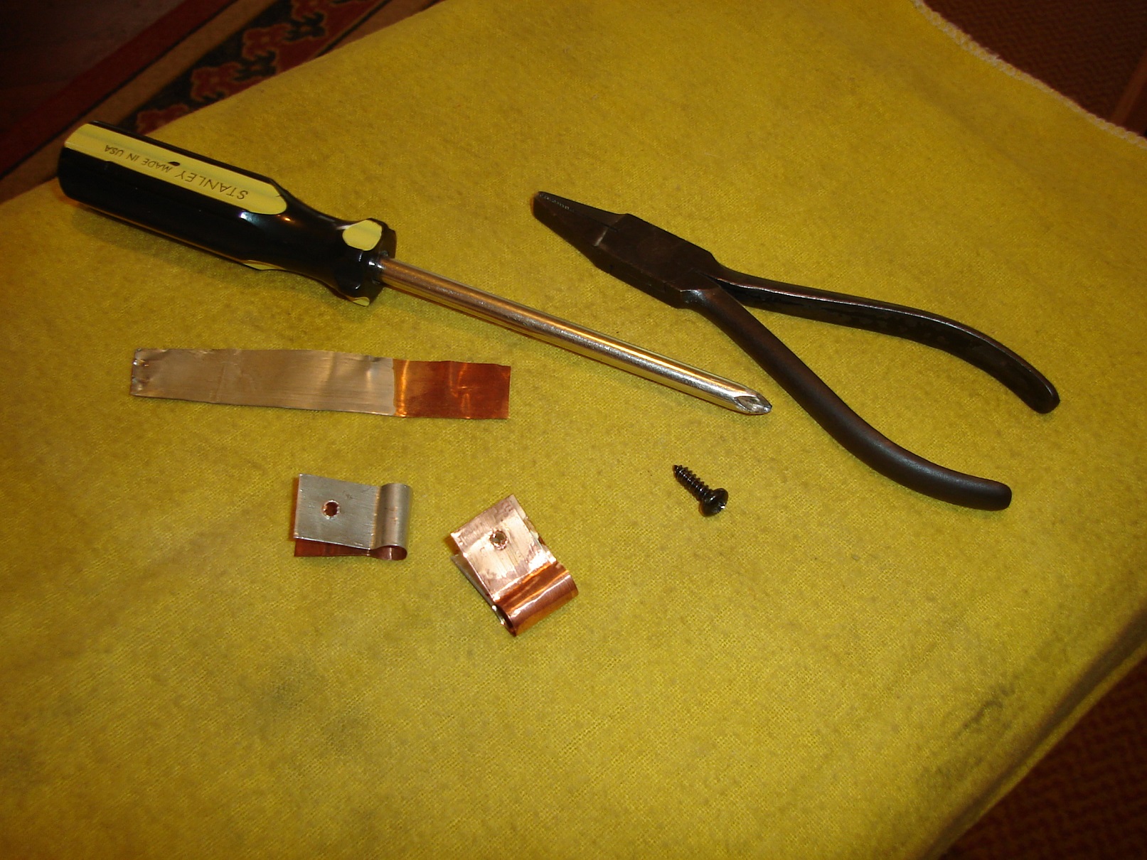

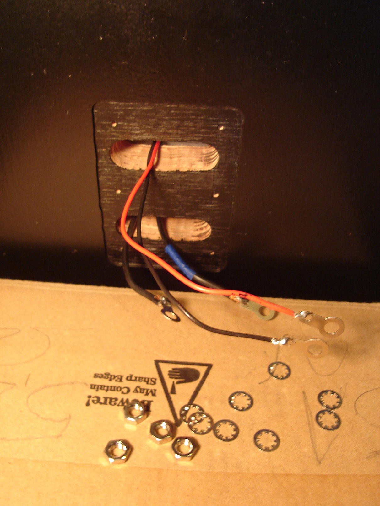

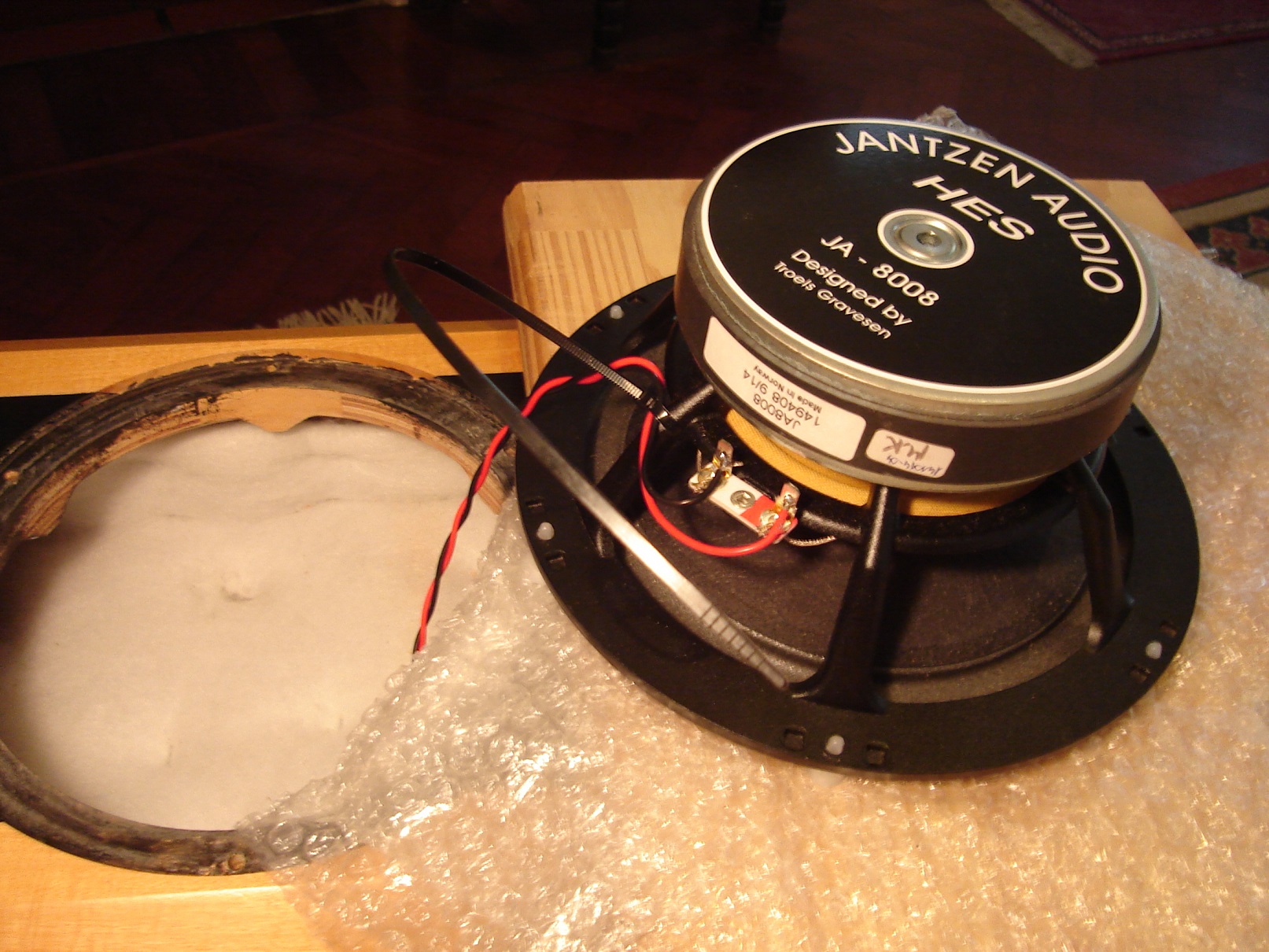

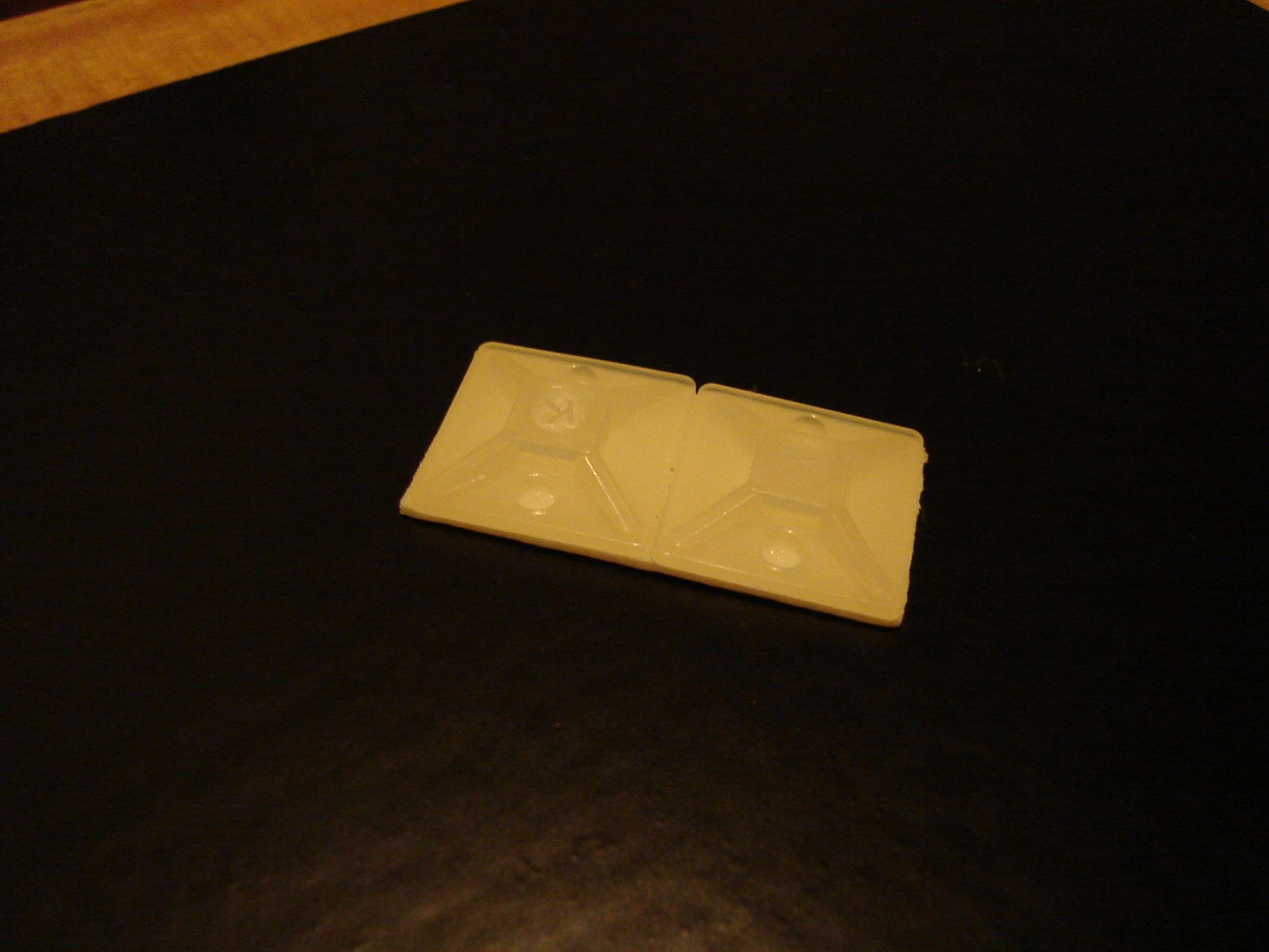

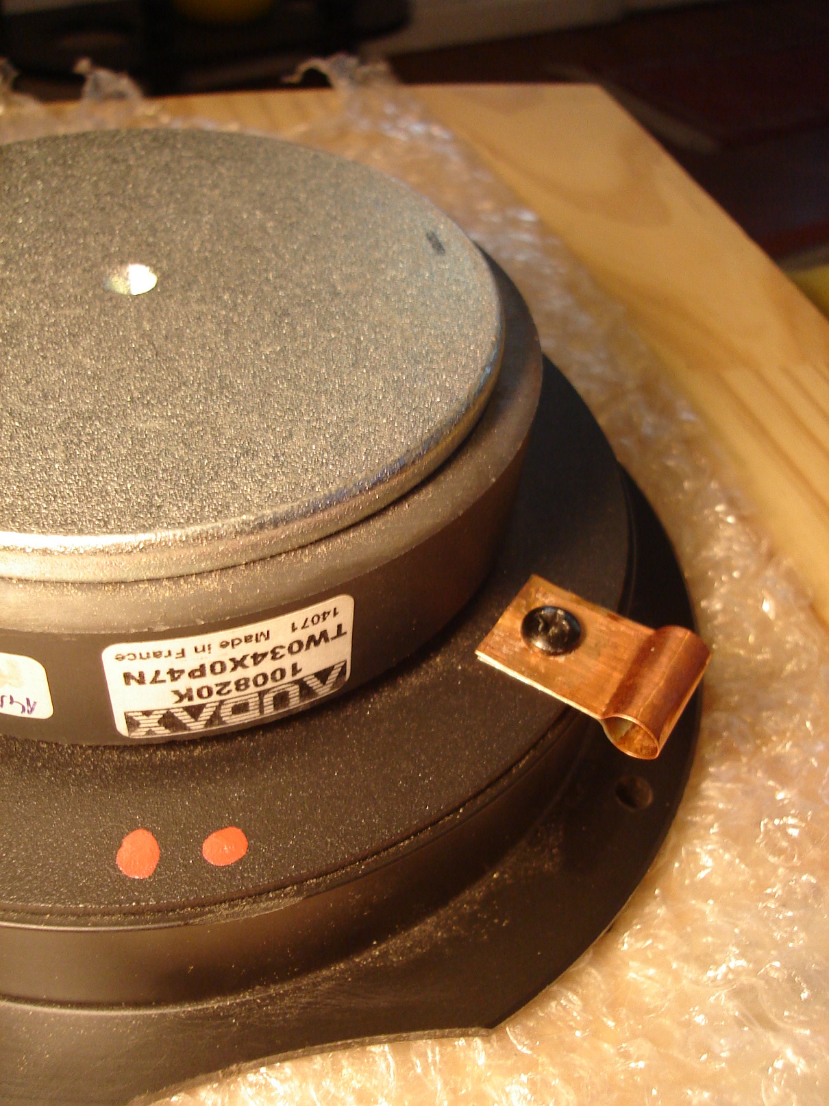

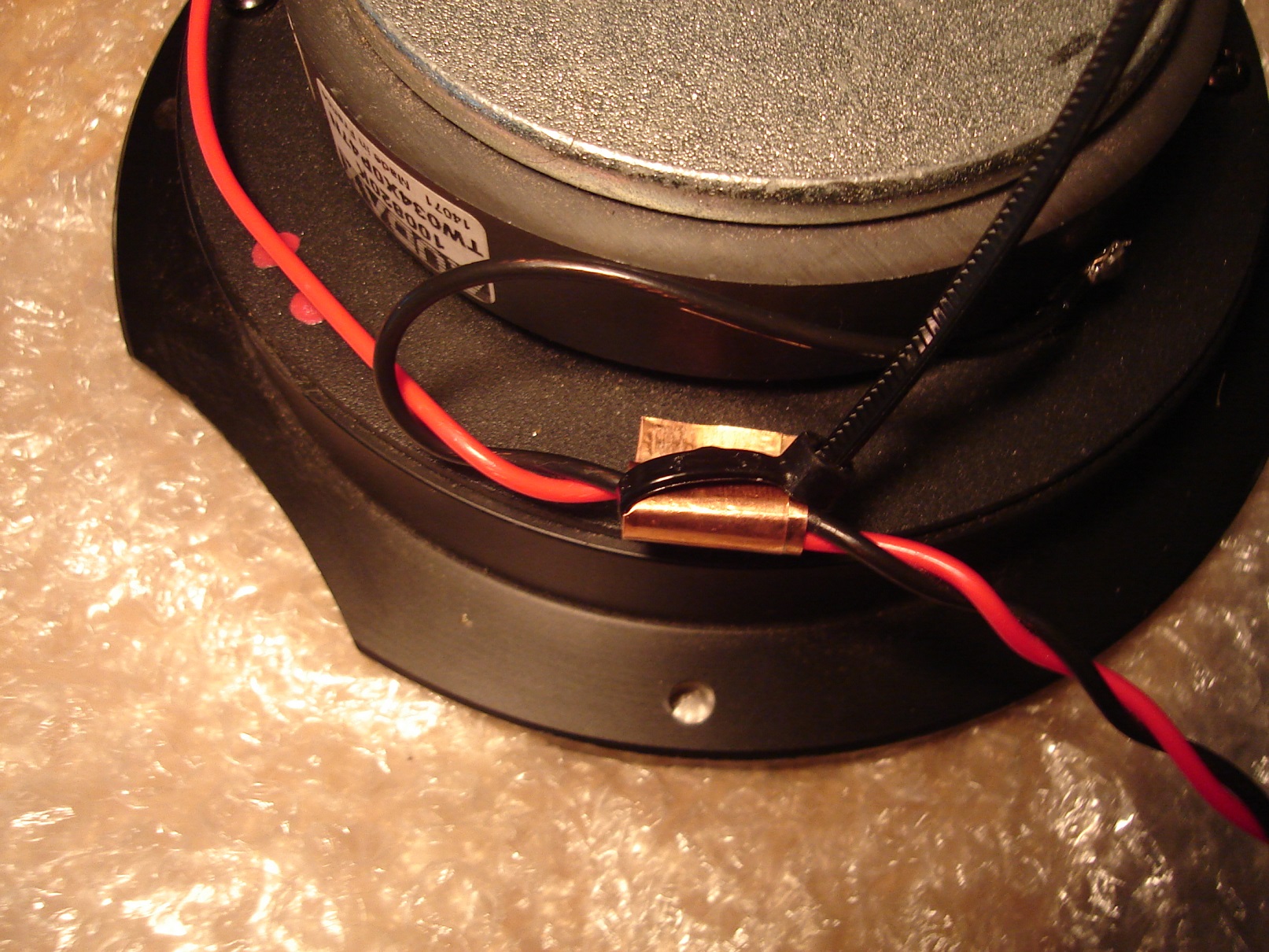

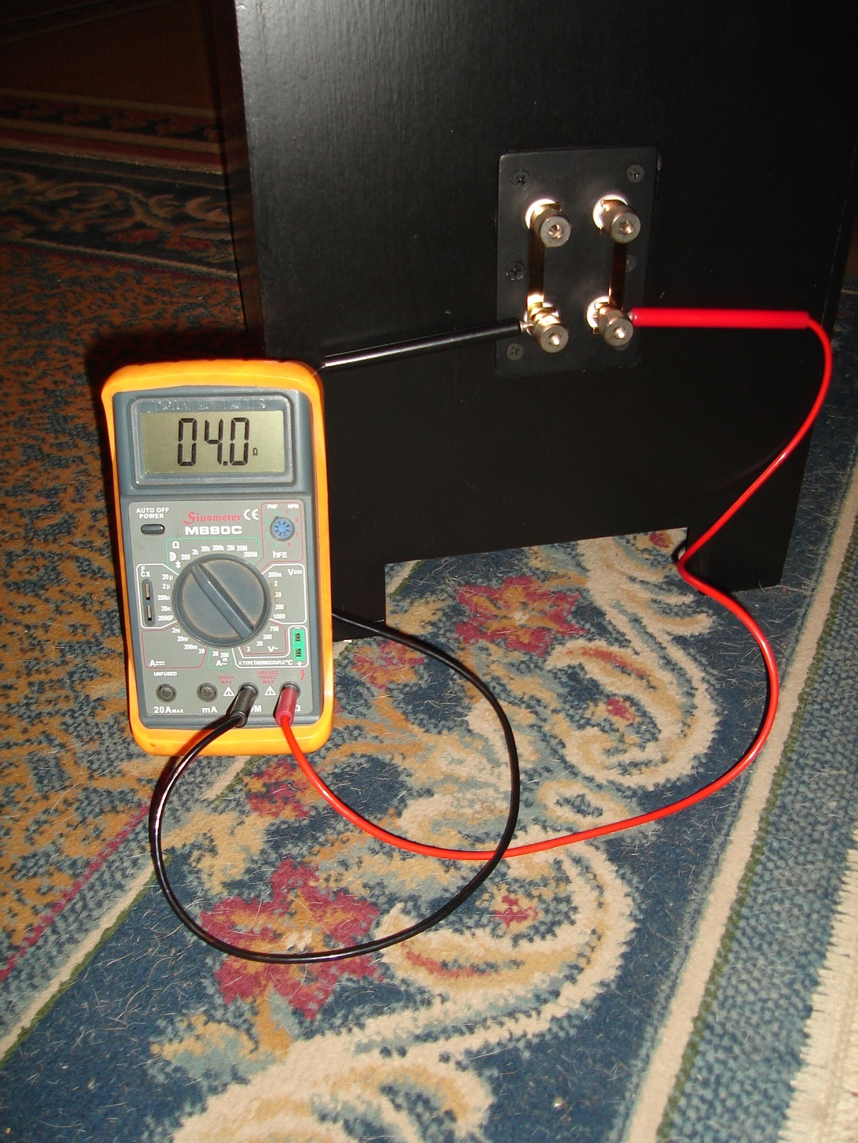

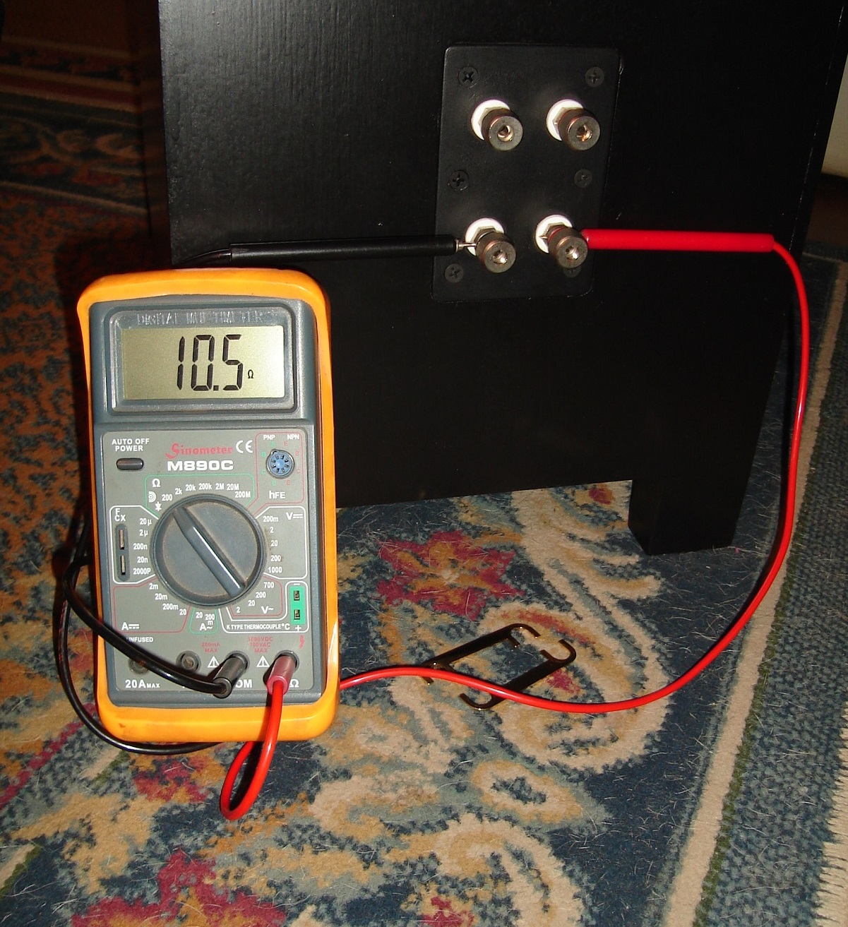

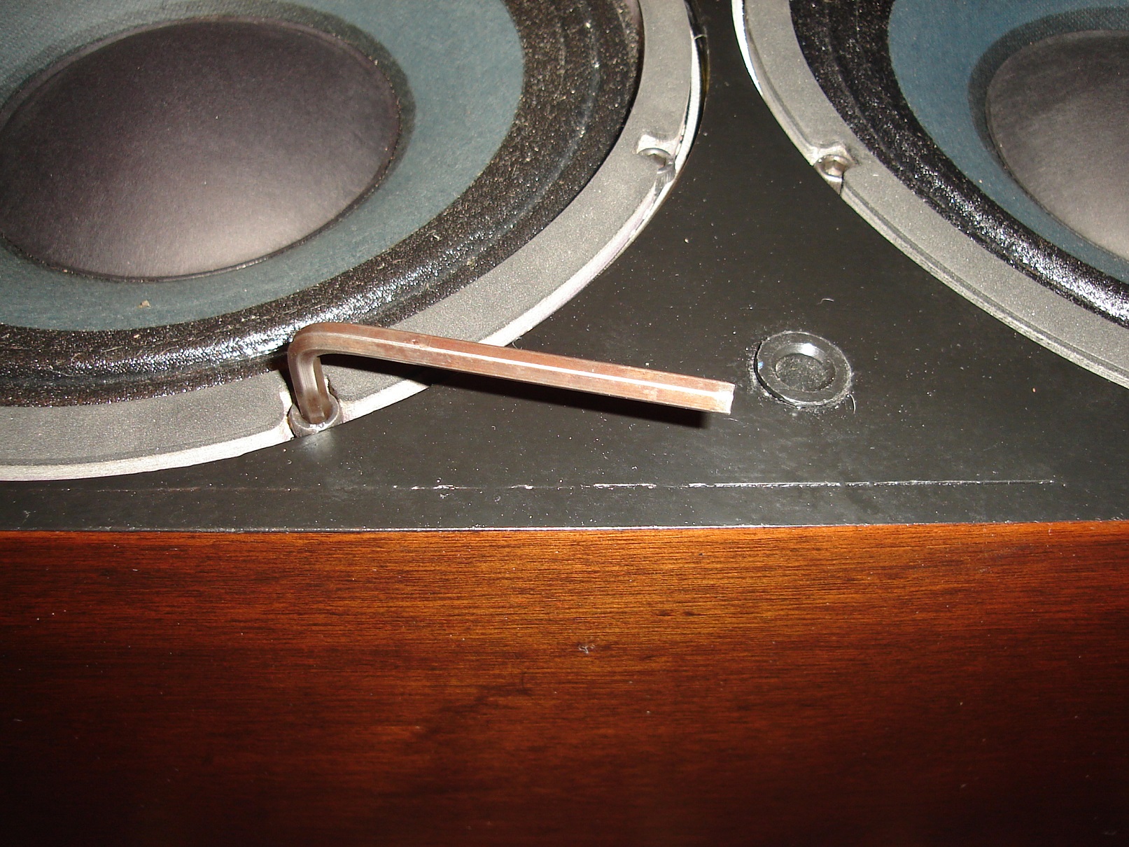

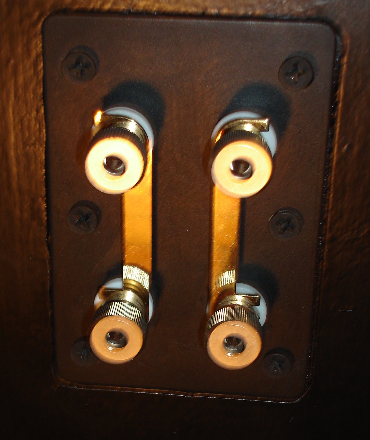

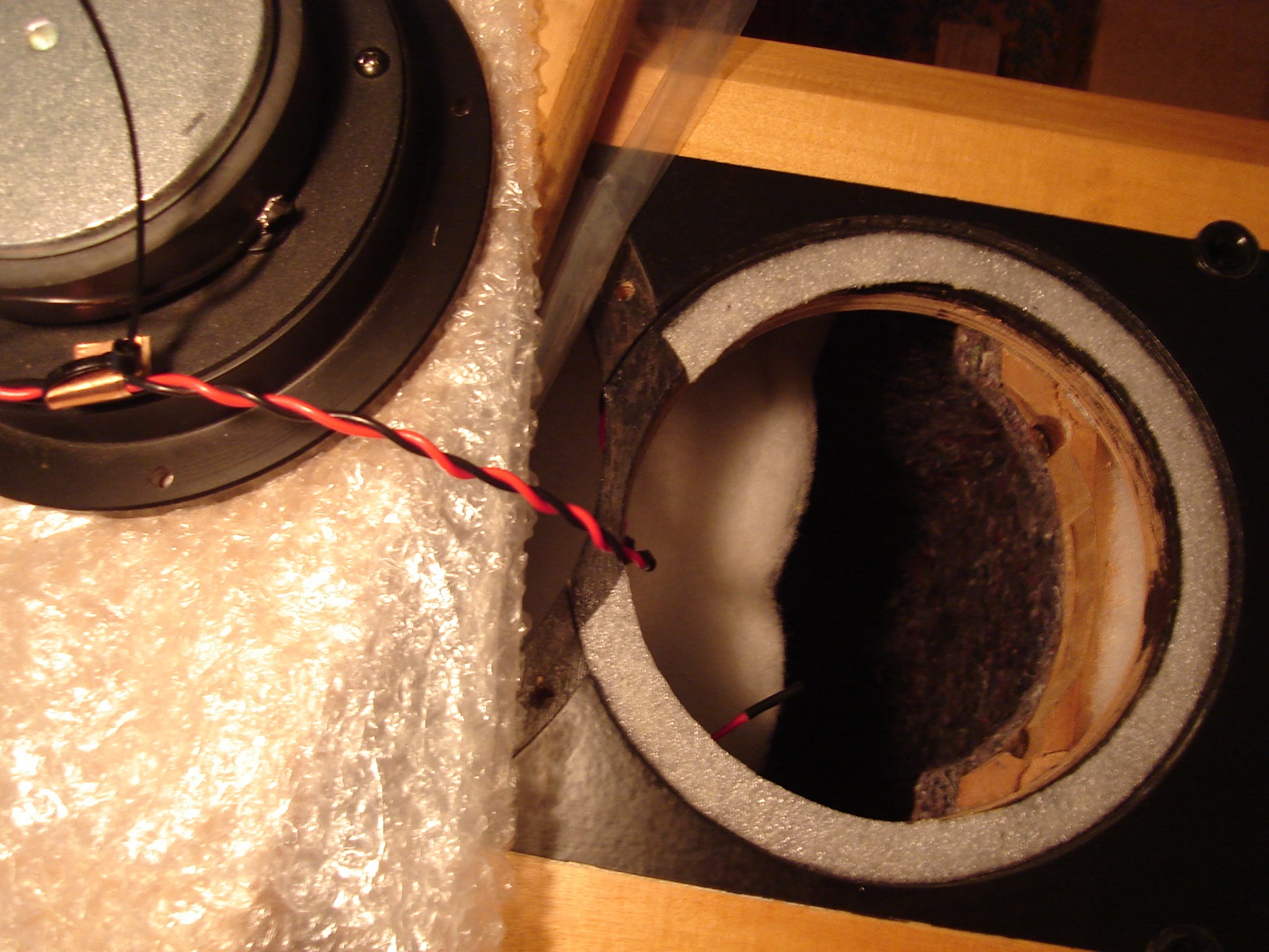

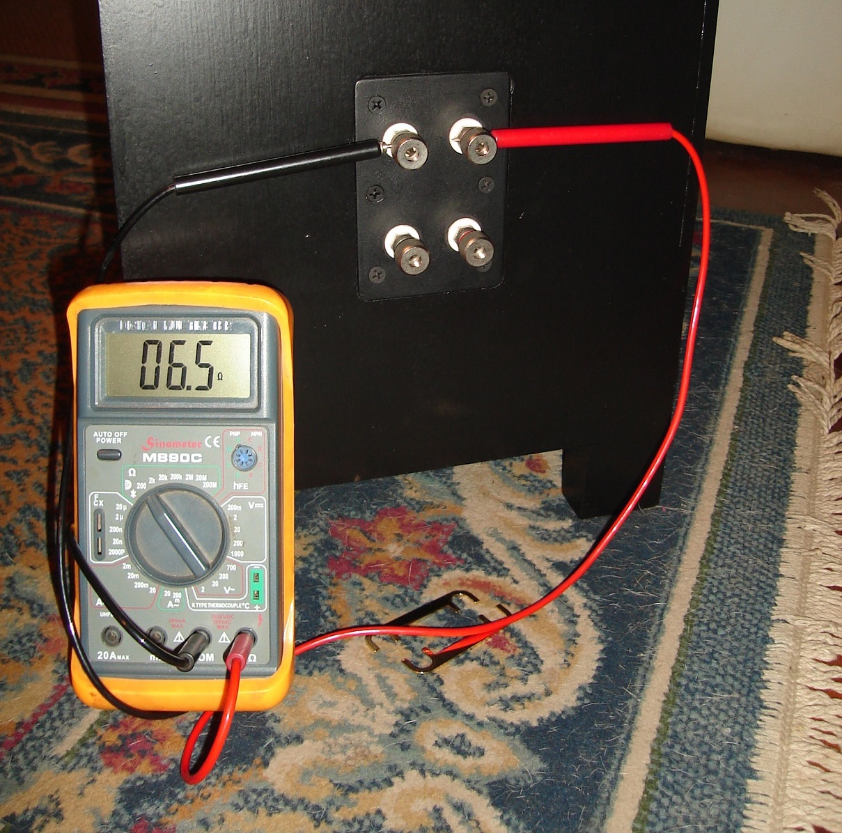

I forgot to upload the photos of the installation of the front panel drivers and the binding posts.
These cables are good quality but very hard and difficult to peel! Then, it is essential that they do not put pressure on the connection terminals, could break with the manipulation. You have to fix them first. Then mold them by hand to bring them to their correct position and finally solder! Do not do it the other way around! 🙁
As you can see, I have not had much confidence in the gadget that came with the kit to fix the tweeters cables.
The glue of double tapes does not usually be as durable and would be a complication if it were detached in the future. So I have prepared this accessory with leftovers from the wax coils. Copper is a non-magnetic metal, better then, given the proximity to the ceramic magnet of the speaker. This is voodu audio? 😱
Another point was the boards I had prepared for these drivers. I only used one of them to supplement one of the tweeters, which was somewhat sunken in its housing. it's not important anyway, just a detail of manic perfectionist ....😀

Anyway, I had many experiences to evaluate this DTQWTII.
Ear training calls it, even if we do not have auditory memory, we know what we are looking for.
DTQWTII is a great speaker, natural sound, good dynamics, details, etc. The sound comes out of the boxes but it does not stay locked, it floats in the air. As it should be.
Is good to suspend the tweeter wire since the terminals are very fragile. Even with something not 100% secure, since even so most mechanical force will be directed to it. Of course is only problematic during the construction phase. I don't used this in mine.I forgot to upload the photos of the installation of the front panel drivers and the binding posts.

I decided to measure the impedance (resistance actually, as we know the impedance is always greater because it is a value that is usually measured at 1000 hz, (there are exceptions to this, some twofers measure them at 400 hz and some tweeters at 4000 hz) And it varies constantly according to the signal applied. Basically, the inductance starts playing and in very small proportion the capacitance.
But I do not intend to go over here concepts of Ohm's Law on how inductive reactance or capacitive reactance is calculated, or the combination of both with resistance, etc.)
I just wanted to check the load that the amplifier sees to select the correct connection with the output transformer of my valvular amplifier.
So we have the following measurements.
10.5 ohms for the bass sector,
6.5 ohms for bass, mid and treble
Applying Ohm's Law for resistors of different value in parallel, we have 4.014 Ohms.
My amplifier has (as is standart) two secondary windings, 4 and 8 ohms ....
I have used both connections and for my ears, I have not noticed any differences.
But we know that the best energy transfer is achieved when the impedance matching is optimal, thus obtaining 50% of the energy present in the primary. The rest is lost in the form of heat and other phenomena, I imagine.
In short, which connection would they use? Am I reasoning correctly or is something missing ?
