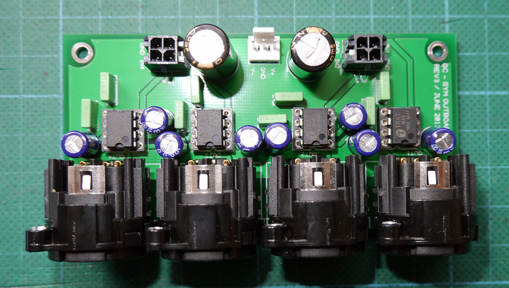

I've made some progress on my build. I'm still standing by for some pcbs to arrive from China to complete it
Jean Claude

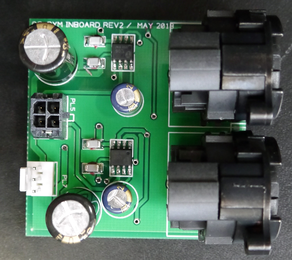

Hey, Jean Claude
Where can i get these fine in/out xlr-pcbs?

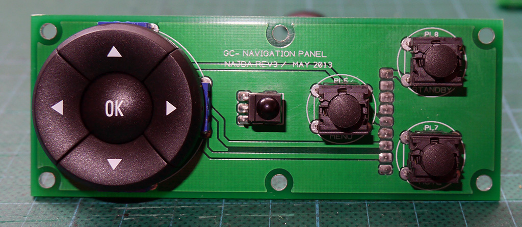

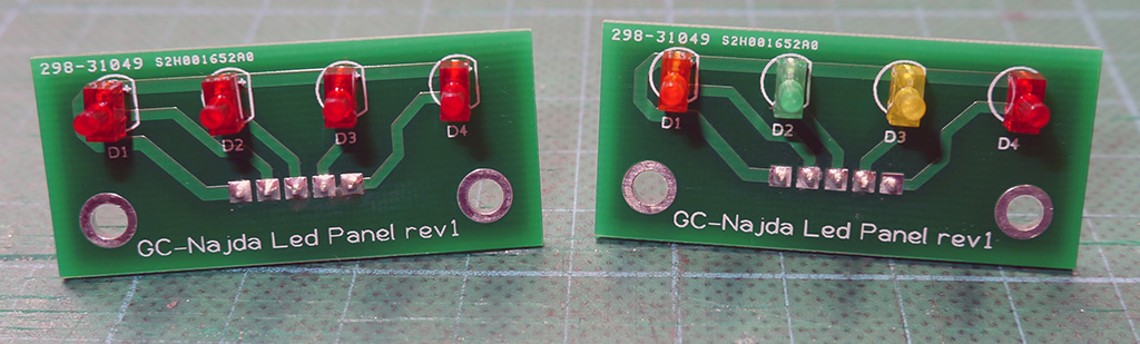

Nick, quick question,
Im using illuminated buttons for the controlpads. Each switch has an LED built in that draws 20ma @3v. In total there are 8 LED's.
Is it possible to power it them off one of the headers on the board?
Thanks.
Hi Beau,
I suppose you'd like to power these leds from the 5V supply rather than from the 3.3 regulated supply. Can you estimate how much current you would draw per led if you were using the 5V supply?
Same here.
... or is it possible to power the LEDs over the dimmable backlight together with the lcd-panel?
Hi Bruno,
The supply for the led backlight is 5V. So it's as above, you need first to estimate how much current you want to draw.
It's probably going to be necessary to add a current-limiting resistor in your both cases. Under this condition, yes, you can power the leds from the available supply onboard.

I wouldn't do that. Using clean regulated supplies to power leds is a waste. The 3.3V supply is mainly intended for the DSP's IOs. These IOs must be powered before the cores get their 1.2V supply.
Also, here's a quick note about the staging of power supplies:
- When you turn on Najda, a certain amount of current goes through the 3.3V regulator.
- If you draw too much current, the 3.3V regulator will keep the 1.2V regulator in power down.
- The 1.2V regulator will tell the micro that it couldn't start.
- The micro will not boot the DSPs.
Frankly, I would do a couple of tests with a resistor in series with one led and a 5V supply. Keep raising the value of the resistor (you could use a pot) until you're happy with the amount of light the led emits. I suppose you want the buttons to be visible in the dark and that you don't want to illuminate your home with these leds, so you should be able to keep the current low.
Once you have determined the proper resistance value, you can measure the current per led. If you can keep it below 100 mA for all leds, then you can power them from the 5V supply.

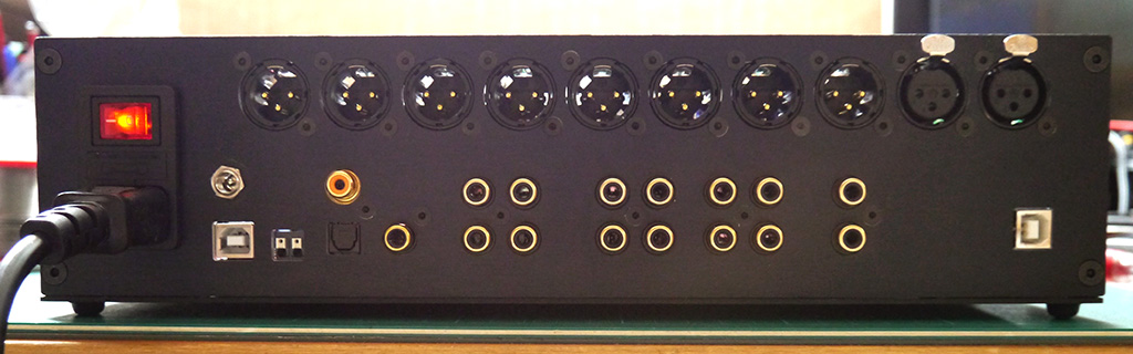

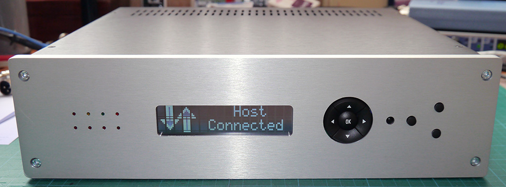

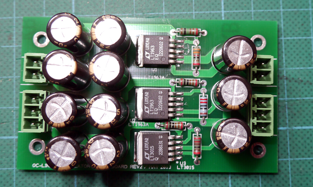

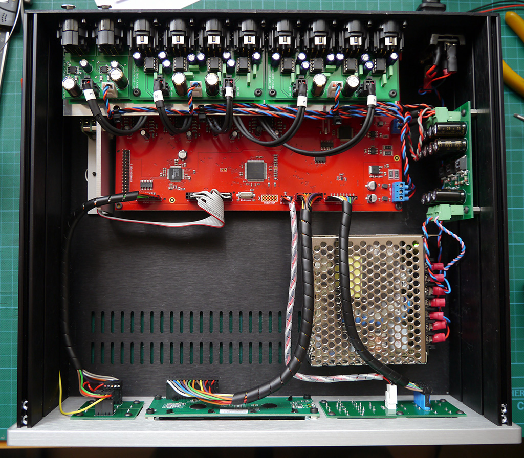

I've now completed my Najda build :
full symetrical inputs/outputs
Amanero + isolator
+5 & +/-12 linear regulators
Now, it's time to go ahead in the real world...
