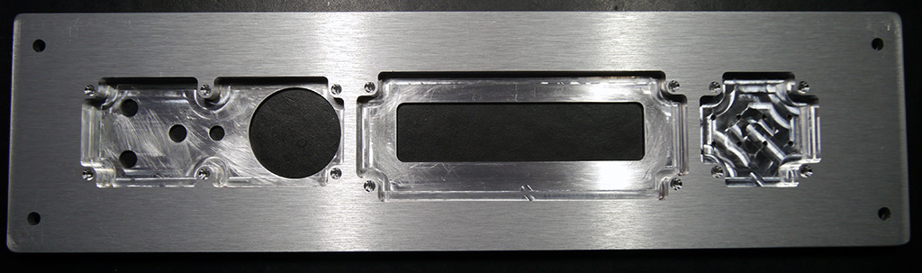

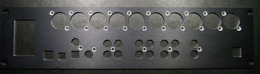

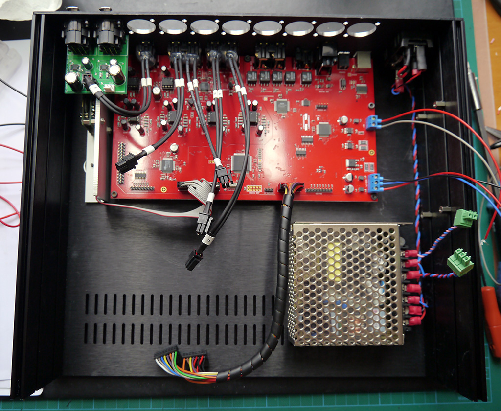

I've made some progress on my build. I'm still standing by for some pcbs to arrive from China to complete it
Jean Claude
Looking at it again, really very nice. Where did you have your panels machined?
Well I sent dxf files to Hifi2000 (modushop) in Italy and they did it for me but, the price for the box (GX388) jumped from 65 € to 200 € including VAT but excluding shipping.
Here are the front and rear plates
About DSP resources saving, if it's not possible or too complicated to have a pool of resources that could be shared between channels, then having the possibilities to disable individuals channels could be a solution.
That's really very nice, thanks for posting. The price is indeed expensive, but you have requested complicated work as well (compared to simple circular or rectangular cuts) so that looks like a fair deal.
