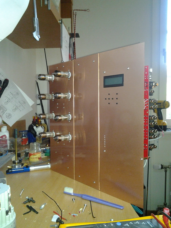

Hello Jcga,
Is there a chance to get the dcx files for the front and rear panels from you?
A hopefull Najda user....
Hello Jcga,
No problem to share the dxf files but I want to check first with the remaining pcbs supposed to arrive home this week.
Jean Claude

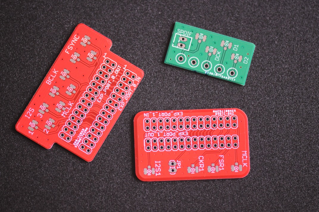

I've made two U.FL adapter board for exp. port 0 and 1. I've got 10 each...
If someone need it just drop me a line.
Hi Michele,
Looks very nice !
I sent you an Email
Best
Jean Claude
Looks good indeed! What's the little green one?
That little green one is an adapter for TPA BII DAC....🙂
