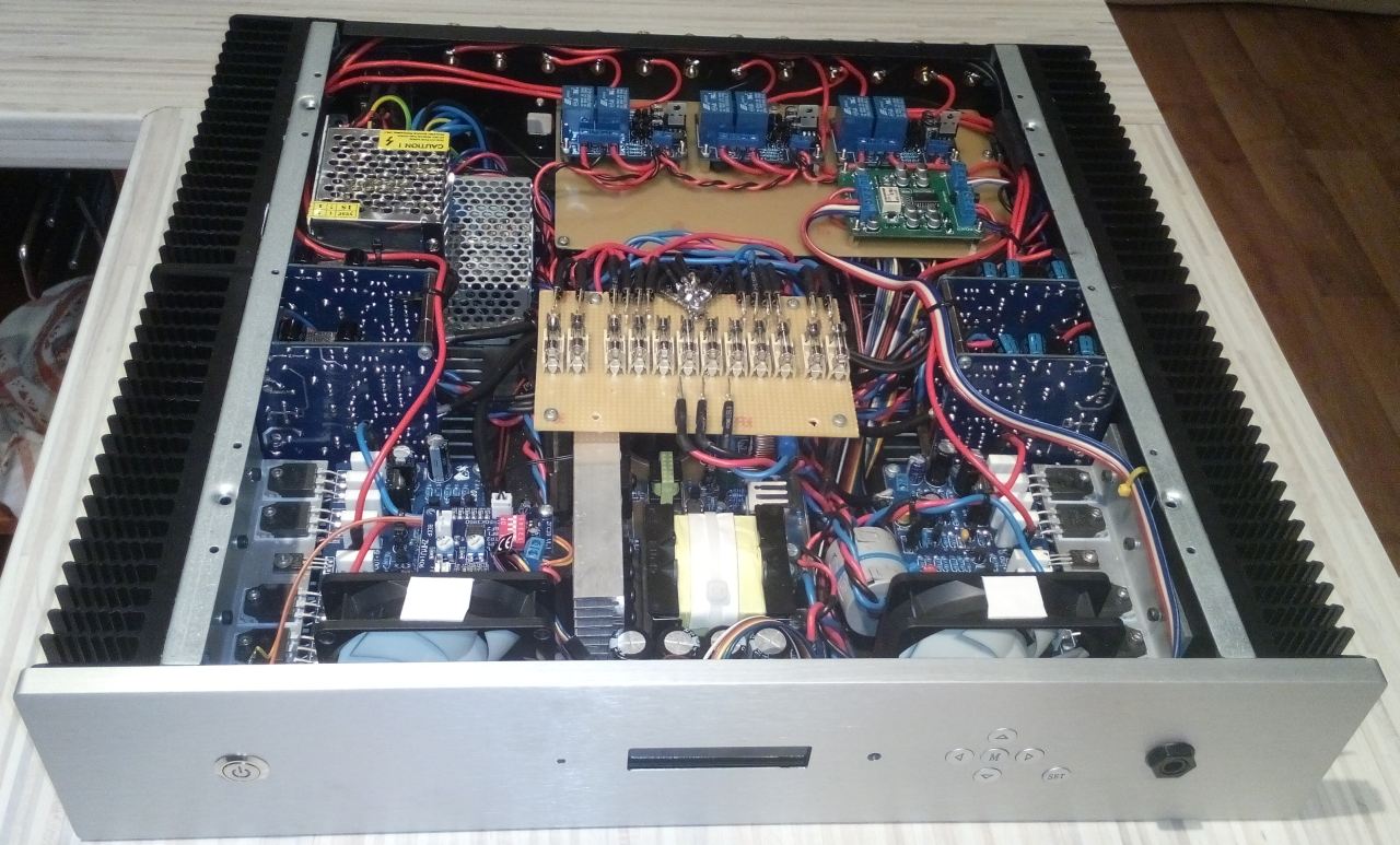

Najda built

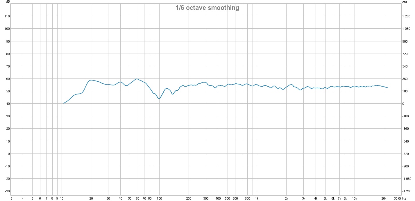

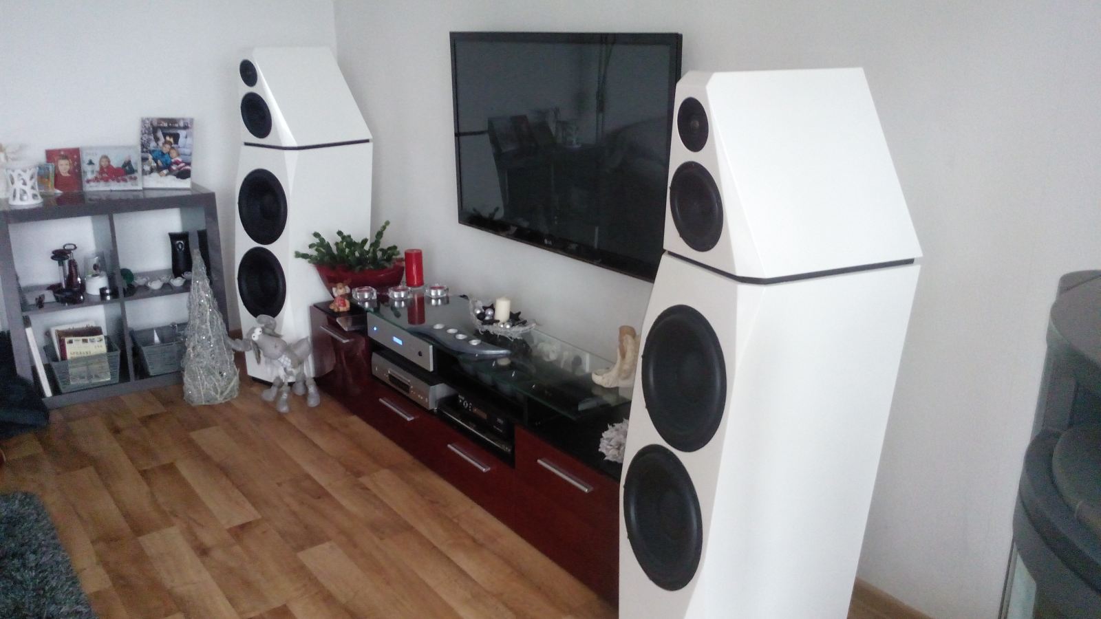

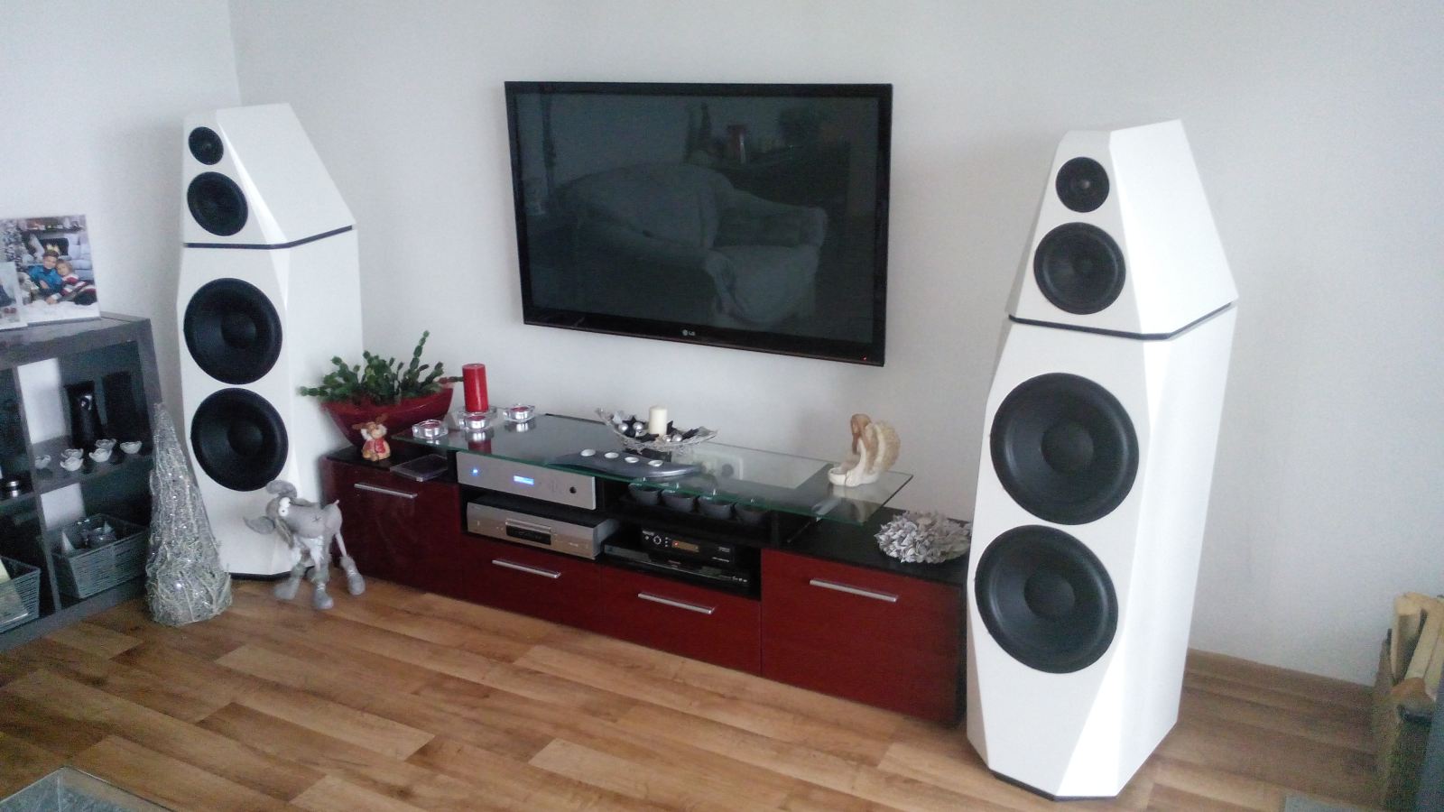

Hi guys, here is my active version of Avalon ISIS speakers using Najda V1.3.
BTW, one question to Nick. I am having the same problem as I had with Najda V1.2. If I don't use Najda for some days (2-3), I am not able to turn it ON using the keyboard button and also remote control is not responding. I have to power OFF and that all runs well. Anybody else faced this behaviour?

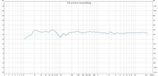

I experience exactly the same problem after an extended time in standby. Like you, if I turn power off fully then back on - everything becomes normal again.

Nice set-up by the way.
