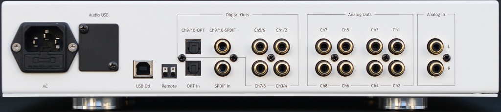

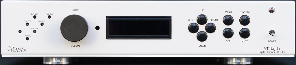

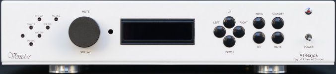

I'm sometimes asked whether there's a boxed Najda available.
There's actually a Japanese manufacturer (S&K Audio) making a full unit in a classy white chassis. More information here:
https://www.facebook.com/skpcaudio/
S&K Audio Labo Inside Story
S&K Audio

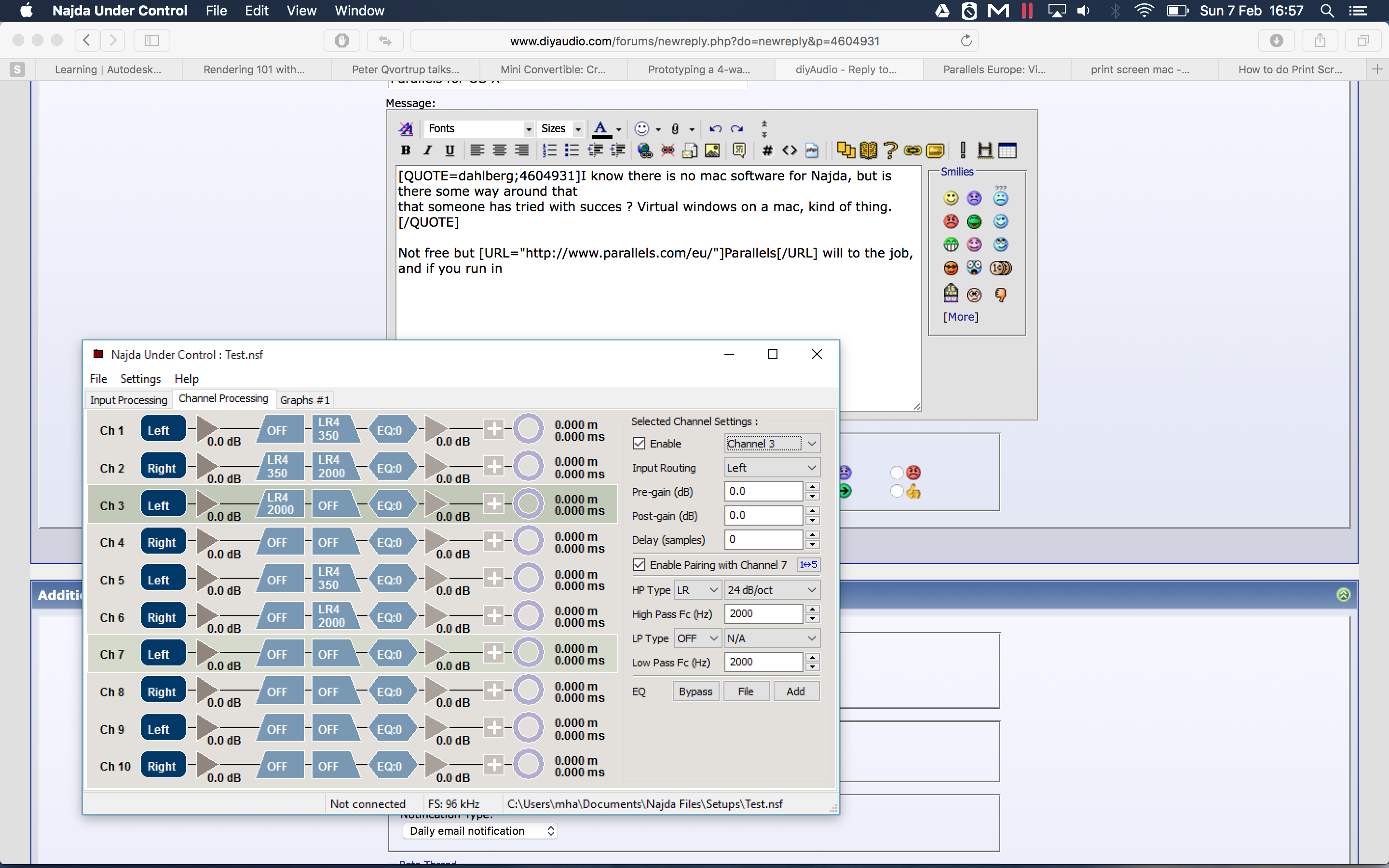

I know there is no mac software for Najda, but is there some way around that
that someone has tried with succes ? Virtual windows on a mac, kind of thing.
Not free but Parallels will to the job, and if you run in Coherence Mode you can mix windows and mac application on the same desktop.
Try take a look at the image of my desktop. You will see a mac desktop with NUC running in what looks like a normal os x window.
