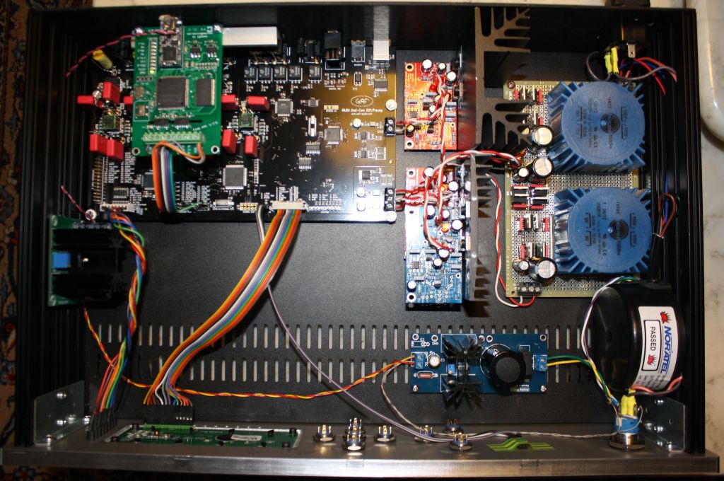

Hello Sigi,
which opamps did you end up using? I noticed from your photos with cap upgrades you are trying something other than the stock model.
first a few remarks:
If you have a red bord be very careful when desoldering the electrolytic capacitors. Although they are soldered on through hole pads, it can happen, that the pad at the bottom is lost. This is not a serious problem because the connections to the circuitry are on the component side.
If you have a black board the TH pads are much better, had no problems at all when desoldering
Find attached some photos. The ones with the red board are not finished, I just began to solder one end of the capacitor to the boards pad.
The black board is a finished board working perfectly.

Hello Sigi,
Hello,
I replaced the original ones by OPAs 627
Cheers
Sigi
