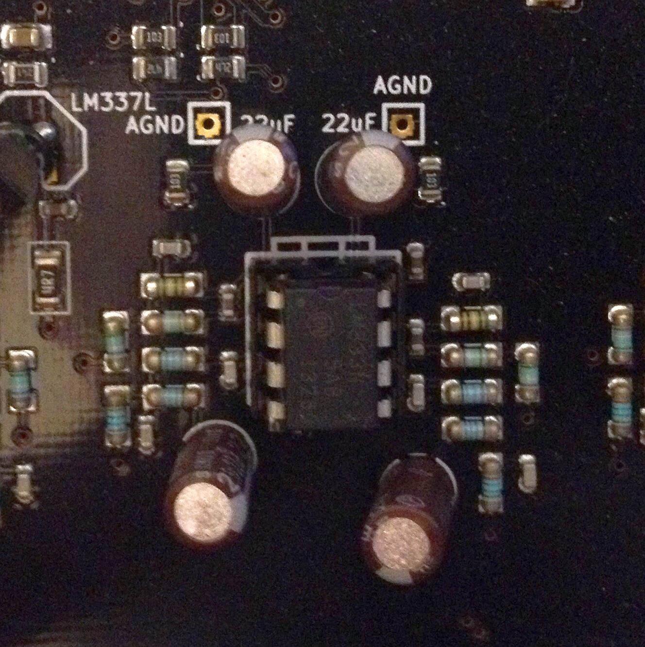

Not the whole answer!
There is a possibility to re-insert the analog signal from Your DAC back into Najda before the analog volume control.
It is described far away in this thread and might take a bit of soldering, but not too complicated....
be aware of possible differences in latency time, so measure and adjust delay, but it might be a minor problem fpr a subwoofer.
Thnx for the explanation of that option.
I will take it in consideration. Soldering on the board is not really my level of diy, but who knows 🙂
I also have a stand alone (non diy dac) so the wires would be long and a bit strange. It does look quite simple...
