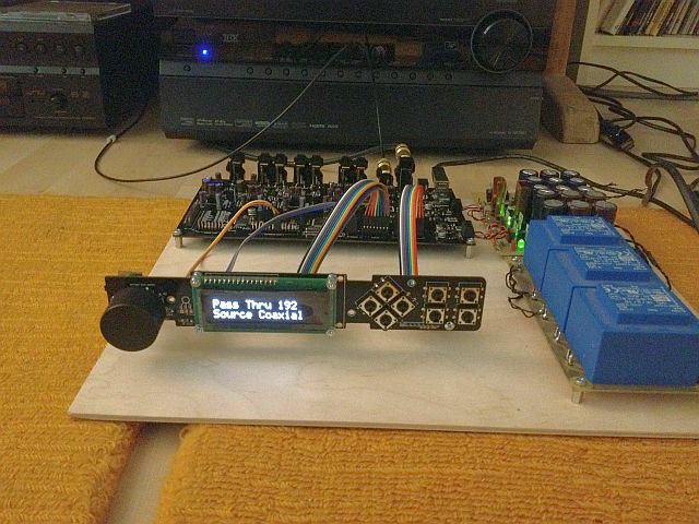

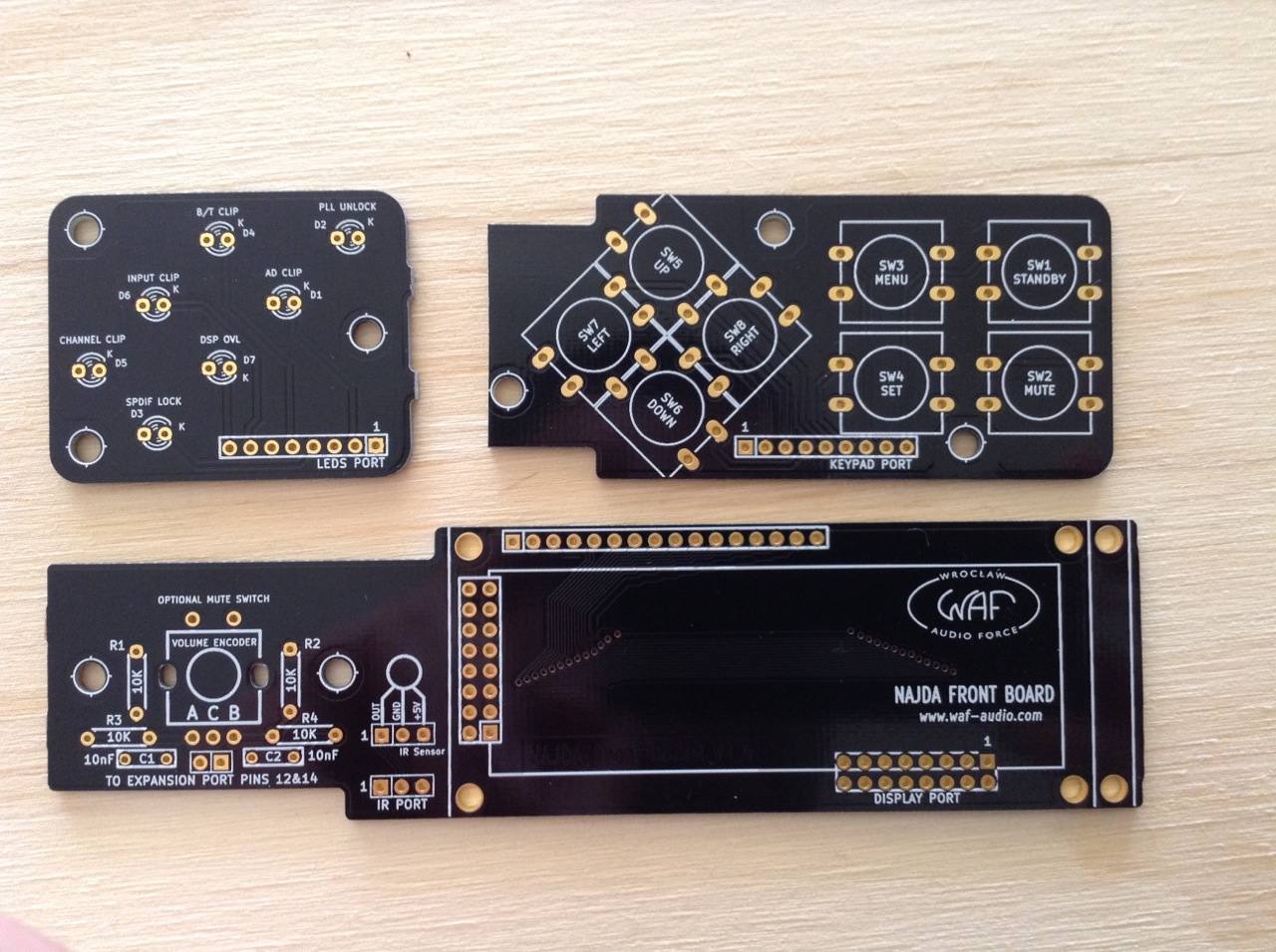

I am having trouble getting the rotary encoder to work. I am using the front panel board, everything else on that is working fine. I have set the volume setting to wheel and connected to pins 12 and 14 on expansion port 1 but I get no response from the encoder. I have tried reversing the connections to pins 12 and 14 this made no difference. The mute switch part works fine though. I put a multimeter across the two pins from the front panel board but moving the encoder doesn't seem to register. Any ideas on a way to find out what the issue is? The encoder is a bourns pec 11r.
When I have the encoder working I will post some pics of the finished article, I am very happy with how it has turned out.
What I can think of is the following:
- Check the pins on Expansion Port 1 where you've plugged the encoder. Both pins should be on the row near the PCB edge.
- Have you assembled the additional parts as well? (2 resistors and 2 capacitors)
Looking forward to your pics!
Nick

Hi Nick,

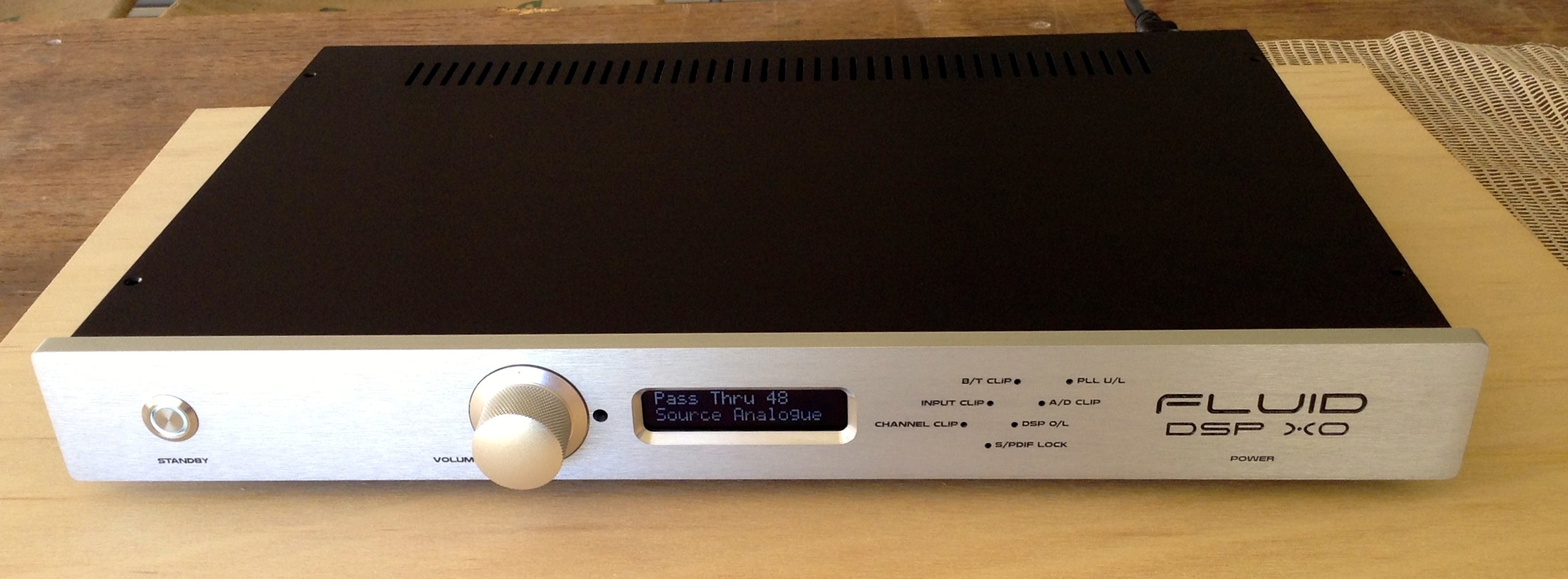

All working now, the information about the location of the pins helped, didn't realise it was odd on one side even on the other. When connected to the right pins everything is spot on.

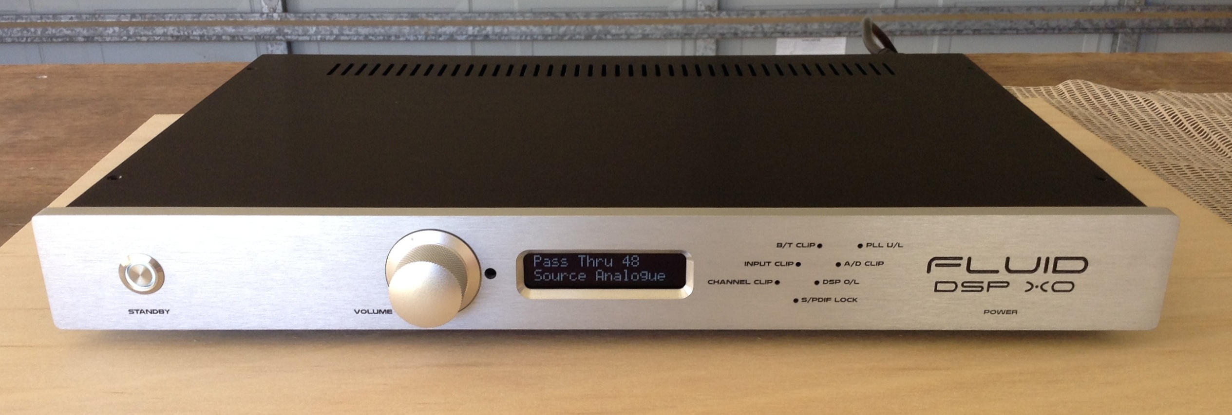

Here is a quick and dirty picture, I'll take some better ones in natural light and post them
Hi Nick,

Hi, it looks like you have selected the slimline 1U 10 mm front panel, 280 mm deep Modushop cabinet.

Yes you are right Modushop 10mm front panel in 1U 280mm deep.
Here is some information for you I have attached the pdf of the drawings to modushop
This is the link to the basic CAD drawings on their site
Hi-Fi 2000 contenitori per l'elettronica, case modding HTPC, Galaxy, rack, DIYaudio, computer cases, front panel express, knobs,milled Handles, milled fronts, hi-end,
The panel is held on by metal L brackets they are 35mm long on the sides and 10mm long on the front, the holes marked on the edge of the panel pdf show where these are.
Send me a PM with your email if you want the autocad version so you can check any dimension
I'll post more pictures later when I get a chance so this might make more sense then.

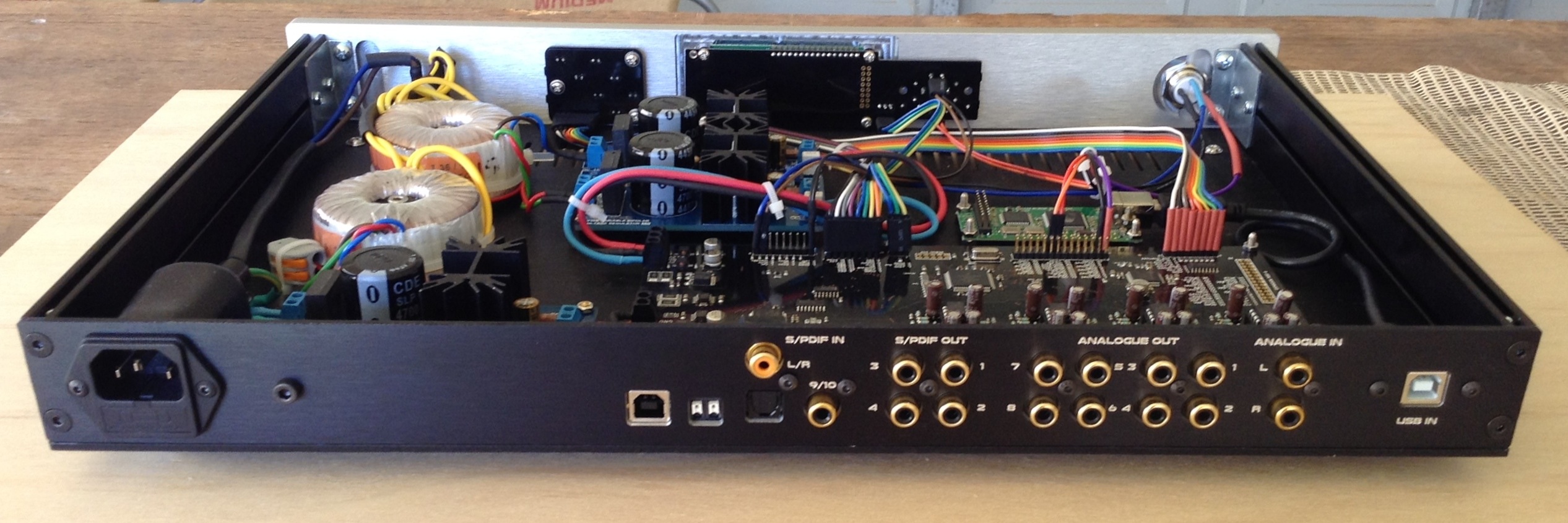

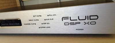

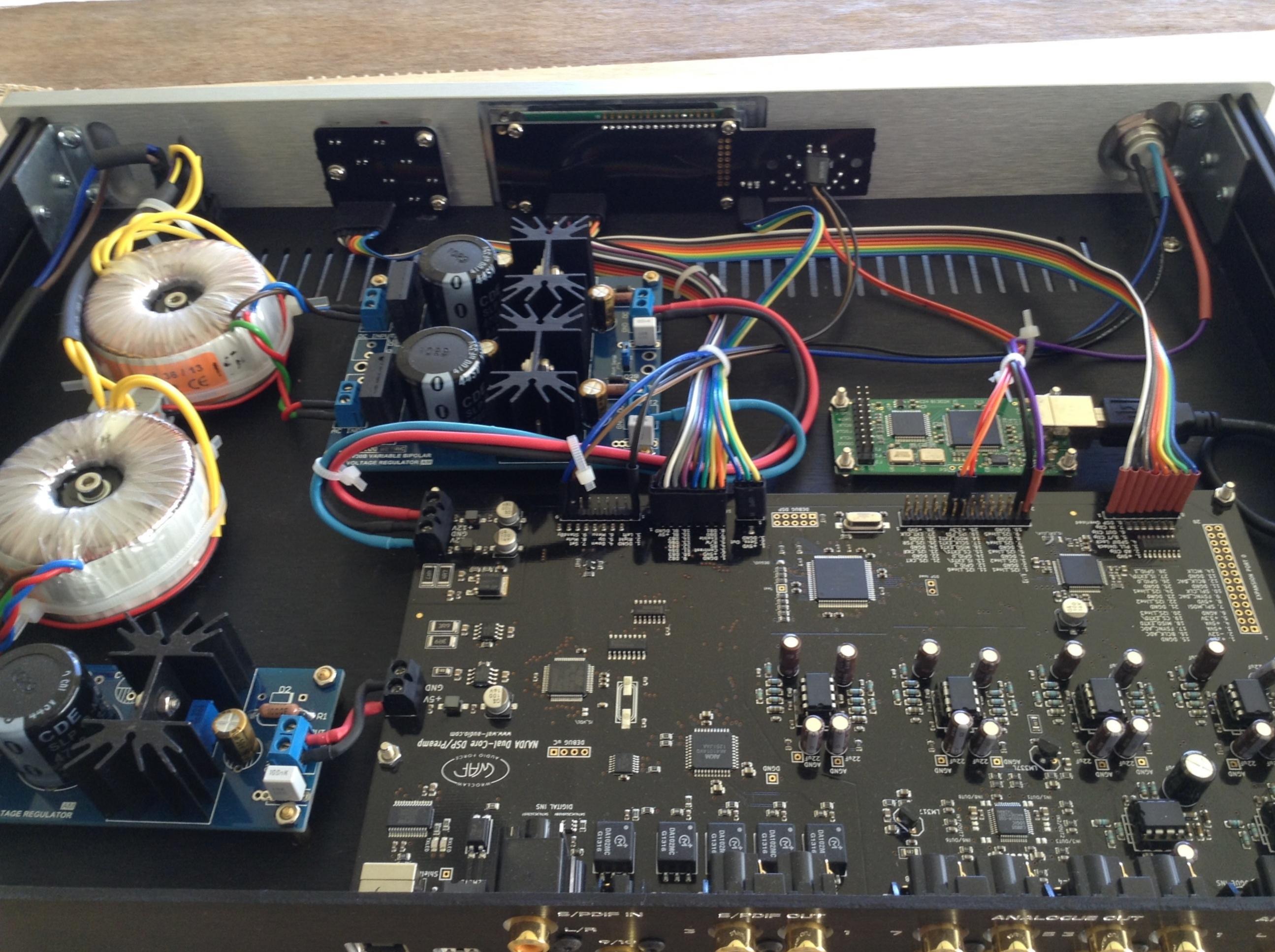

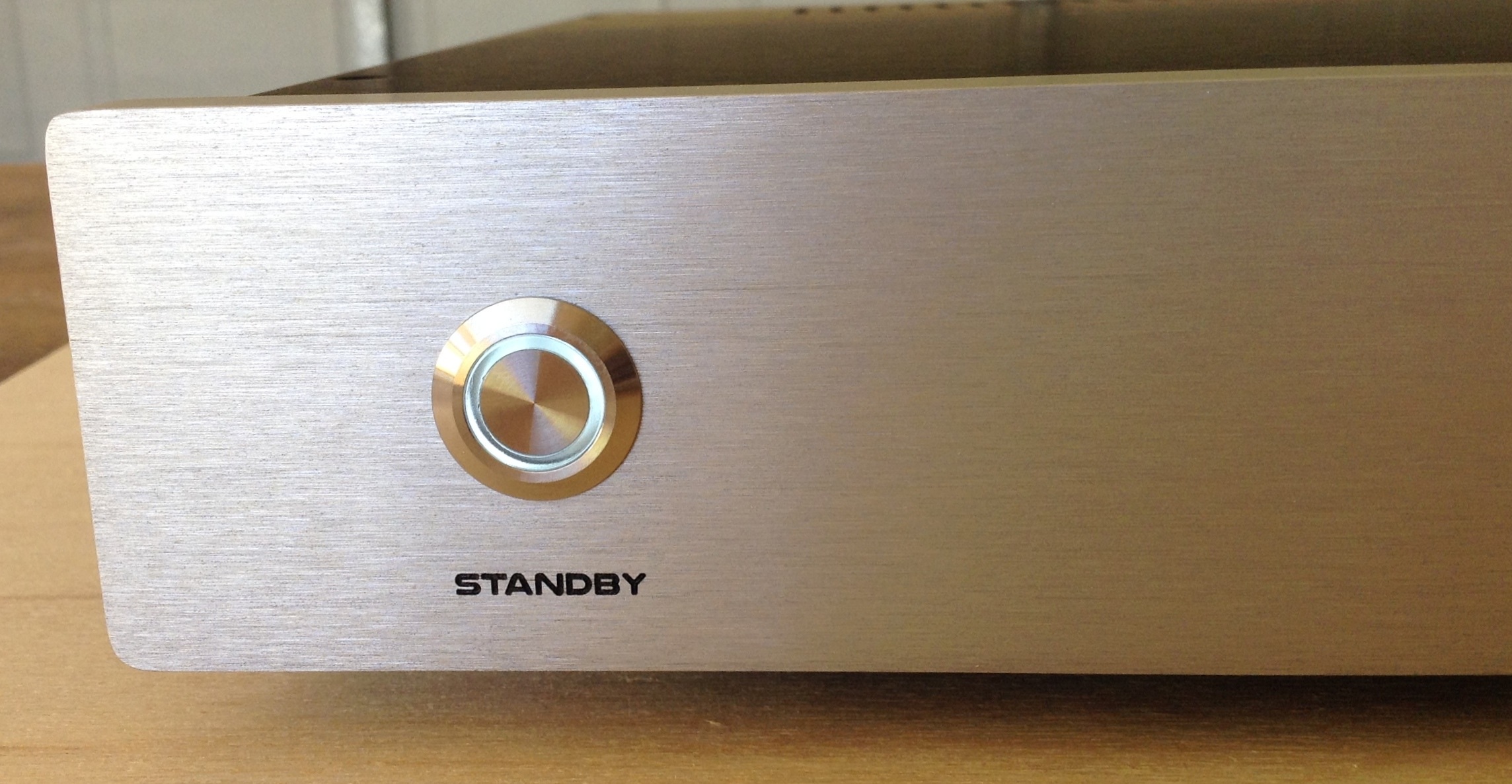

Photos

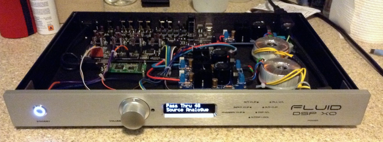

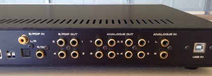

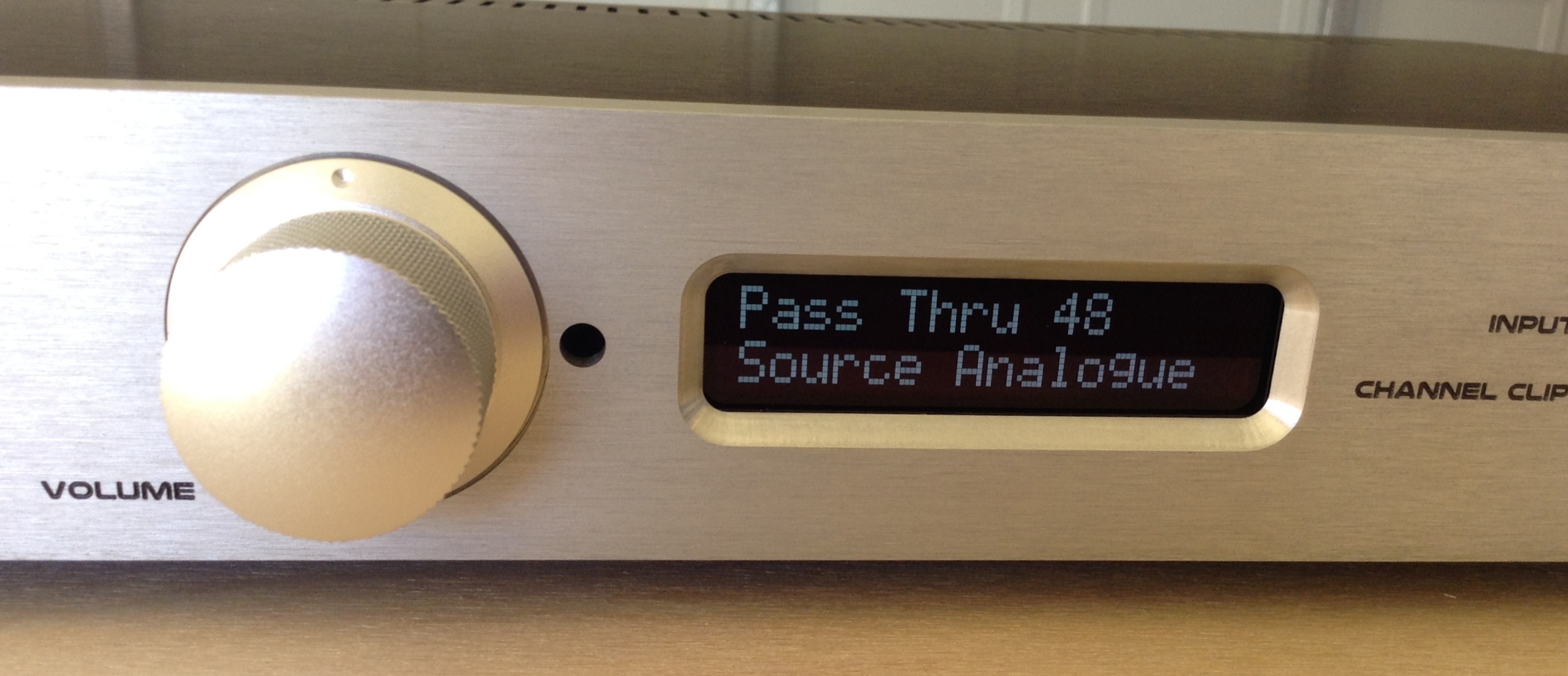

As promised some better photos these are the finished enclosure. Linear power supply, front panel board cut up and moved around, and an Amanero which has yet to be set up.
I'm very happy with the outcome, modushop did a really good job with the machining and I can recommend them.

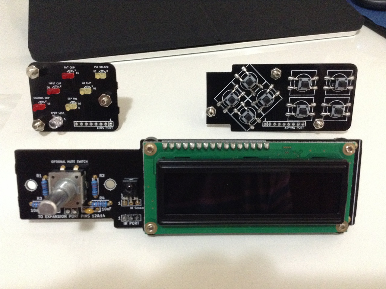

More photos

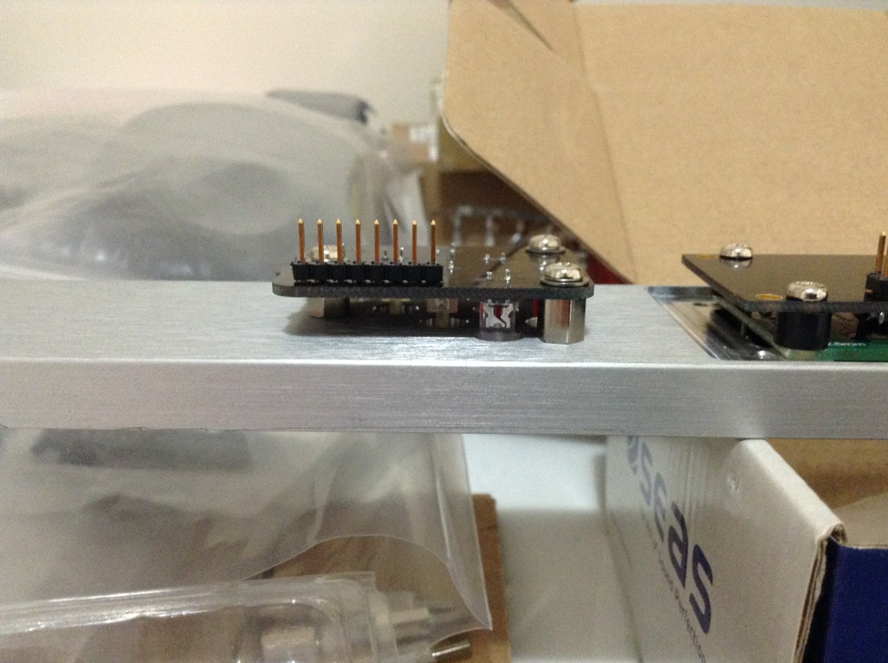

Theses are some photos of the front panel being constructed
They show where I cut the front panel into pieces to fit where I wanted them.
I am using the keypad section as a spare so I can use it to change the setup later if need be. For now everything works via remote control.
I used a thin kerf japanese saw and it was easy to cut the board up and left a neat finish. I bought the wrong size switches, I bent the legs and soldered them in place and they work fine, especially as they are only a setup tool for me.

I have now all the necessary information. The only missing one is for the ventilation holes on cover. It seems, according to the very nice pictures taken a few post below that there is only one row instead of two. If you can give the position of the first and last ventilation holes relative to the sides and back of the cover, I will be able to draw everything correctly.
Again, congratulation for this very nice build. I like also the very nice engraving.
Jean Claude
Jean Claude,
Dimensions for the hole cutouts are 52mm from left/right edges and 25 from back in my pictures the slots themselves are 30mm long and 2mm wide, the slots can be either on the front or back edge they fit either way.
Thanks for the nice comment on the engraving.
