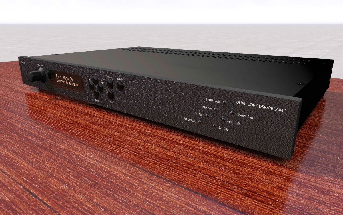

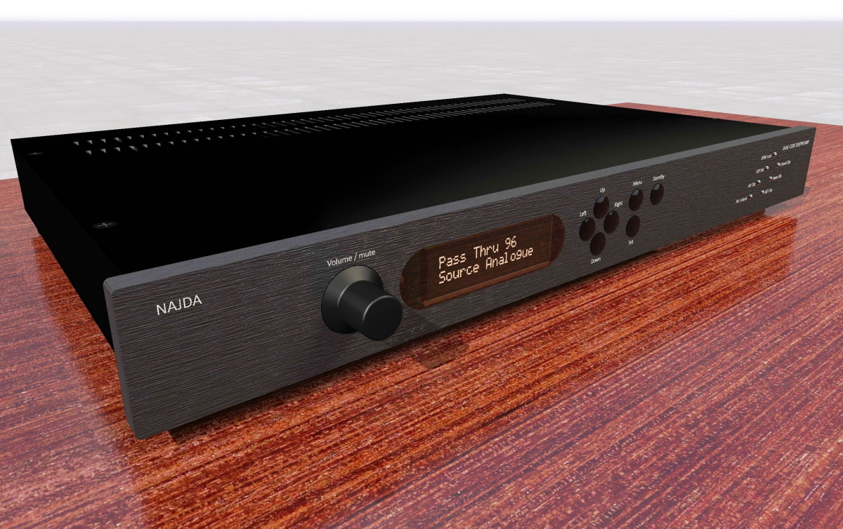

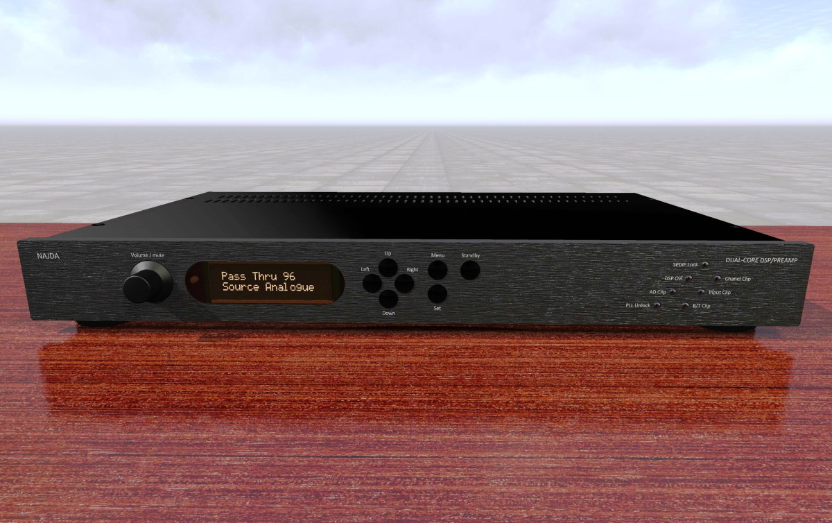

Sometimes I'm getting emails from users or potential users with the pictures of their project. Quite often it's really nice and I'm thinking "damn! why don't they post this on a forum so that other people can see it?" - not mentioning that I have issues with my email box flooding.
This time I asked if I could post the pics myself, I can't be the only one seeing this. This project by Alex from Latvia is really gorgeous: plain and classy 🙂
Alex is a member of this forum.
Cheers
Nick
Thanks for the nice review of my project
