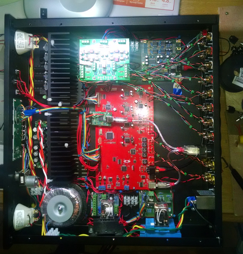

Well, I think my Nadja is pretty much complete now. I may add a balanced analog input but otherwise it's working quite well and putting out a respectable noise.
The only thing I really, really want from my Nadja is access to another 2ch of I2S output! Please Nick, if there's some way for me to get more I2S output can you let me know? I don't mind if it involves a little surface-mount soldering (although prefer not 🙂 )
Here's a pic - I believe there's at least 30m of cable in that box so the fact that it looks kinda tidy is an achievement in itself.
