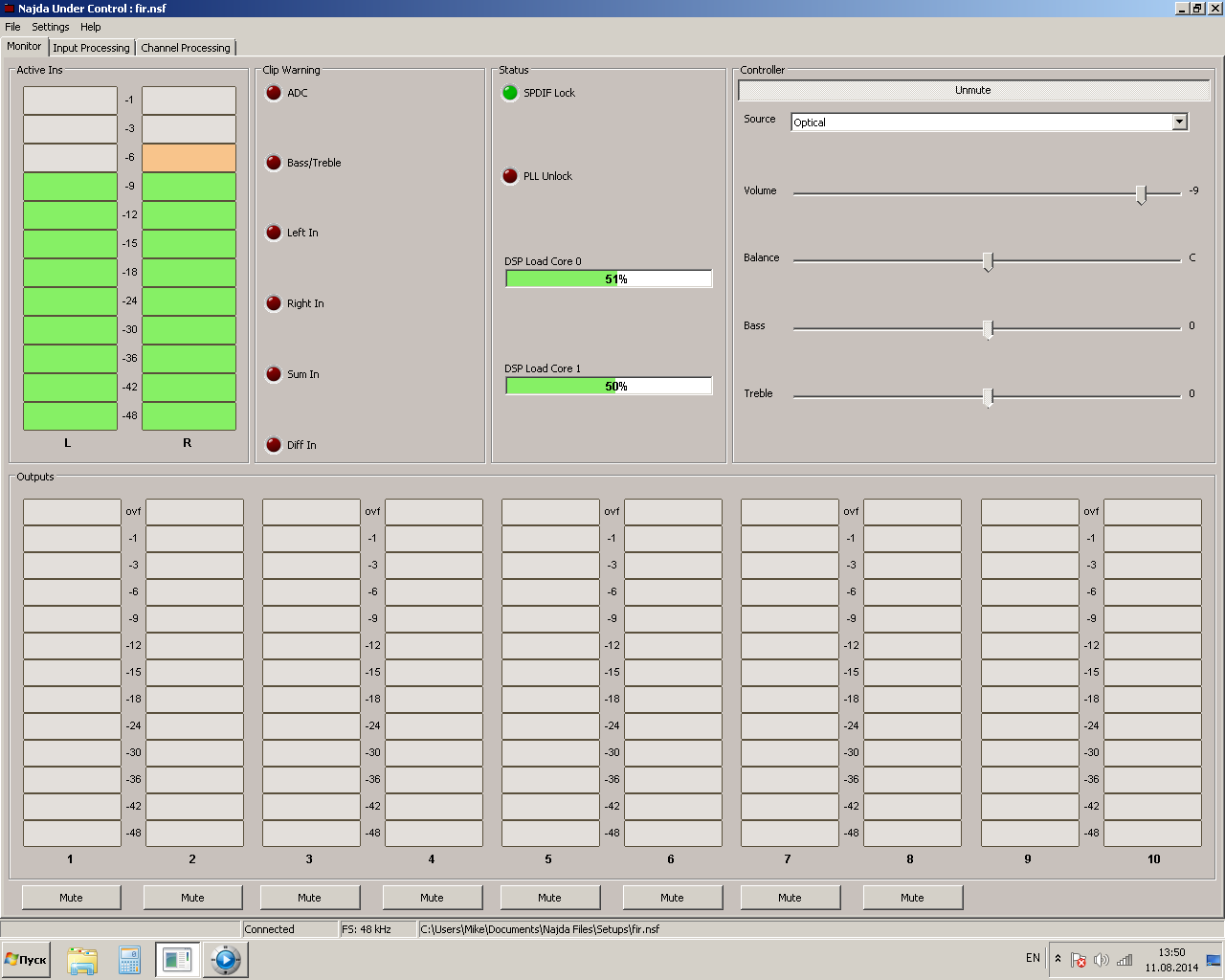

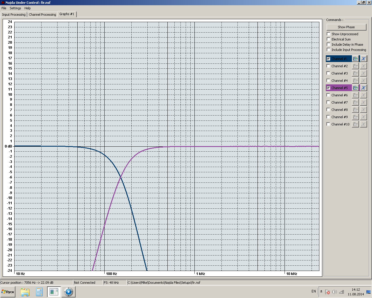

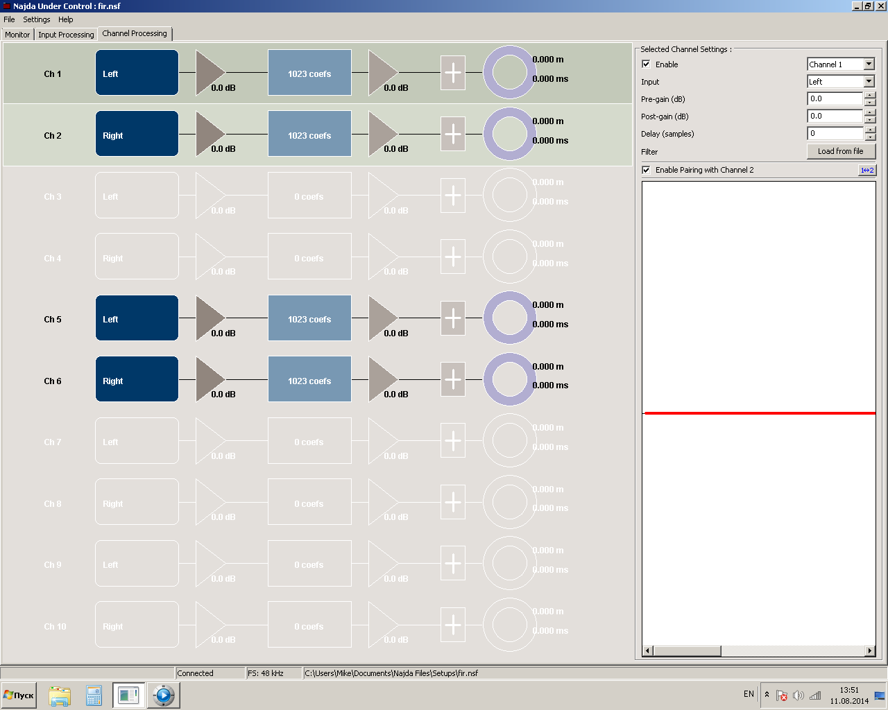

Well, I made my first FIR 2-way xover and I was able lo load it as a preset. But! I don't have any signals on the outputs! What's going on?

Mike,
You need to check the whole audio path.
The signals are first crossing the Input Processing section. What do you have here?
By default, there's no coefficient loaded at this level. No coef = open circuit (no sound).
If you want a pass-through, you need to load a '1' for each path being used (in your case I suppose that's going to be Left and Right). This is all extensively documented in the NUC manual.

Hi Nick!
You're absolutely right! Sorry for my impatience😡 I printed the Manual on the printer and I'll note all the important points with a red marker. Nevertheless, while I can not promise the absence of such a stupid questions in the future 🙂 I'm starting to slowly fall in love with Najda 🙂 Even without MUTE button.

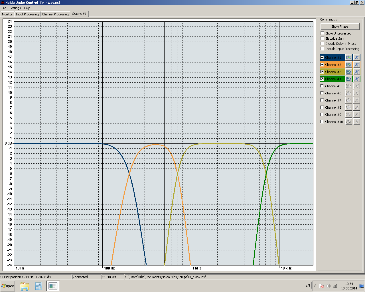

Hi guys!
Now about taps for FIR filters.
My goal is to create 4 filters for my 4-way loudspeakers:
1. LPF 150 Hz
2. BPF 150-700 Hz
3. BPF 700-7000 Hz
4. HPF 7000 Hz
What can you recommend, i.e. how many coefficients for each filter will be an optimum? All filters have to be LR 24 or better 48 db/oct. Also what about DSP Sampling frequency? Is it possible 96 kHz for my setup or only 48 kHz?
Regards, Mike

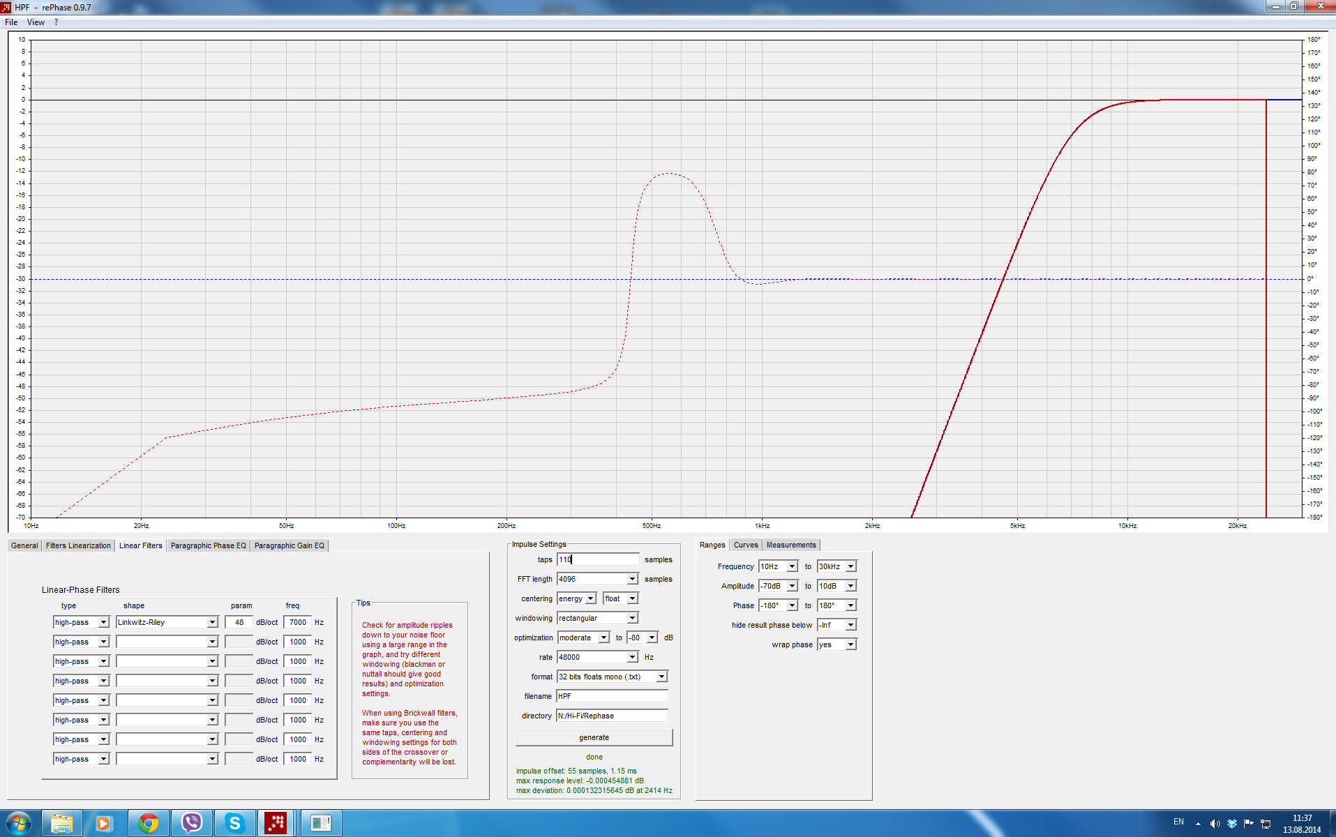

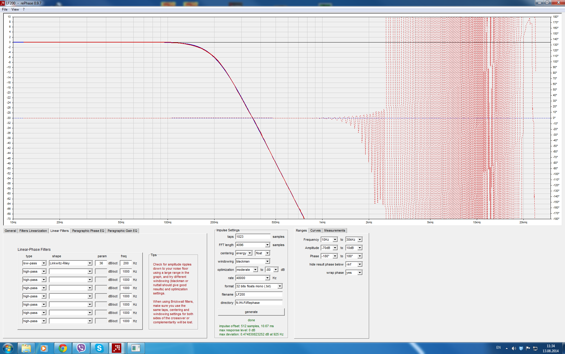

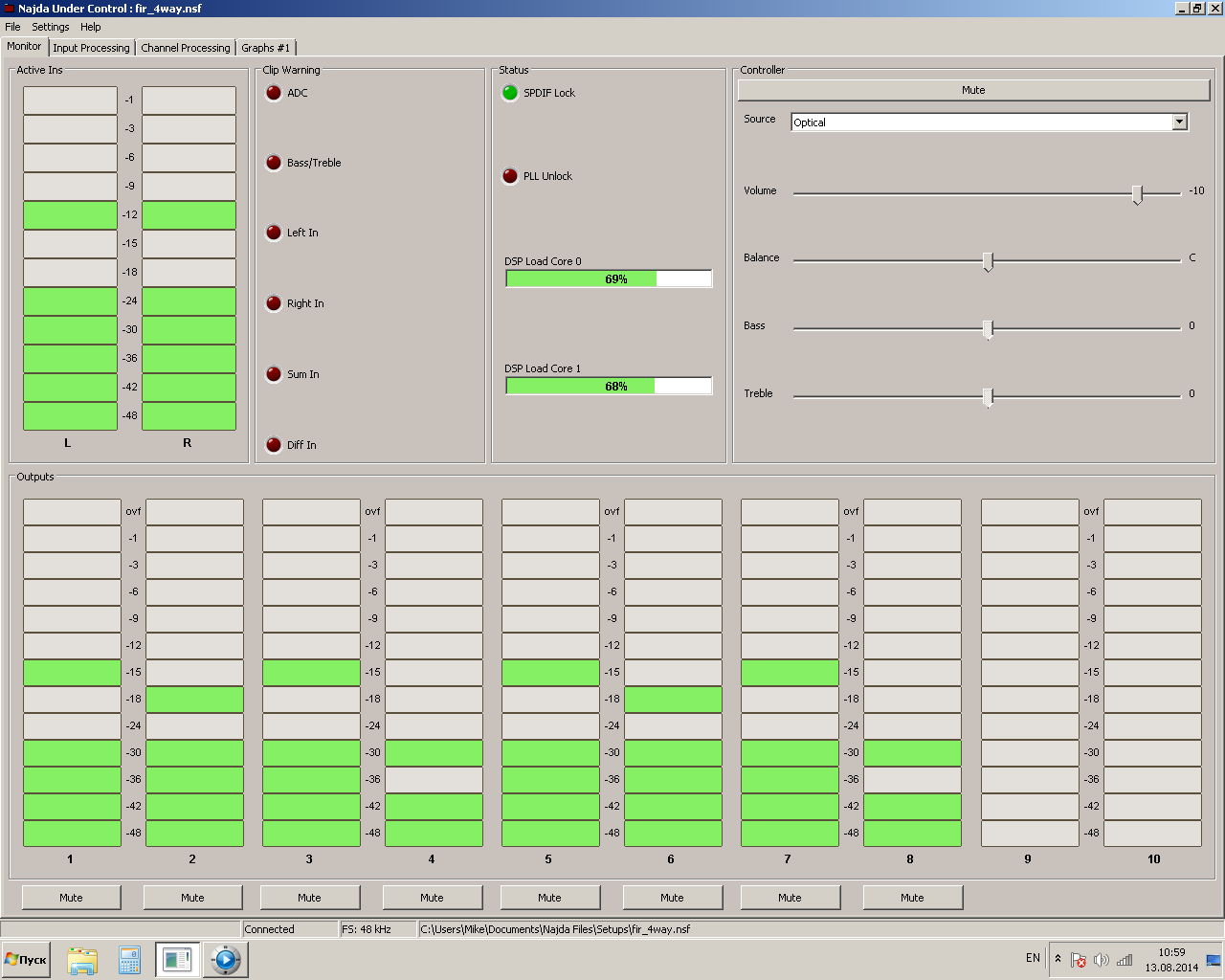

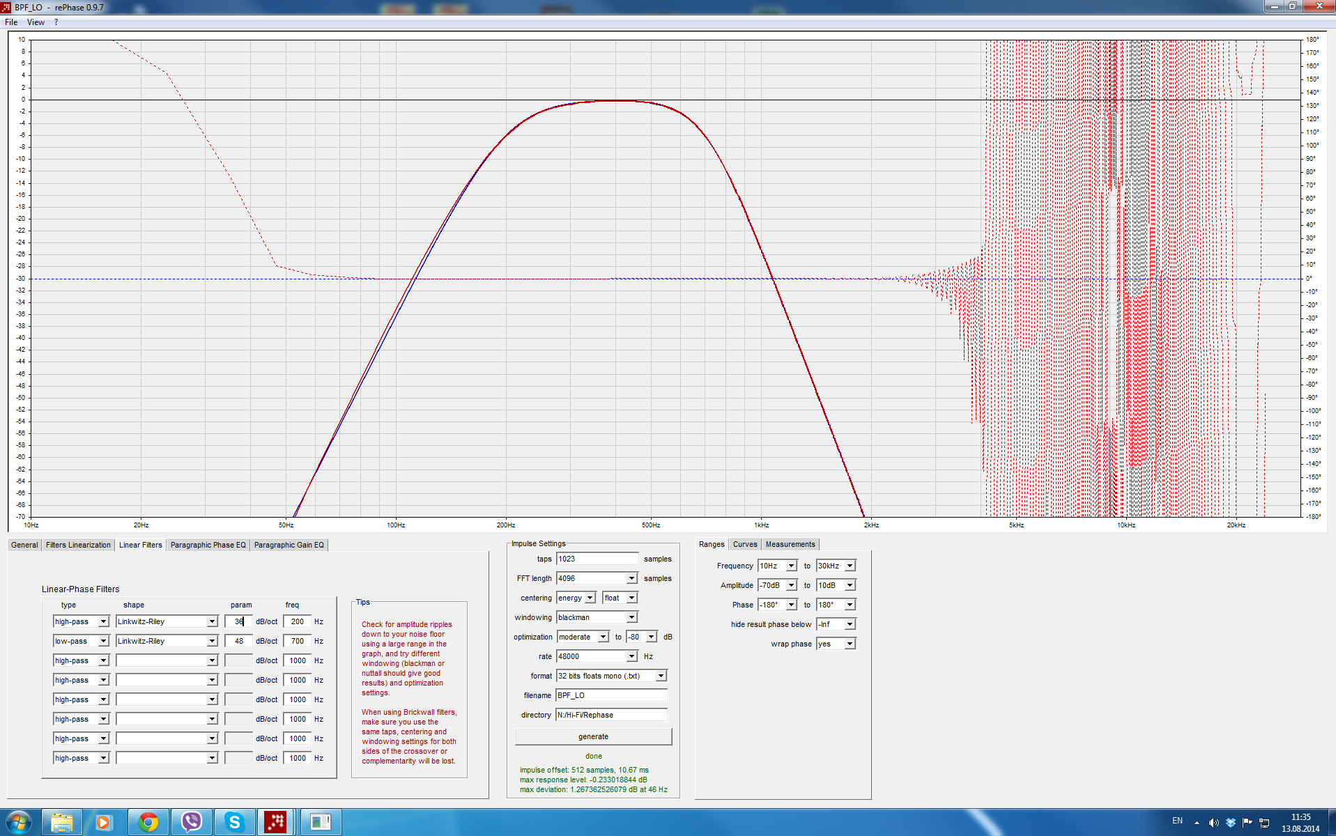

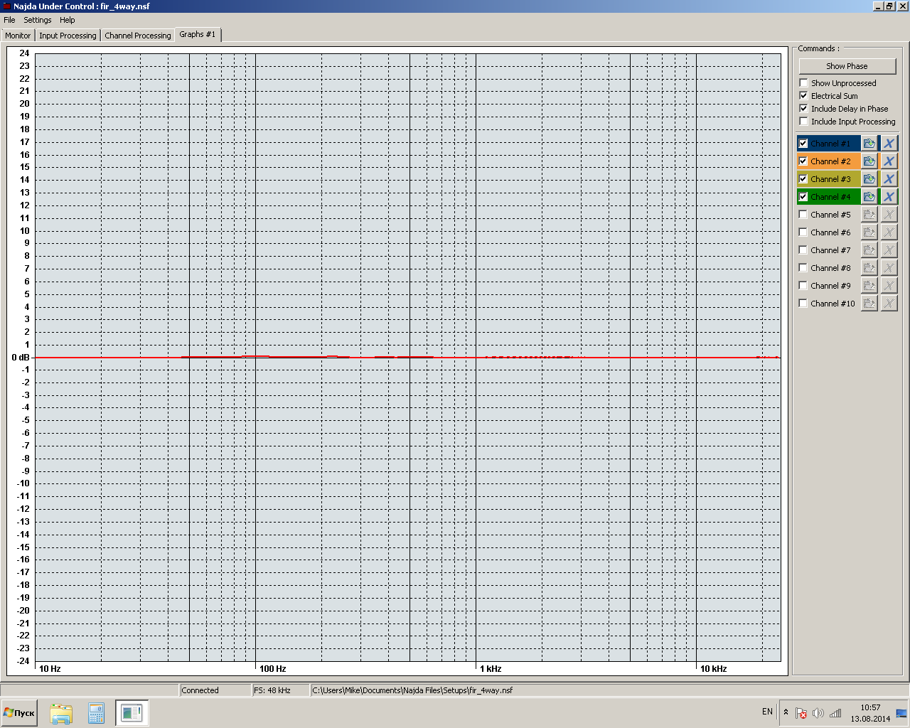

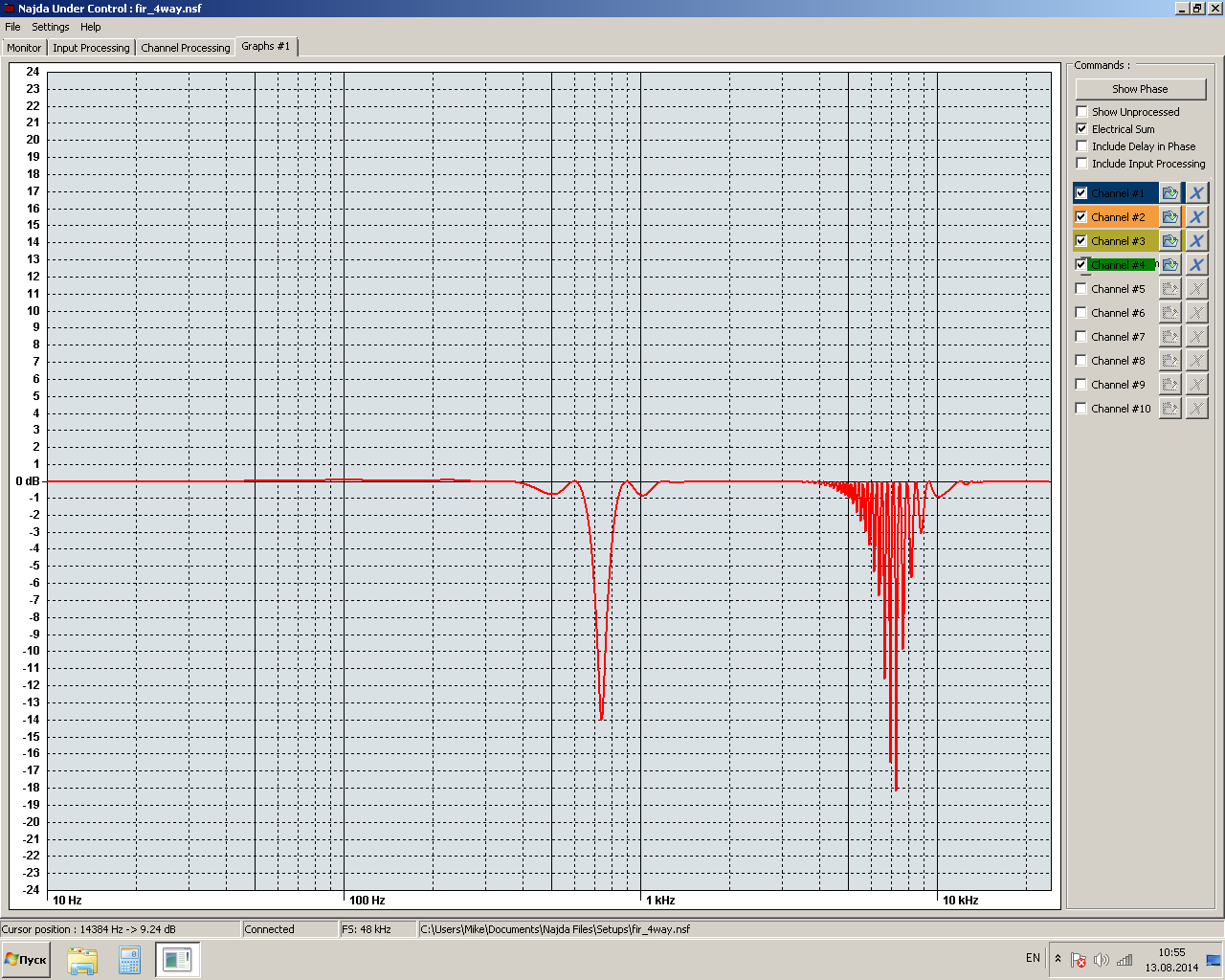

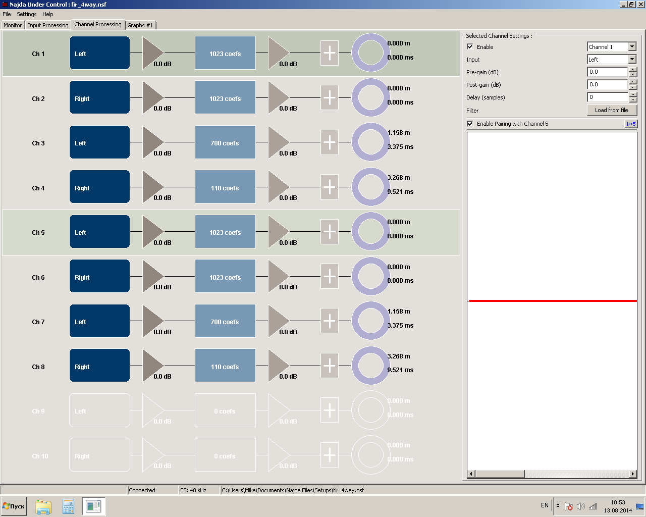

Well, I spent few hours to play with rePhase and NUC. Nick, your post helped me very much. What I got:
Is this point OK to start up?

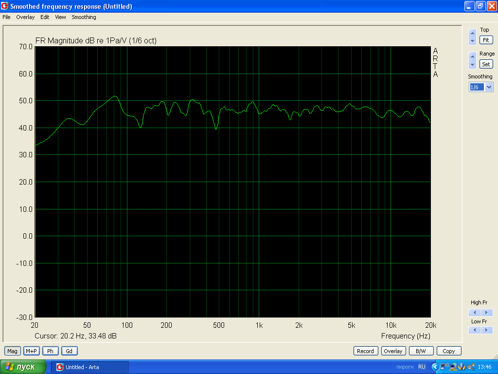

First result is very impressive! After separate measuring each driver necessary delay was added and also I made some correction for tweeter with Paragraphic Gain EQ in rePhase. The sound is amazing even with not the best amps for high-mids and highs. This FR was measured with the mic placed on the listening point

Some time ago you promised about possibility to use IIR and FIR in the same setting. Is it still in development?
What about possibility to have more coefficients per channel, if the limit of 3580 coefficient for each DSP core not reached? For example, if I need only 3 hannels with FIR filters, can I have 1193 coefficients per channel?
