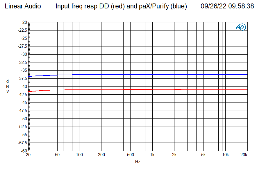

OK, my bad, forget about my post # 97.
I found that some of the EQ and loudness settings from an earlier experiment were still enabled in the RME. Red face :-(
So I redid the measurements, first doing a freq response on the input signal to the direct drive amp as well as the Purify/paX as a baseline check; that should be a flat line, and it is, reasonbly.

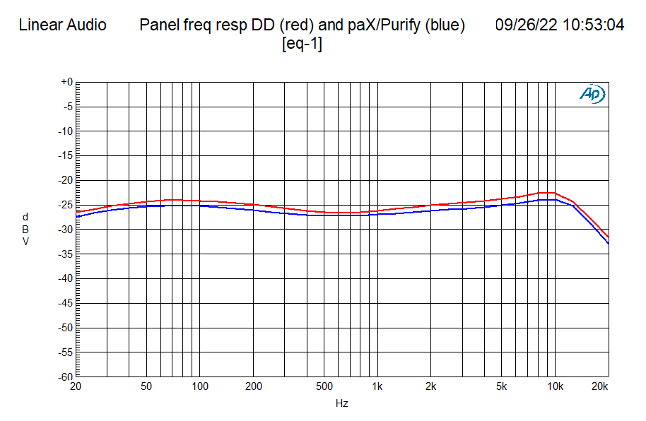

Next I did a freq response at the connection to the two stators. The Purify that drives the speakers through the stepup transformer/network shows, among others, a roll off above 10kHz. The direct drive much less as it has not been eq'd yet. (Level has not been eq'd either so disregard absolute differences).
Hans, does the stepup network freq response look credible? The roll-off looks very similar to what I've been measuring on the ESL63 months ago.

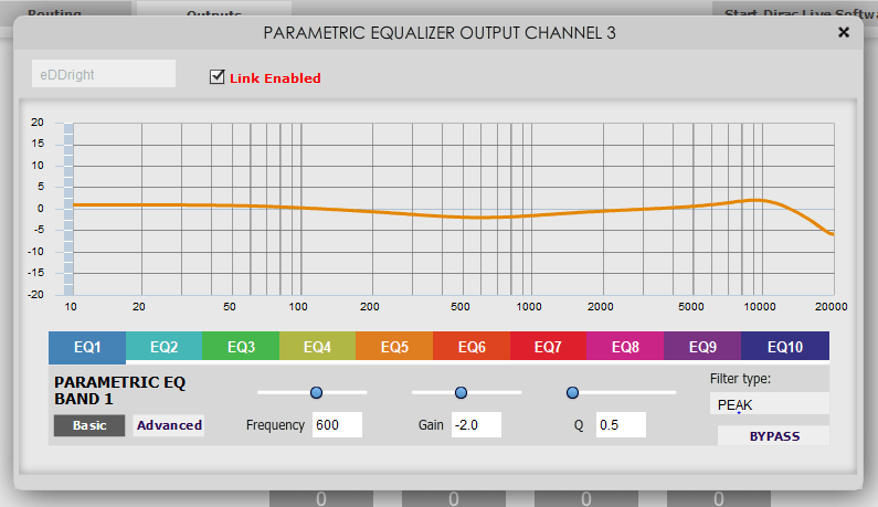

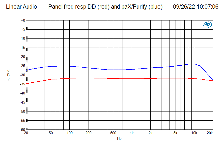

OK, next step. This is fun!
I setup an eq in the FLEX for the DD channels.
Re-measured the freq resp at the stators, and after some iterations I got this.
Maybe time again to listen to some music ;-)
Hans and Demian, thanks for keeping me on the straight & narrow!

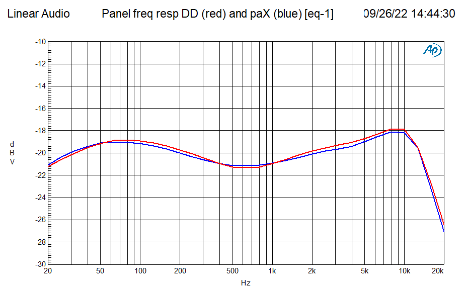

Final matching, between the direct drive and the paX solid state through the stepup xformers.
Measured directly at the stators.

Simple. I want to be able to switch between the direct drive and tyhe 'traditional' drive and listen for differences.
You really need to level and response match to better than 0.5dB for a fair comparison.
