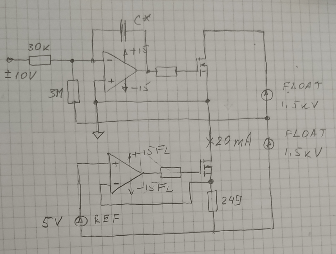

By linearly do you mean frequency response or distortion? The big FETs have a "nasty" cap transition point. You really need a pretty good driver to get them to perform. The gate current needed increases abruptly as the drive increases.Alex, can you share a schematic?

Sure. Later. Getting old it seems. Early days I could prototype the whole unit without drawing a line.Alex, can you share a schematic?

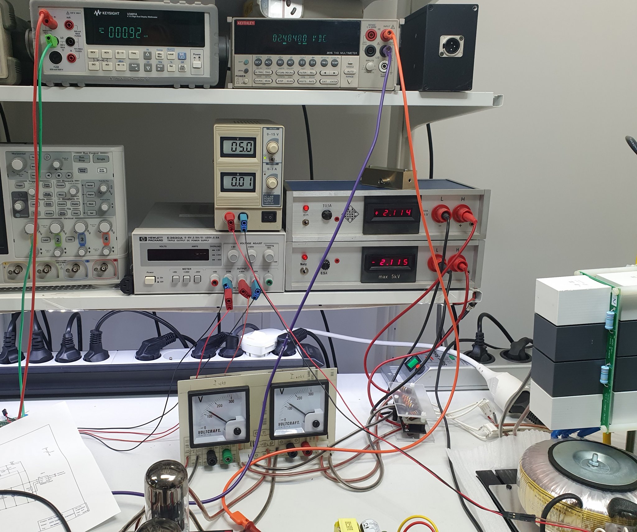

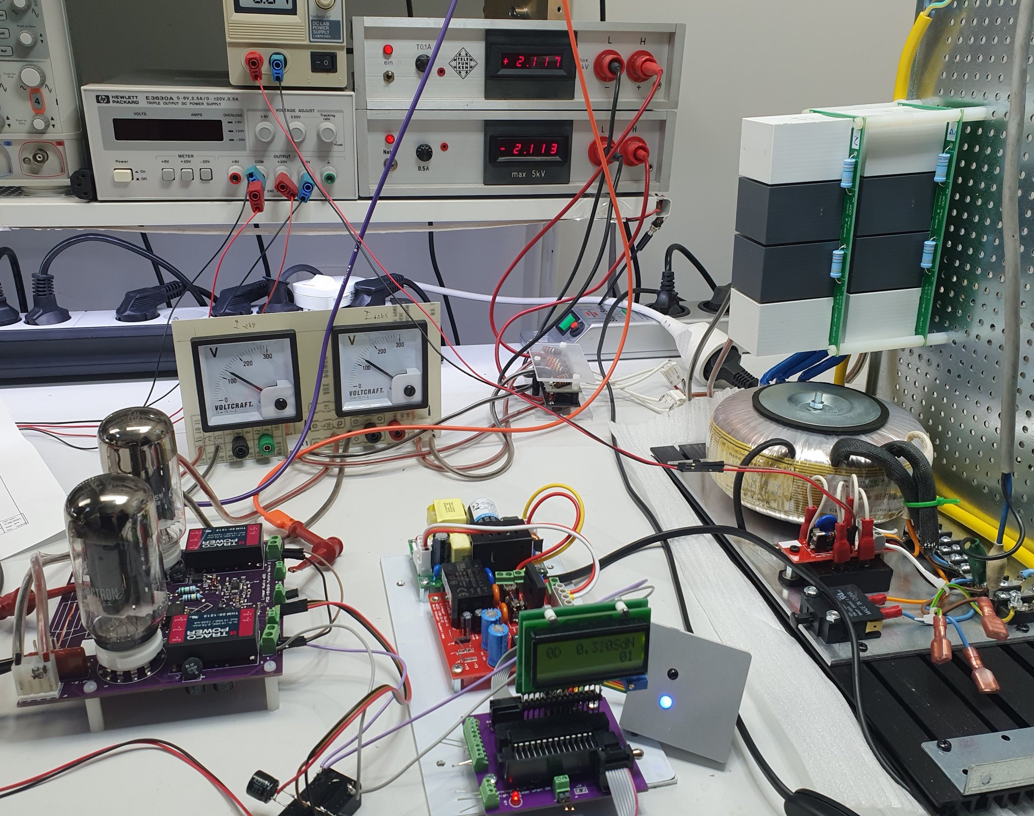

Just a sample of progress: Verified the offset servo at full supply level (~+/-2.1kV).
The meter in the top left corner of nr4offsetlevel shows the output offset. Yes that's 0.92mV ;-)
The square meters show the bias current, 30mA full scale, currently at 13mA design center.
I have 6 amps in various stages of completion. A few of them have been playing on the Quad 989 already.
The enclosures are ready and partly wired, waiting for the final PCB for the power sequencing (had to change a DC-DC converter which didn't fit the original PCB). Umbilical cables between amp and speaker are done.
All should be up and running end of August, after my short trip abroad.
Looking forward to closing a multi-year project!
(I know someone who will call it a multi-decade project ...).

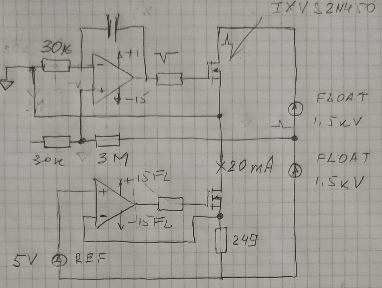

Thanks Alex, food for thought! I assume the load is between the tap on the floating supplies and ground.
20mA seems like a sweet spot; I'm running mine (tube based, different schematic) at 13mA.

Well. I needed 10 mA, capacitive load, basically connection cable, about 10 kc max.
There's an error in circuit as drawn. You should swap inv and non-inv inputs at top O/A.
Getting old.
