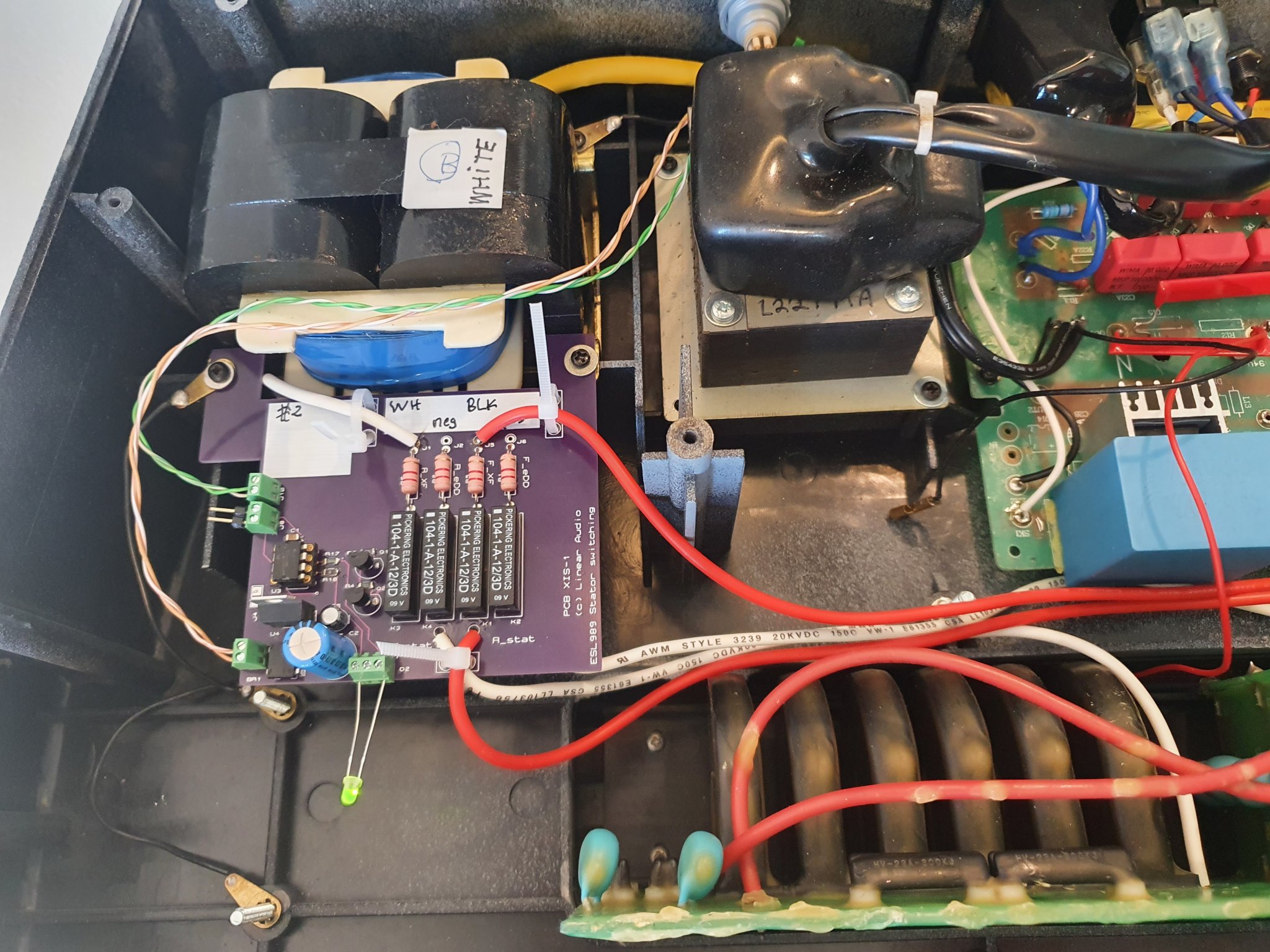

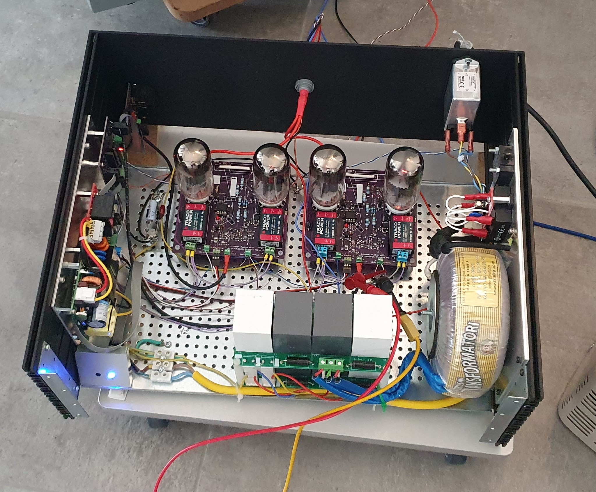

The first amp and modified ESL989 are making sweet noises! Finally a big step forward.
The software needs some finetuning (does anybody know how long the heaters of a 6HS5 need to heat up before anode current starts to flow?).
Next is to get the 2nd channel going, and do some listening tests. And clean up the wiring of course ;-)

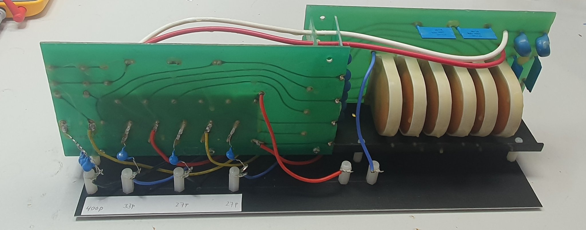

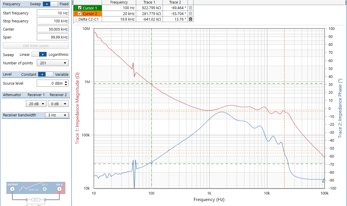

Update. I've been listening to the direct drive amps for some time now, and it's time to do some serious measurements.

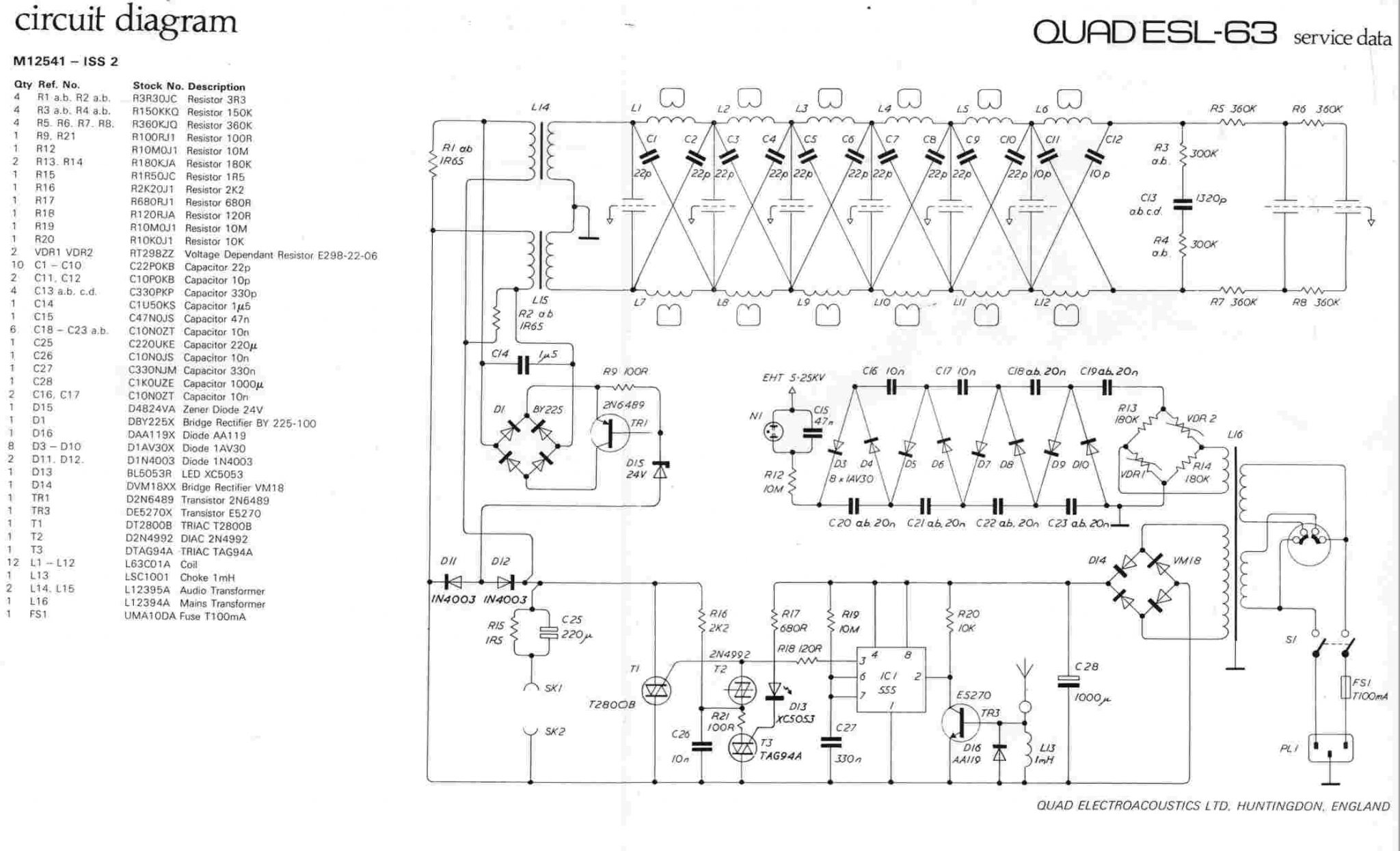

I build a dummy load out of the delay line section of an ESL63 and some capacitances to emulate the panel capacitances, see pic.
To my surprise, small ceramic caps rated for 6kV are common and low cost.
The measurement shows the impedance of the dummy load over frequency. Over most of the audio band it hoovers around 300k, but the phase goes through major changes.
This dummy load doesn't take into account the air load on the diaphragm, among other things.
Do you guys think that this would make a major difference, and if so, is there an easy way to include that with some more parts?

What exactly is it what you are aiming at and why using a dummy instead if the complete ESL ?
Hans
I doubt that ferroelectric capacitors are a good representation due to nonlinearity and hysteresis. Use teflon/PP film caps instead. With some effort one may obtain air caps used for RF tuning.somewhat representative load
As with series LC tank, series R could represent active load per say or would it?

Is this 6kVDC? or 6kVAC rating. With ceramics, usually the AC rating is based on the peak-to-peak not exceeding the VDC rating; VAC = VDC/(2*sqrt(2))To my surprise, small ceramic caps rated for 6kV are common and low cost.
So if rating is 6kVDC, the AC rating is likely about 2.1kVAC. Probably only a concern if driven long term, but something to be aware of.
https://www.psma.com/sites/default/...ac-parameters-dc-rated-ceramic-capacitors.pdf
The airload will not make a major difference, mainly because the transduction coefficient of the ESL is so small.This dummy load doesn't take into account the air load on the diaphragm, among other things.
At mid and high frequencies where the radiation impedance(ie airload) is resistive, its contribution to the electrical impedance would be well approximated by a 25Meg resistance in parallel with the ~300K of the electrical network...an insignificant difference.
https://www.diyaudio.com/community/threads/driving-the-beveridge-esl.381885/post-6924634
https://www.diyaudio.com/community/threads/electrostats-vs-conventional-drivers.17424/post-6957351
At low frequencies where the impedance of the electrical network rises toward 10Meg, you will see a small difference from the airload mass and mechanical stiffness of the diaphragm suspension. I think I had previously provided you these approximate component values for putting in parallel with the electrical network to evaluate the difference. I don't think this difference is anything worth pursuing.

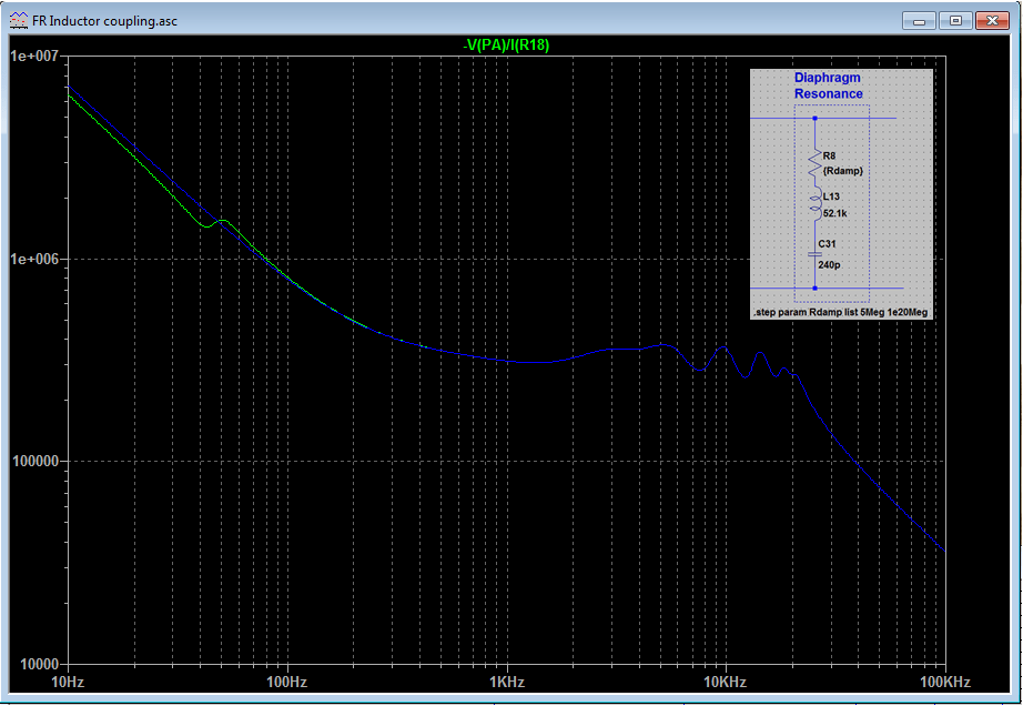

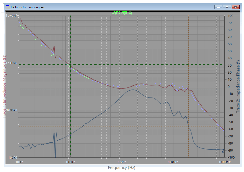

Thanks again to Hans Polak for continuing to refine his ESL63 model. Here is an overlay between the model and your measurements.
Thanks Steve, that's very helpful. Apologies if I asked for what has been given before; my memory isn't too reliable apparently at this age.
The max pk-pk voltage across the caps is 4.4kV and the 6kV rating is a DC rating, so I feel it's OK.
Yes, Hans' model is uncanny close to what I measured.
What puzzles me though is that his curve shows the same 50Hz mains wiggle as my measurement (we're both in 50Hz land).
Are we sure that 'the Hans curve' is from simulation and not also a measurement? Hans?

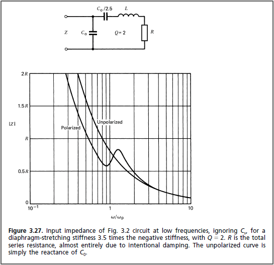

Would have helped if I included a plot legend.What puzzles me though is that his curve shows the same 50Hz mains wiggle as my measurement (we're both in 50Hz land).
The blue curve(without any wiggles near 50Hz) is the curve using Hans model as he posted it.
The green curve(with wiggle near 50Hz and offset below 50Hz) is the curve when the LF airload and diaphragm stiffness are included.
BTW, you can measure this effect of the diaphragm resonance on the impedance by measuring an ESL assembly once with the diaphragm unpolarized, and once with it polarized. The transduction coefficient will be zero when ESL is unpolarized, so you will get a smooth line. Turn on the polarizing voltage, and the motion of the diaphragm will be reflected in the impedance measurement.
More details on this are contained in the Baxandall ESL chapter. Here is one relevant figure from it.
Thanks Stephen. So it is just a coincidence that this wiggle falls on our European mains frequency!Would have helped if I included a plot legend.
I'll read the Bax chapter again, it's been a while.

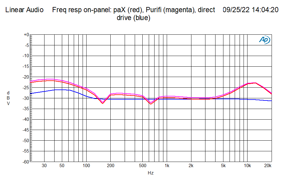

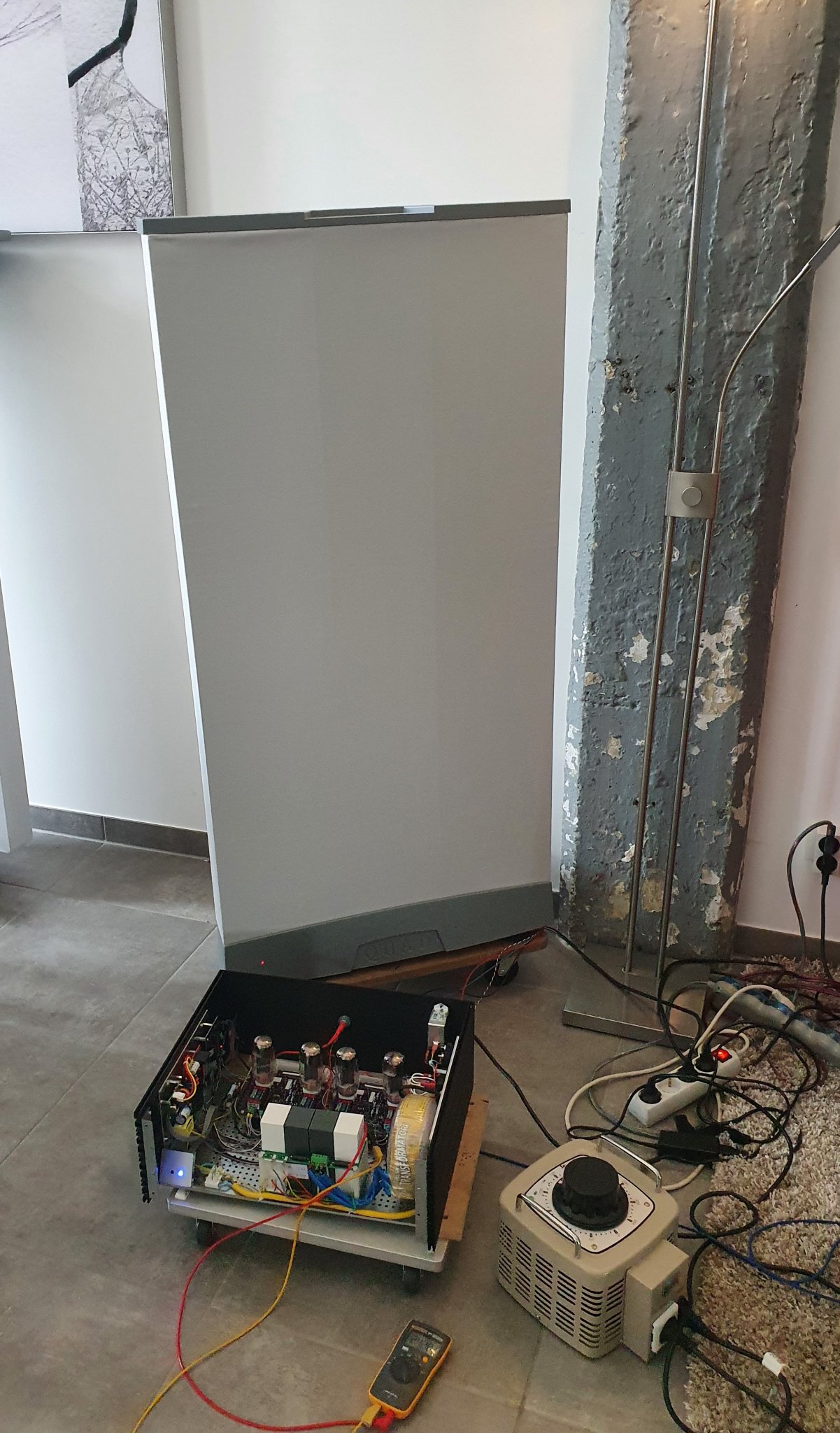

Another step forward.
I am working on the following setup: streamer (Volumio Primo) into a miniDSP Flex with Dirac Live! enabled, into the two stereo DACs of an ADI-2 Pro Fs R.
The Flex has 4 configuable outputs, so one stereo pair goes to the ADI for the DAC that feeds the direct drive amp, and another stereo pair to the DAC that feeds a 'normal' amp that drives the step-ups.
I can switch inside the speaker (IR control) which signal is fed to the stators, direct or from step-up.
So far this all works as advertised.
To prepare for the Dirac runs I intended to equalize the freq response and level of the direct drive and the step-up output at the panel. That way, the speaker level and response is the same whatever the drive selection, and the Dirac room correction would be valid for either drive method.
Attached are the freq response curves; please ignore the average level differences for now.
Two comments:
- that step-up and its networks manipulates the flat amplifer response;
- the direct drive looks good except for some low end bump.
Now, all of this is easily matched with the Flex DSP, but I wonder: do I match the direct drive to the others, or vice versa???
Jan
Note: the two dips are at 158Hz and 632Hz (factor of 4 - why?).

Good to see that you are still working on your direct drive amp with enthousiasm.
If you allow me, in your mail you give a lot of info’s that need some extra detail.
1) When you talk about “step-up” I assume you mean using the Quad’s transformer, but is this with the dual trafo setup including the 3 resistors and the 2 caps or is it just one transformer section.
2) the frequency responses that you show are all taken from your attenuator connected to the HV side, right ?
3) The blue line in this case shows the direct driven FR. I wonder where the 5dB lift between 40 and 60 Hz comes from or is this by purpose ?
4) Then with Dirac Life you have processed the direct drive signal (paX) to match the version through the step-up transformer driven by a purify amp (purify), true ?
5) If “Purify” is indeed the signal through the step-up transformer, I’m rather amazed by its shape including the two dips.
6) So, what was the load on the HV side in both cases ?
Hans
Hi Hans,
I have measured indeed directly on the wiring going to the stators.
The graphs are the freq response measured at the stators, on the speaker, so the load was the actual speaker.
No Dirac processing yet, just a flat signal sweep into either the direct drive or Putzeys' Purify amp and my own paX solid state amp.
I use sets of HV relays to switch the stator leads to the output of the transformer set, or to the output of the DD amp.
No mods on the low voltage input and transformers, so all parts on the primary and secondary are untouched.
I don't know where the 5dB lift on the direct drive comes from, I need to investigate.
You see a similar lift but more pronounced with the low voltage amps through the stepup transformers.
So it is a simple direct comparison on the stators, using either a direct drive amp, or using the stock stepup xfrmrs and their primary and secondary networks.
I have no idea where the two dips come from. I noted that their ratio is pretty perfect factor of 4.
A long shot - assume a resonance circuit in one xfrmr circuit, would that cause a 4x freq resonance on two transformers?
