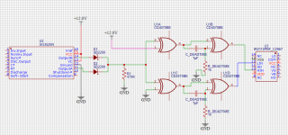

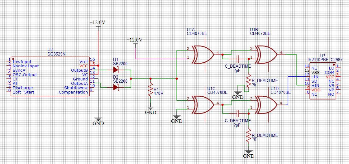

I added the XOR gates like in that schematic i sent, but unfortunately it doesnt work.
The output voltage becomes super unstable, it continues to go up and down. It peaks at more than half Vin.
But something is wrong...... What could be wrong!? I cant understand...
I used C 1nF and R 1K
Here is the schematic again:
Important: The outputs are actually flipped.
The upper XOR gate goes to pin 12 of ir2111 and the lower one to pin 10.

Maybe unstable feedback. To exclude this, try manual duty cycle control. You need to make local feedback for error amplifier , and then add potentiometer from vref to gnd, and can adjust duty cycle manually. Output voltage would be unregulated, but voltage should be enough constant,to exclude instability. At moment can't tell which pins needs to be shorted, but i did that with this ic and with 494 too.
Well i tried but it still does not work. I managed to lower the output voltage but when drawing more current the inductor starts to vibrate at a low frequency (Like 700Hz) and the efficency becomes horrible.

Some time ago i've built psu for charger, it was based tl494 and ir2110, mosfets in halfbridge combination, and rewinded atx transformer. Had several times mosfets blown, until discovered, that ir2110 is very very sensitive where from it gets ground. On pcb i've had long and wide -300v track, at one end was high side capacitors bank minus, at middle - board with mentioned ic's, and at other end low side MOSFET source pin. Also halfbridge had it's own decoupling capacitor very close to MOSFETs. Mosfets blown when psu was just started , even at 50w output . Problem was that driver ic needs ground routed from low side mosfet source, not from elsewhere. When i cut that track from board with ic's and put a wire to MOSFETs source pin, no more blown MOSFETs. So check your layout carefully, if it follows datasheet layout, because this ic (ir2110) has it own limitations.
