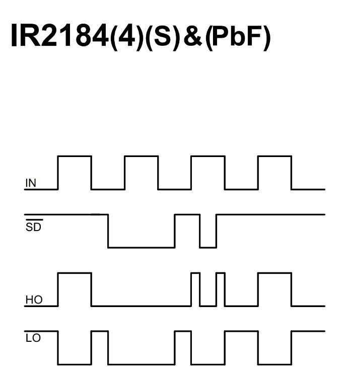

There are other mosfet drivers like IR2184. It requires only 1 PWM input to drive the half bridge. It seems like it 'duplicates' the input signal. But the two outputs of IR2184 are complementary, so they can drive a half bridge with close to 100% Duty cycle.
But SG3525's output are not truly complementary.

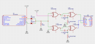

For now, what about joining togheter the two outputs of SG3525 with two diodes? (Sb2200).
The max 50% odd-even pulses from ICs like 3525 are meant to drive isolated SMPSs. However, you may combine the pulses using an OR-gate to obtain double the duty. Since the max duty is only 50% and the pulses never overlap, an XOR-gate would also work.
Using diodes to combine them is equivalent to an OR gate, so yes, it'd work.
An op-amp is not fast enough, you'd have to obtain the complement using digital logic. I'd suggest using a quad XOR gate like CD4070 (not 74HC86) to obtain dead-time and complementary outputs simultaneously, as shown below.Then invert this signal with an inverting OpAmp (LM358) and feed it to the low side input of IR2110 (LI).

Combine using 2 diodes + resistor. Use the circuit in the above link to get LO and HI with deadtime.I just need to use the XOR gates for the inverted signal, right? Because the first non-inverted signal... I can get it by using 2 diodes. Right?
Yes, 3525 dead time is lost, XOR gets them back ...The dead time is already generated by the SG3525, ... Or this dead time 'gets lost' in this 'signal unification' and i have to re-implement it using those XOR gates?
Not sure, but you can try either way and see what duty results at the outputs using a meter ..To let the sg3525 output its maximum duty cycle (So ~50% on output A and ~50% on output B), i should connect the non inverting input of the internal comparator to Vref (5V, pin16) and the inverting input to ground, right? (I need this for testing).
If the power part works ok, there's nothing much to fear about the duty pulses.About the MOSFETS, they are HSP0076A (100V, 1.8mOhm, 200nC@10V, Ciss = 13370pF). IR2110 can source / sink with 2A of current. It works well at... ...So i'm ok for the POWER part. ... the only obstacle that i'm encountering right now is ... duty cycle.
You could find a lot of circuits that use 3525 and 2110 here on this forum, especially from sometime ago. The logic circuit I cited above is also from within the forum.If you can ...send me a schematic so that i can understand better what to do. Including SG3525 (just the output part), IR2110 and additional logic ICs.

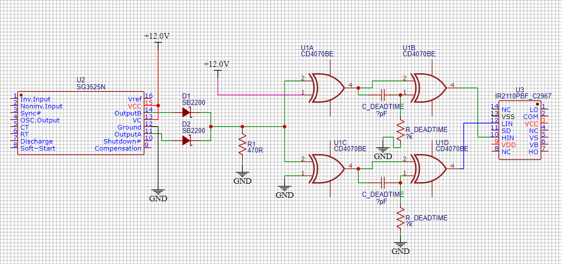

Alright, but how do i calculate the period in ns / us of the deadtime implemented with the XOR Gates? So that i can select the proper resistors and capacitors. I need it to be 500nS. After i know this last thing i will be finally able to make it work.
Last doubt: Are those XOR gates really that much relayable? Even more than fast OpAmps? Can they handle 200 - 500Khz signals?
Will my design be relayable using theese XOR gates to handle the signals for the mosfet driver?
There will be no errors / distorsion in the signal, right?

Look at this schematic:
Is that it? Is this right?
I only need the values for the resistors and capacitors to get a dead time of 500ns.
Hopefully there will be no shootthrough in the half bridge with the implementation of the XOR Gates.
Let me know if this is right. So that i will proceed making it in the prototype board and then see if it works.
Once again, thank you so much for all the help.

I know, some gate drivers have integrated dead time like the IR2184. But IR 2110 does not have integrated deadtime.
Most gate drivers with separated input (HI & LI) dont have integrated deadtime.
So i need this circuit (If it works) to generate deadtime so that (hopefully) i wont get any shootthrough on the half bridge.

Ok, alright. But the solution with the XOR gates will also work, right?
I even have the CD4070! I had a variety of logic ports ICs laying around, and luckily i just found the IC i needed!
So, lets see if this solution works first. Its probably more relayable too, i guess.
I just need to know how to calculate R and C for a 500nS deadtime.

Nice, but you seem to drive the complement into HI and the straight pulse into LO, which might give an inversion at the output. This is why one needs to test the duty pulses for polarity and proportionality.Schematic:
There's no calculation which is why you'd have to simulate. Besides, the dead-time could also vary on the threshold levels and make of the CD4070. I would start with a large capacitor (say 1nF) as recommended by Osvaldo de Banfield and iterate according to the shootthrough and heat that results.Does somebody know how to calculate R and C?
Well, if i had a oscilloscope it would have been waaaay easier...
Anyway, i'll try this out and see what i get.
I am going to flip the connections on the ir 2110.
I am using polyestere capacitors, hopefully they're fine for this Application.
At 100kHz the period is 10uS.
So i'm guessing that 1uS deadtime will 'suck up' 1/10 of the energy thus 'limiting' the total duty cycle at 90% (I may be wrong here).
I may have to select an even lower deadtime like 250 / 100 nS for higher frequency applications. Hopefully i will be able to obtain short and precise deadtimes with that XOR gate solution.
