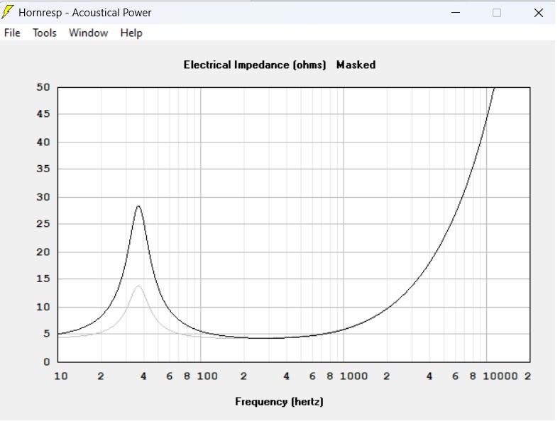

It is not best example, but here you have the Dayton UMII-15 in 150l closed box with its original Bl value and then about doubled:
See, between 23Hz and 60Hz, the model with lesser motor force shows more output. Well, because it gets more input.
Based on the constant voltage drive but different impedance, it is not a discussion or opinion:

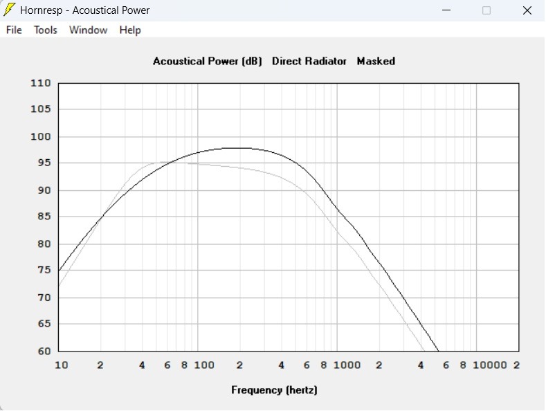

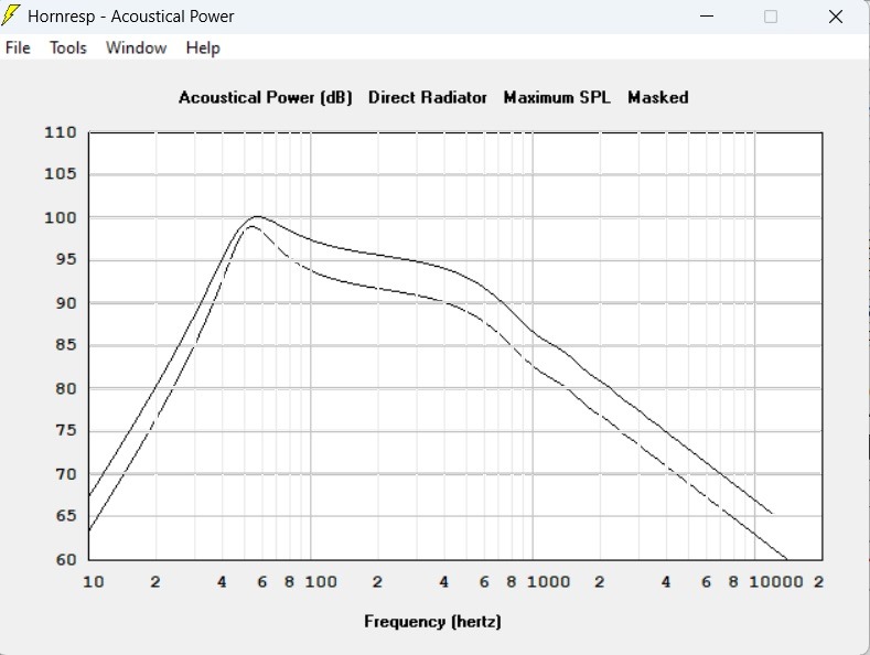

I worked on this an asked mr. @David McBean to implement constant power curves in the hornresp. And he kind of did already! You can watch constant power responses!
So, here we go, The UMII-15 with Bl 23,1 vs Bl 14,61 simulated by Hornresp at 1Watt. I do not remember anymore, but I guess phase is accounted for, so you are looking at real power, not apparent power. That is ANOTHER HUGE MEGA CAN OF WORMS on top of that, that 95% of people ignore. The different Bl value sims have different scales, so sorry for poor overlay.
1Watt SPL response:
And yes, the upper line is the one with higher Bl.
It is painfully obvious from many sides than Bl adds output (efficiency), and so seeing a case where it takes output, should make you stop, step back and reevaluate what´s happening. Why you get the data you are getting. One piece of data of the two contradictory pieces of data MUST be wrong. This is not fuzzy logic or quantum particle behavior. 🙂 It is mutually exclusive.
Of course this must be accounted for in the design. High Bl high impedance drivers are tough cookies to drive. Once you start exceeding 600V p-p input as I did on RCF LF21N551, you have some mess on your hands. That´s why IPALs are so low impedance.

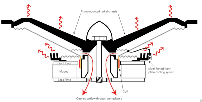

Anything that can transfer more voice coil heat directly to the outside air, rather than the magnet structure is useful.
Getting the motor's heatsink to transfer it's heat to the outside air in a 1.25 cubic foot box would be an innovation.

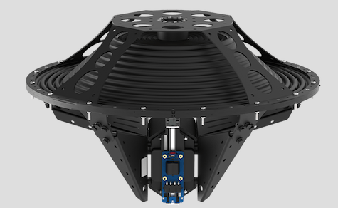

The Brane Audio Repulse Attract Driver (R.A.D.) is an example of "groundbreaking" new motor technology used in small enclosures:
https://www.diyaudio.com/community/...pel-attract-driver.395631/page-4#post-7632469
Reducing the amount of heat generated, rather than transferring it seems "cool" to me 😎

The Volt use of an external chassis frame as a heat radiating surface is a good concept.
Now you're thinking! Imagine the cooling you would get if the entire motor was outside of the enclosure, and the voice coil was directly exposed to the outside air. 😲 😉
I have listened to the Brane, and it's really good for a little bluetooth speaker. Those things hardly generate any heat at all, just because they run on such a little mount of power. Different game there - efficiency is king in that world. But their tech is highly impractical for use as a large subwoofer.

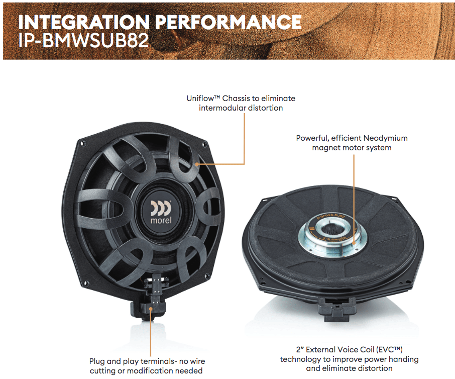

And on the small side, the cute 8" Morel Ip-BMWSub82 with the usual hype:
If rear mounted, the Ip-BMWSub82 is external structure does not protrude (much) from the baffle, a good characteristic for small subs. It would be "cool" if more options like it were available at prices commensurate with performance.

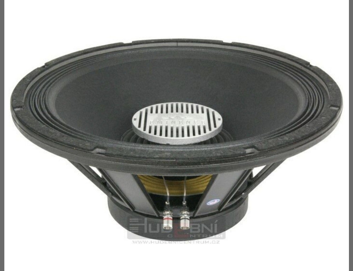

Does an alloy cone on an alloy former achieve this to an extant ina practical way?
It can, aluminum alloy cones certainly transfer heat faster than paper pulp, and won't ignite at Fahrenheit 451, or 233C, which doesn't make as good a book title.
Art
