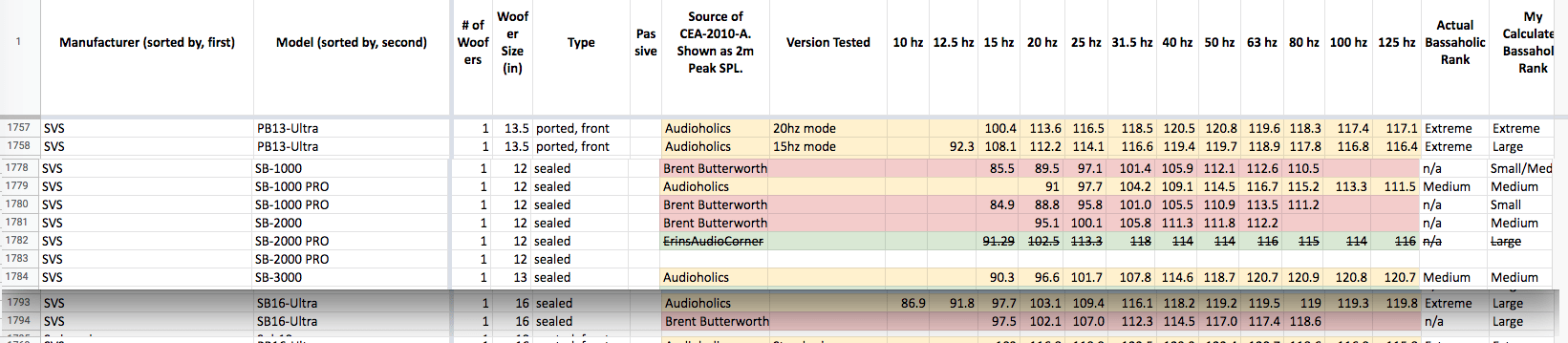

A near field in room test says nothing about free field output, longevity, or distortion.The SB3000 has roughly 1.6cf of internal airspace, it is close but not as compact. It is a very close contender, though.. they nailed it. The external dimensions of mine work out to roughly 1.85cf. Also keep in mind that the simulated response of mine based off just the Fb and Qtc alone isn't a representative of its measured low end response, especially in different sized rooms. We have measured -3db @ 17hz with an 80hz L/R4 in nearfield during testing on an earlier revision.
Third party outdoor tests like the CEA-2010-A above do.

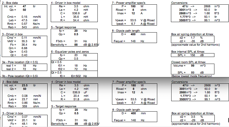

No handy example, but Siegfried Linkwitz ( the Linkwitz of Linkwitz–Riley filters) made a handy calculator:I'm curious if you can qualify these statements with some examples?
https://www.linkwitzlab.com/Amplifiers-etc/SPLmax.htm
The distortion estimation accounts only for 2nd order distortion.
The formula is taken from his spreadsheet "closed-box1.xls".
distortion in % = 0.014*Sd*Xmax/Vbox
Sd is the cone area in cm^2
Xmax is the peak excursion in mm
Vbox is the internal box volume in liters
Vbox is in the denominator, so a larger box would reduce this distortion source.
Halving the box size doubles the box air spring distortion H2 distortion:
Anyway, Siegfried Linkwitz (RIP) knew what he was doing when he made the spreadsheet.

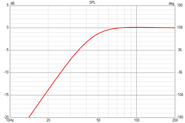

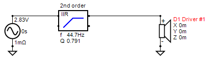

I feel like you are smart enough with vituix cad to model a filter to match its response like you did with mine, and simulate it on that subwoofer.No, I don't. Neither have I seen an impedance curve for their driver, nor its raw sound pressure response before it's placed in the enclosure, both of which would have been interesting. I assume that the manufacturer judiciously made use of EQ as power is cheap, albeit the driver must withstand its application.
Sure, that wouldn't be too difficult, but I don't see it as being particularly useful; the response is what it is. The whole point of my earlier simulations was to take a look at what an Fb = 39Hz and Qtc = 0.62 response would look like, considering that it was being achieved in a compact closed-box enclosure. It was simply exploratory in purpose, to try and gain a better understanding of a particular physical realization, and the −3dB cut-off frequency of 17Hz seemed difficult to achieve in my simple simulations.

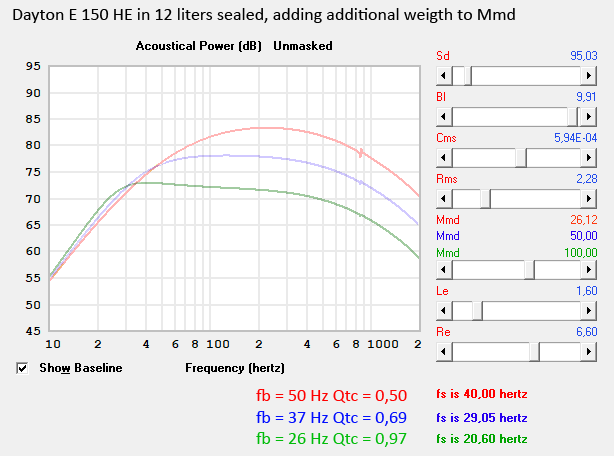

Fb is the box tuning frequency of a bass reflex enclosure, which does not change with the mass of the driver.You need more mass to get low end extension. With a light mms, the Fb goes too high to have any low end once you start shrinking enclosure size.
Fcb, the resonant frequency of the driver in a closed box, always increases from Fs (Free air resonance).
More Mms does (generally) lower Fs, and a lower Fs will have a flatter response in a sealed box, but that does not mean a high Fcb precludes it "to have any low end".

Interesting. The specifications of the 12W7 in a compact sealed enclosure are: Fc = 44.7Hz, Qtc = 0.791, F3 = 40.4Hz, Vcb = 1.375 cuft (38.94 litres). The simulated frequency response of the equivalent second-order high-pass filter is shown below. It matches up quite well with JL Audio's specifications. Unfortunately, they don't show any measured results, but I expect that they believe that Small's analysis of closed-box loudspeaker systems stands them in relatively good stead.The Gotham subs use bone stock W7 car audio drivers..

This simulation shows that in fact the very low end response is really pretty much I think actually dominated by the ratio of cone size to box volume. The notion that the bass is getting more extended may sound so perceptually but is actually kind of fake; it's really the top end getting choked off which then makes F3, F6 lower. But the actual power to put out the very low notes is hardly affected by the moving mass.
--> I think at this point, you just have to simulate each driver you are thinking of.
Hmmm, something like the red curve I'm feeling will complement a -12 dB lowpass filter which is "undertuned"
The "less low end" is because as you say the sensitivity increases but that was specified by Small as a mid-band quantity. So Hoffman applies more to full-range woofers...the "less low end" is not because the actual sensitivity at very low frequencies has changed.Do you know what happens when you increase motor force but keep the mms the same? Sensitivity increases. Are you familiar with Hoffman's law? High sensitivity, low end extension, and small enclosure size: pick two. When you increase the motor force / mms ratio, you increase efficiency/sensitivity. The higher these are, the less low end extension you will have for a subwoofer in a given airspace. This is pretty basic stuff.
