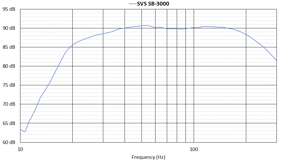

It will be interesting to see what it looks like. My curiosity is getting the better of me, so can we please see a teaser pre-Cedia photo?It is a 15" that has a Fb of 39hz and a .62 qtc in a 1.25cf sealed enclosure, and it is going to be displayed in a demo booth at Cedia in a few weeks by a high end hifi company.
The SVS SB-3000 comes to mind. It's "only" a 13-inch driver, and the gross enclosure volume based on external dimensions comes in at a very compact 2.15cuft (61.0 litres), so the net volume is likely to be close to that erstwhile goal of 1.25cuft sealed volume in compactness. The SB-3000 has a nicely extended low-frequency response, being −3dB at about 22Hz. That is a true high-end level of performance concerning that parameter. See the frequency response plot below for confirmation.It is in the same playing field as many other hifi sealed subwoofer designs of similar usage, with the others needing more airspace for a similar alignment. Given the constraints of 1.25cf sealed volume, it is very good. There is nothing out there that I am aware of with this low end curve in that small of an airspace.
Interestingly, the SB-3000's measured response in the 40Hz to 150Hz region is also very flat, which helps to simplify the user's job of setting the low-pass/high-pass filtering on the system where it is being used. It is not an easy task for a subwoofer to exceed the capabilities and usability of the SB-3000. I guess that's where the SVS SB-16 Ultra might come to the fore.
The SB3000 has roughly 1.6cf of internal airspace, it is close but not as compact. It is a very close contender, though.. they nailed it. The external dimensions of mine work out to roughly 1.85cf. Also keep in mind that the simulated response of mine based off just the Fb and Qtc alone isn't a representative of its measured low end response, especially in different sized rooms. We have measured -3db @ 17hz with an 80hz L/R4 in nearfield during testing on an earlier revision.

The information that has been presented, consisting of Fb = 39Hz and Qtc = 0.62, fixes the response shape of the woofer in whatever size sealed enclosure it might have been placed. How a natural frequency response that is −3dB at about 45.6Hz is converted to a response that is −3dB at about 17Hz is not immediately clear. To achieve that with a low-pass LR4 filter would require a low-pass cutoff frequency of 28.8Hz. The simulation shown below gives the before and after frequency response functions.
It seems apparent that the action of the LR4 filter is noticeably affecting the response below 20Hz, and over 12dB of attenuation has been introduced. It seems quite clear that a choice of Fb = 39Hz comes with significant acoustic penalties.
This is somewhat confusing. Potentially it seems to point to the provided Fb and Qtc values being somehow in error; or the system being measured is greatly nonlinear in its dynamic behaviour (undesirable). Those two parameters, correctly determined, are sufficient to define the low-frequency response of a sealed enclosure. Can it be assumed that Fb was determined from the measured peak in the impedance curve? And how was the value of Qtc estimated?
The measurements that were provided appear to have a very well-defined 24dB/octave roll-off at low frequencies. That's double what a sealed enclosure typically produces. This result just adds to my confusion.

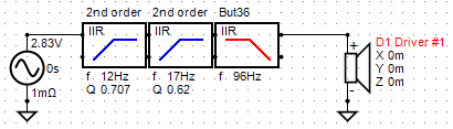

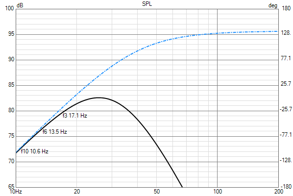

A VituixCAD model can be created to represent the system response. It is shown below.
This simple model produces a quite close approximation to the measured results that were provided, corresponding to the curve with the higher output. The simulated frequency response function is shown below. The driver sensitivity was set to 119.5dB for this example.
