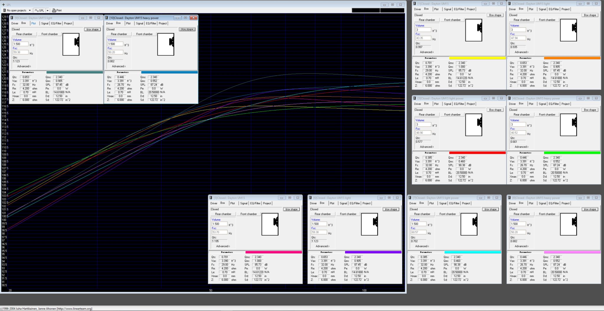

So, for comparison, we are going to use the new Dayton UMII-15 with its parameters found here.
I have created 4 drivers from this, with everything being identical except for changes in motor force and mms.
First we model them in Dayton's recommended 3cf sealed at 900 watts of power. You can see that UM15 light loses a slight amount of low end and gains a slight amount of high end vs. the factory UM15. Motor force / mms ratio increased here. When we compare UM15 light power and UM15 heavy power, we see that they both lose output compared to the first two, because the motor force doubling has increased the motor force / mms ratio on both of them even more. Neither of them meet the output of the factory UM15 and UM15 light until 30hz. UM15 heavy power has slightly more low end and loses high end vs. UM15 light power. This is pretty much in line with my statement of a higher motor force / mms ratio making the sub act more like a woofer.
Now we take all 4 of these versions at the same power and shrink the enclosure volume in half to 1.5cf. Uh oh, they all lose low end. Factory UM15 and UM15 light both lose the most low end extension, naturally. UM15 light power and UM15 heavy power have more low end than the first pair, but UM15 heavy power takes the lead from UM light power below 50hz. Naturally, because of its higher mms.
Now, we get to where what I have explained is important. We are going to compare UM15 light (the theory that light moving mass is what you want) vs. UM15 heavy power (high motor force, heavy moving mass) in 1.5 cubic feet with more power budget. We have 1500 watts to work with now. As you can see, the UM15 light has a lot of high end but falls on its face at 40hz and is 3db down by 30hz compared to the original UM15 in its factory recommended airspace at rms wattage. UM15 heavy power almost exactly matches the low end of the factory UM15 in its factory recommended airspace at rms wattage, and it also has more high end than even UM15 light in the factory recommended airspace at rms wattage.
So, to be able to cut the enclosure size of this sub in half and get the same performance, all we needed is: more motor force, more mms, and more power. Pretty much exactly what I have said, yea?

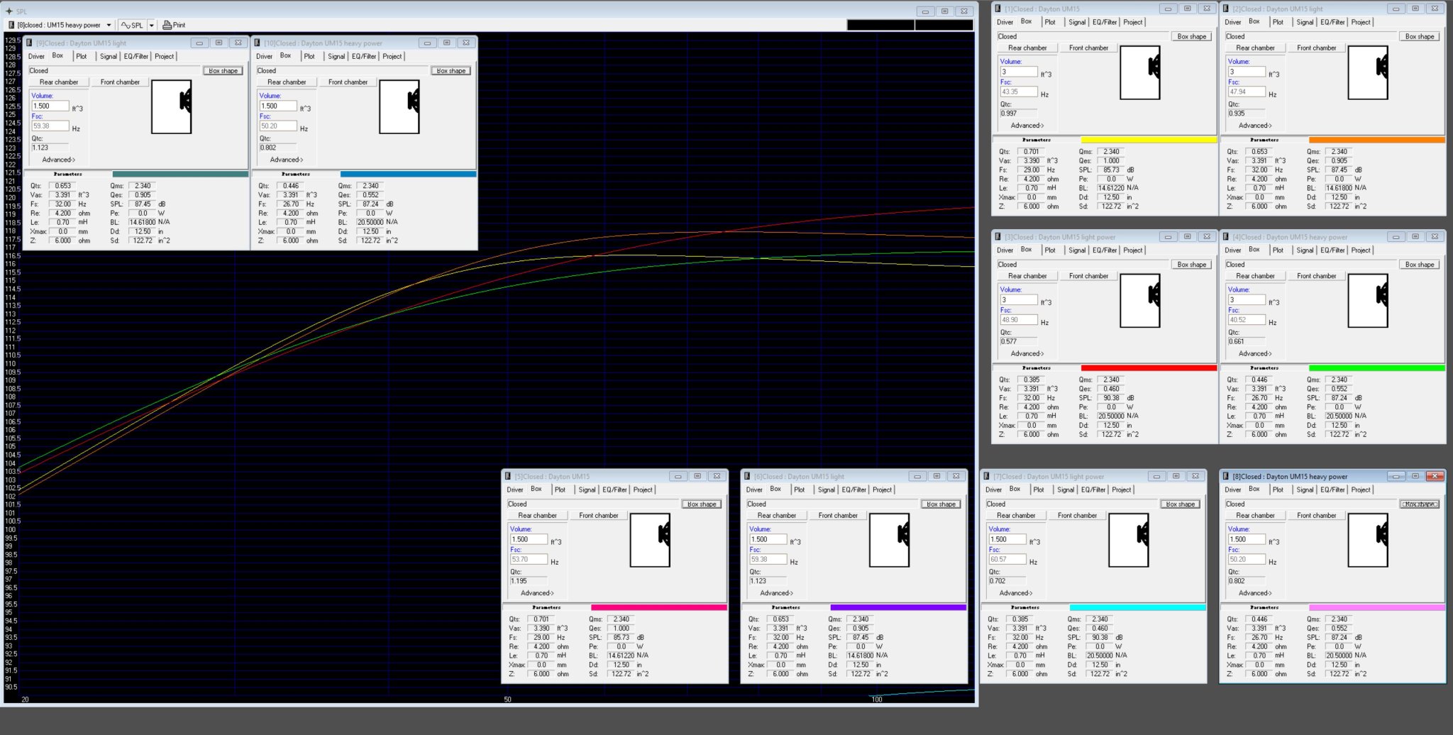

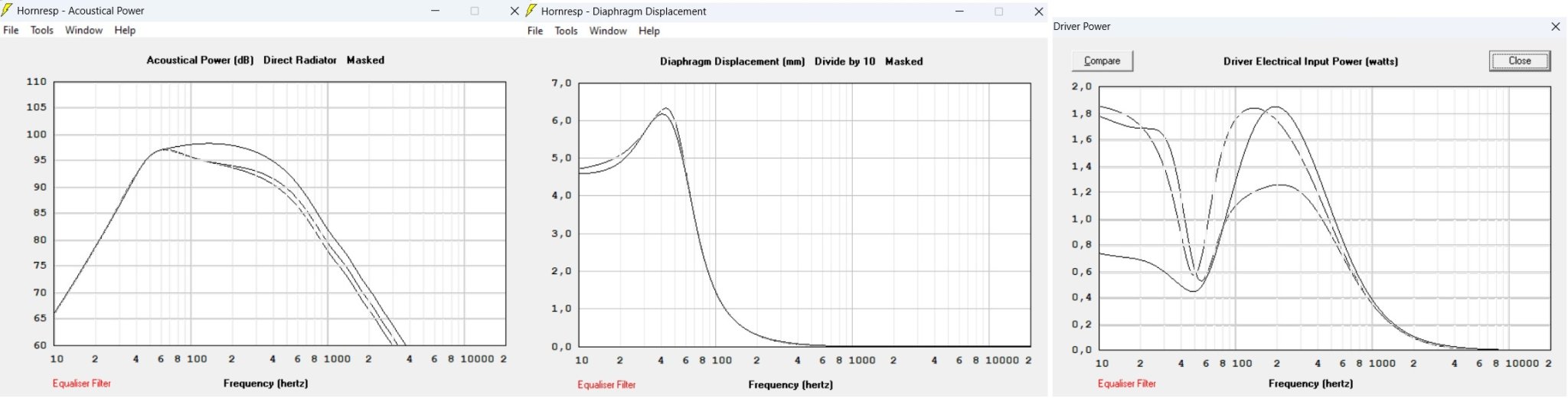

So, here are overlayed SPL, cone excursion and power input graphs of the Dayton speaker in 1,5cu.ft volume (usable band 20-120Hz, due to the Hornresp limitations). One is original, one is 50g lighter on Mms.
For the response, the EQd solution works the same. For cone excursion, the sim shows that the lighter version would have little lesser excursion, but I disregard that, as for the same SPL, same excursions should be produce.
For the power graph, the Upper range above 50Hz speaks for the lighter version, 20-50Hz range speaks for the heavier version.
Funnyly enough, for different case, I argued that my solution eats less power, heats up less, and program content is not RMS power, and so this claim of power and heating was disregarded, with some members arguing that it doesn´t matter and I basically lost that argument to the higher power draw being ignored. Now here we have it again, only now I am on the higher power draw side, It´s the only thing You can pick on, and it cannot be lost both ways. Which is it? 🙂

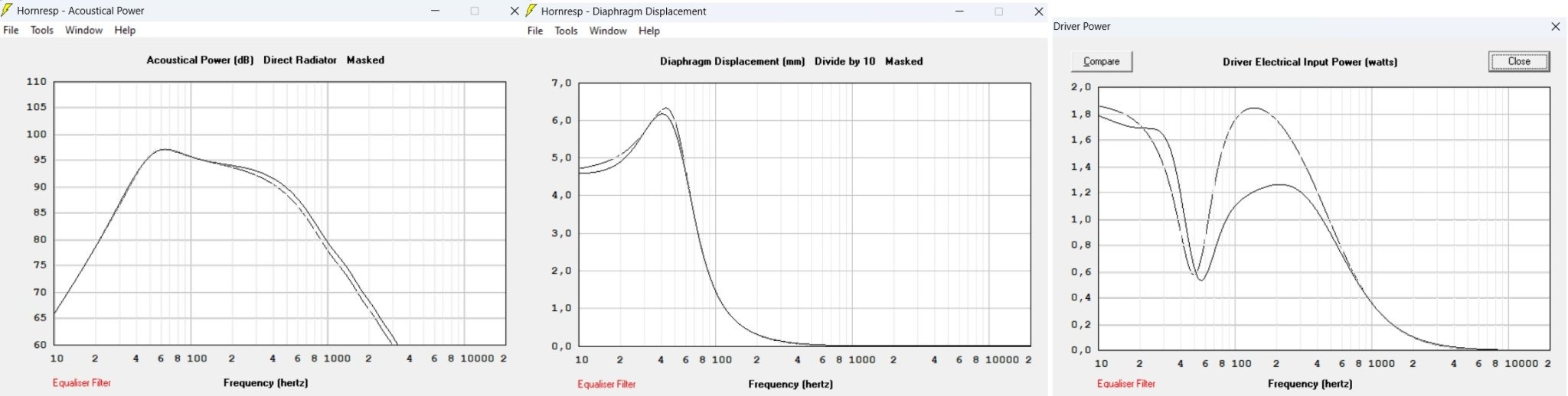

Now, I up the lighter cone model Bl, and EQ to the same response.
Hornresp is limited by amount of eualizers, so now lets focus on 10-60Hz range, where I equalized it out.
See, lighter cone and stronger motor after EQ can do same SPL, but with muchless power. Analogically, If you add the power back in the low end of the speaker, the SPL will go up there too, and so light cone strong motor solution can give you more SPL down there too.
But unequalized high Bl driver will show less SPL in the bass region. It does not make it less subwoofer. It makes it a device with altered impedance, that needs different voltage to be driven properly. It DOES play bass, and power by power, it does play bass more and better.
The thought process that strong motor will make it less of a subwoofer, and light cone will make it less of a subwoofer is not fully true. The strong motor has more damping and needs more voltage for the same power input to keep the voltage response, and the lighter cone only loses around the impedance peak of the heavier cone speaker Fs moved down a bit, not in the whole band. So I cannot agree with your assesment.

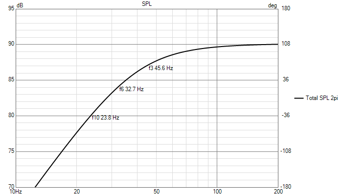

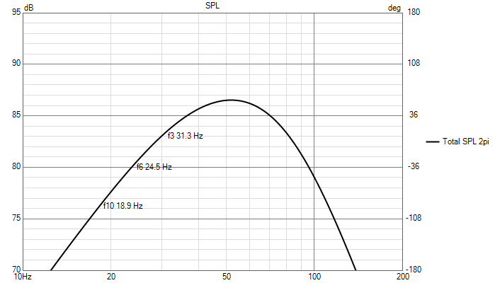

Is an Fb of 39Hz truly in "subwoofer" territory? It seems quite high. The expected natural response is shown below, and the −3dB point is a very high 45.6Hz.The title of the thread literally says small enclosures ... a new subwoofer design ... low end extension in small airspace .... a 15" that has a Fb of 39hz and a .62 qtc in a 1.25cf sealed enclosure,

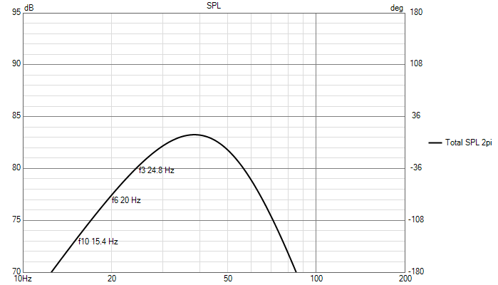

Of course, if we add an 80Hz 4th-order Linkwitz–Riley low-pass filter, we get the following response. The action of the low-pass filter now extends the −3dB point to 31.3Hz, albeit with a loss of 3.5dB in sensitivity. Here the input power requirements have gone up by 220%.
If we instead apply a 50Hz 4th-order Linkwitz–Riley low-pass filter, we get the following response. The −3dB point is now 24.8 Hz, albeit with a loss of 6.8dB in sensitivity. Here the input power requirements have gone up by about 470%.
And we still don't have a −3dB point of 20Hz for this subwoofer. I guess that's the penalty that needs to be paid when cramming a large woofer into a small enclosure.
