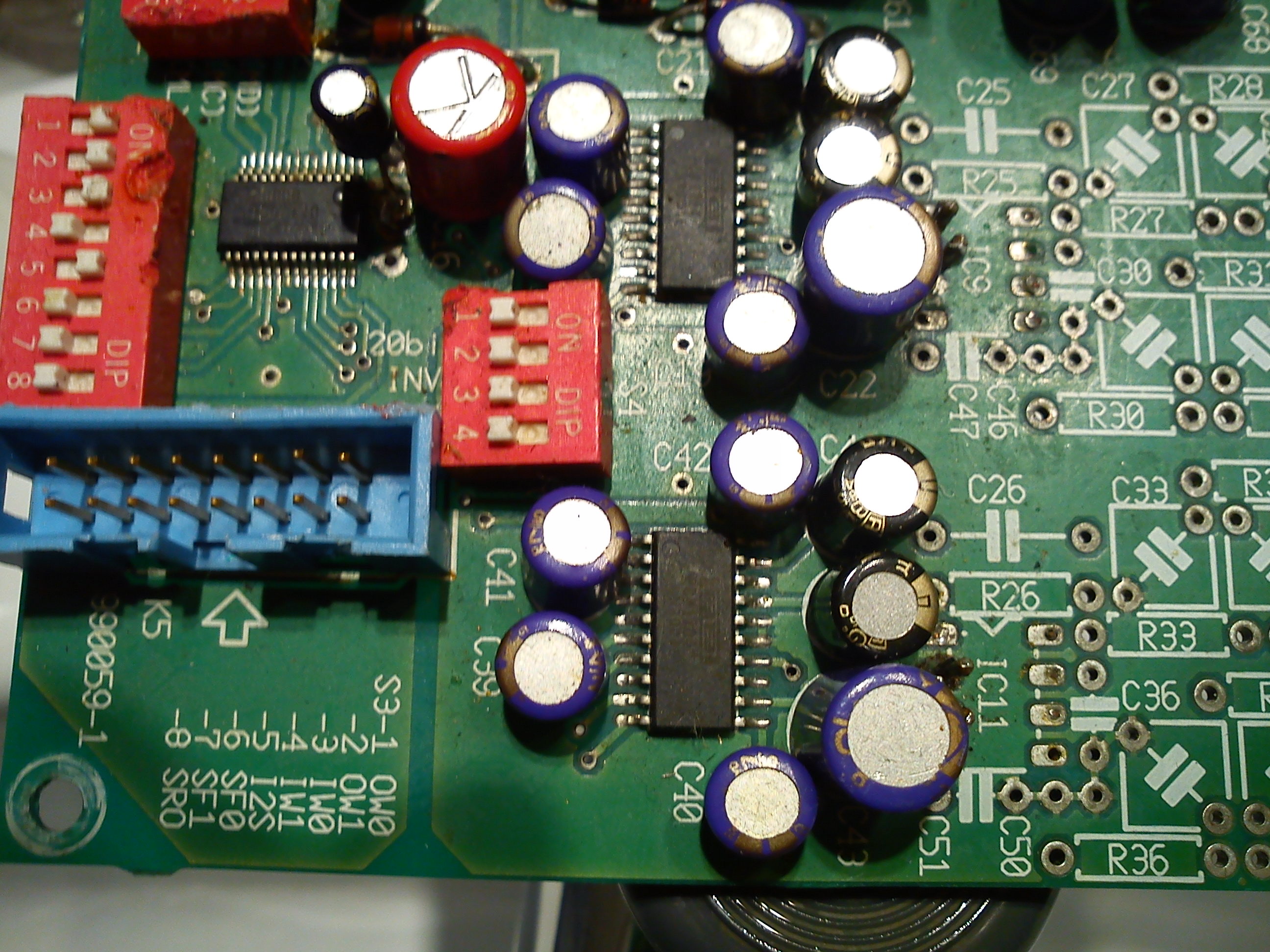

Is your 1704DAC ready to open the input ports? It comes with DF? The daughter board needs to be placed between the I2S source and the 1704.
Please let me know your configuration.
Thank guys.
Ian
I have the Elektor HIF2000 DAC: 2 pcm1704 + 1 df1704 and in a separate board the receiver CS 8414/16.

Ian, any experience with TDA154x (1541)?
TDA1541 can accept standard I2S signal. So normally we do not need the I2S to PCM daughter board to interface fifo with it.
However, it has a L/R simultaneous input mode(OB/TWO connected to VDD1) which I thinks might be better option for SQ. But the data format has to be in offset binary.
I know there are a lot of 1541 expert over there, any comment on this issue?

Hi Ian,
I'm no expert but I've been listening the the TDA1541A running at 16bit/44.1k using the FIFO for a bit over a month now. With the I2S to PCM convertor board you get the added "advantage" of oversampling of up to 8x (352.8k).
The 1541A will accept up to 4x oversampling in I2S mode, so the oversampling can be done before the FIFO, the benefit being less added jitter after the FIFO.
So you have a few options:
- Use FIFO connected directly to 1541A using 16/44.1
- Oversample 4x before the FIFO then to the 1541A
- Oversample after the FIFO up to 8x but with the added jitter of conversion.
Hope this helps. If i've made any errors anyone - please correct me.

Thanks Ryan,
In this case, we need running 1541 at L/R simultaneous input mode(OB/TWO connected to VDD1). But the data format has to be in offset binary, if I'm not wrong. Do you have any experience on this offset binary format?

The L/R simultaneous mode is probably the most desirable way to use your board with the TDA1541. Very few TDA1541 designs use offset binary because of the complexity of the glue logic required to do this.
I have never tried it, but my understanding is that offset binary is the same as two's compliment, just with the MSB inverted.
These two links seems to explain it well.
C3Dformat
Offset binary - Wikipedia, the free encyclopedia
I will be interested to try offset binary with the TDA1541 this when the boards are finally ready.

Please allow me to advise.
This board Ian is making will allow the option of a simultaneous output of offset binary Left and Right Data. For TDA1541 enthusiasts, and tinkerers, this will allow a person to create a dual mono TDA1541 board. Also possible is a dual differential, or balanced output TDA1541 board.
I know many people will be interested in these possibilities.
And it may be worth nothing, but I have read reports from those that have tried it, that the offset binary data input sounds better than the i2s.
I don't know, but I am keen to try it.
It will also allow the use of the TDA1540 chip.
can a synchronous oversampled 4-8*FS output from this board be fed directly to the TDA for DEM reclocking, or is the only way to adjust the DEM by the use of specific capacitor values to adjust the normally free-running clock?
Qusp, the 1541 has limited bandwidth to about 6.5Mhz. The DEM has successfully been clocked from BCK at 2.8Mhz by several members following such designs as member "ecdesigns" (John Brown) has used in the past.
