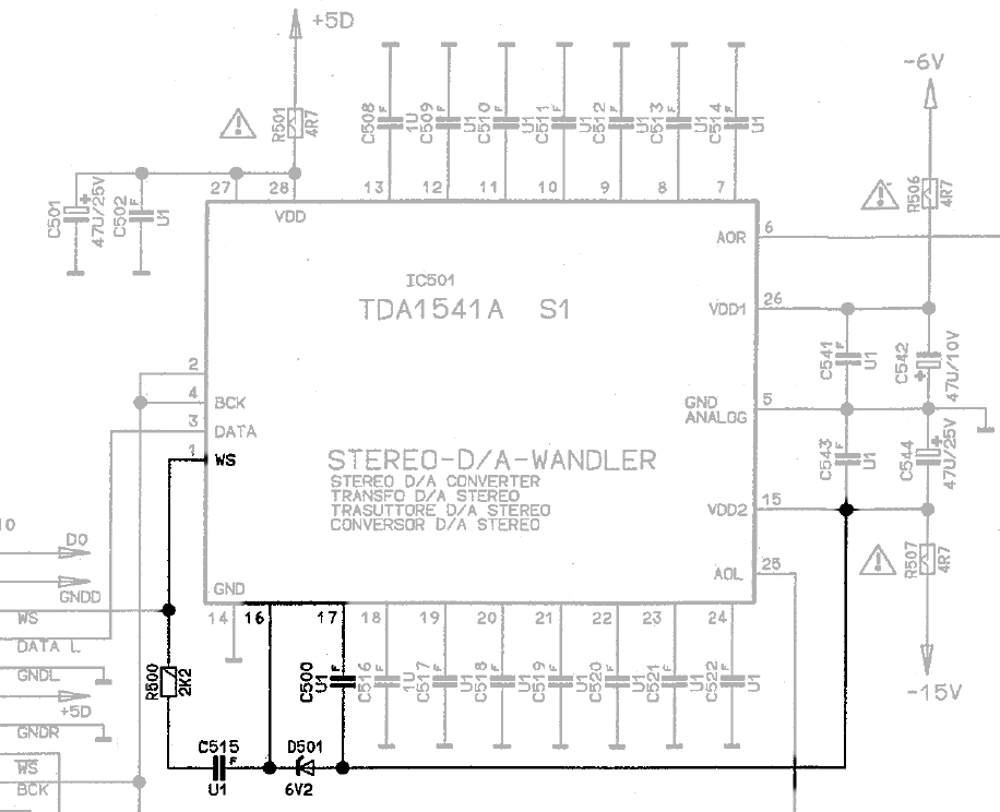

can a synchronous oversampled 4-8*FS output from this board be fed directly to the TDA for DEM reclocking, or is the only way to adjust the DEM by the use of specific capacitor values to adjust the normally free-running clock?
You need to divide the oversampled output by 2 or 4 respectively if you want to try DEM reclocking with oversampling.
Adjusting the capacitor value between pins 16 and 17 is another way to adjust the speed of the free running clock- but in which case it will not be synchronized. My 2c is that the Grundig method is the best sounding reclocking method. here I made some comments about the sound.
