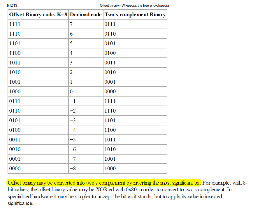

TDA1541 offset binary solution, please confirm
1. “Offset binary may be converted into two's complement by inverting the most significant bit.” So, to get an offset binary data format on both DL and DR which were two's complement format, I just need invert the MLB if the corresponding jumper is set for TDA1541. Is that OK?
2. To run NOS DAC’s at differential mode, we need a group of the reversed left and right data. For an I2S format (which is two’s complement), this usually can be done by just inverting the data line.
So, nDL=~DL; nDR=~DR;
The only problem is that will result in adding 1 LSB DC offset on the DAC output. Because the real reversed data should be equle to ~data +1.
Is there any problem on the 1 LSB DC offset? Or, it’s not an issue?
3. Method 2 will apply to data in offset binary format the same way as two’s complement to get the reversed data.
If all answers are yes, the offset binary mode would be no difficult to achieve.
Ian

Hi Ian,
thank you for your time and efforts used for such DIY gems.
In my humble opinion inverted I2S or offset binary stream for differential TDA1541 DAC is ok.
Because 1 LSB DC offset is permanent and really small (about 60nA),
such DC offset can be simply ignored, especially in cases if there are 2mA current injection circuits on the TDA1541 outputs.

Hi regal
at first, it looks you are right: inverting word of all 16x0 to all 16x1 ( or vice verso) should cause clipping.
But we are talking here about two differential data streams: one as it is, another inverted, both from same source.
I can not understand how can be any clipping in inverted stream if it is simply mirrored and here is no any clipping in source?
Do you have personal experience with clipping of inverted data stream?
Good to know that🙂I hear what you are saying
but I would think the "digital" offset would cause a clipping at max output, no ? I guess we need to try and measure.
We are talking about the +1 DC offset introducing to 2's complement format by inverting it for DAC in differential mode. To make it easier, I take 4 bit for example:
For a 4bit 2's complement format, the range will be -8(1000 min) to +7(0111 max).
If A=+7 (0111, max), the inverting result will be -8 (1000), so the differential output would be +7 - (-8) = +15, it's exactly 2*A+1;
OK, If A=-8 (1000, min), the inverting result will be +7 (0111), so the differential output would be -8 - (+7) = -15, it's also 2*A+1;
And more, If A=0 (0000), the inverting result will be -1 (1111), so the differential output would be 0 - (-1) = 1, still 2*A+1;
It's just a 2'complement converting method, I didn't see there is any problem except the +1 issue.
But agree with you, I have to have some test, just to confirm. But I no longer keep my old TDA1541 DAC now🙂.
Ian

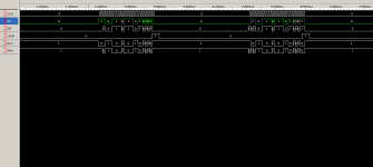

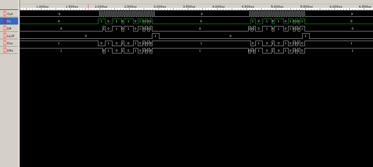

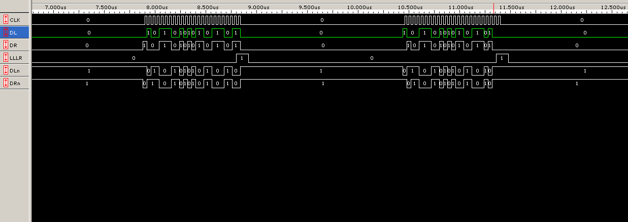

Offset Binary format option for TDA1541 achieved
PcmTransmitter.v
//2013-01-19 Add offset binary format jumper for TAD1541 OB mode
//2013-01-20 Optional offset binary output achieved
module PcmTransmitter(
reset, //system reset
mclk, //system clk
obflagn, //offset binary format flag
endmodule
Please see the actual measurement screen shot from my logic analyzer for details.
Tested at 384Khz Fs with MCLK=256Fs.
Ian
