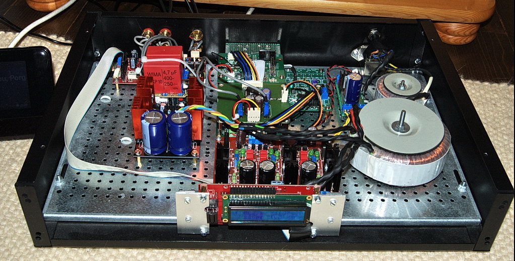

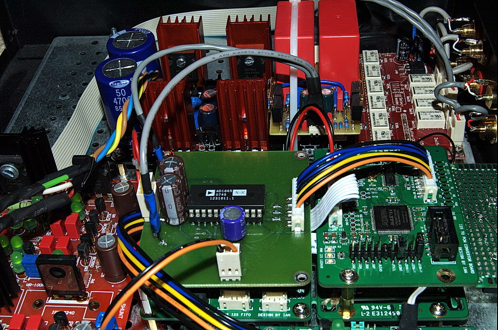

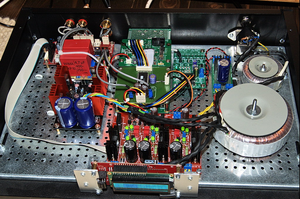

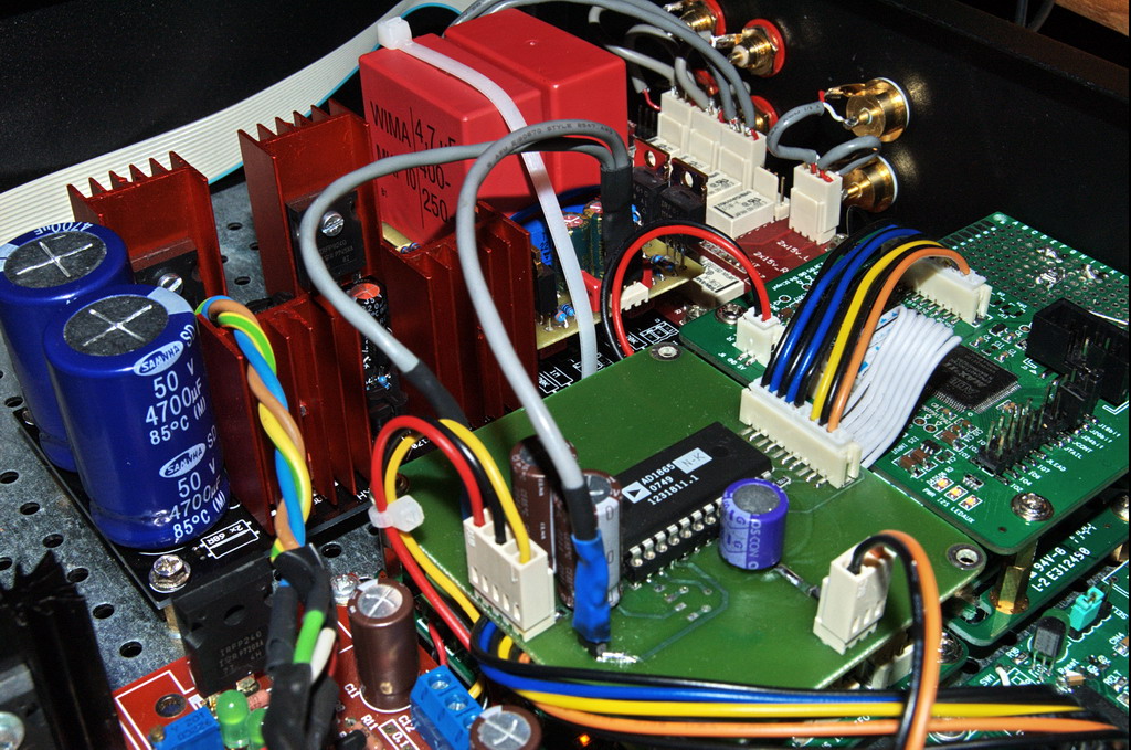

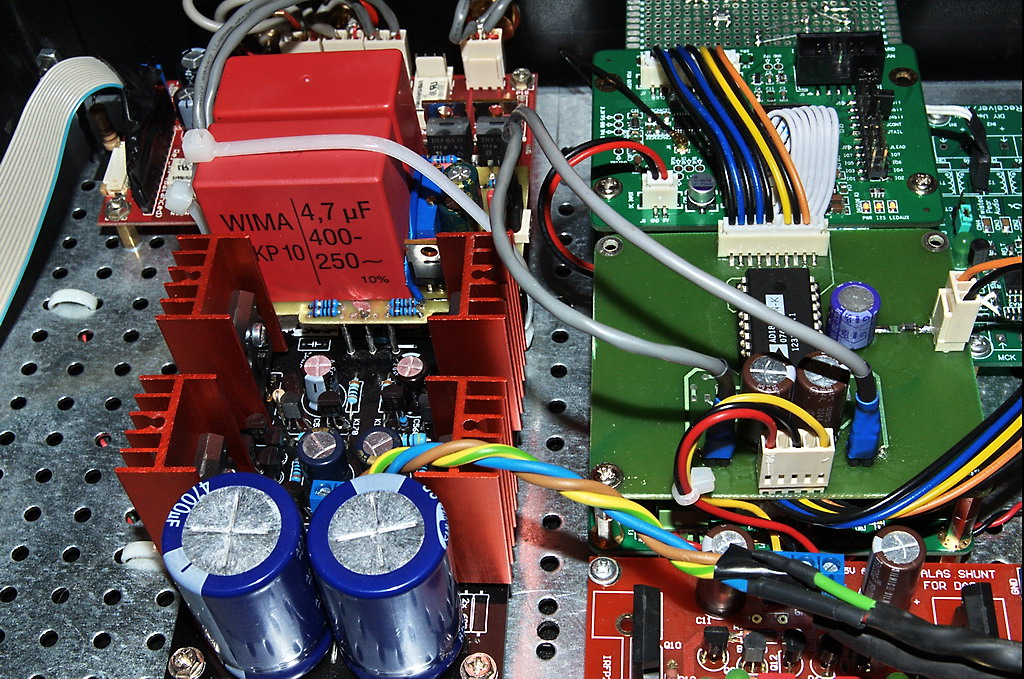

So here comes the mass I call my DAC 🙂
From top-left to bottom-right the modules are:
- r2r volume control and input selection connected to the controller with LCD from middle-bottom
- dual Salas shunt regs from a DCB1 Hypnotize board and a Pass D1 I/V converter to fit over the empty space of the Hypnotize board
- yummy DAC and FIFO sandwich 🙂 the temporary DAC PCB one day will be replaced with one containing a selectable digital filter (DF1706) when the source is 44.1Khz (CD). Before somebody complains: 0603|0805 decoupling caps are on the bottom of the DAC board 🙂
- bottom of DAC sandwich are 3 Salas shunts feeding the AD1865. When the digital isolator will be ready one of them will also fed the clock and I2S-to-PCM board
- then comes a SPDIF receiver with CS8416 connected to a SPDIF buffer (Jocko like) that is on the back side of the veroboard with the BNCs
- finally a 5V prereg for the FIFO and some shielded over-sized toroids
What is on the workbench:
- another DCB1 Hypnotize board to have a buffer after the volume controller
- your digital isolator board
- small selector to switch between two I/Vs
Thanks, Zsolt

Hi Zsolt,
Your DAC looks great! It's amazing how you could fit everything into a very compact space. You have SPDIF interface, FIFO, clock, daughter board, AD1865, D1 IV,shunt regs, controller with LCD... almost everything 🙂.
I like your 1865 core board, looks very clean, I almost couldn't help...
Why my Salas shunt reg is much bigger than yours? As well as my D1 I/V. Did I miss some wonderful group buy? What is the Hypnotize board? I'm interested in the board.Can you give me a bit more details?
Thanks Zsolt for sharing pictures of your system with us. It seems I need take some time to get understand every details🙂.
Merry Christmas
Ian
because his is part of the hypnotise board, which does not permit as much flexibility, or as high voltage (without modifications) its similar to the hotrod DCB1. it has an analogue stage on there, along with the regs, but many ended up just building the regs with it to power other things, which without using the free space like he has, makes them larger, not smaller.
His version of the D1 is much lower voltage and lower current, thus smaller, hes not even using heatsinks at all.... I admit its very cool indeed fitting in the empty space like that, neat idea, but in the NTD1 development thread you can see how profoundly different the performance is with NTD1 and ESS to stock D1 and ESS, no way in hell it will fit in that space. NTD1 uses no buffer but MUCH higher class A bias at more than double the voltage to push the transconductance of the mosfets up and thus bring the impedance down along with THD to match. this brute force uses space
me included ...

You're too polite about the almost empty 1865 core board... at least I left generous space for that : )
I think qusp summarized well enough the hypnotize board - actually I like more the Salas regs you have but I got tired always rebuilding my stuff.
Indeed I'm using the stock version of D1, dunno if more voltage or current would help in this specific case -maybe an active current source or different fet or jfet- might try if I got tired listening to this... but till then...
Merry Christmas
Zsolt
