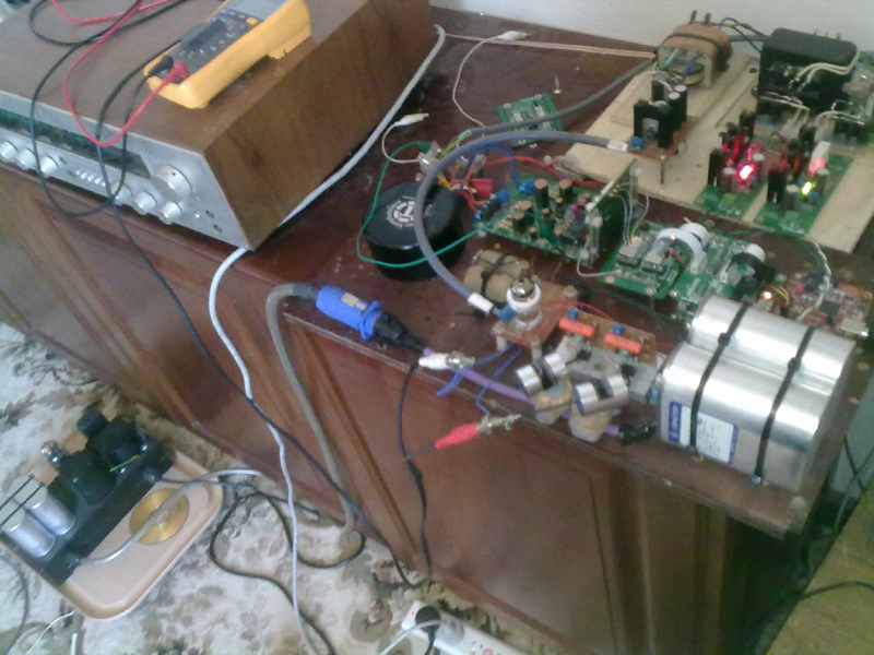

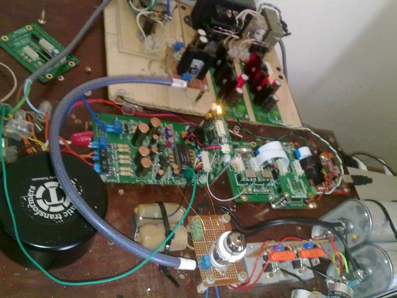

Dear Mr. Ian,
Running PCM board from WaveIO un isolated I2S plus MCLK distorted sound, low level.
Measuring voltage at PCM board I2S input is 1.6V sort of thing. Voltage at DAC chip pins 1 - 4 is super low, 0.8V. I did measure 3.3V when I first installed it, its not a faulty unit - i somehow managed to kill it. :-( (ok, or maybe it just died).
Not wanting to give up on PCM just yet, Ian can I please buy another board?
Sincerely,
Shane
Back to I2S to 1541A = distorted.
Changed amplifier = Music.
Re-instated I2S to PCM board and all adjustments, same Music.
There were some LF oscillations whilst running without MCLK - looks like I took out the transistor amplifier, or some part of it.
Maybe the WaveIO through to 1541A is actually ok - I don't know, still low voltages at DAC chip inputs. Had seem 3.3V there before, its like 0.8V now but it works - kind of.
Some oscillations and DC sounds on substitute amplifier pot, measured DC at output of coupling caps. Seems running without MCLK can really do some damage. Need to replace analog output stage (passive I/V ecc88 ccs loaded RC out)
Question for those who might know, could oscillations be to do with digital side of things as well as analog, or purely analog domain?.
Remaining hopeful.
Shane
All good.
Got my hands on a new old transistor amplifier and replaced the output stage coupling caps.
Some HF oscillations notable with volume pot at half position with no signal playing, touching caps/tube/CCS lead-in make squelching noises.. don't know yet but it sounds that good when its cranked that I'm sure the digital side simply must be functioning properly.
Thats an old 70's NAD receiver with some old Jensen speakers. They sure never sounded better.
Using Audirvana and the 45.xx and 49.xx clocks with Dual XO running from WaveIO, I can only go so far as 192kHz without massive distortions, but you know what?.. it doesn't matter, it sounds good enough as it is, really good. I'm calling it a day and going to try and fit it all in a box.
Shane
