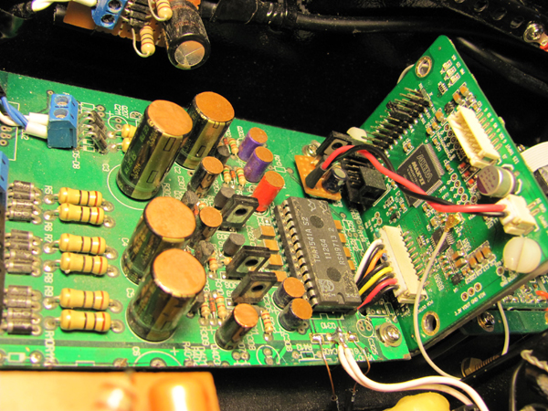

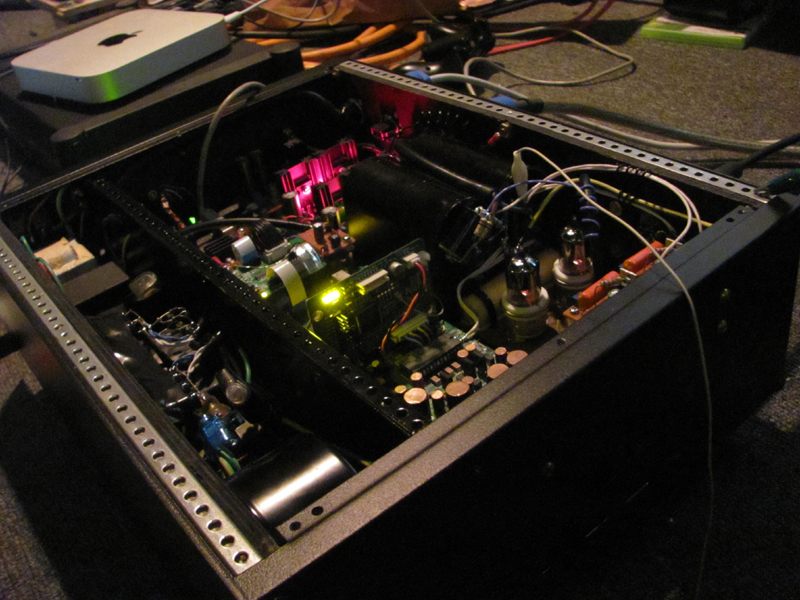

Hi Chris,
I'm using ISO > Dual XO > I2S to PCM in that order which then feeds the 1541A in simultaneous mode, each with separate supplies provided by separate windings on the PT secondary.
The AYA II board doesn't use 7805.. or any other three terminal reg. When you get your board you'll see exactly what I'm meaning. Very nice discrete regulators, operating without feedback and buffered for very low Zout.
As you can see, its a cut-down AYA board, so there are supplies which aren't used for CS receiver etc, which can be put to good use for clocks, PCM boards etc.
hth
Shane
