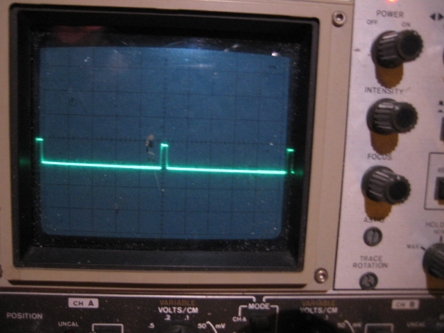

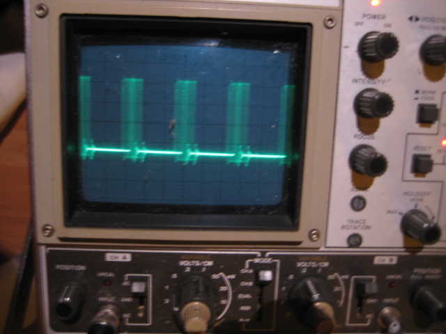

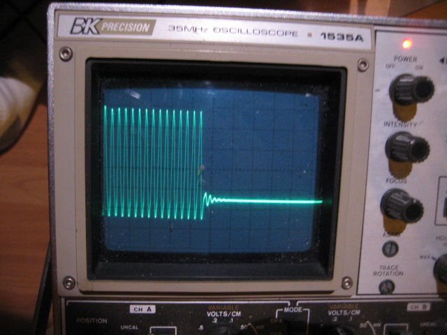

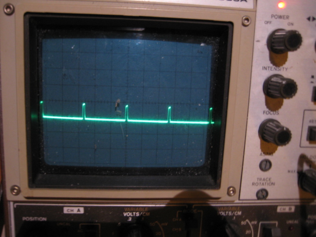

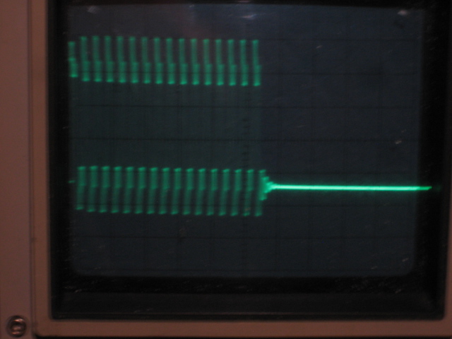

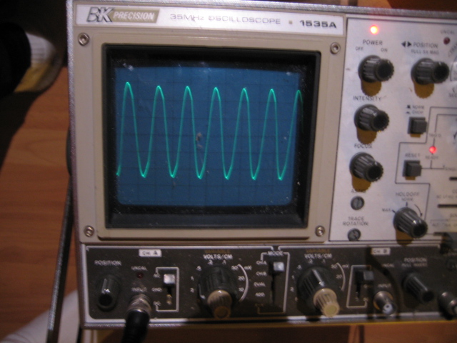

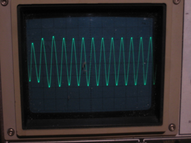

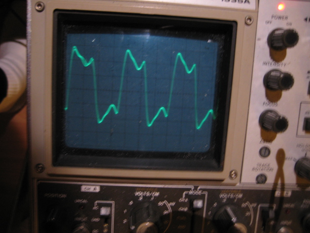

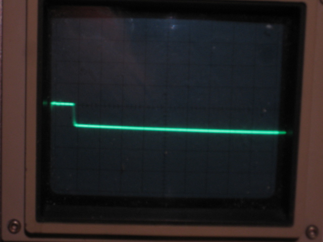

PCM waveforms
Continuing with my 192kHz tda1541a non-performance, I have attached some shots of the PCM signals at the dac chip input pins for 44, 96, and 192 kHz. Approximate calculated CLK frequencies from the scope are 2.8 mHz for 44 kHz, 6.0 mHz for 96 kHz, and 12.5 mHz for 192 kHz. The vertical scale is 1v/division and the horizontal scale is 2uS/division, except for the large CLK images the scale is .1uS/division. The scope is 35 MHz, not 20 MHz as previously mentioned. The picture titles give descriptions of the waveforms.
The CLK waveforms appears to ok to me, but I don't know much about digital so if anyone has a comment, please let me know. The frequencies also appear in the ballpark to me.
As noted before, the CLK is not attenuated at all and it appears to be approximately 5 v peak to peak. The unattenuated LLLR and DL and DR (no pictures) are approximately 3.3 v and their attenuated value at the dac chip is approximately 1v as shown in the pictures.
I also upgraded the WaveIO firmware to the latest and tried playing the 192kHz material again, but no success. The WaveIO also has its own power supply capable of supply more than .5A so power should not be an issue.
Ben

pcm waveforms
I just wanted to add that the last picture of the 192 DL waveform is .2 uS/division.
Ben

Thanks, Oliver. The reason I posted the waveforms was to see if anyone sees anything wrong with them since I cannot get my WaveIO-PCM board- tda1541a dac to play 192kHz material. 44 and 96 kHz work and sound great but 192kHz is noise with very low level distorted sounding music in the background.
Right now I am wondering about the 5v CLK. The CLK seems high since the PCM board is supposed to output 3.3v as I understand it.
I am attenuating the LLLR, DL, and DR with 1k ohm in series to the dac input and 680 ohm pull down to ground and 1k ohm up to +3.3v supply. The level at the PCM board is 3.3v and the level at the dac chip input is approximately 1v. Right now I am wondering if that is too low.

From you waveforms, CLK signal looks good, but LLLR and DL, DR are definitely too low(compare with CLK), did you measure them with same probe?
Try to measure those PCM signals again with/without load (TDA1541A) to see it that is a load related problem. Probe set at X10.
Good luck
Ian

Hi Ian,
The PCM signals appear low at the dac chip pins because of a signal attenuation circuit that I described in post #608, which had been used in the past by ecdesigns. I measured the signal at the PCM board output with the 1541a attached and they were between 3 and 4 volts, so I don't think it is a load problem. The signals are reduced by the attenuation circuit, and appear about right for the component values of the circuit.
I will take out the attenuation circuit in the next few days when I take the setup apart to install the fifo and see if 192kHz works. I will turn my one box dac into a two box dac in order to fit all of the fifo/ isolator/dual clock/PCM boards and power supplies. Then it will be easier for me to remove and replace the tda1541a board in order to make changes.
