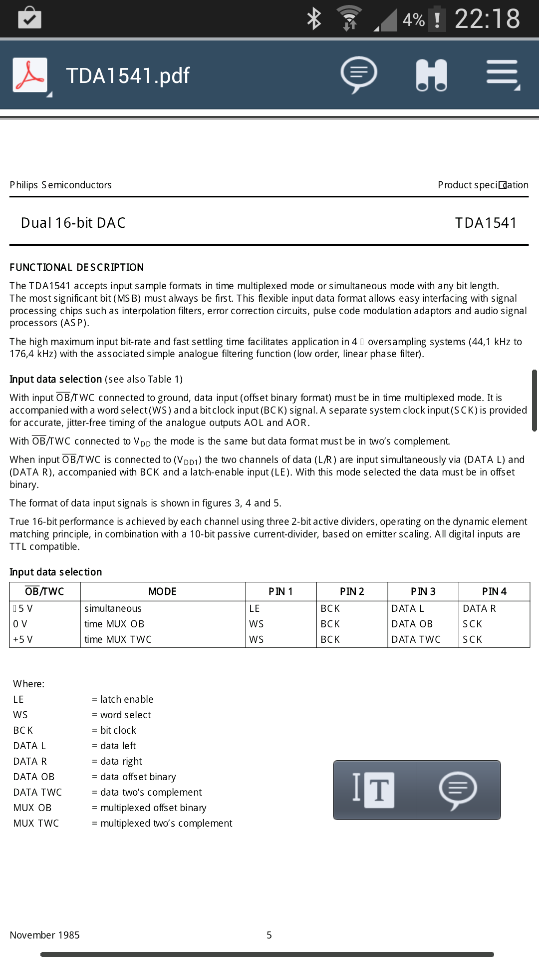

Reading the tda1541 datasheet last night I finally clicked I think on what the simutaneous mode is. From what I understand the chip can be fed by offset binary or twos complement dependant on the voltage applied to one of the pins, either -5v,0v or +5v. Simutaneous mode is -5v?
And Ians board separates these and then DL and DR go to their independant input pins?
Is that correct? Is that the mode you are using
Note here, the datasheet talks about input modes, Pin 27 needs to be at -5V or VDD1 potential to allow simultaneous mode. It also shows the DL, DR, BCK and LE pin connections.
Hope this helps and you get it running! Report back your thoughts!
Drew.

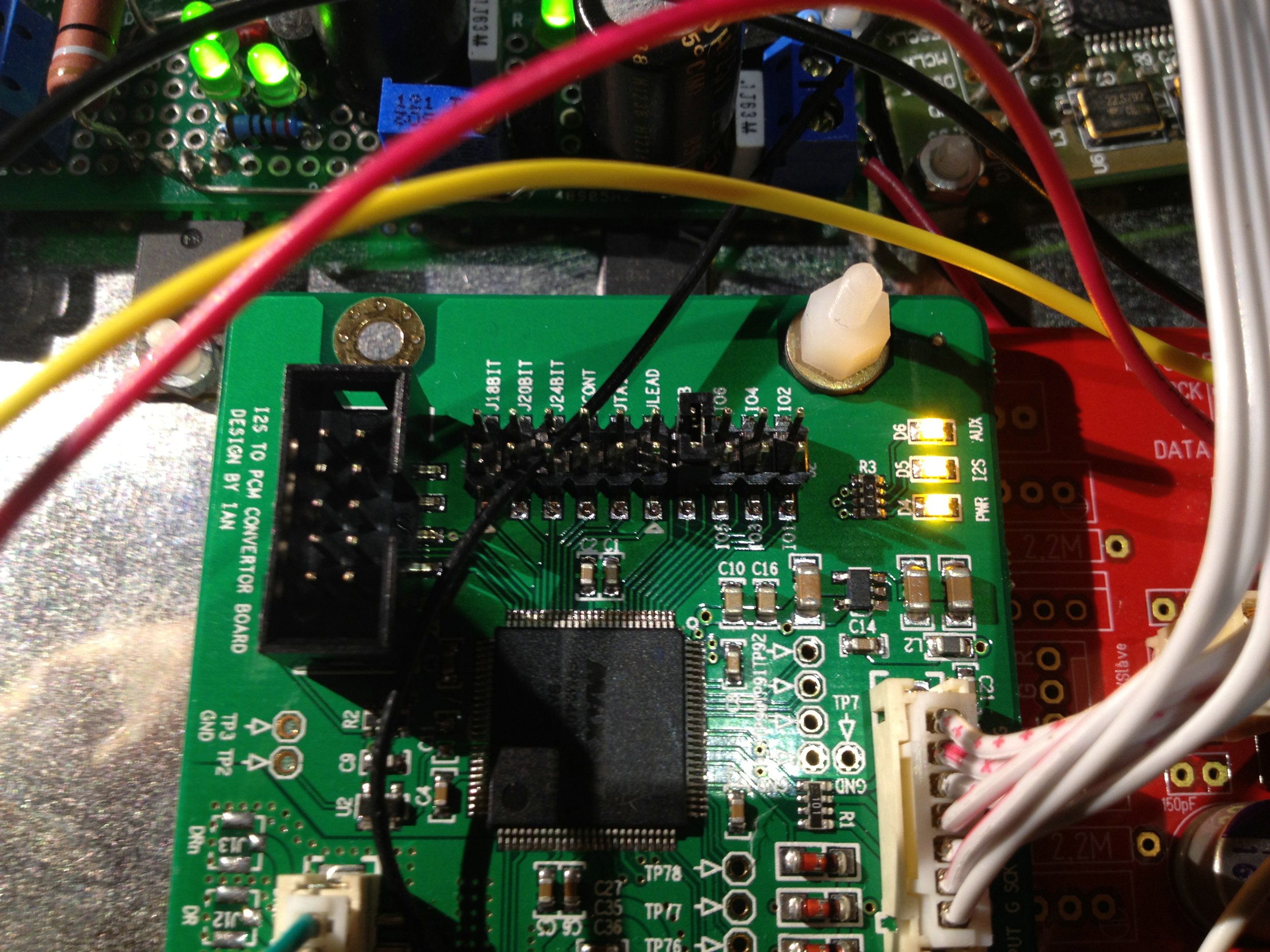

got the new pcm board! many thanks, it looks splendid!

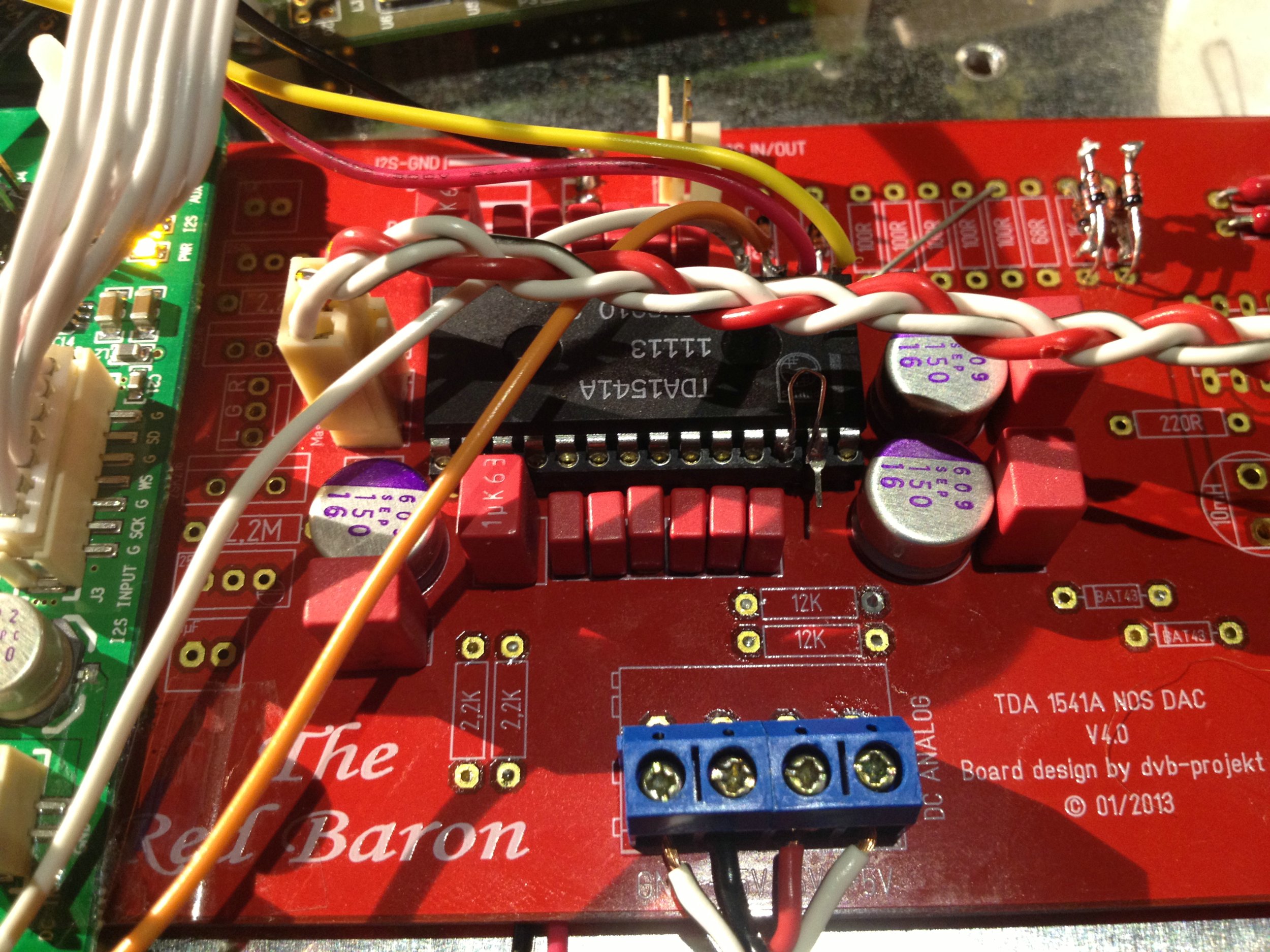

It seems that I need some advice or help with connecting it with Amanero and TDA1541 dac from Oliver.
Need to say that Amanero + TDA alone work fine.
the PCM board and TDA are connected as stated in the manual, jumper is set to JOB.
Amanero and PCM are connected in the following way:
MCLK -> MCLK
BCLK -> SCK
FSCLK -> WS
Data -> Data
Ground -> Ground
all three leds are glowing, so connection should be correct I assume.
DL and DR output pins are soldered directly to TDA chip.
BCK also goes directly to TDA chip.
LLLR is connected through 1N4148 diode as stated for -ecdesigns- latest 3.3.v i2s modification.
Unfortunately on the output of my DAC I get huge distortions, what could it be? Tried to set the board at half speed, no difference.
Did you switch TDA1541A to simultaneous mode by jumping pin 27 to -5V?
PCM interface is different from I2S interface.
Just hope it helps to solve your issue.

hi Ian,
thanks! just have switched it as it should be and thought that the problem has been found and solved, but unfortunately same distortions still persist. 😕
Did you try the normal connection without the diode?
I suggest you asking for advise from Oliver to see what he get back to you.

Cheers Ian,
removed the diodes, check all TDA's power supplies, made a mod to Oliver's dac (DEM oscillator), unfortunately the sound is still distorted.
Do you have any ideas what else could be checked?

Cheers Ian,
Hi deses,
Did Oliver get back to your with some advise? I didn't find problem from your pictures. Just hope I can see the waveform which could tell exactly what was wrong.
If it would be any help, I can sent a new PCM board to you to confirm they are good.
Is there any suggestion from anyone else?
Ian
