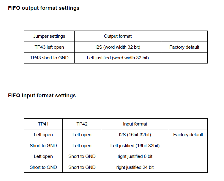

Hi Ian,
is it possible to use your I2S to PCM board to drive this DAC? http://www.dddac.com/documents/dddac1794_nos_ver30.pdf
The schematics of the actual board is here:
apoo

Hi apoo,
Nice project!
From the spec, PCM1794 is not a traditional R-2R DAC, and it accept right justified format which is not the 'PCM' format. So, I don't think you need this I2S to PCM converter.
It's very nice you run it at NOS mode 🙂.
Ian
Gday Ian,
Just wondering if we use your adaptor to make it right justified then run into the FIFO, is that a possibility or is there an easier way I'm missing? The Amanero will output right justified I believe just havent had time to check, Doede also delays one channel by 32 cycles to make the signal equal in the time domain. any thoughts on this please?
Many Thanks for the efforts!
Drew.

HI Drew,
FIFO can receive all formats and can output both I2S and 32bit left justified. I don't know if that is what you want.
Is that 32 bit delay for dual mono DAC configuration?
Ian
Gday Ian,
It is a dual Mono dac yes. if the 1794 receives right justified how would thw fifo output this? I'm still getting my head around the timing signals a bit, kots going on here!
Thanks again!

If no: you don't this I2S-PCM board.
Zsolt

The delay line as I understand it is so the left and right data arrive at the dac at the same time. reading the data sheet says the 1794 will take left or right justified, no idea how this is set and if it affects the NOS setup the Doede worked so hard for. im just wondering if the jitter induced by the 74HC chips is detrimental to the dac. if the FIFO can be setup to output right justified as a dual mono setup, but as I mentioned, in this regard I am a newbie and am not sure about any of this really. Happy to learn, just getting my head around it all....
Thanks,
Drew.

Let's try to touch bases...
First of all I assume you want to use the FIFO.
1. Doede's main board has I2S input, Ian's FIFO has I2S output... you can connect FIFO recloked output directly to Doede's main board input.
2. You want to skip the delay line from DDD1794 main board... you will need the FIFO + I2S-PCM converter board to convert I2S into MSB first, right-justified format and connect I2S-PCM output to [Data-39, BCK, LR] and [BCK, Data-7, LR] as DL -> Data-39, DR -> Data-7, LLLR -> LR, CLK -> BCK
You might want to ask Doede directly about point 2.
Zsolt

Hey Zsolt,
Appreciate the assist. Im figuring Doede has done the delay for a reason. The main reason I am thinking of straight from the fifo is to avoid the probable induced jitter from the 5 of 74VHC chips he uses for the delay. I have no idea if an FPGA could be capable of doing the delay before the fifo. The next thought I had was if delayed could two fifos be run off the one clock set so they run in time. the prob there would be the need to separate left data into one and right data the other. This is assuming I am understanding whether the FIFO does this already. I am just spitballing, so I realise this will have a bunch of issues conceptually so no need for a bunch of blokes to hang crap on an idea.
Understanding for me means being able to explain it to someone else and they understand. I am not at that point yet.
Really appreciate the assistance Zsolt, not trying to make you feel bad if I have.
Thanks,
Drew.
Thanks,
Drew.
Zsolt
Hi Zsolt,
am answering here for apoo and myself, we are working together on this projects.
Yes, the idea was to skip the DDDAC1794 mainboard by taking the signal straight from I2S to PCM board - if it would be a match.
From your quoted answer I deduct this is a straight match, since you mean that what Doede has named Data-39 and Data-7 is the same that comes out under DL and DR from the I2S to PCM board. Is my understanding correct?
Thanks,
Abel
The reason he has called it data 7 and 39 is sara 7 is the right channel and data 39 is the left. he delats the left by 32 cyxles which I am figuring is the number of "bits" or changes of state between the left and right channel. I dont remember why he delays rhe right channel, but from my understanding it is so the dac runs as dual mono, the left and right data is arriving at its chip at the same time to reduce any time smear I assume. But 32 cycles out of a 24MHz clock signal is not very long......
Yes, this is how I understand from Doede's document.From your quoted answer I deduct this is a straight match, since you mean that what Doede has named Data-39 and Data-7 is the same that comes out under DL and DR from the I2S to PCM board. Is my understanding correct?
But please check with him as well!
PCM1794 is configured for Digital filter bypass - Mono (see specs Table 2.)The reason he has called it data 7 and 39 is sara 7 is the right channel and data 39 is the left. he delats the left by 32 cyxles which I am figuring is the number of "bits" or changes of state between the left and right channel. I dont remember why he delays rhe right channel, but from my understanding it is so the dac runs as dual mono, the left and right data is arriving at its chip at the same time to reduce any time smear I assume. But 32 cycles out of a 24MHz clock signal is not very long......
He has to delay both channels in order to have 24bit right justified of both: delay right channel by 7 cycles and left by 39 cycles to have the LSB bit of both data channels clocked in when right channel's latch goes low.
31-7 = 24
63-39 = 24
(31 and 63 because I2S format has data delayed by 1 cycle).
Right-channels's I2S latch signal (LR) latches both L and R DACs.
Having reviewed how that works I'm 99% sure I2S-PCM board can be used to bypass Doede's delay line.
But why on earth use PCM1794 when you can use any good old R2R DAC with this I2S-PCM board?
Zsolt
