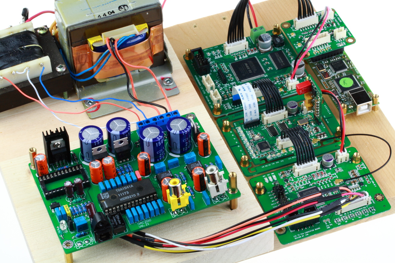

Some good news: PCM1704, TDA1541A confirmed working at 384KHz driven by PCM board

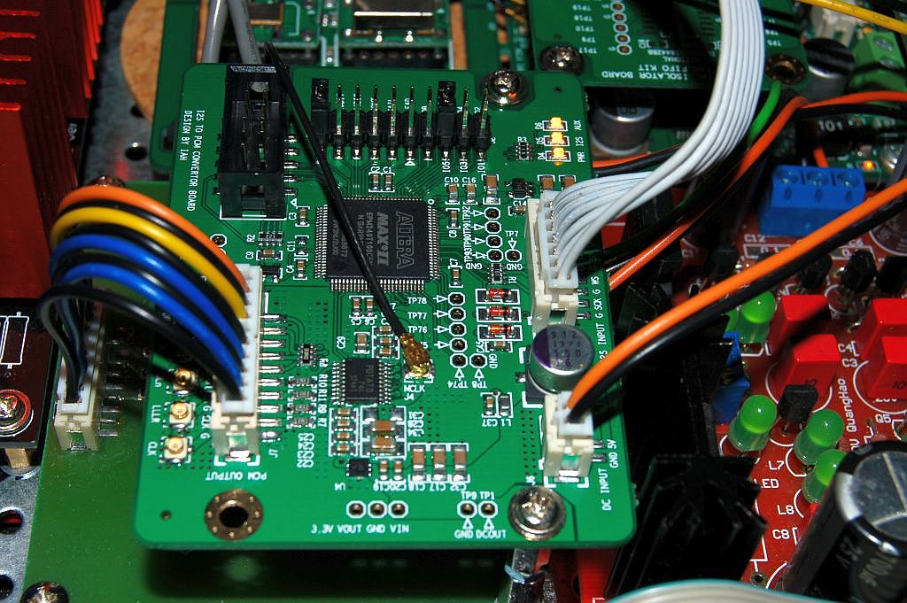

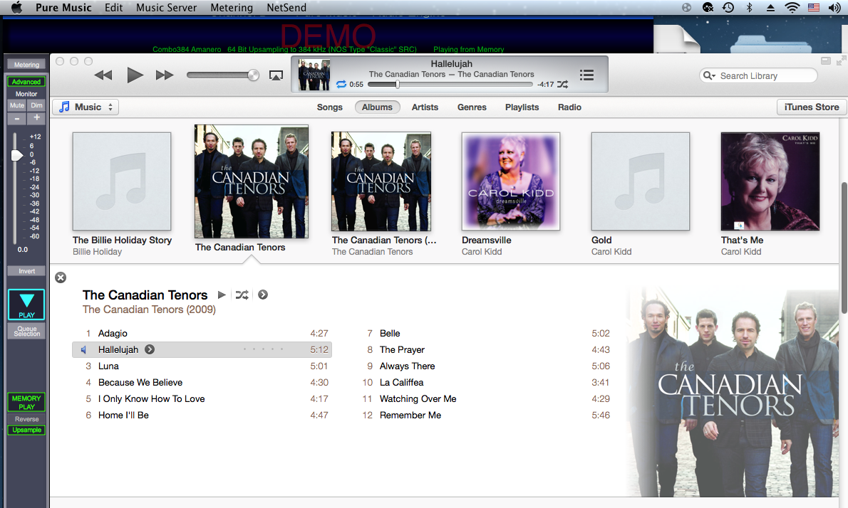

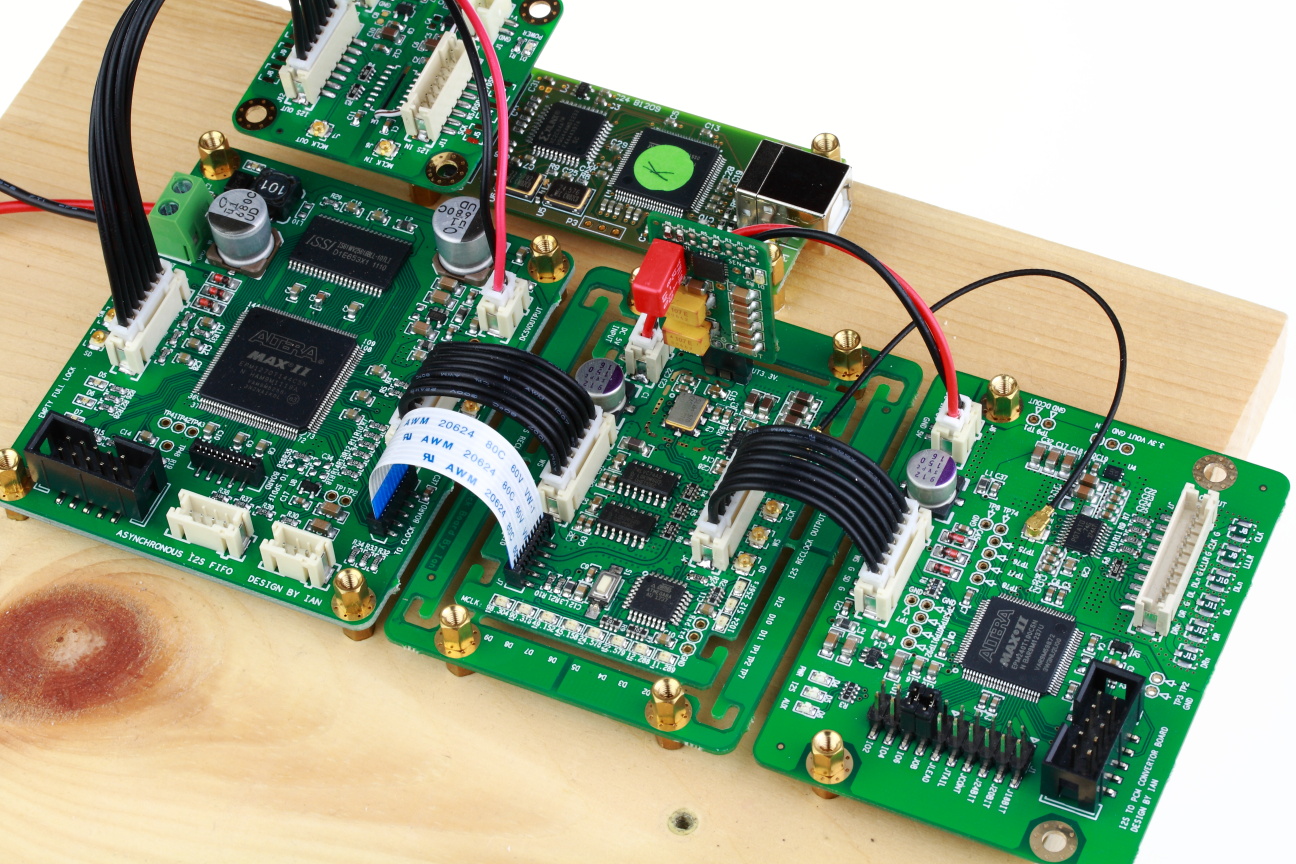

I made a fixture and did some test with success yesterday. I confirmed both PCM1704 and TDA1541A NOS DAC can work perfectly at 384KHz driven by I2S to PCM convertor board.
System configuration was:
1. PureMusic with 384KHz real time up-sampling and memory play
2. Amereo384 USB audio interface with I2S isolator
3. FIFO KIT with Si570 clock board running at 98.3040 MHz (can also use Dual XO clock board with 45.xxx/49.xxx MHz XOs)
4. I2S to PCM convertor board
5. PCM1704 or TDA1541A NOS DAC
PCM1704 can work at both half-speed and full-speed mode. Software based real time up-sampling filter should be better than hardware based DIF chips because of the 64bit calculation and algorithm.
TDA1541A sounds very nice at 384KHz, but could only work at half-speed mode. Though in this case, according to the datasheet, it’s already over clocked.
I2S to PCM convertor board can work with Amereo USB audio interface without FIFO KIT for sure, but can only go up to 192KHz because of the low frequency on board MCLK. I hope they can upgrade it to the 45.xxx/49.xxx MHz version later on.
I upgraded WaveIO to new firmware which comes with 384KHz support, and I did some test with same configuration. But I got problem with it. WaveIO plays noise at 384Khz on both PCM1704 and TDA1541A. But no problem at 352KHz. I tried back and forth a couple of time still cannot fix it. It might be a software compatible issue with pure music. Just hope it can be solved soon.
I attached some pictures blow. Please find the picture name for details. I2S to PCM board could also be stacked on top or underneath the clock board to save space.

Hi Ian,
I have not yet read the whole manual in detail. A quick skim read it looks good! A big achievement to get it all written down so concisely, there is a huge number of options on these boards!
I did notice that points 8 and 9 on the Application Notes & Tips page are missing test point numbers 'TPX' is presumably a place-holder for you to place the respective numbers. Looking at the pic of the top of the PCB I'm thinking maybe the 3pin regulator doesn't have TPX designations unless they're on the underside? These perhaps are now best shown as 3.3Vout, GND and VIN.

Hey Ian,
Concur- Great Job!
I am struggling to see the u.fl inputs that are mentioned in the table on the board unless that are on the underside? There were a couple other u.fl I couldn't see that we're mentioned, will check again later

Thank you so much Chris, you found a bug! Yes, it should be VIN, GND and 3.3V VOUT. Will be changed in V1.0

Hi Drew,
Another good point. Yes, they are on the bottom side of PCB. I'll discuss with vzs to see if we should include the layout of the other side into users manual.

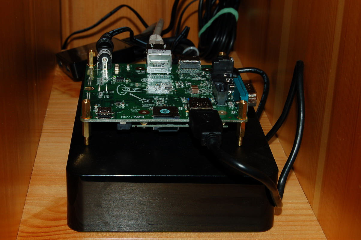

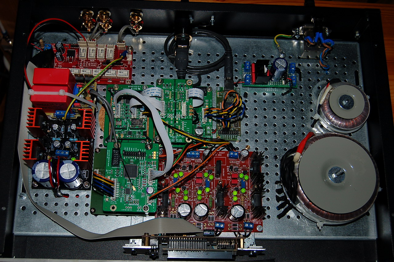

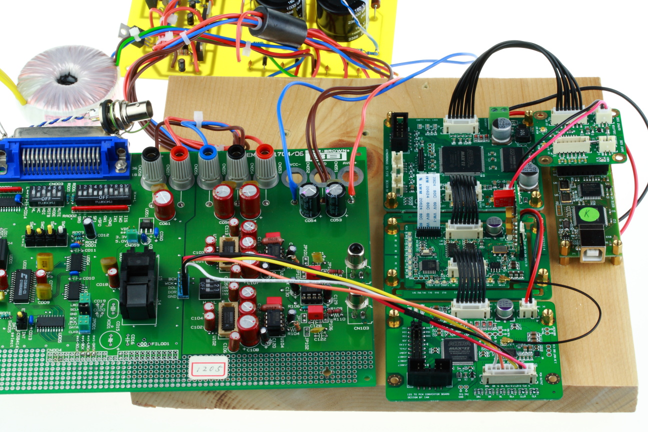

Hi Ian,
Got the converter board and did a quick test - it works nicely with AD1865 in both full-speed and half-speed modes!
The unfamiliar board among the pics is the music source Wandboard on top of an WD USB HDD. It will be stuffed into the DAC box as soon as I have time to do it.
Zsolt
Zsolt

Thank you for your good news. Looks very nice. What is the maximum Fs your AD1865 is going?
I didn't see your AD1865 😀.
I think I'll buy a Wandboard board. I can source it from mouser in Canada.
Ian
Thanks! I'm hiding my AD1865 🙂Thank you for your good news. Looks very nice. What is the maximum Fs your AD1865 is going?
I didn't see your AD1865 .
Forgot to mention... maximum Fs is 384KHz with full-speed mode.
Since it's overclocked with full-speed mode at 352.8|384KHz I'm using the half-speed setting - don't hear differences but will do some tests later on and maybe switch back to full-speed.
Zsolt
Zsolt
Good to know that. You confirmed AD1865, I confirmed PCM1704 and TAD1541A. It seems with this I2S to PCM board, all NOS DACs we tested can work up to 384KHz at NOS mode . That's really a good news.
Ian
Zsolt
Hi Zsolt,
I'm very interested in your AD1865 board. The concept is like a core board, with keeping anything else such as digital front end, IV, power supply external, the core board could become a standard part.
Each DAC can have its own core board to reduce the cost and complexity, for example AD1865 core board, TDA1541 core board and so on. With same size and same interface, they can share a same platform. Change DAC will be as easy as change a XO.
I like this idea 🙂.
Ian
