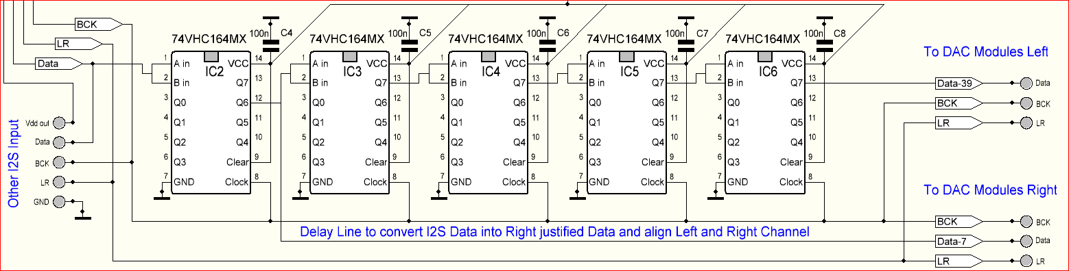

From the spec, PCM1794 is not a traditional R-2R DAC, and it accept right justified format which is not the 'PCM' format. So, I don't think you need this I2S to PCM converter.
It's very nice you run it at NOS mode 🙂.
Ian
PCM1794 is configured for Digital filter bypass - Mono (see specs Table 2.)
He has to delay both channels in order to have 24bit right justified of both: delay right channel by 7 cycles and left by 39 cycles to have the LSB bit of both data channels clocked in when right channel's latch goes low.
31-7 = 24
63-39 = 24
(31 and 63 because I2S format has data delayed by 1 cycle).
Right-channels's I2S latch signal (LR) latches both L and R DACs.
Having reviewed how that works I'm 99% sure I2S-PCM board can be used to bypass Doede's delay line.

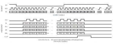

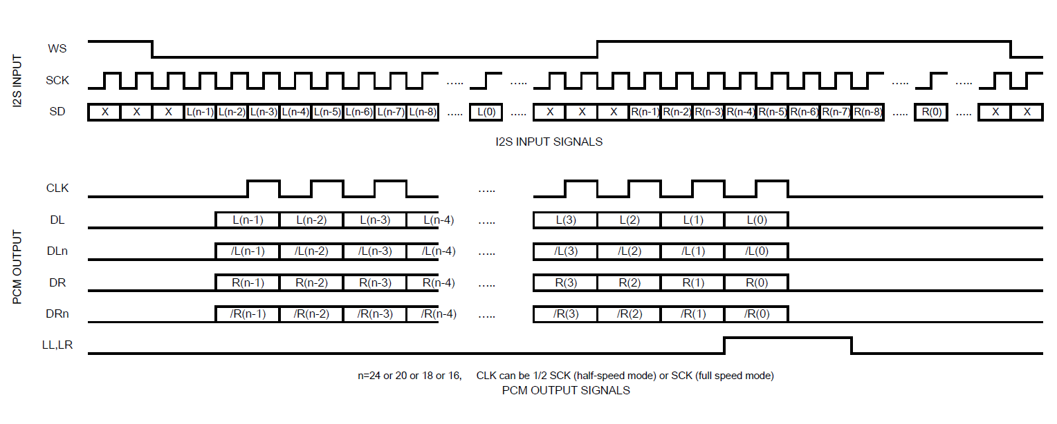

Maybe I didn't get your point. Running PCM1794 at NOS mode is a special configuration, can your post the timing to drive it?
Here is the principle waveform of I2S to PCM board (half speed mode), you can figure out if it is working for your application.
Ian
