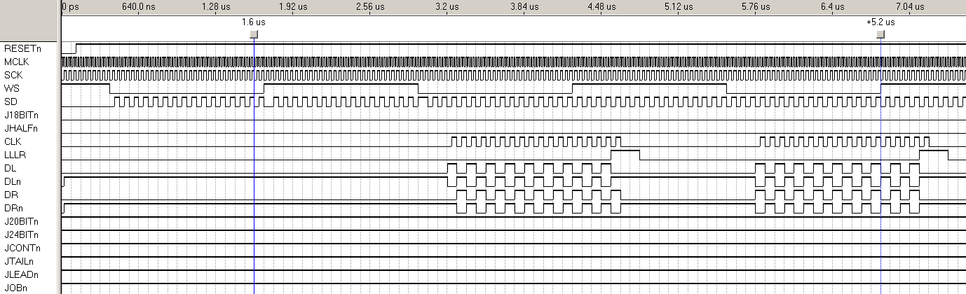

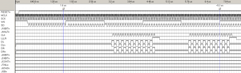

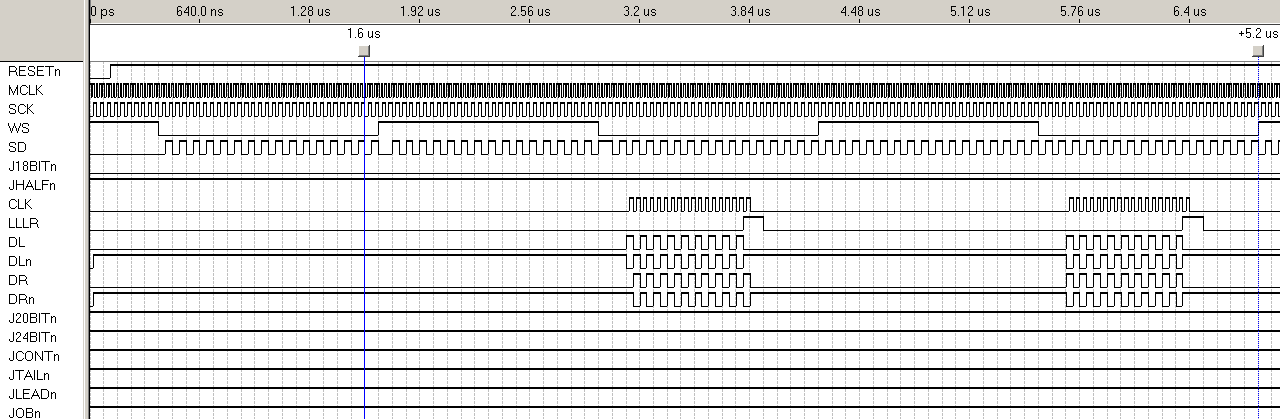

Half-speed mode passed simulation
I revised the verilog code to implement the half-speed mode. Now, it passed the simulation.
Simulation was running at 384KHz with 49.xxx MHz MCLK. You can see at full-speed mode (default), the CLK frequency was 24.xxxMHz, exactly as same as SCK. With half-speed mode jumper JHALFn jumped to low level, it goes half-speed mode. All data was exactly as same as full-speed mode, but CLK frequency was just as half as SCK, now becomes 12.xxx MHz.
Next step, I’ll do some real test with logic analyzer on the fixture. This project will be ready for launch if everything is OK.

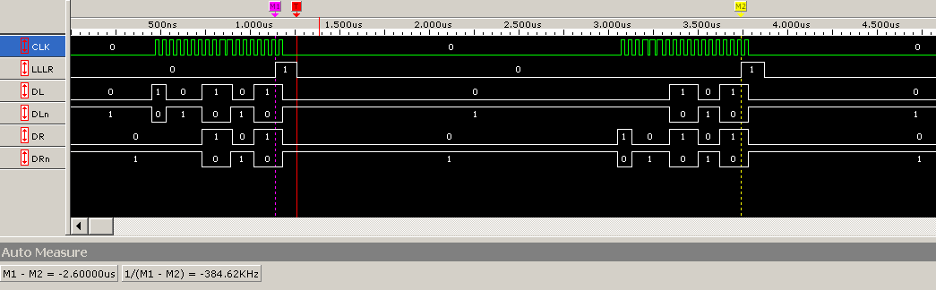

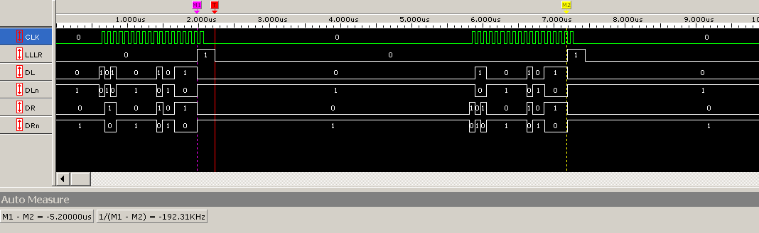

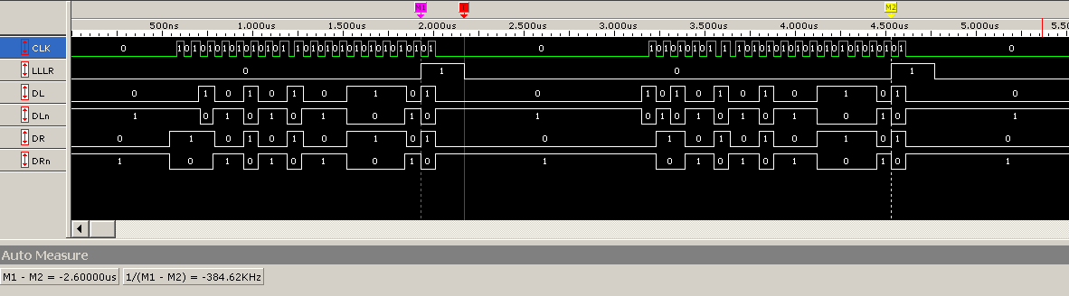

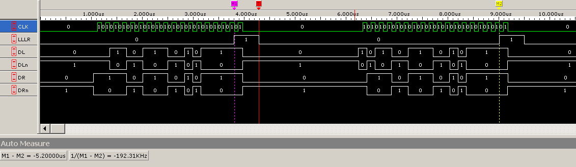

I2S to PCM board half-speed mode passed real world test
New upgraded firmware has been programmed, the daughter board passed the real world test without any suspecting.
Four waveforms were captured from screen of logic analyzer, they are:
192KHz 18bit half-speed mode
192KHz 18bit full-speed mode
384KHz 18bit half-speed mode
384KHz 18bit full-speed mode
From those waveform, it’s very clear the difference between half and full speed mode.
Bit perfect confirmed for both half-speed and full-speed mode up to 384KHz by loop test fixture as well. The MCLK frequency can go up to 98.xxx MHz from Si570 clock board without any problem. It also works for other MCLK frequency options, such as 49.xxx/45.xxx, 24.xxx/22.xxx and 12.xxx/11.xxx.
Real listening test did on PCM1704 and TDA1541A DAC. Half-speed mode sounds as good as full-speed mode. Both of them have no problem running at 192KHz. I didn't do the 384KHz listening test. I don't have a 384KHz music source.
Half-speed mode makes it possible running your NOS DAC at higher Fs. But, theoretically, full-speed mode comes with lower noise. The reason is obvious. There is more silence time on signals than the half-speed mode.

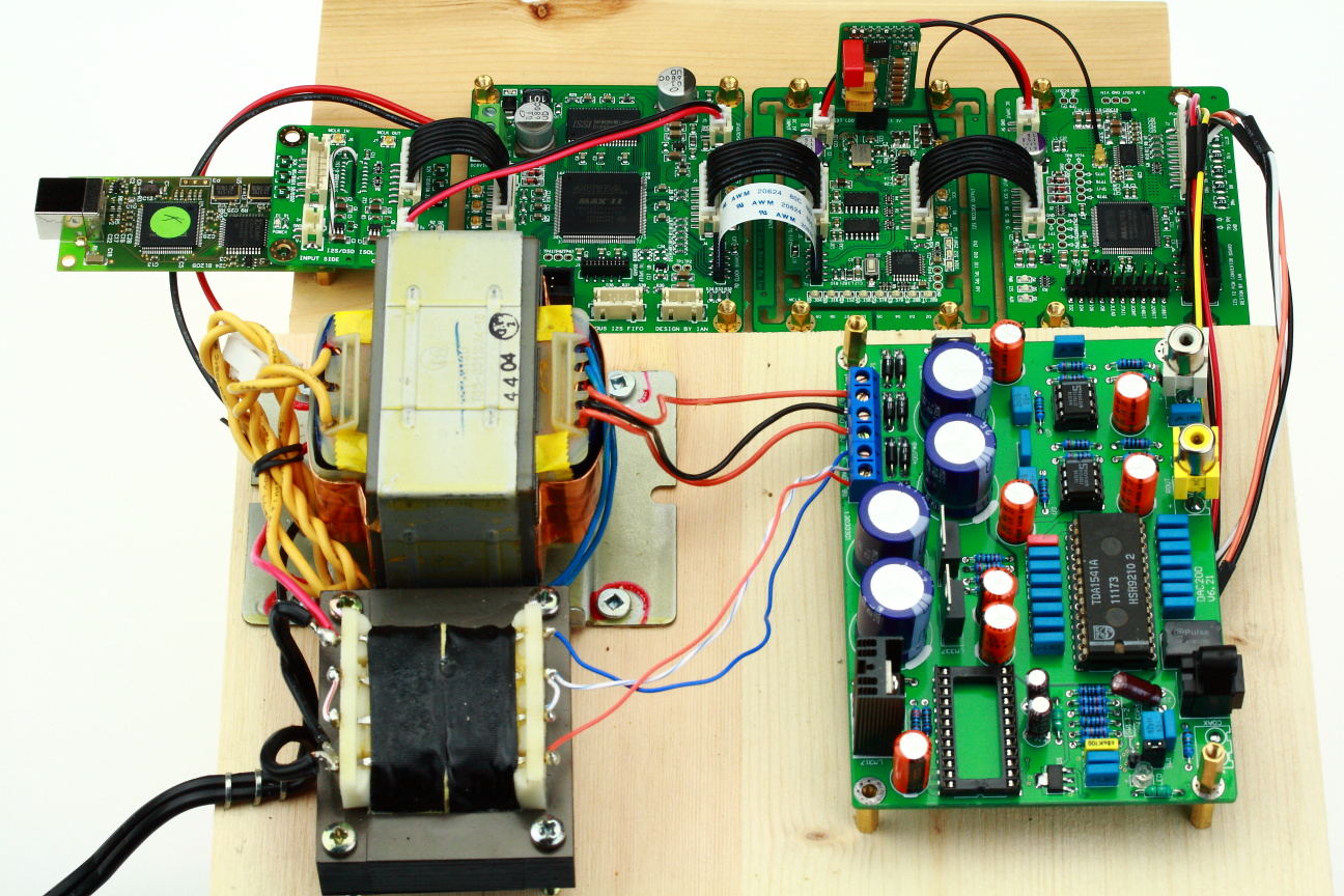

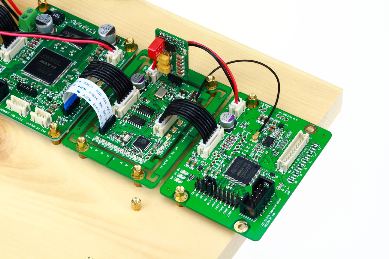

I got the final PCB, I’ll post some pictures soon.

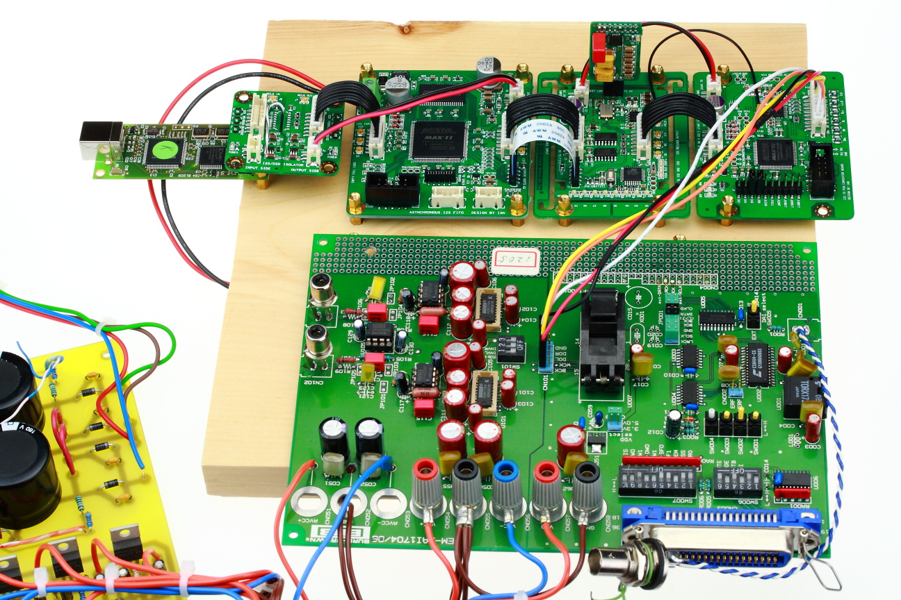

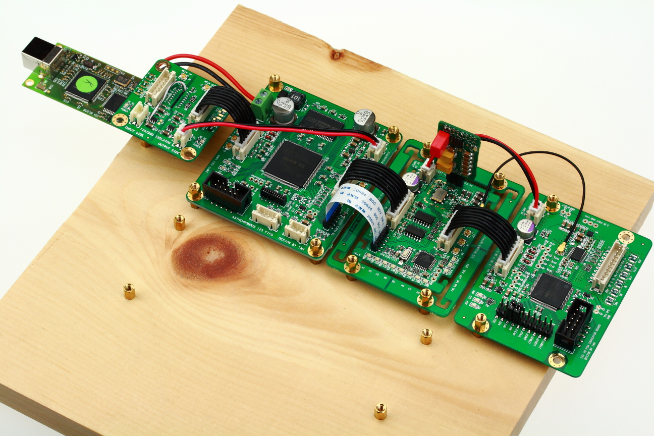

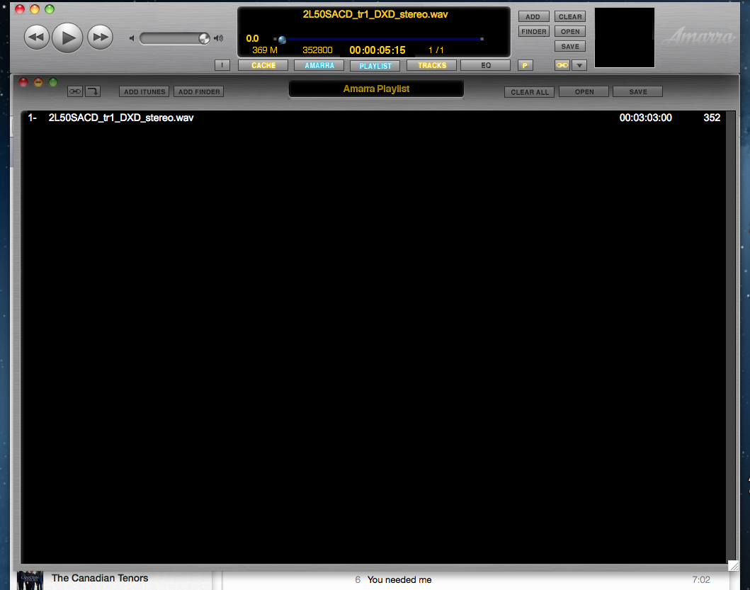

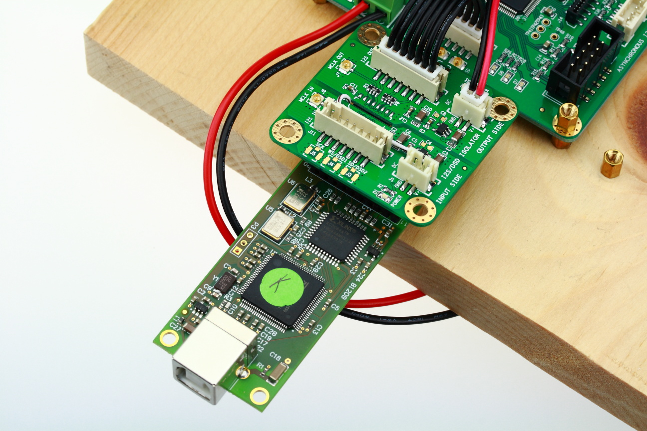

352.8 KHz listening test on NOS DAC TDA1541A and PCM1704
Since Ammara can play music up to 384 KHz with Amanero Como384 USB, it seems I can do some real listening tests on the I2S-PCM convertor board at higher Fs with NOS DAC now.
I download some 352.8 KHz music tracks from 2L: High Resolution Music DOWNLOAD services .:. FLAC in free TEST BENCH
Software setup:
MacMini – itunes - AmmaraV2.5.1
Hardware setup:
Amanero combo384 – isolator – FIFO – Si570 clock – I2S to PCM convertor
DAC setup:
1. NOS TDA1541 fixture
Jumper: short JOB and Half-speed mode
2. NOS PCM1704 fixture
Jumper: short J24 only
352.8 KHz music was playing on both NOS TDA1541A and PCM1704 without any problem. With higher Fs, they sound more analog. I have to say, TDA1541A sounds wonderful. I never thought it can sound like this way, with much higher Fs, it sounds very impressed.
At 352.8 KHz Fs, TDA1541A can only work at half-speed mode. Thanks vzs, without your great suggestion, all of us will lose the opportunity playing 352/384 KHz music with TDA1541, as well as AD1865 of course. If you don’t mind, I’ll send a final version I2S to PCM with half-speed mode to you for evaluation once I finish test.
PCM1704 can play 352.8KHz music at both half and full speed mode without any problem.
Unfortunately I can’t find any working software based real time up-sampling apps which can go up to 384 KHz so far for both Mac and PC, any recommendation?
Ian
