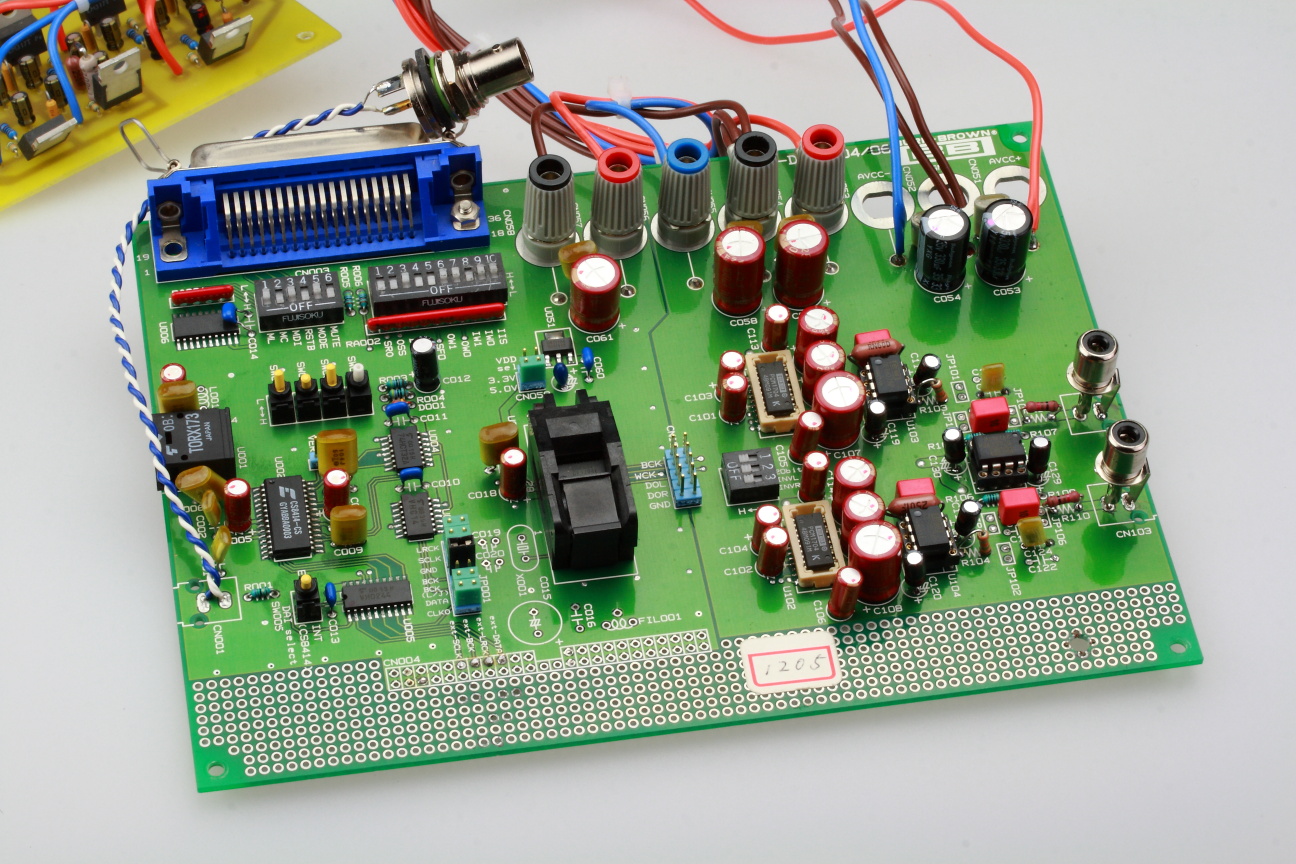

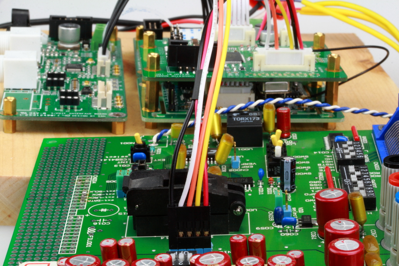

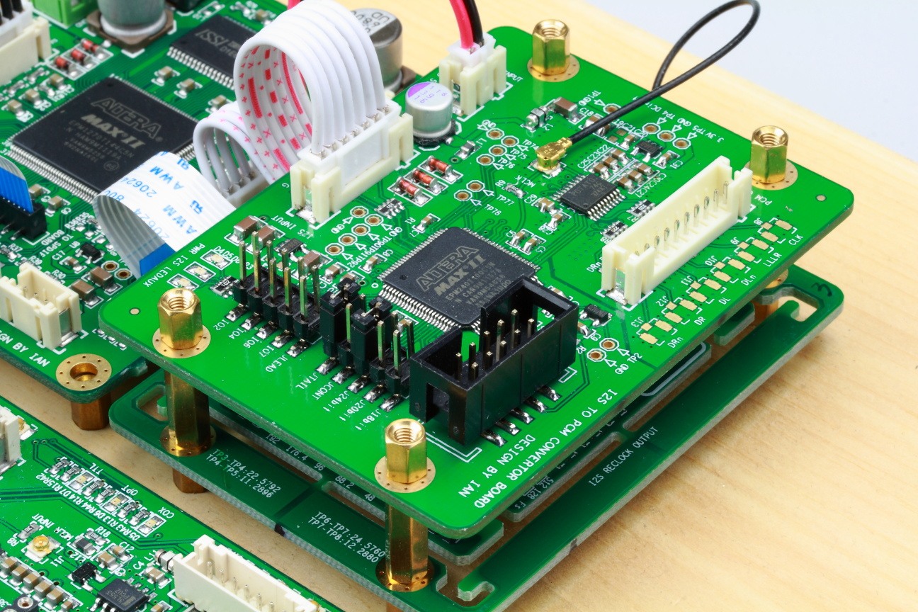

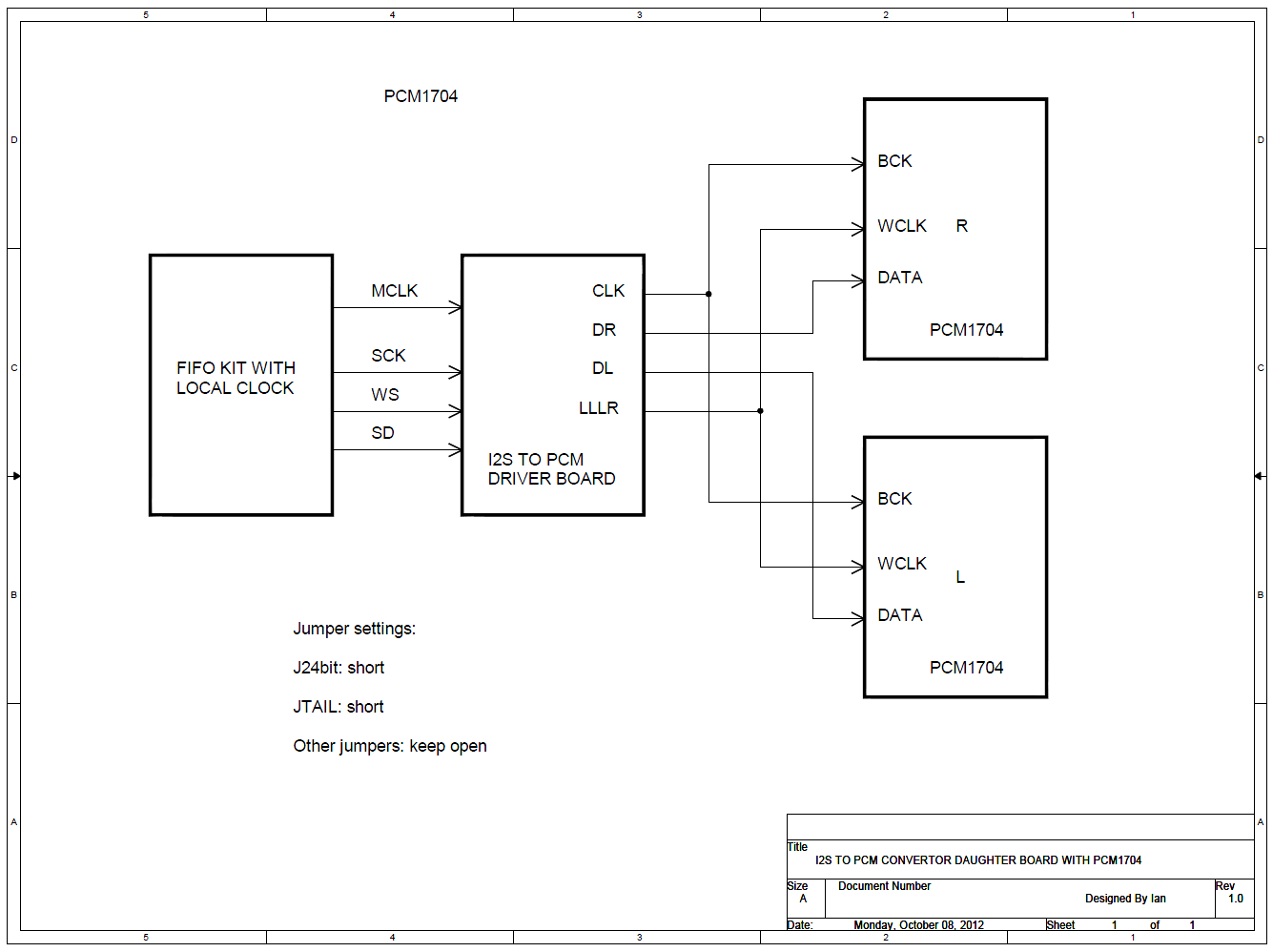

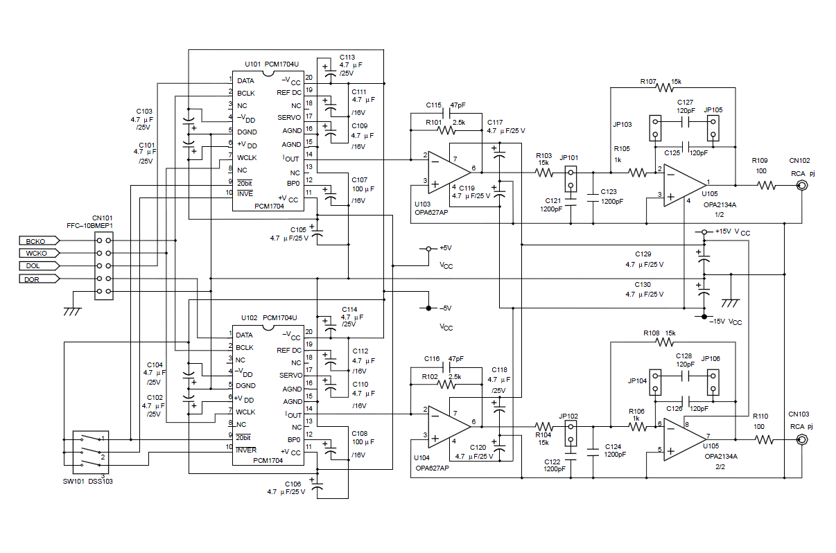

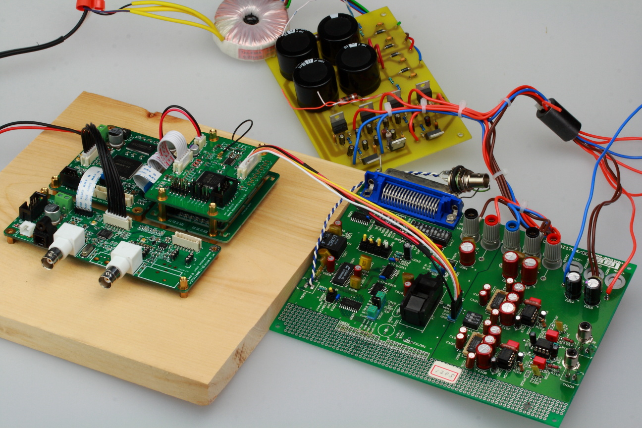

PCM1704 Confirmed works perfectly with the PCM daughter board from 44.1 to 192 KHz
I don’t have a PCM1704 DCA to test the PCM daughter board. A friend of mine sent his own BB PCM 1704 fixture to me. Thank you so much. It seems working perfect.
PCM1704 DAC connections:
LLLR to WCLK
CLK to BCLK
DL to DATAL
DR to DATAR
I2S to PCM daughter board configurations:
J24BIT short (24bit format),
JTAIL either short or open
All of other jumpers keep open
Test conditions:
Fs: 44.1KHz, 48KHz, 88.2KHz, 96KHz, 176.4KHz, 192KHz,
MCLK: 22.579, 24.576, 45.158, 49.152 MHz,
Without and with FIFO.
(The daughter board tested working bit perfect up to 384 KHz, but I don’t have a 384 KHz music source to confirm.)
It works very well on all conditions. 192 KHz sounds much better than 44.1 KHz, over all, the daughter board sounds better than the original front end (DIR and digital filter at left half of the BB fixture), impressive. PCM1704 normally works with DF1704 digital filter running at 8x Fs, so, to play 44.1/48 KHz music, software based up-sampling plug-in is highly suggested, otherwise, you need to have very good NOS LPFs.
Some comment:
1, Continuous clock mode (JCONT) is also functional, but is not recommended. Stop clock mode theoretically comes with less noise.
2, JTAIL was specially designed for PCM1704/02. But the actual testing result shows PCM1704 works perfect either with JTAIL short or with it open. So now, JTAIL becomes an optional function, can be decided according to personal preference.
3, To get better signal quality, u.fl coaxial cables are highly recommended for the connections between DAC and the daughter board.
4, PCM1704 was powered at +-5V, the datasheet says the min Vih is 2V. I don’t think there is any problem tolerance with PCM daughter board outputs which are 3.3V LVTTL logic level. Actual test also approved it.
5, If using a FIFO KIT in system, I am highly suggested place a isolator board between FIFO and clock board.
Now, we already confirmed the daughter board working perfect with AD1865, PCM1704 and TDA1541. Please let me know if you think it’s OK to release.
I already ordered the final version (V2.0) prototype PCB. I will test it very soon. GB board will be based on this version.
Ian

Ian,
For lower noise, would not it be better to have 1704 board on FIFO side,
before isolators?
TonyB
Let me try to answer in Ian's place... what you want to isolate from noisy ground is mainly your clock board and what follows (e.g. I2S-PCM and your DAC).Ian,
before isolators?
TonyB
Since the FIFO itself might have some ground noise from its FPGA you want to isolate that too, so option #1 is to insert the isolator between FIFO and Clock board.
If you are not comfortable isolating FIFO from Clock board (but why not?) there is option #2 to use the isolator before the FIFO, thus isolating the I2S source only.
Option #3 is the most orthodox of all: use two isolators, one before FIFO and one after, so basically option #1 + #2
I2S-PCM (1704) also has FPGA, a noise generator. That is why I would not have it on the DAC side. I would place it on FIFO side, before isolators and oscillators/DAC.
From what I could see, Ian placed the 1704 board on the DAC side, after isolators.
I2S-PCM board uses a simple CPLD not an FPGA and is carefully designed as far as grounding, powering and trace impedances are concerned. I would be happy to say the same about most of the available DAC kits.
All isolators add a fairly large amount of jitter. In Ian's design-stack simply adding an isolator between DAC and I2S-PCM would deceive the whole role of the FIFO which is eliminating jitter.
In order to do what you are suggesting: isolating the I2S-PCM board from the DAC and not shooting yourself in foot with a jittery isolator you would also have to move the clocks and a reclocking stage on the DAC side. Of course these clocks will have to be routed back to the dual-clock board through an isolator. In _my opinion_ this is theoretically possible -even with the current isolator board- but I have high doubts whether you gain anything from it.
