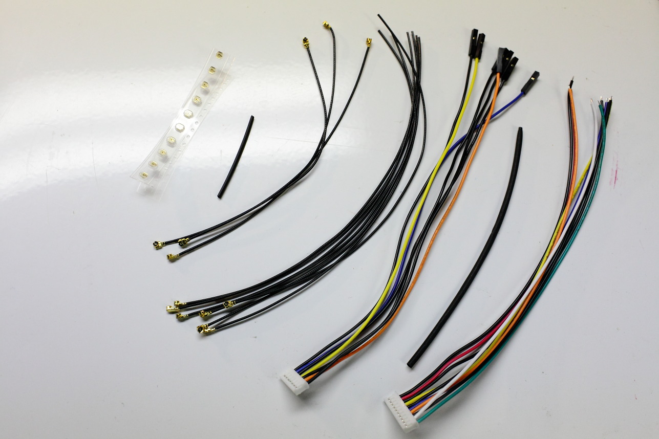

Do you need single ended U.FL cables to improve signal quality? I can send you some.
Another thing is, all output signals of the daughter board work at 3.3V LVTTL logic level, I'm concerned about if your DAC can tolerance with this logic level when CLK frequency goes higher.
Ian
Ian I need U.FL sockets to install at the I2S input & output of your Driver NOS also will be nice if you provide more uncut & cut U.FL cables to connect WaveIO to Driver NOS.

Sure, will send them to you in a letter this evening.
Ian
Ian

Hi merlin el mago,
I made a full set of cables for you. Both u.fl and ph2.0 are included. Together with the u.fl sockets and some heat shrinks, they were shipped this evening in an envelope . You will receive in a week. Hope they work for you.
Ian
