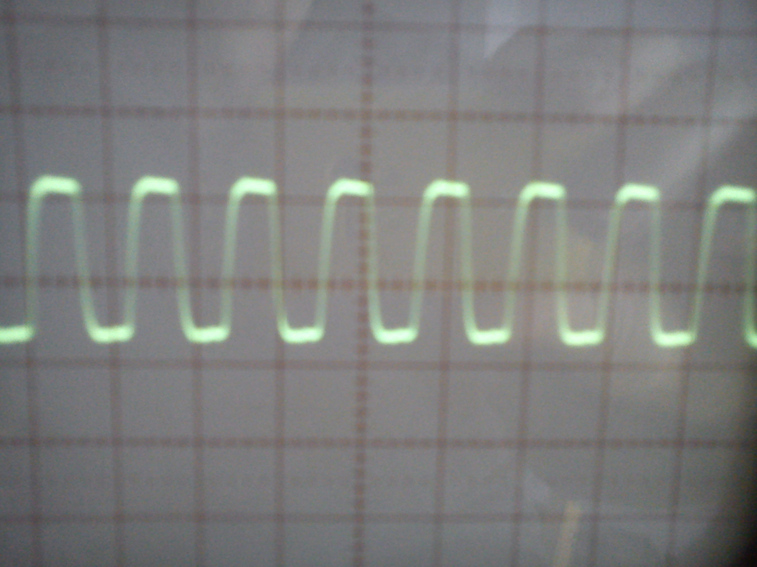

So all three leds from the converter are lit up or just the power? No, only lits the power LED
I suppose you:
- checked -without powering the units- that everything is connected and nothing shorts to ground Yes
- measured with your scope that you get the correct frequencies at each and every MCLK/SCK/CLK/WS/LLLR input and output pins I will do today

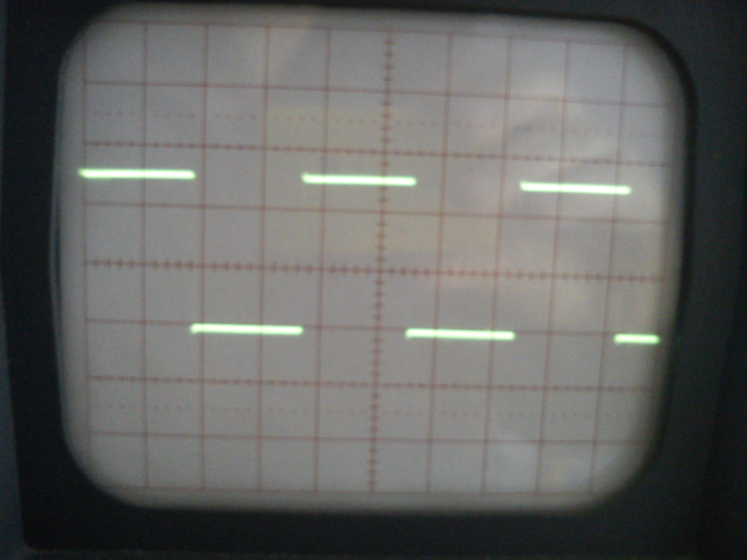

The U.FL with MCLK was not connected now LEDAUX LED is lit togheter the PWR LED, still I2S LED don't lit, attached pic with WS, SCK & MCLK arriving to the Driver NOS, obviously I can't measure nothing at LLLR & CLK Driver NOS output.

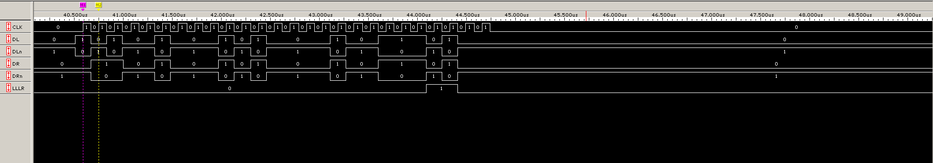

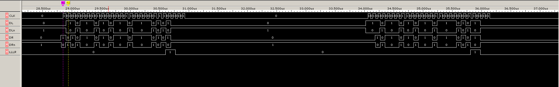

Real waveforms driving PCM1704 at 96 KHz and 192 KHz
I’m trying to replay the real case of merlin el mago on the last daughter board I keep.
Jumper settings: J24bit and JTAIL closed, all others open
MCLK was fixed at 24.576MHz
24 bit I2S generator was running at 96 KHz and 192 KHz
The screen shot was captured from my logic analyzer. Unfortunately I don’t have a PCM1794 DAC😉.
Loop test confirmed bit perfect.
Maximal Fs was tested at 384 KHz, but MCLK has to be 49.152MHz or 98.304MHz with this frequency.
It seems OK from the waveform. Please let me know if you can find any problem.

Waveforms seems OK from both format and timing point of view....
It seems OK from the waveform. Please let me know if you can find any problem...
As far as clock modes are concerned I would recommend everyone to start with JCONT closed -continuous clock operation- . Only if this works try with JCONT open -stopped clock operation-

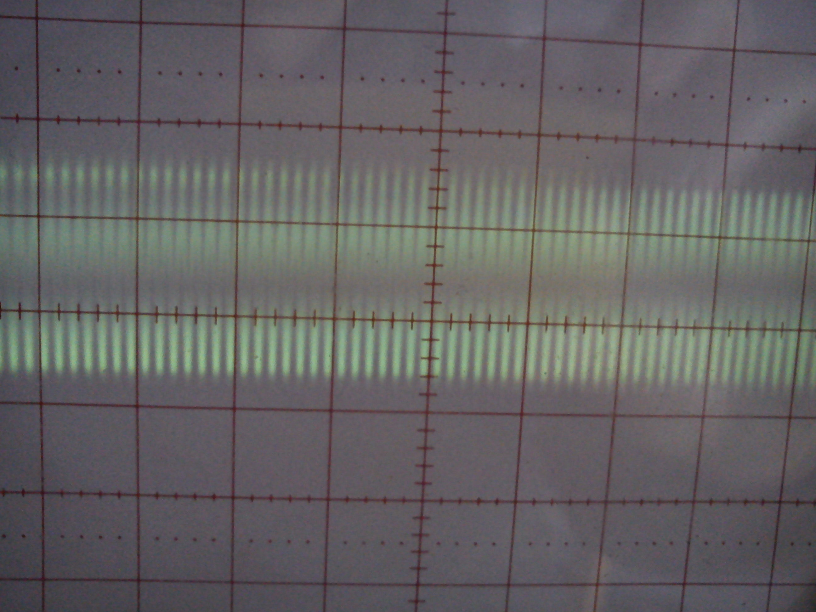

In place of bus powered I used separate +5V PSU for WaveIO, all three LEDs lits but still plays 192K with a lot of noise😡
Can you confirm that PC-WaveIO ever worked correctly at 192k?
I didn't played with USB sound-cards/streamers yet but I saw they need specific drivers, maybe buffer settings?
I think I'm out of ideas, sorry.
